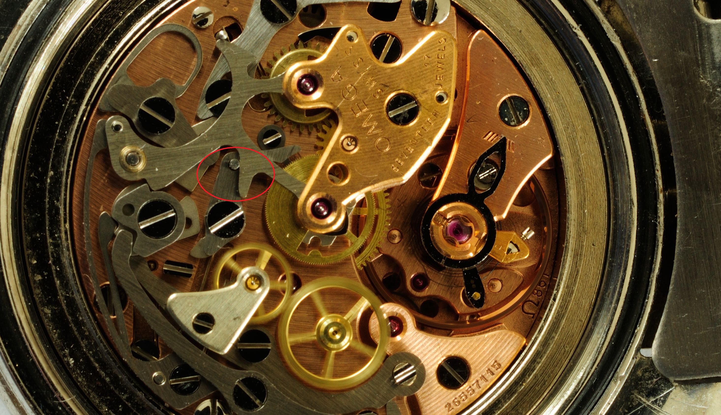

    Anyone got a wider pic of an 861 to put the brake in context?
  5. ahsposo Most fun screen name at ΩF Jan 14, 2017
    3,745
    19,992
    See the red oval
    BTW This photo was taken before a service so it's cleaner now...

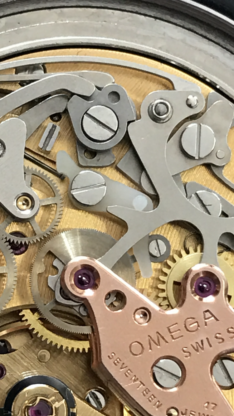

  7. ATWG Jan 14, 2017
    2,053
    6,192
    Here is another plastic, slightly different color
