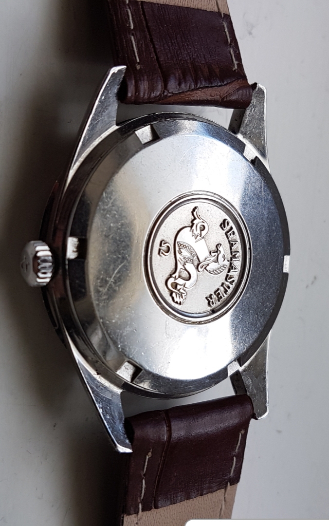

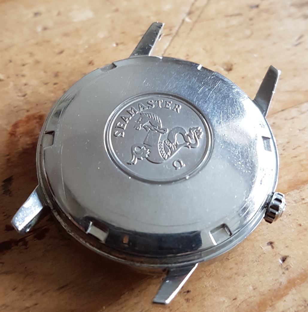

  15. Shabbaz Oct 5, 2019
    4,897
    17,855
    Cases?... 1st one is a 165001. Second one a 165002
    Edited Oct 5, 2019
  16. Noddyman Oct 5, 2019
    1,116
    1,774
    Ugh!! 1st one 165.001? You on the wine already?
  17. Shabbaz Oct 5, 2019
    4,897
    17,855
    Haha. Ok. Let me go back to my database. Maybe I took a wrong picture out of it. I once owned a couple of 165001's...
  18. Shabbaz Oct 5, 2019
    4,897
    17,855
    Sorry. I think a picture of a 166010 ended up in my 165001 file... :D::book::
    Noddyman likes this.
