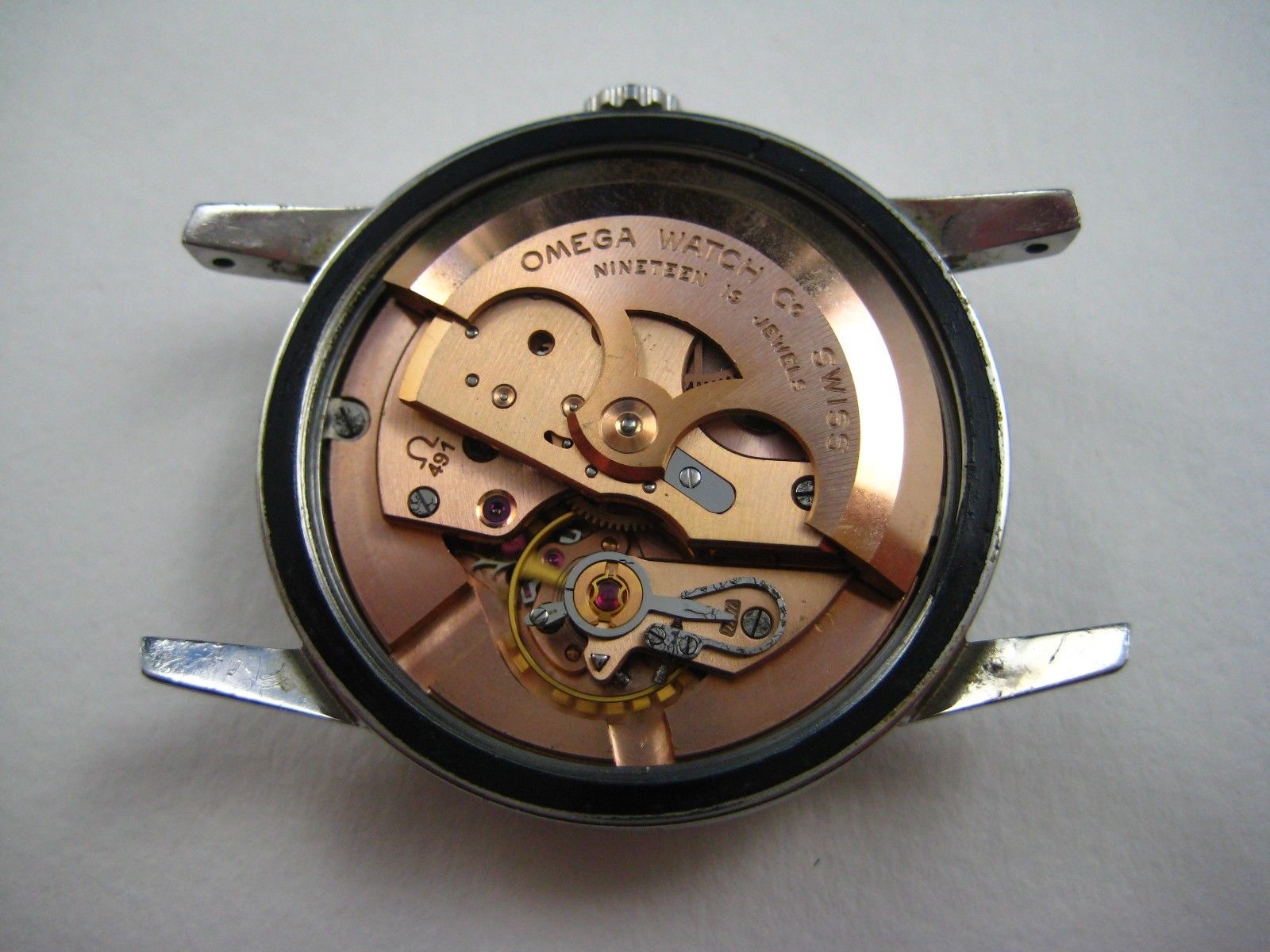

What every ones opinion on the dial refinish or original?
  1. DG GW Jan 2, 2015
    204
    92

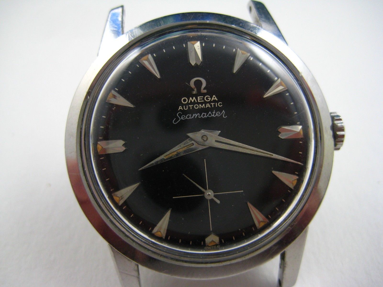

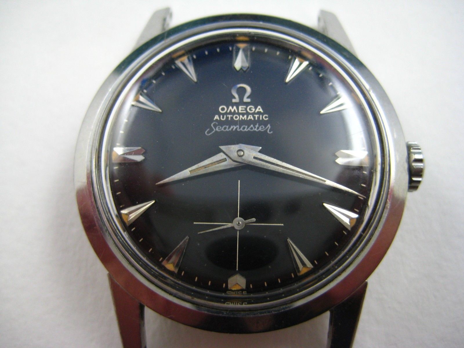

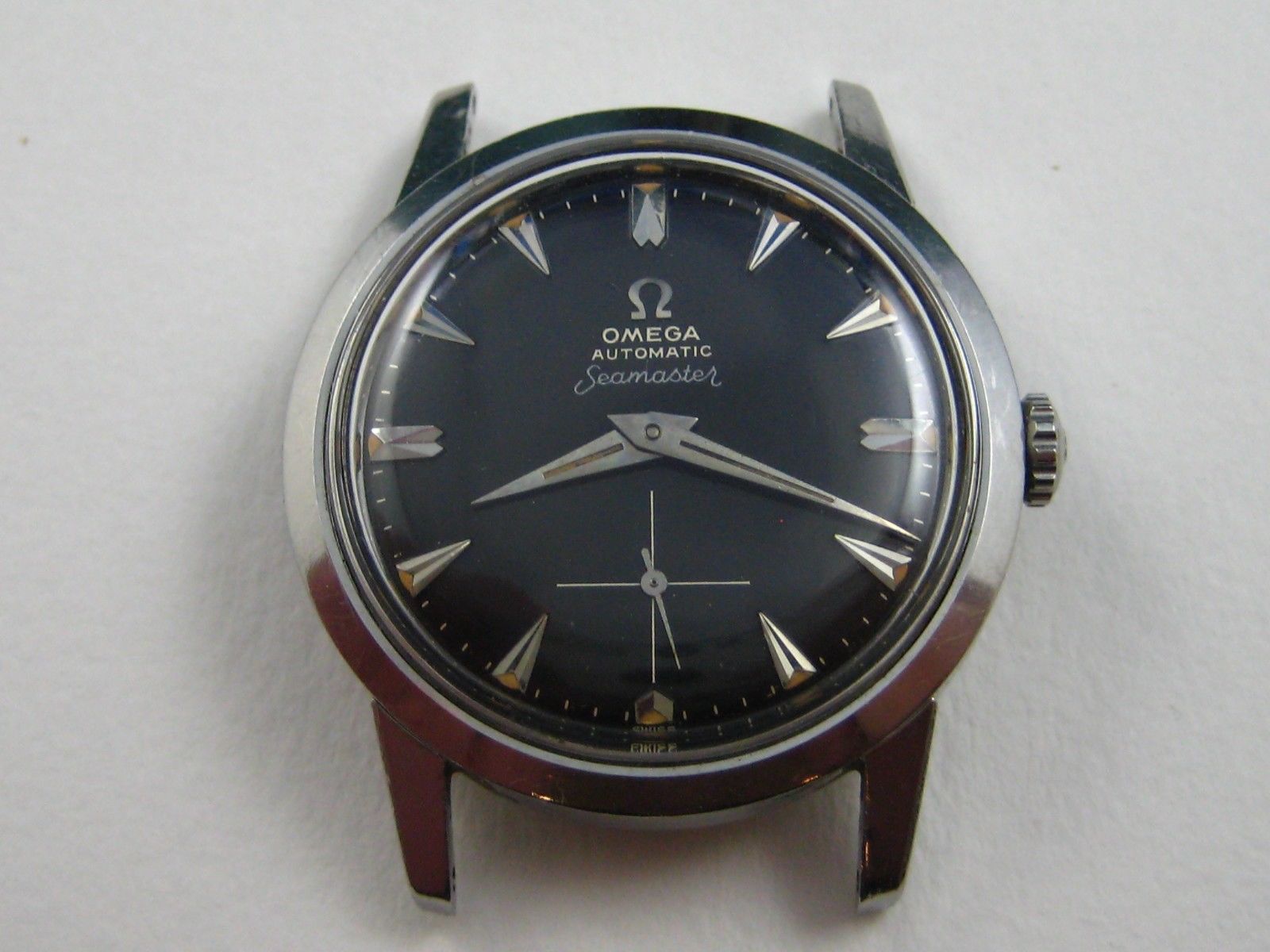

    The seller claims this to be an original dial. What every ones opinion on the dial refinish or original?
    REF.14767 RA-61. DATES 1958
  2. watchyouwant ΩF Clairvoyant Jan 2, 2015
    5,157
    8,673

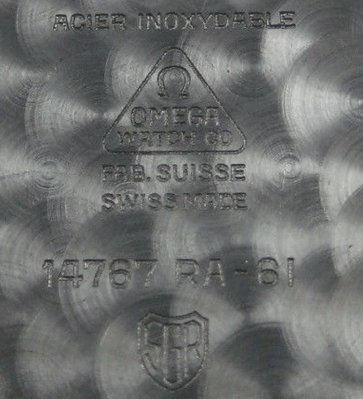

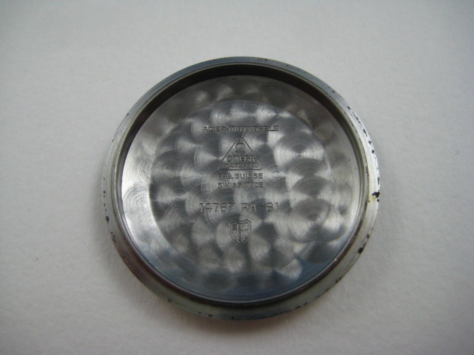

    hard to see about the dial.... my gut feeling is refinished; the printed minute marker strokes are not right. and to me the inner case back markings are laser engraved..... not a good sign for that claimed age..... no buy for me. kind regards. achim
  3. MSNWatch Vintage Omega Aficionado Staff Member Jan 2, 2015
    6,533
    10,835
    Probably original.
  4. Mark020 not the sharpest pencil in the ΩF drawer Jan 2, 2015
    4,736
    6,740
    +1. My feeling as well. Bit to crisp imho
  5. gatorcpa ΩF InvestiGator Staff Member Jan 2, 2015
    12,204
    15,718
    My vote is also all original. I'm normally very skeptical of earlier Omegas with black dials, but this one has two very good signs:
    1. All the dial lume is uniformly aged and matches the hands.
    2. The dial is marked "Swiss", not "Swiss Made". This would indicate a U.S. market piece.
    Very nice piece,
    gatorcpa
    Samir likes this.
  6. cicindela Steve @ ΩF Staff Member Jan 2, 2015
    15,047
    23,790
    The script looks very appropriate for 1958 and matches that on 2846's I own.
  7. X350 XJR Vintage Omega Aficionado Jan 2, 2015
    12,620
    29,918
    Original.
    If you look closely the "printing" is gilt (under) the black and not printed on top.
    Movement and dial condition match nicely.
  8. Hijak Jan 2, 2015
    7,225
    24,337
    That's a nice watch!:thumbsup:
  9. dsio Ash @ ΩF Staff Member Jan 2, 2015
    26,989
    32,701
    That's a very attractive dial
  10. DG GW Jan 2, 2015
    204
    92

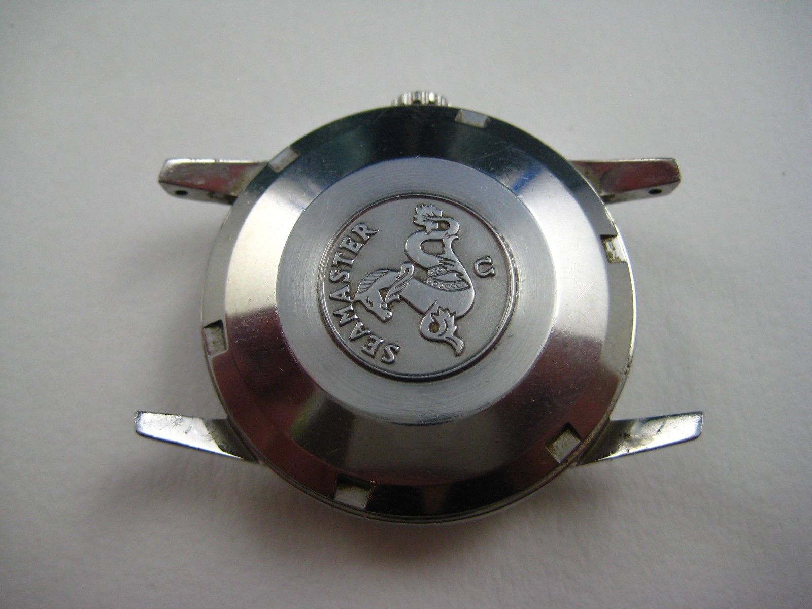

    I to am worried about the case back it does not look like any other I have seen. I am no means an expert it the matter but it does look some what like a laser engraved it. How are the case backs from the 50's marked? Are they stamped? Any one seen RA-61 on a case back before?
  11. Hijak Jan 2, 2015
    7,225
    24,337
    Its just fine, in fact its known as the big medallion and nice to have.
  12. DG GW Jan 2, 2015
    204
    92
    No am sorry not this pic. The inside of the case back look laser engraved. Any one else see this or is it just me?
  13. gatorcpa ΩF InvestiGator Staff Member Jan 2, 2015
    12,204
    15,718
    That is exactly as it should be. Not laser engraved, but it is very sharp.
    gatorcpa
  14. DG GW Jan 2, 2015
    204
    92
    Thank you Gatorcpa I purchased it
    NT931 and Darlinboy like this.
  15. X350 XJR Vintage Omega Aficionado Jan 2, 2015
    12,620
    29,918
    I think you got a nice watch.
  16. Darlinboy Pratts! Will I B******S!!! Jan 2, 2015
    8,736
    69,169
    You got a nice one!
