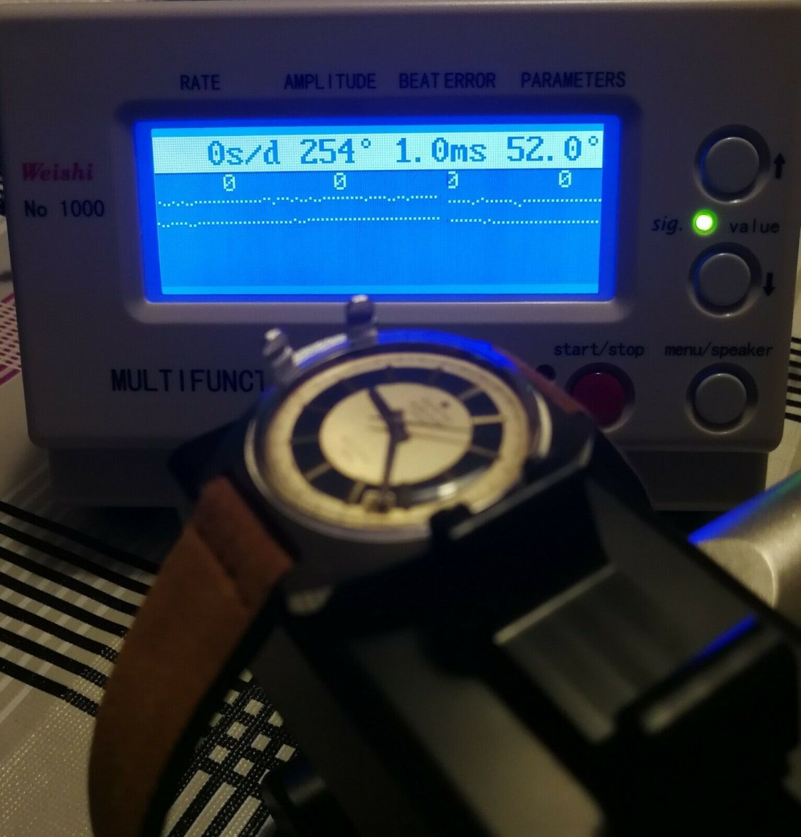

What does this readout mean?

Can anybody tell me what this particular readout is telling me?

Yes. It is telling you that your vision is way the heck better than mine, as I am unable to read it. 馃榾

It's telling me that the user is too lazy to set the correct Lift Angle on the Timegrapher.
And that the loss rate is zero seconds per day, the amplitude is 254潞, the beat error is 1 millisecond and the lift angle is 52潞 (the default setting).
Or sets it to whatever makes the watch look best.

This doesn't tell you much. As noted the lift angle is set incorrectly, and should be 49 degrees. This means the balance amplitude you see is overstated by about 18 degrees, so the 254 is actually more like 236. The beat error is too large, and the rate in this one position looks okay.
But none of this is worth anything unless you know what the state of wind in the movement is. Next what is the variation in positions? Unless you keep the watch in this position all day long, this tells you absolutely nothing about what the timekeeping performance will be when the watch in the wrist.
Sellers tend to add these things in for proof of something - most of the time it proves they don't know how to use a timing machine properly, and not much else.
Cheers, Al

Bad taste in tablecloths? Dunno.
I'd steer away from such a low amplitude unless you factor in the cost of a service.
