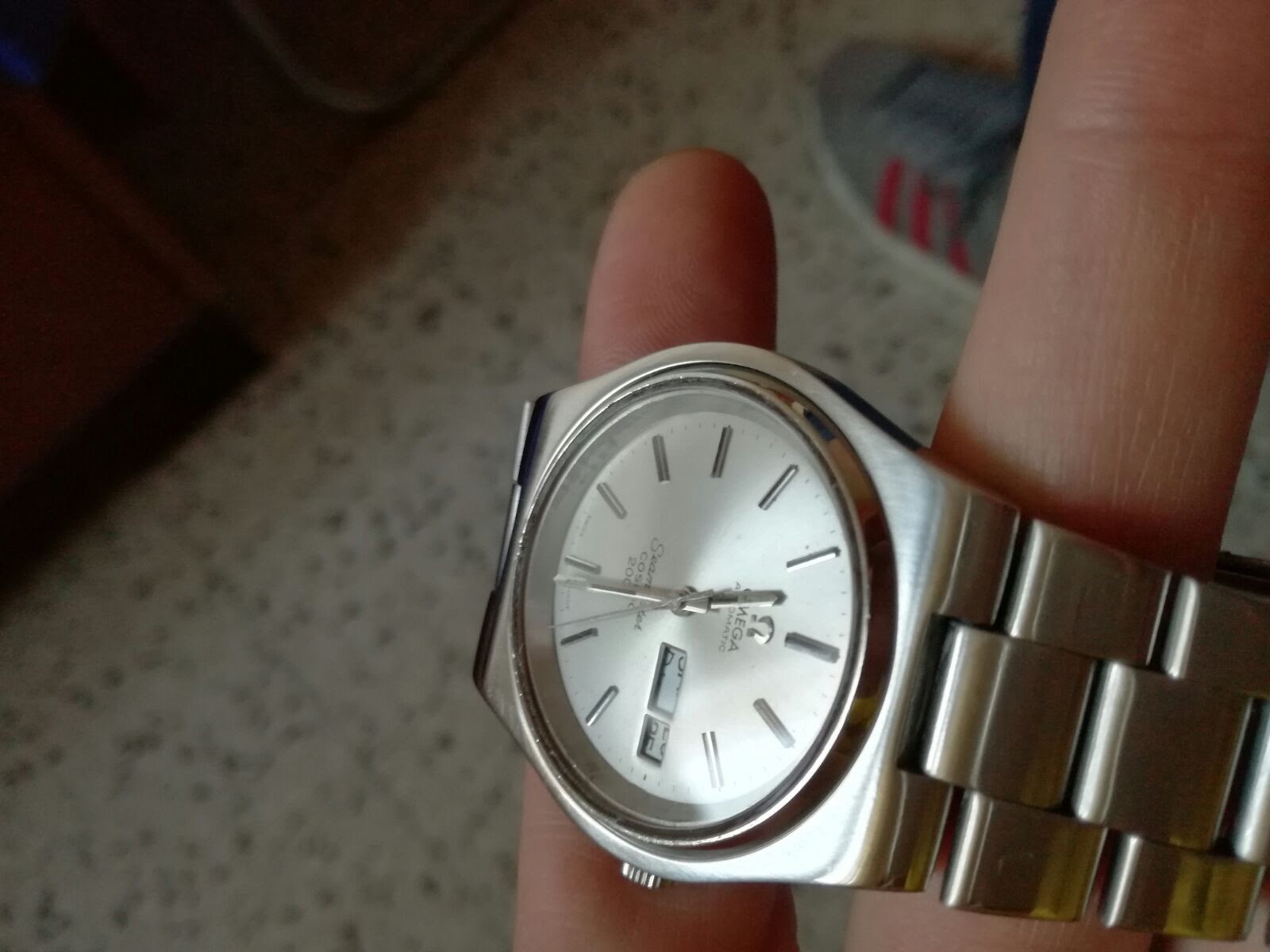

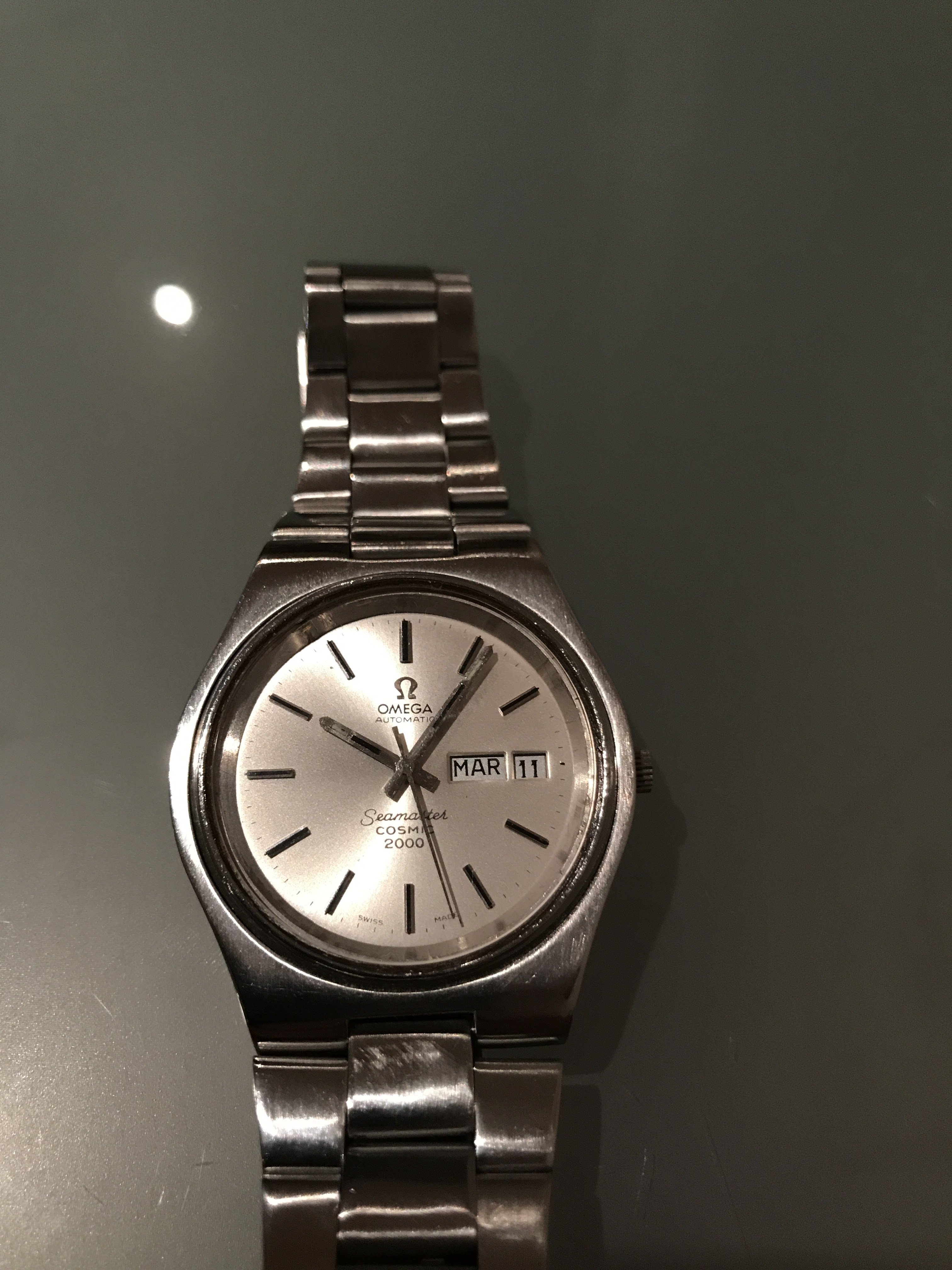

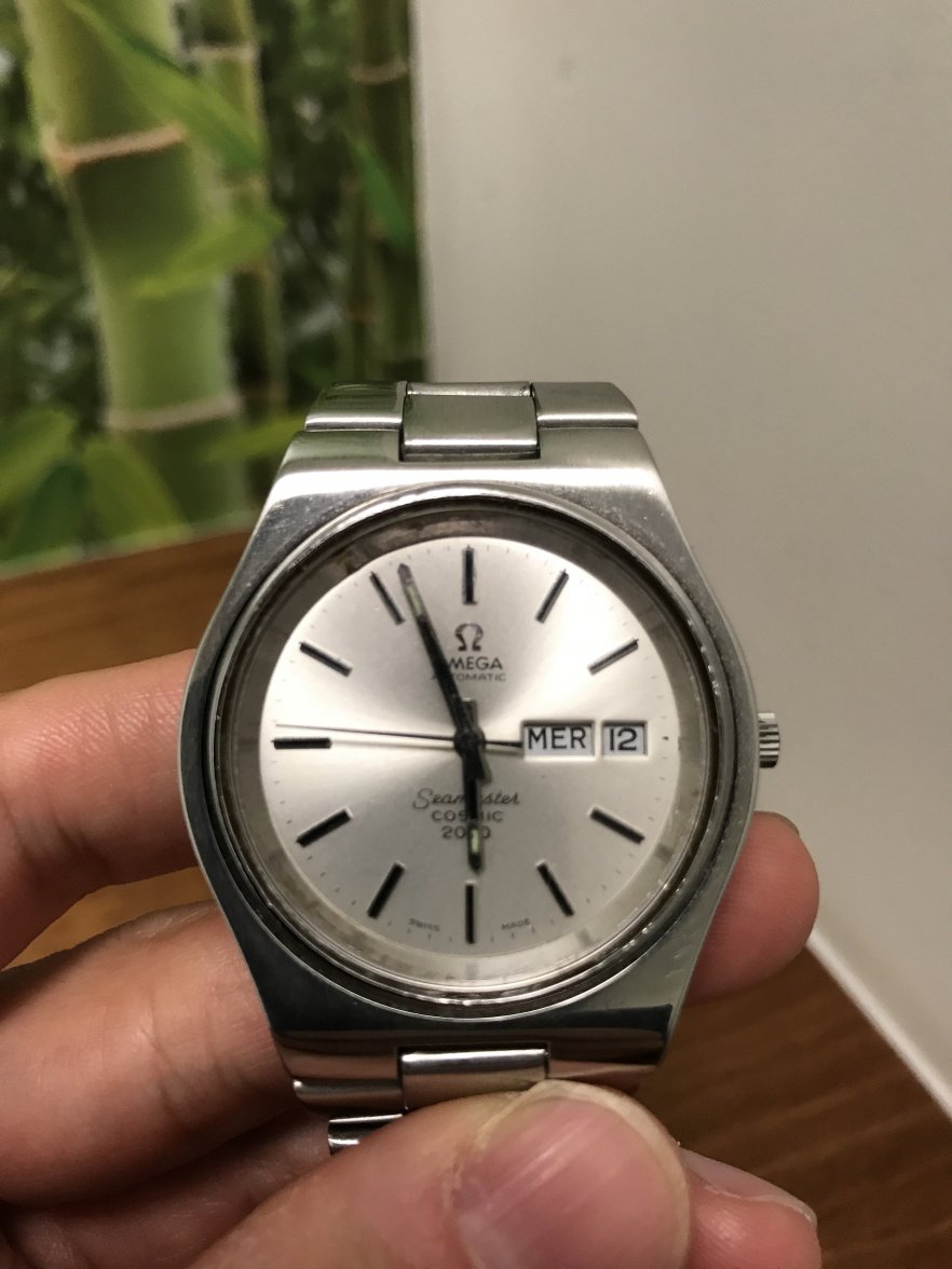

    Hi all,
    I recently bought this Omega Seamaster Cosmic 2000 from a private seller. The watch was sold to me as a genuine vintage (no repaint, polish etc.).

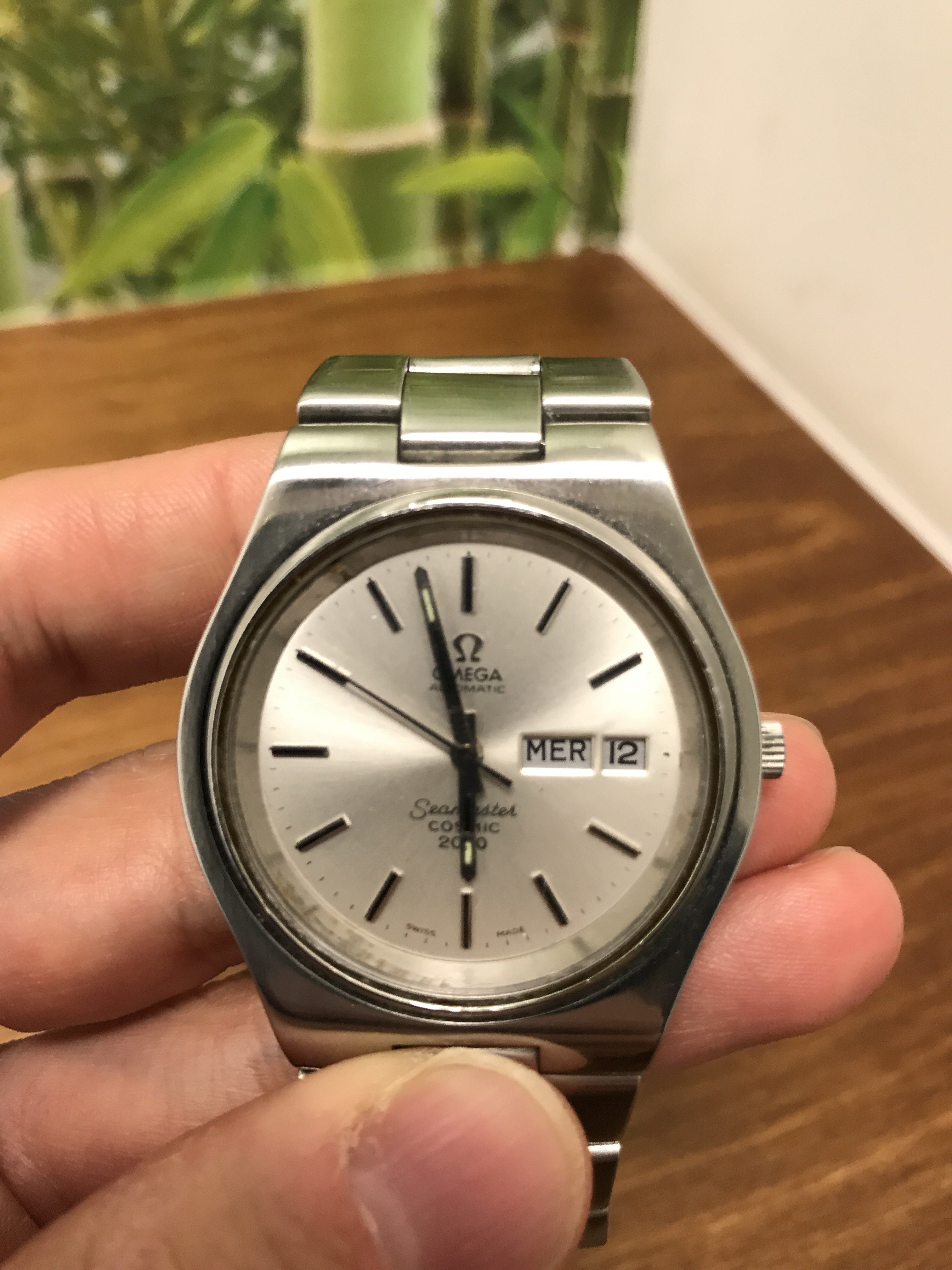

    I've shown it to a couple of experts since then and I got some contrasting opinions. In particular one of them told me that the dial may not be authentic as:
    - the day-date wheels are missing their frame (you can see it on this watch for example);
    - the SWISS MADE logo is positioned above the seconds' markers, while it should be below them.
    I don't consider myself an expert of vintage watches and I'd really like to get your opinion on all this.
    Thanks a lot!
    M

  2. oaclondon Apr 25, 2017
    74
    511

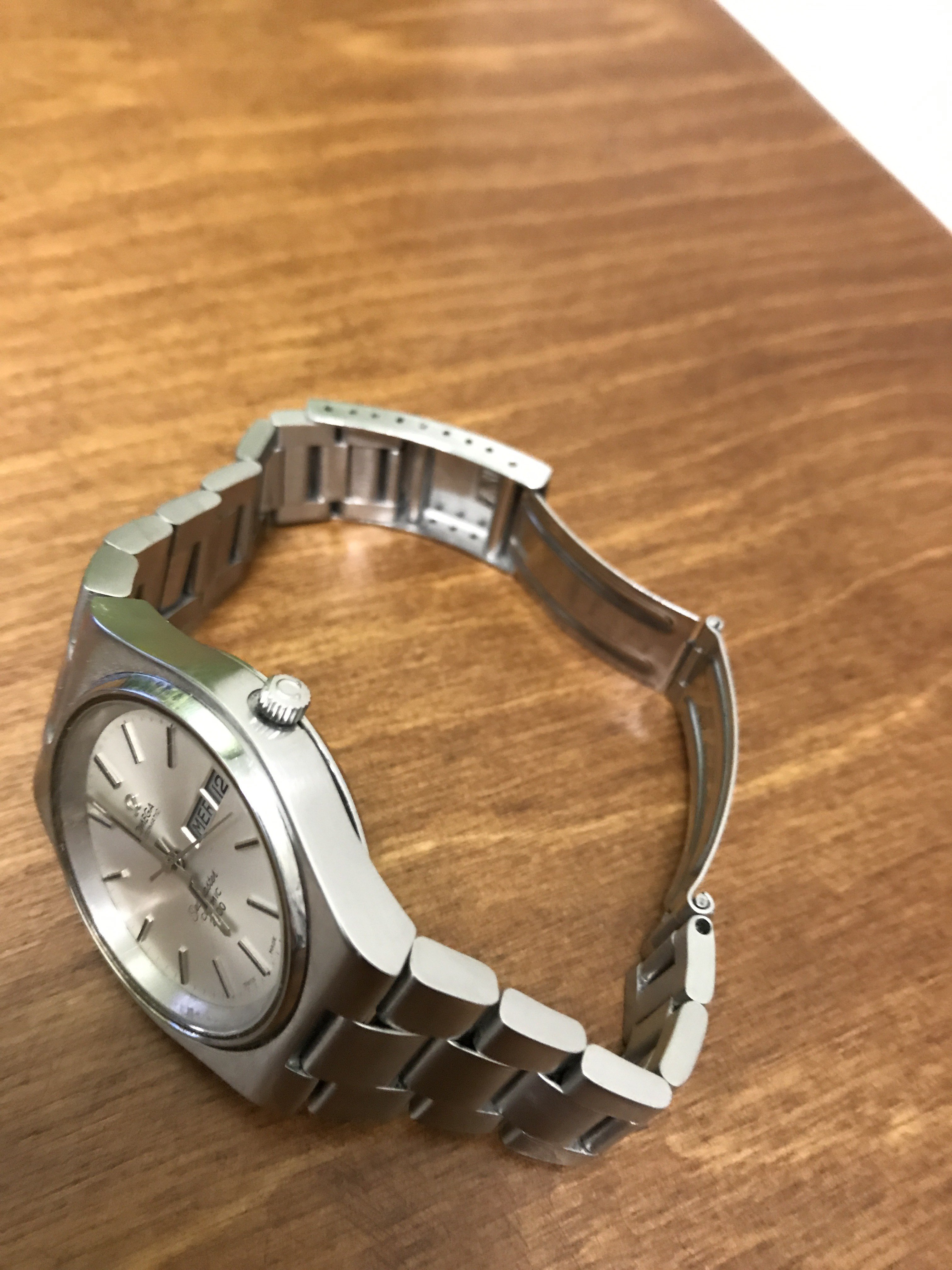

    Not an expert on but the dial looks a bit small, not sure if it's the photos. Chrono24 and Google images should shed light on this

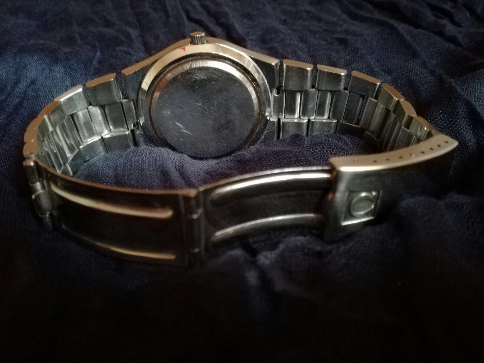

  3. eugeneandresson 'I used a hammer, a chisel, and my fingers' Apr 25, 2017
    5,001
    14,594

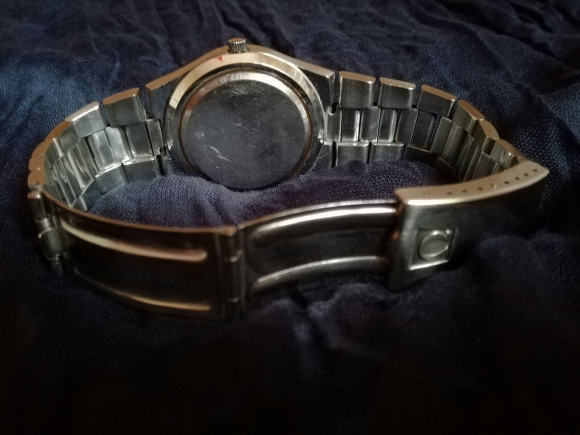

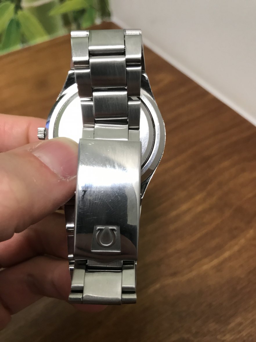

    Also not an expert, but your watch definitely looks polished/brushed -> the case and bracelet has lines in one direction, definitely not random scratches from wear...but I may be wrong.

  4. X350 XJR Vintage Omega Aficionado Apr 25, 2017
    12,586
    29,834

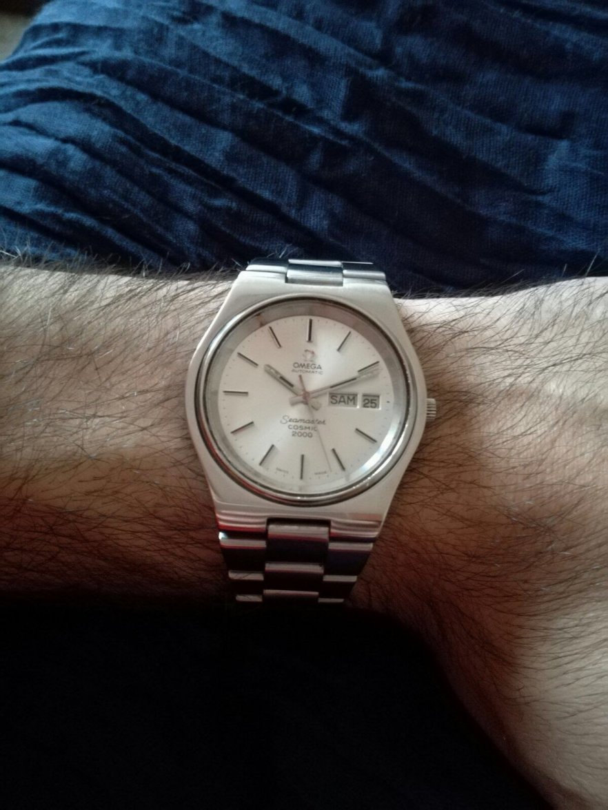

    Dial has been refinished.
    Note: the watch in OPs link is overpriced by at least 4X.

  6. X350 XJR Vintage Omega Aficionado Apr 25, 2017
    12,586
    29,834
    Yes, stripped of it's original finish and reprinted.
    Unfortunately you have overpaid, considering the the polished case and refinished dial.
    I would return it if possible as it has been misrepresented as being all original.

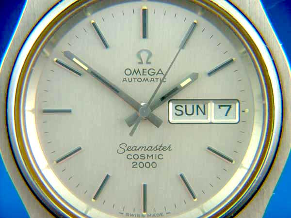

  7. Marins Apr 26, 2017
    21
    23
    Thanks for your opinion. Very appreciated!
    I find it striking how accurate this refinished dial is though. You can also find pictures of very similar watches online , like the one below:
    [​IMG]
    Are all those also refinished then?
    In any case, I think I will probably keep this watch anyway as despite all this, I do still like it.
  8. novina Apr 26, 2017
    350
    168

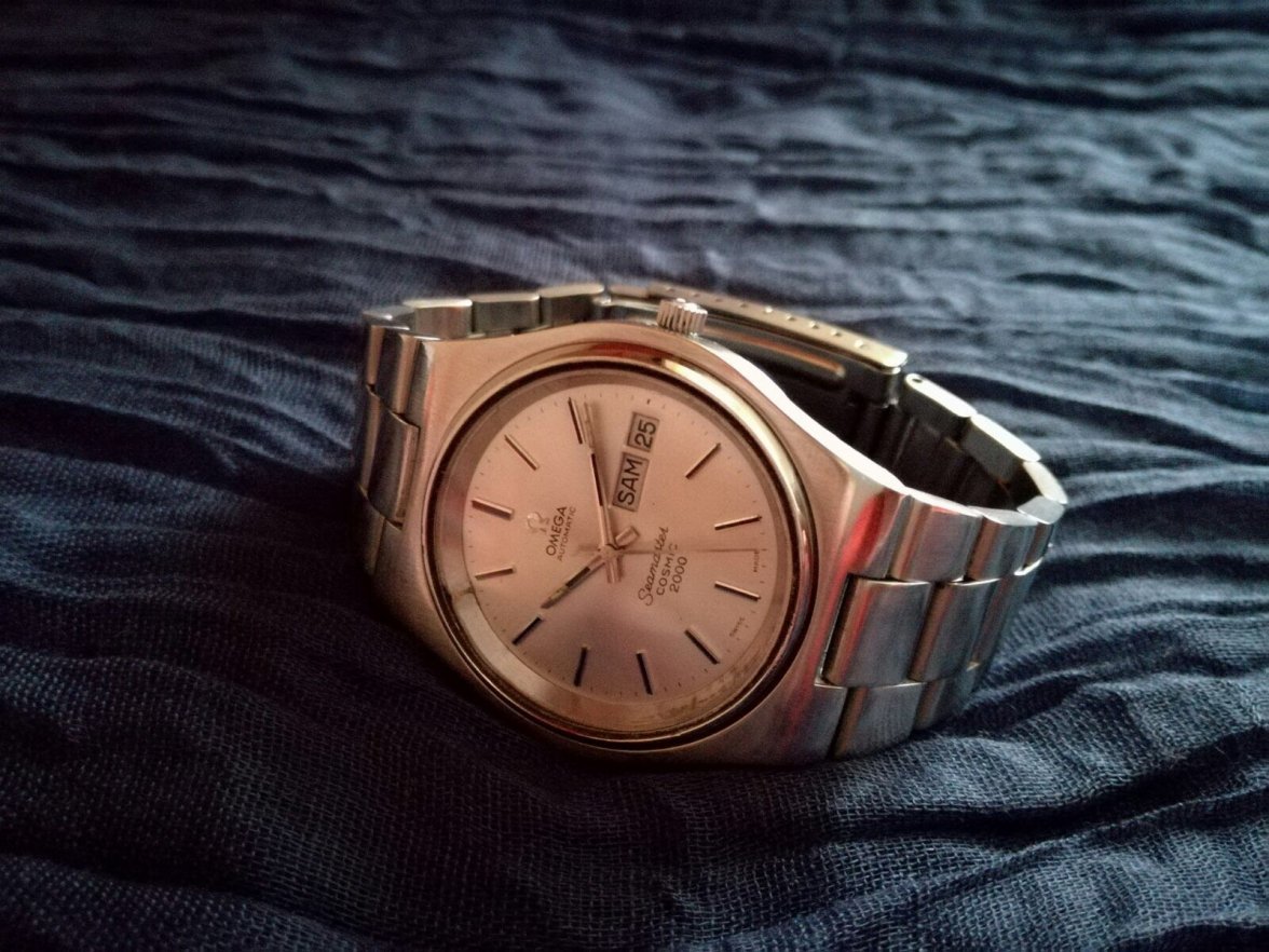

    You may be able to source a period correct dial for your watch. And while yours is similar to the last picture, please note that yours is missing a detail or two. First is the date window. Note the thin black outline. Second, the script on the "cosmic and 2000" appear to be too thick. That is why it is easier for the trained eye to spot a redial. Subtle text variations and missing added details often indicate a redial.

  12. JimInOz Melbourne Australia Apr 28, 2017
    15,476
    32,319
    Hi @Marins
    As you can see, most comments I would make have already been addressed. I would like to point out a couple of tips for you though.
    In the upper half of the dial, the whole word "OMEGA" should be centred below the Ω symbol, and because of font spacing (kerning) the letter "E" should be slightly off center, not directly below. If it exists, the word "AUTOMATIC" should also be spaced and centered properly, not to one side or the other.
    Down to the lower half of the dial. Omega in nearly all cases, space the model text between the tops of the 4 and 8 markers and down to the tops of the 5 and 8 markers, depending on the number of lines describing the model. On your example the word block is situated far too high.
    And as noted, the "SWISS MADE" appellation should be below the minute track, not above it on this watch.
    While your watch may not be "Collector Grade", it's a decent vintage Omega you can wear without fear of damaging a safe queen, and only nerds like us would know the problems but would either be too polite to mention them or would give you some "fatherly advice".
    Cheers
    Jim
