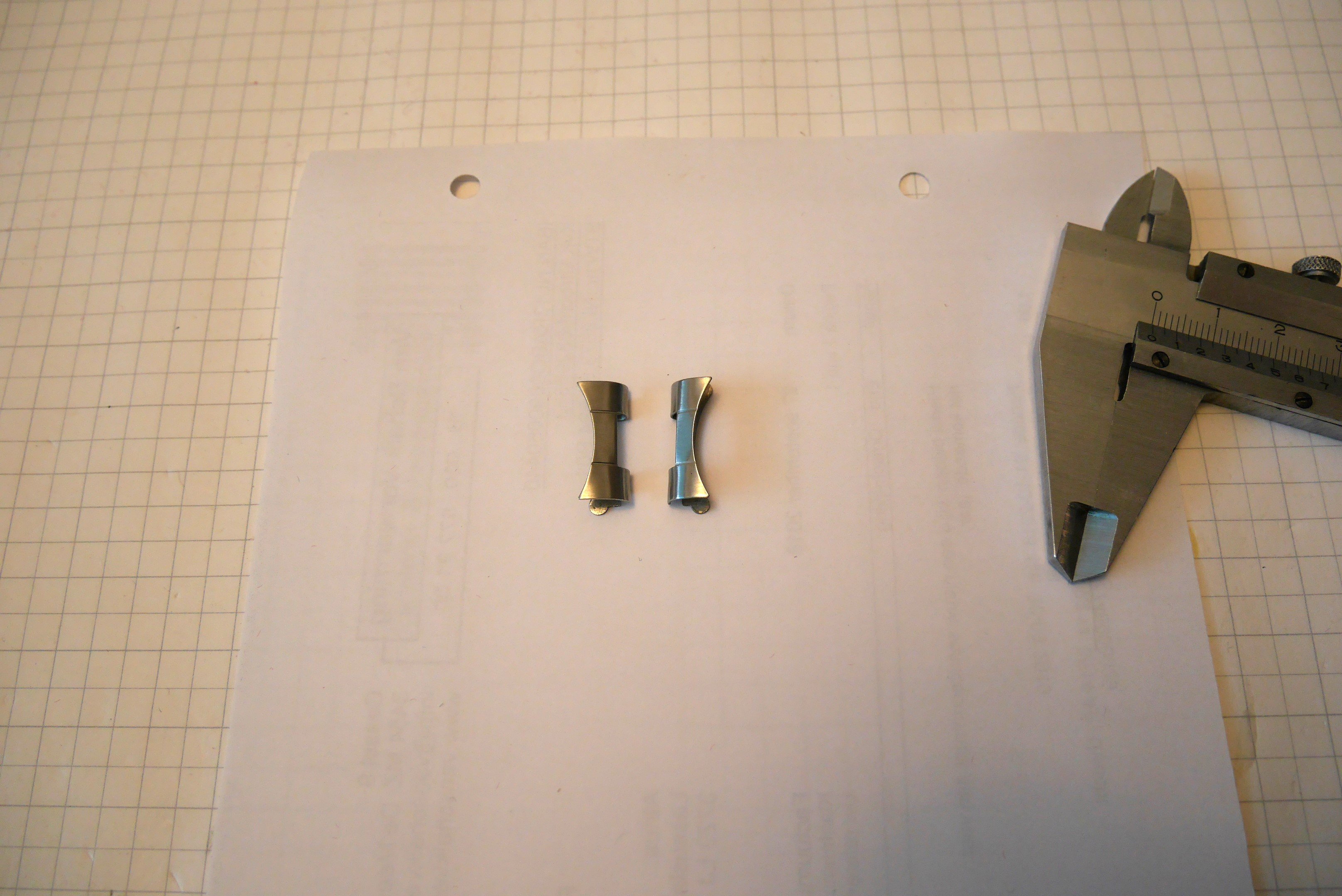

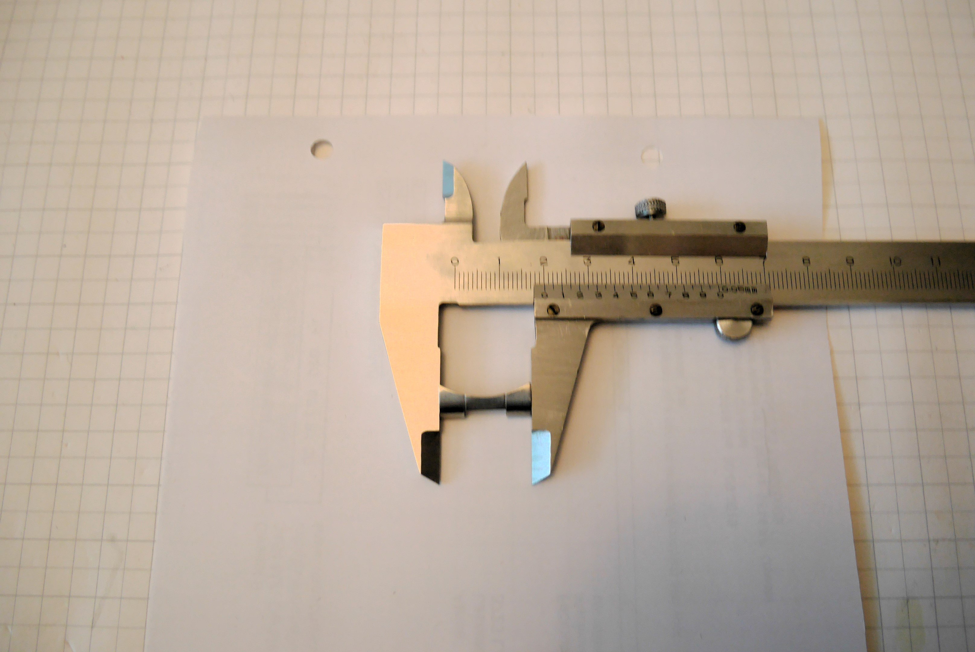

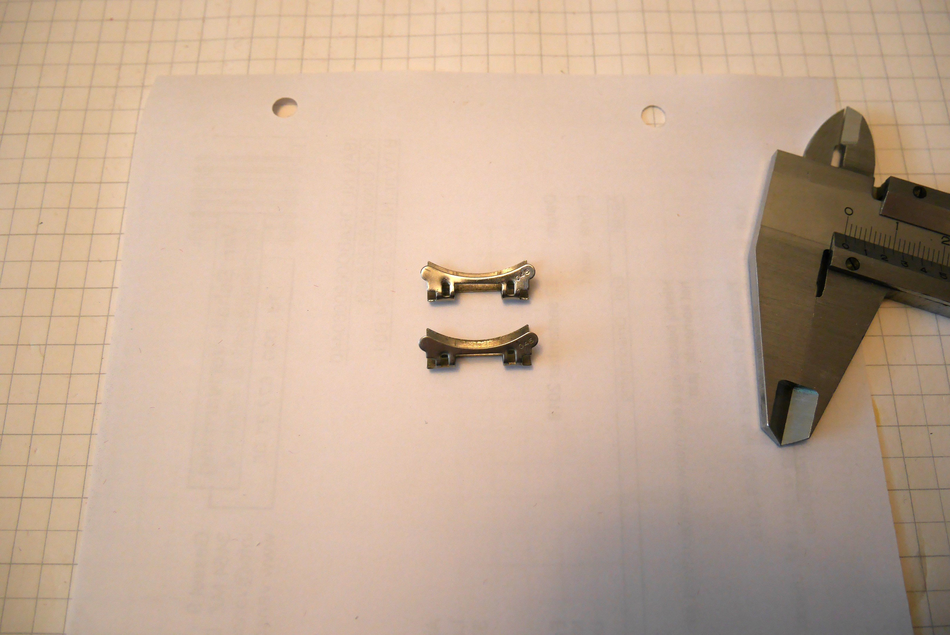

Hi OF,

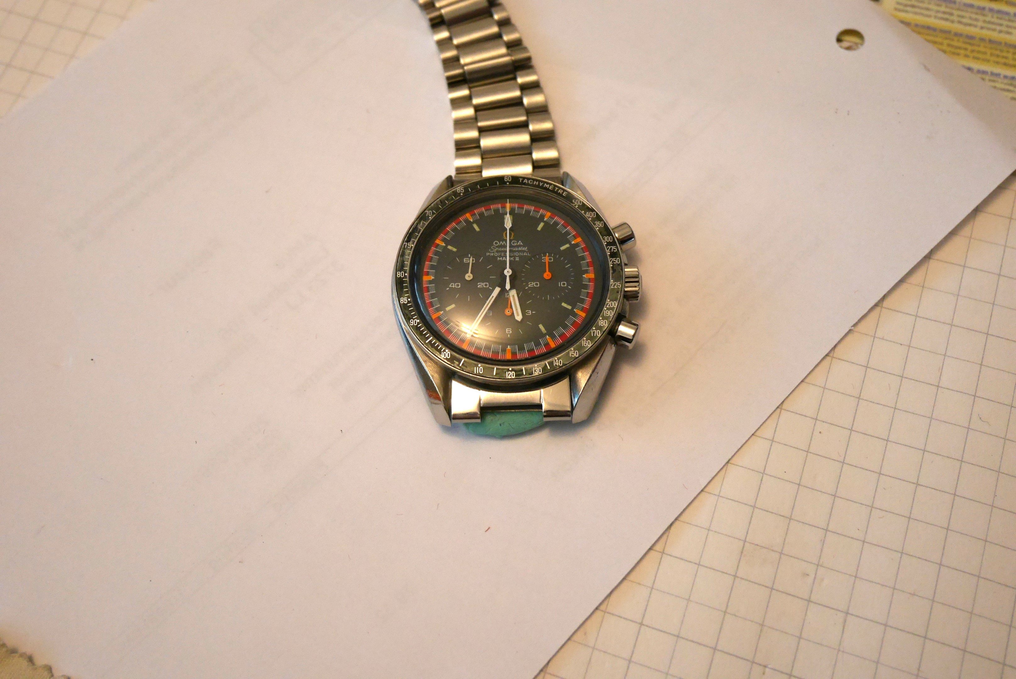

these came on a 1125 bracelet that should have 560 or 617 according to the list used here on OF. But i cant find anything about these 045. Very good fit on the 145.022 anyway

I would guess they are Japanese endlinks, so they would fit a model with .045 end - maybe 198.045

Thanks Kaplan, but what makes you think they are Japanese ?
I see Constellations for that reference indeed, but do they have a 20mm lug width ? And some Marine Chronometers which have very different bracelet styles.

Some smaller ones are 19mm and some larger ones are 20mm
When you see a 0 prefix it’s either Japanese or not Omega as far as I experienced

I see, thanks again 👍 , and a quick search with rolex added gave a matching result.
Blimey, dont want no rolex on my Speedy 🤦 no matter the surprising good fit.
