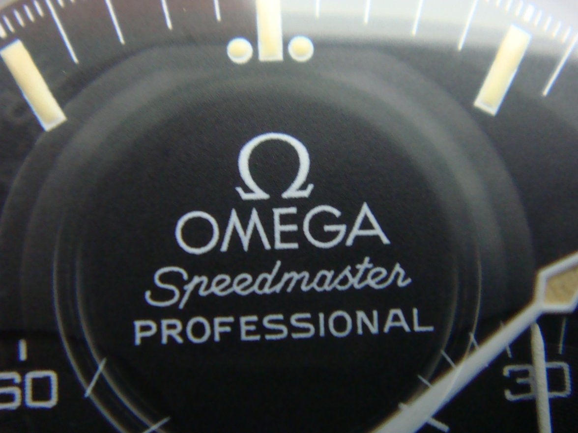

    Don't forget the 345.0808, they came in a numbered (2000 pieces) & an unnumbered release. DSC00785.JPG DSC00786.JPG DSC00789.JPG DSC00790.JPG DSC00792.JPG DSC00794.JPG
    Camboselecta likes this.
