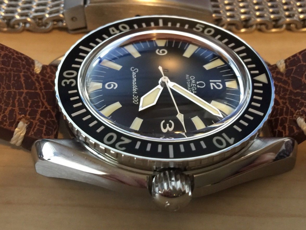

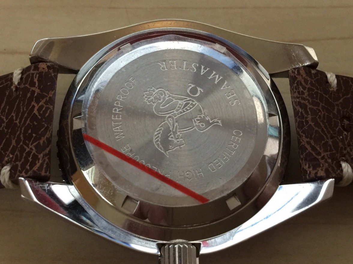

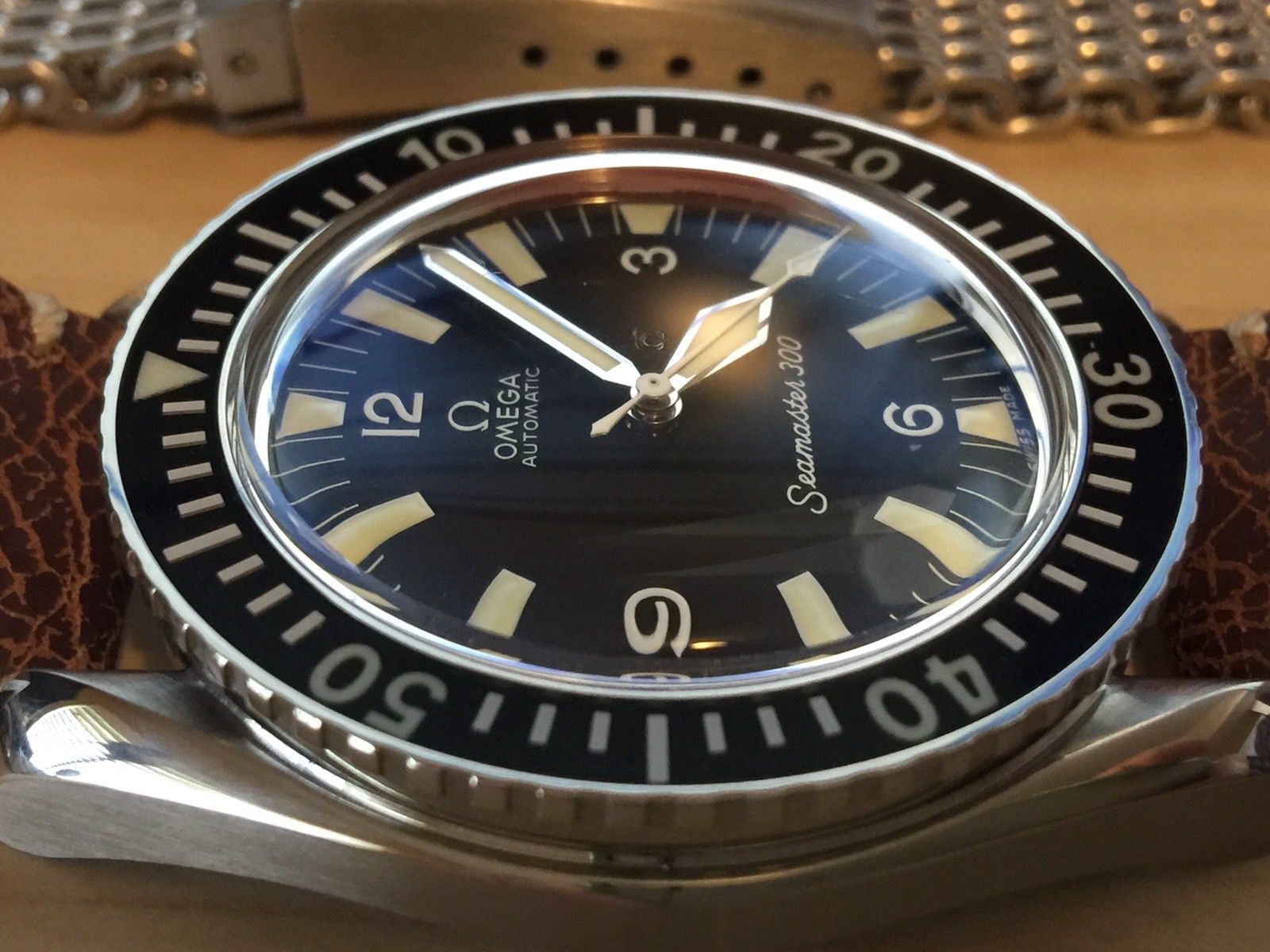

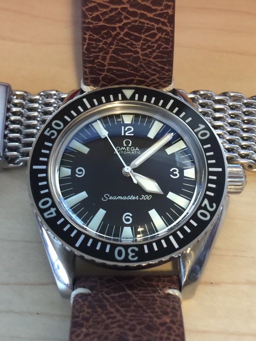

    I am going to try an make an offer on this one. It looks OK to me but if anyone sees something I missed
    No movement shots yet

    Is it me or do the lower lugs look non sharp?
    Movement shots are important on these. Some "watchco" use poor and ot unserviced movements Watchco ones should have paperwork.

    Is there any proof on who made it? Watchco generally did full services on good movements, other people that made "watchco" sometimes had junk or unserviced movements.

    Thought the same thing on the picture as well - looks heavily polished, considering this should be basically a new case.

    bottoms of the lugs look scratched, not good if it's supposed to be a new replacement case.
