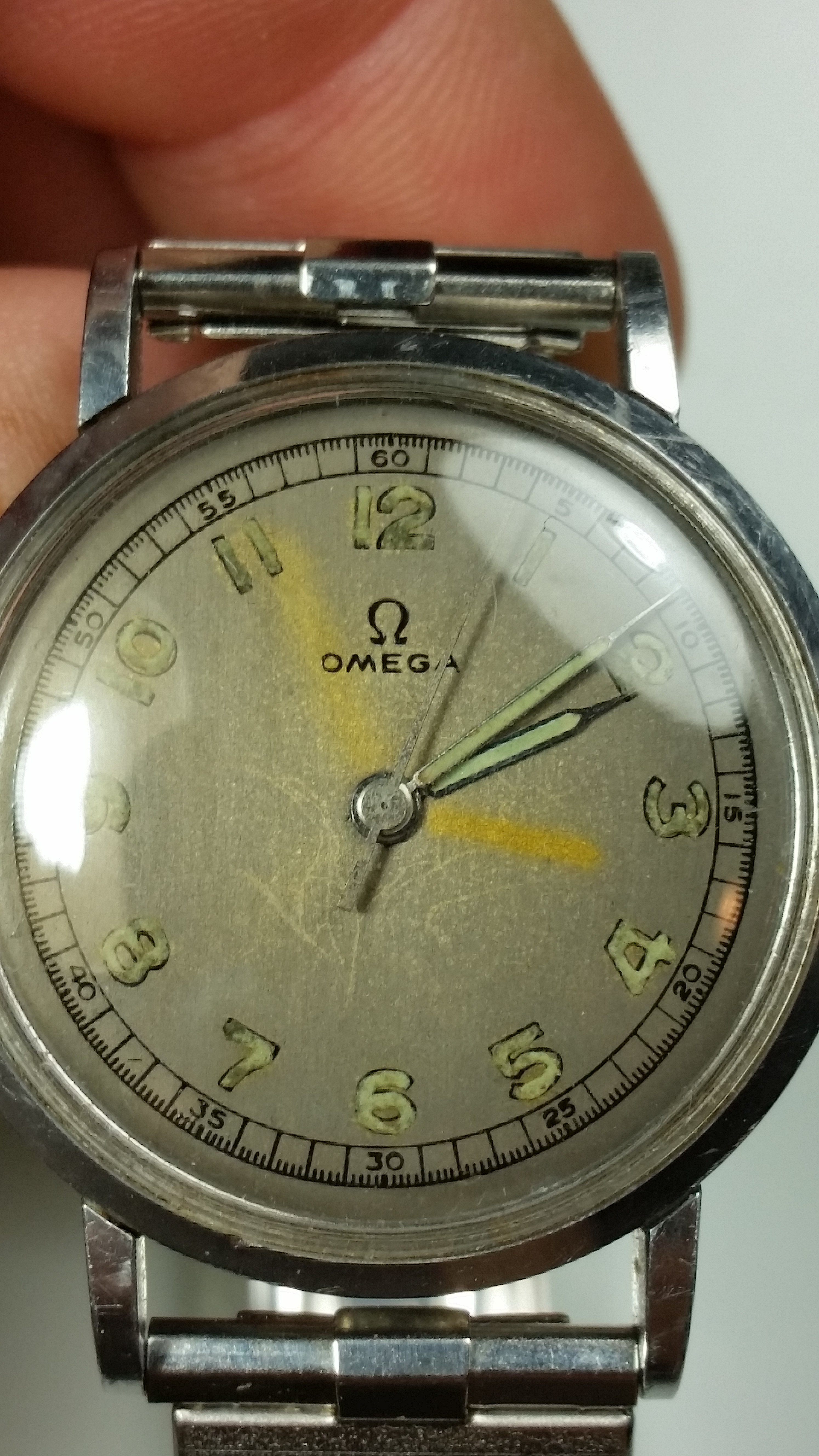

Thank you
13
Your watch might resemble the watches you've referenced (by the way, I do respect you doing your own research), you must understand that the devil is in the details.
The font of your watch is all wrong. It's too fat and dark.
Compare:
Thanks , I see
13,628
18,979
Your watch may very well have one of the US Army dials, albeit a refinished one.
However, those watches (Ref. 2179 or 2384) did not come with the higher grade RG movements. So I think that your dial was replaced at some point. The hands are correct for the Ref. 2179.
The Chronometre case was either Ref. 2363 or 2364 depending on the size.
I know a little bit about the US Army watches as I own one with a nice original dial:
You can see how the radium is painted within the lines and us not "puffy". The minutes track looks distorted as I do not have the proper type of crystal on there.
The "pock marks" are from radium exposure over a long period of time. The lacquer cracks and moisture gets to the dial paint.
Hope this helps.

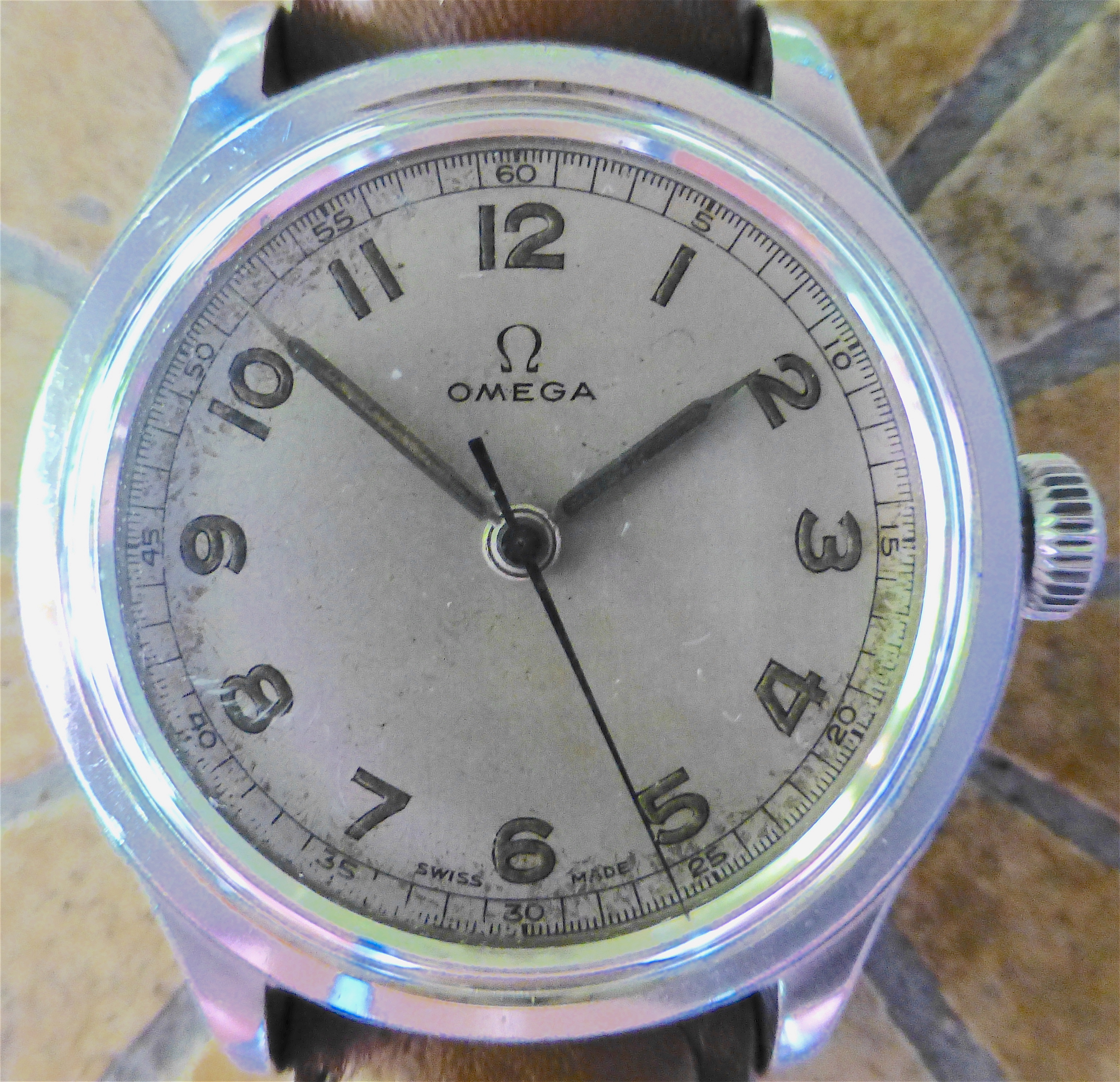

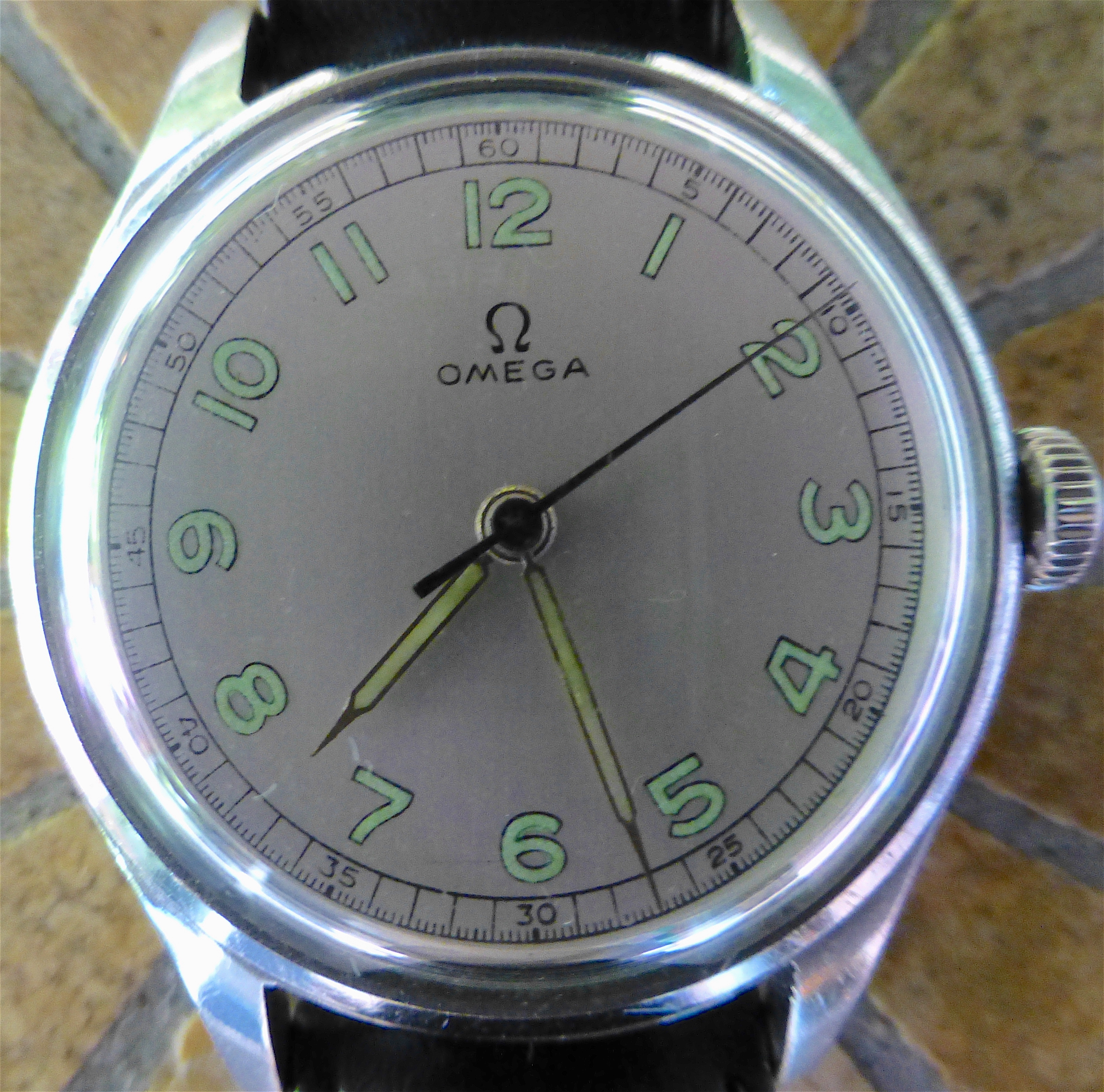

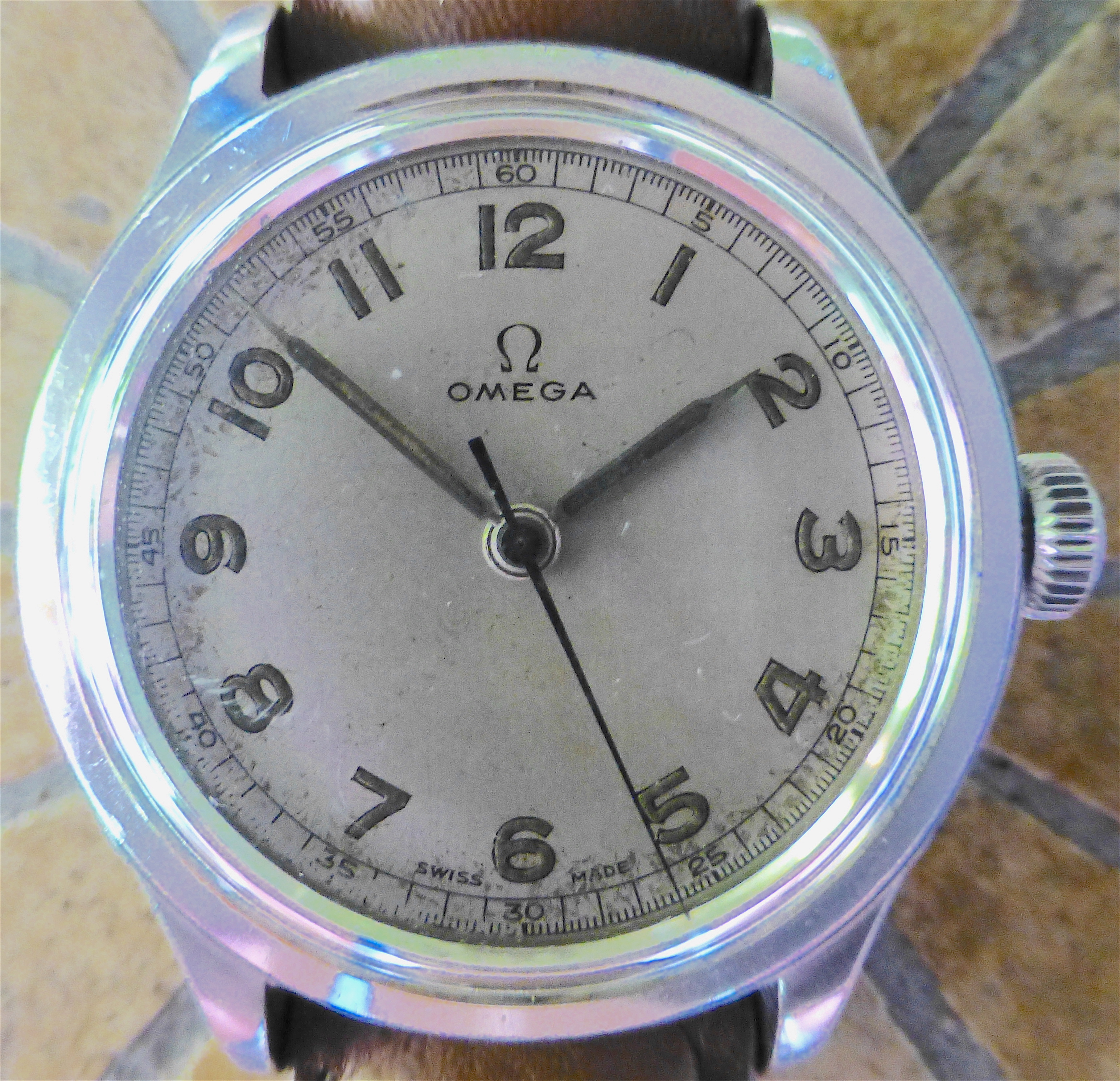

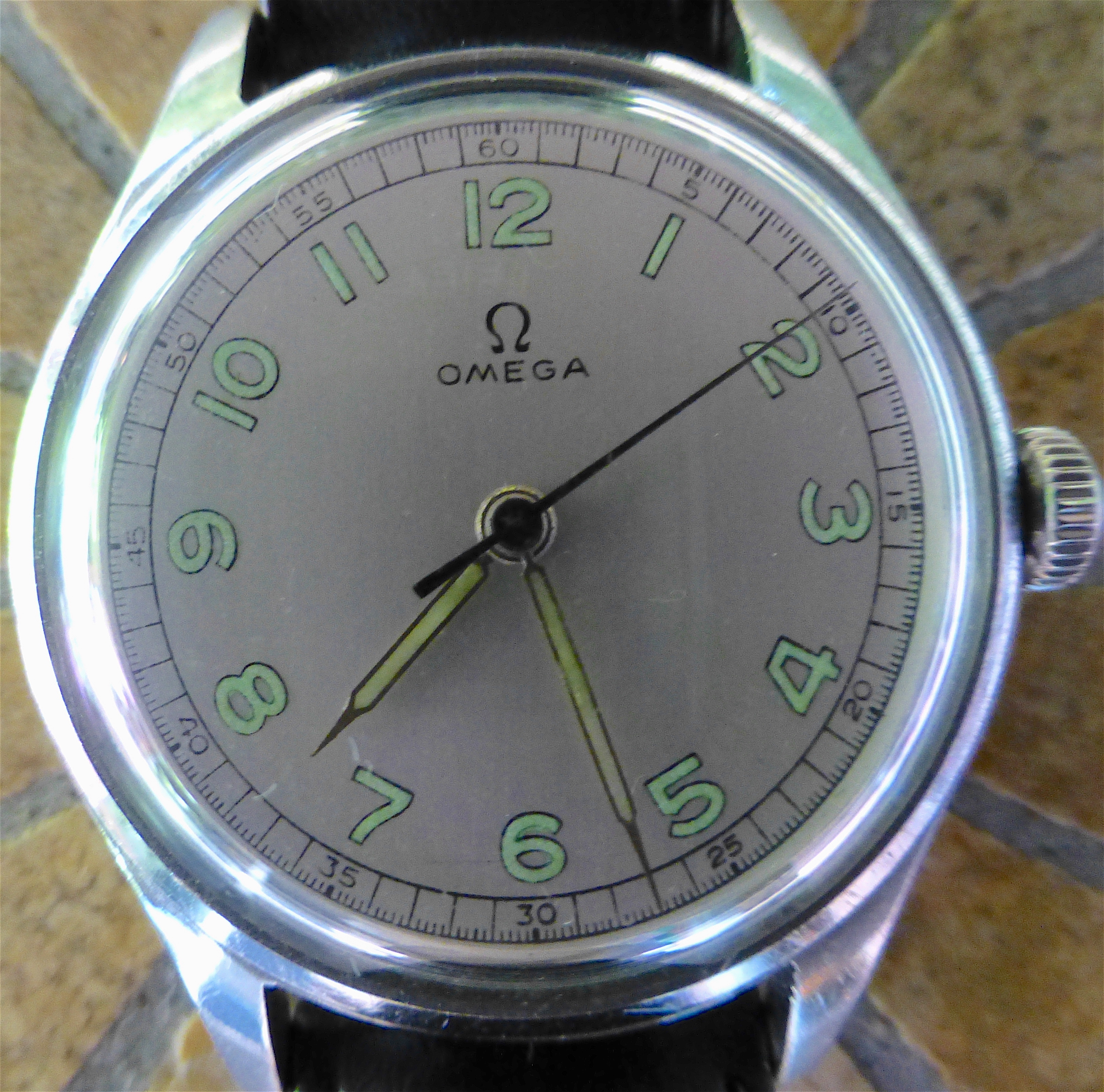

On the subject of the dial.
The only way to be sure is to post a decent close-up of the dial in as high a resolution as you can manage. Take the shot/s in filtered natural daylight.
I've shown two of mine as examples.
Here's an original dial, although a bit degraded. Note the sharpness and regularity of all markings.
And here's one that has been "washed" and the markings re-applied. Not the smudgy minute markers (at about 20) compared to the original, also the Swiss Made has been removed. The radium lume has been replaced as well, as radium would not glow as brightly as this after 70 years.

Mine has many lacquer cracks. You understand what I'm talking about. OK so it's possible that it is military dial, refaced. I'm leaning towards the case being military as well which would mean they swapped in the RG movement. The reason I believe this , the border ring between the case and movement are not in the chronometre dialed watches. Thoughts?
Hhgg
514
564
I'm no expert on dials, but it looks more like it has been displayed in a very bright place for a very long time and not used. I think the marks are probably caused by the hands having shielded the light from the dial, and the golden colour is what the whole dial should be.
16,900
48,108

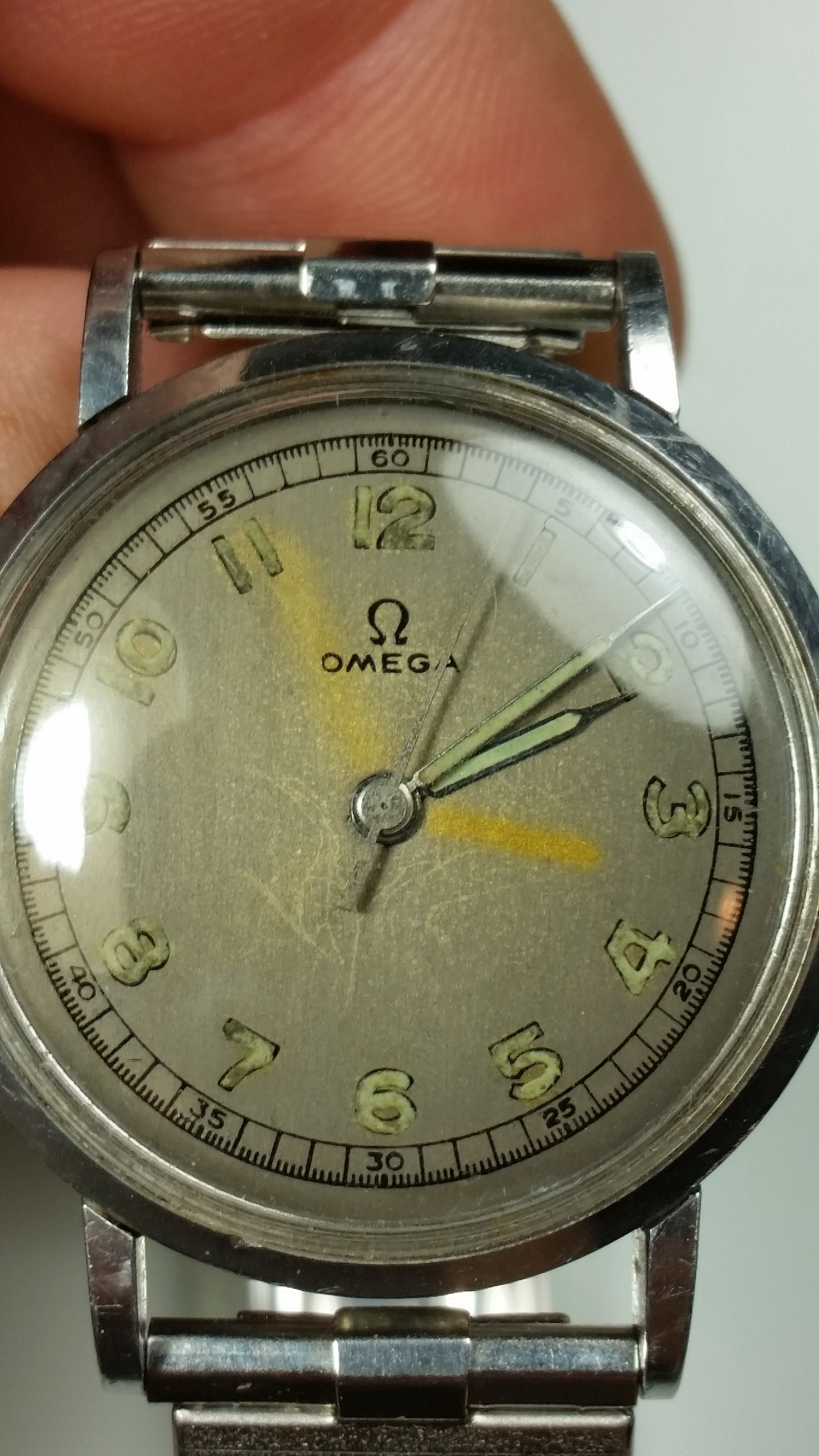

The best lighting I have at the moment
Easy for me who has only looked at this thread to see you have a redial. Same watch as bought new probably ( not getting into movement as I don't know enough) but may have been redialled 45 years ago. I get this from the omega that is not as neat as @JimInOz example and the minute markings. May be military but a redial. We all question but as said before you have come to some of the most knowledgeable omega collectors around.
No matter what you post or think from now on it will never change from a redial. May be a military watch or case as other will give advice.
@Geo! hand marks are from the radium hands sitting in one place for years and burning the dial
514
564
Thanks for clarifying. 😀

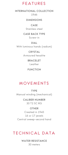

I wonder about some of the "expert´s" comments here - no offense intended!
I do not want to show off with my knowledge about this kind of stuff but I have dedicated more than 25 years in studying and collecting these 30mm chronometers and I think I know what I am talking about.
1) The case and movement are correct for a Ref. 2410 chronometer with screw down case back - however the winding crown is a wrong replacement. Hands are correct except the second hand which should be blued steel.
This reference was not a military issued one - it was more some kind of a "scientific watch"
2) the spacer ring between the movement and case band is an absolute necessity to hold the movement in place, to prevent it from "floating around" and center the dial. This spacer ring is used on many of the early screw back SS Omega cases and it does not matter at all if it is a military case ref. or not! This spacer ring is not present with gold cases as the movement comes out from the front after removing the bezel and the movement holding screws.
With the SS screw back cases it is different: the movement comes out from the back - hence no movement holding screws and the necessity of the spacer to hold and position the movement/dial combo.
3) The dial:
a) it could be the original dial plate which was restored in the wrong way omitting the "chronometre" in the branding.
b) it is a replacement dial from let us say Ref. 2179 or 2384 which was redone also (does not matter if it derived from a military issued or civilian version of these refs. as they shared the same dials.
As it is a dial in redone condition nobody will be able to tell the origin - I can only tell it is a redone dial.
The presence or absence of "SWISS" or "SWISS MADE" on the dial is no indication whether the dial is original or not - nor any hint whether it was for military or civilian use. In that era sometimes the swiss marking was used and sometimes not - seems to be random use, I have not found any logic pattern yet.
My final assessment:
The watch is an uncommon reference (not really rare hence I say uncommon) and coveted by collectors if it is all original - and this includes an original unmolested/unrestored dial. The original dial represents about 40-50% of the value on these watches.
So you have to deduct about half of the value...
The condition of the movement is decent, not really outstanding or near mint.
A mediocre example.
I realized that you have listed the watch on ebay with a pretty much "fantastic" description to say the least (I do not want to call it deceptive as I assume you lack the knowledge to give a proper description) and your price expectation is somewhat very "optimistic".
Maybe my comments here help you to "update" your item description to the truth...
kind regards

From what I see, the dial was refinished and the radium burn is faked.
Look at the hour hand radium burn, it says 3.25 but the minute hand is at 55 already.
Do we set the hands that way?
