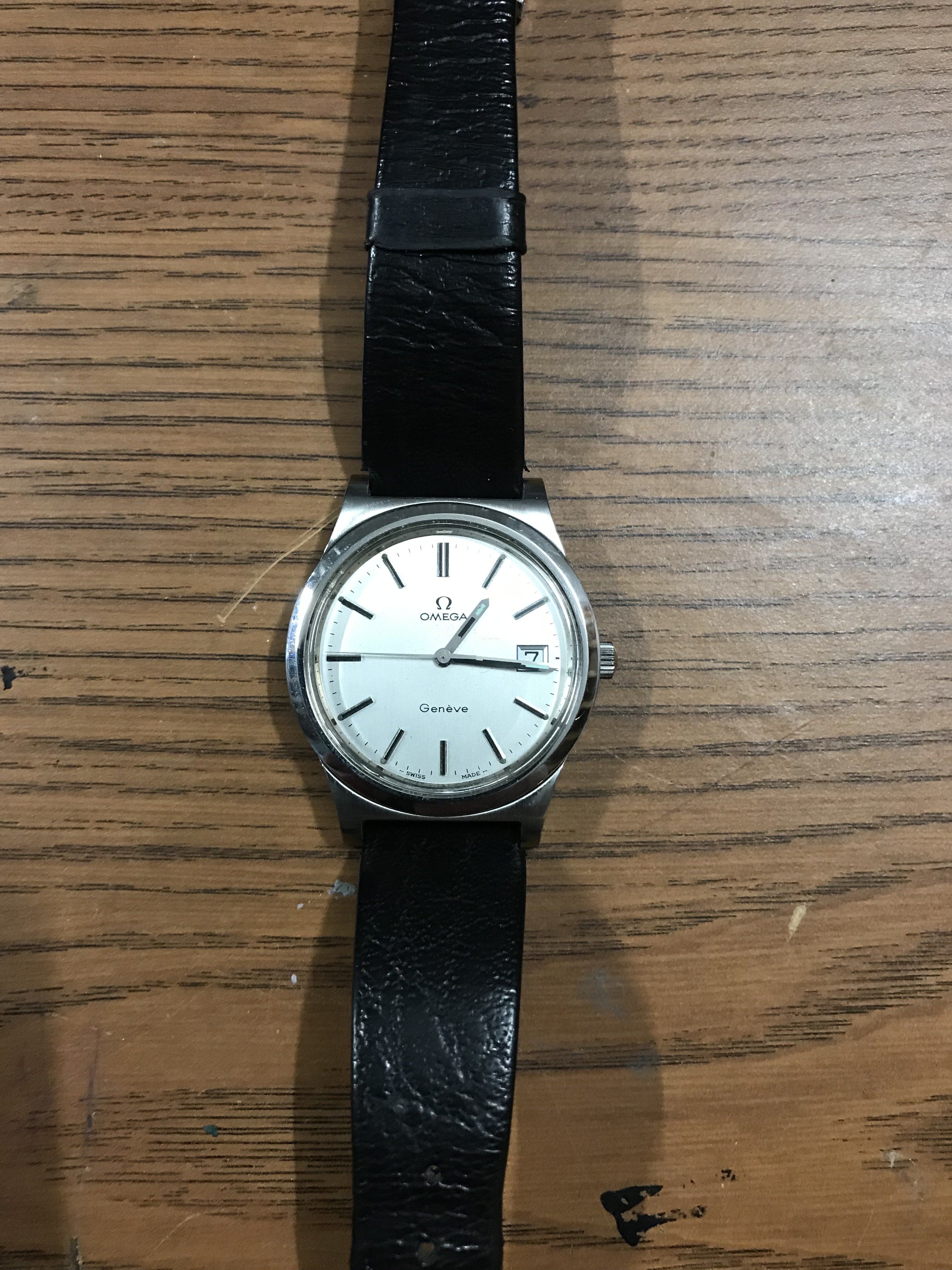

Hi,
My Dad left me his Omega watch when he died in 1990. The manufacture date is probably around 1980.
The strap is broken and it's not even an Omega strap. It would be nice to get an Omega metal bracelet to match.
Can someone tell me what type of watch this is so that I know what type of bracelet or strap to get?
Many Thanks!

The number in the caseback will let us know if Omega ever offered a bracelet for that watch.
As for straps, Omega has some nice ones but they're pretty darn expensive. Many of us get a good quality strap from other makers such as Hirsch or Hadley-Roma and add an Omega buckle. So that might be something worth thinking about.
You might be thinking of buying a strap on eBay; be aware a lot of those are fake.

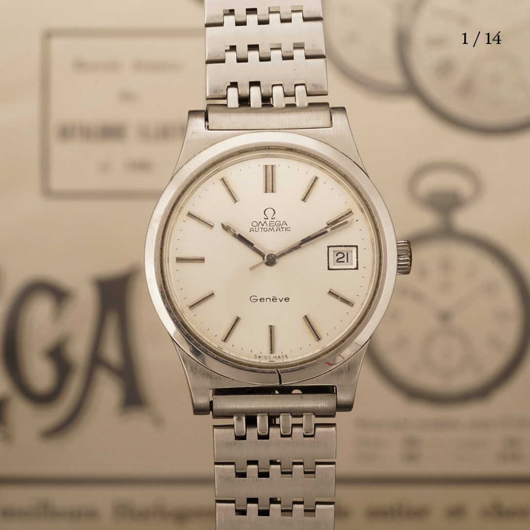

The case looks similar to a ref 166.0168 from the 70鈥檚. This ref is an automatic. Found one with a 1193 bracelet attached to it with 568 straight end links. No idea if it was originally for this specific reference.
Nevermind the refurbished case, it was the best i could find馃槣

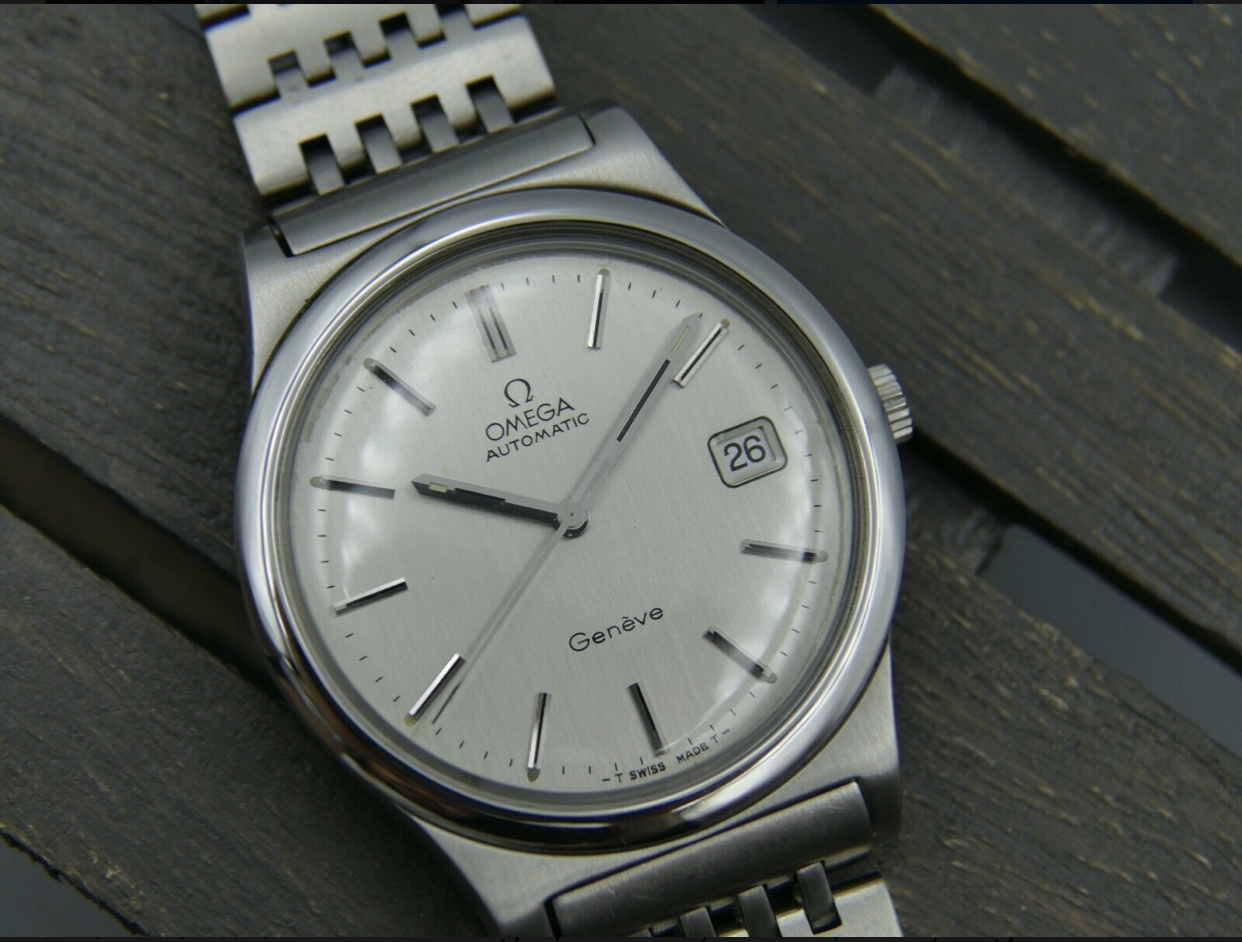

And here is another one from a finished ebay listing. It has a 1193 bracelet as well.
I verify that bracelet appears on the list for the specified reference.

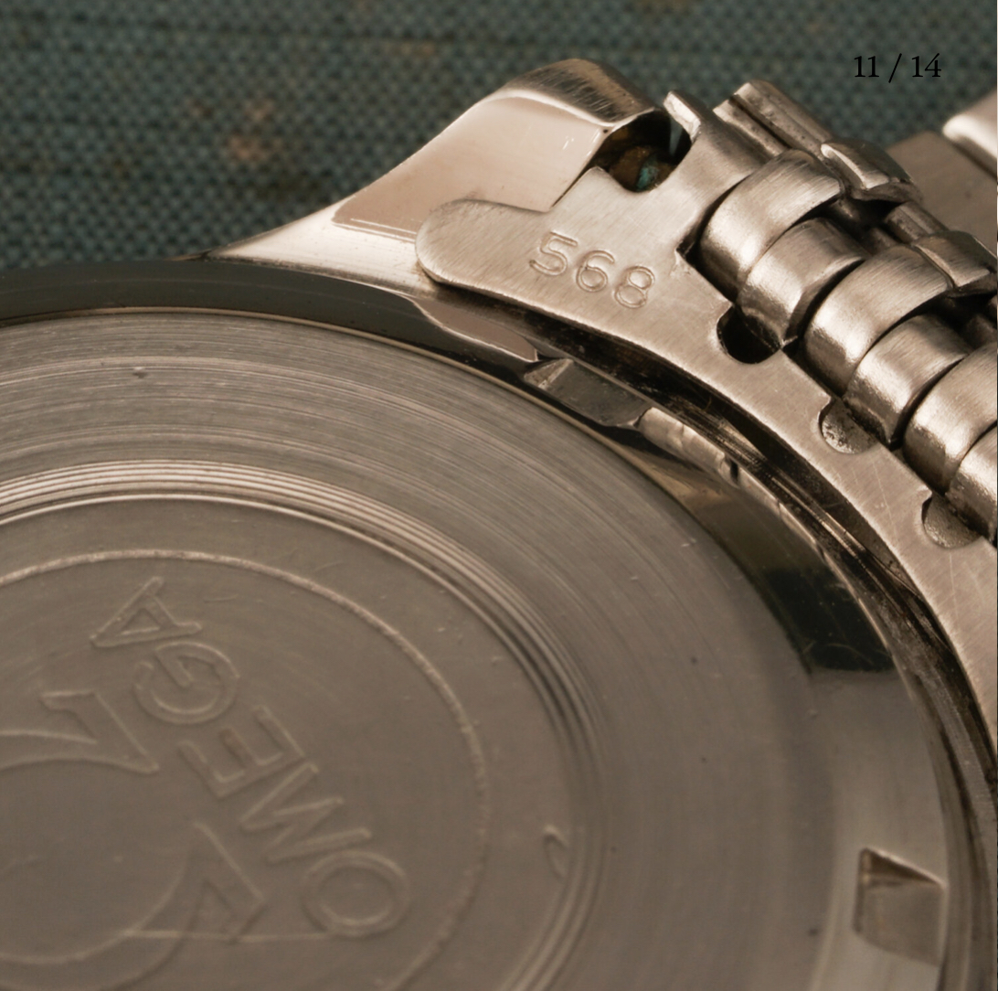

1193/568. First number identifies the bracelet and the second number identifies the end links. You need both.
