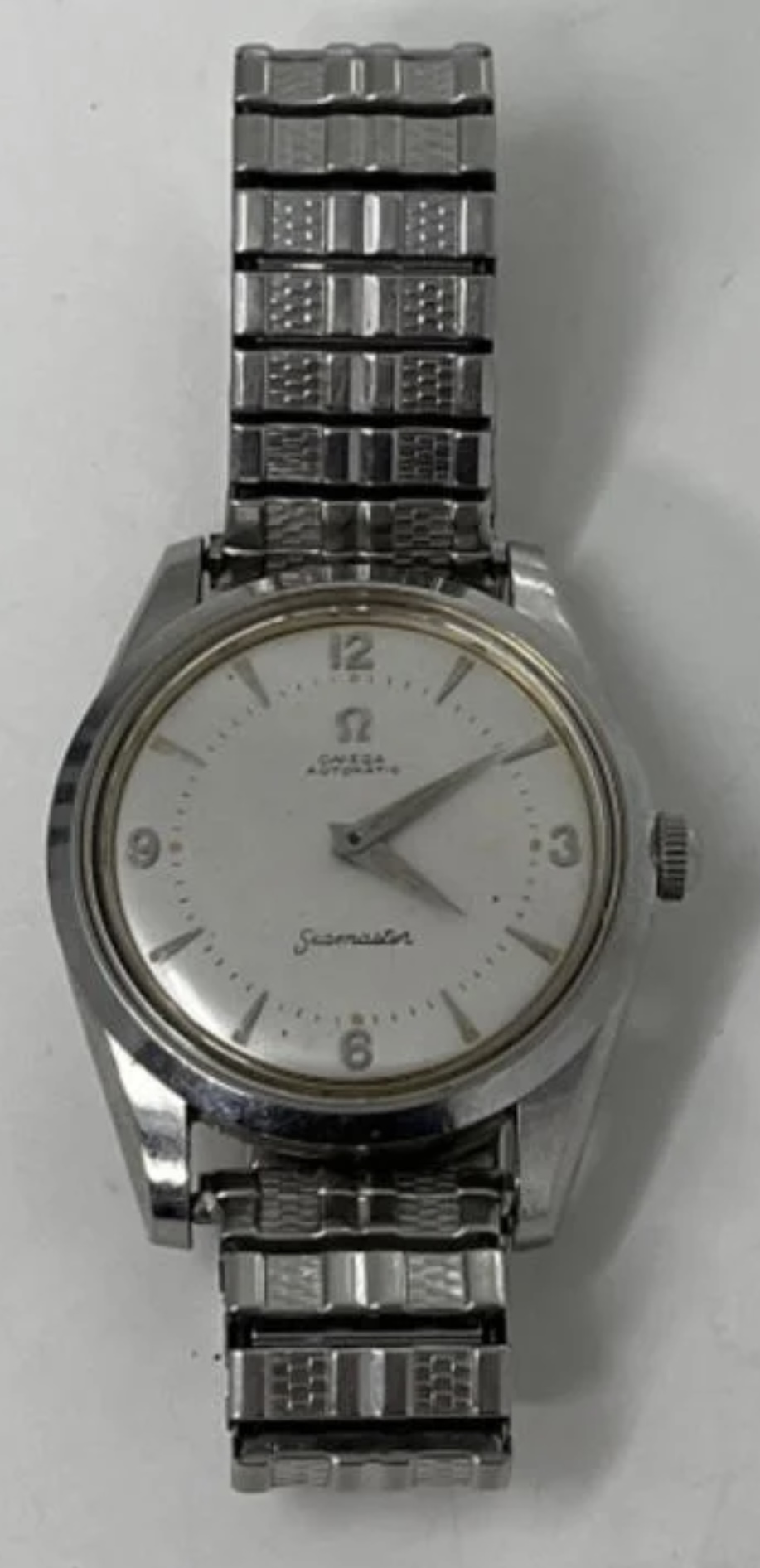

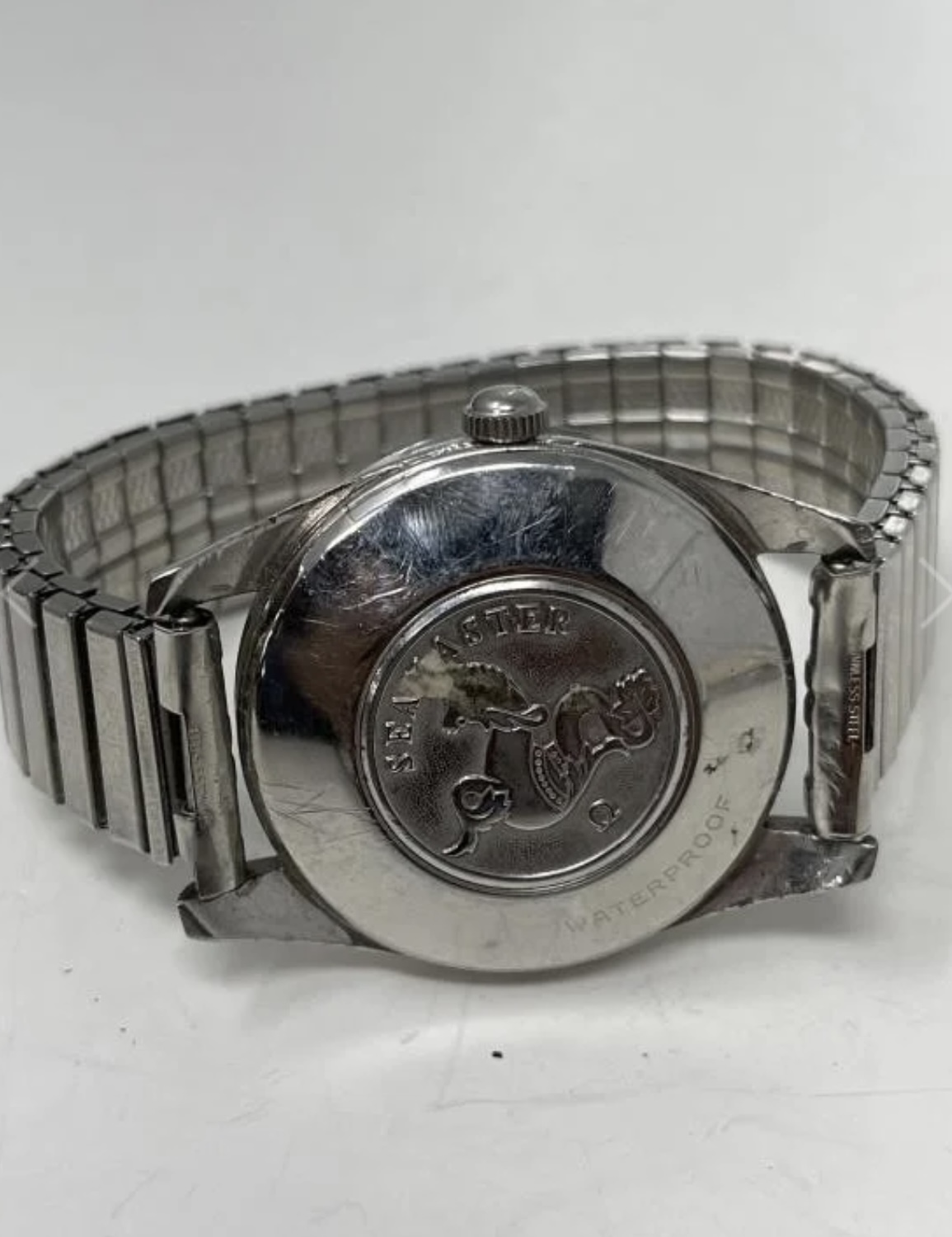

Hey everyone I need some help with an ID on this Vintage Seamaster. Also, is it authentic and has it been redialed, if so how could you tell? Thanks.
5
PS. I know it’s missing the second hand, does that drop a lot of value?

I'd say the redial dropped the value more than the missing seconds hand.
Based on the quality of the photos I'd say the watch is genuine.

Also, beware of the missing second hand as it's a fairly common ploy by slippery sellers to mask more serious problems like a bad gear.

Interesting strategy 😁 But yeah, +1 for redial, and not a good one. Otherwise it wouldn’t have been apparent with the bad pictures…

Dear Omega collectors ! My name is....insert here. I'm unsure due to my internet searches, if this Dial is original or not. .....insert your opinion here. I'm from.... Can I please have your educated opinion ? Thank you you for your time and help. Kind regards. ..... Insert your name here..... Manners matter. And: Bad redial, yes. Interesting , rare model ? No.

Thank you for your input, in your opinion what would the value be, I understand probably worthless to a collector but what about anybody else?

I watch for inexpensive Seamasters on eBay a bit, and from what I've seen, a redialed watch without a seconds hand would probably go for around 300 USD. If the movement is clean and you take clear picture, maybe a little more.

If you’re a newbie, a vintage Seamaster with a crappy redial and missing seconds hand isn’t how I’d recommend starting off.
The more you look at it and get to know the details of vintage watches, the more the redial will both you.
Plus you will likely have to spend considerable time and between $25-75 to get a seconds hand.
Much, much, much better to bin this one off and find a better example.
