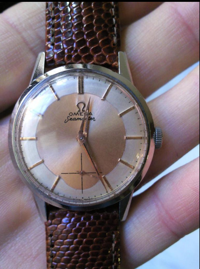

Hi, how are you? These are the following options of watches that I could buy, remember that the prices are in Argentine Pesos (20 pesos are 1 dollar) Which is the best for me in relation to quality price? I do not want a frankenwatch. 1)https://articulo.mercadolibre.com.ar/MLA-710726595-reloj-suizo-omega-de-hombre-enchapado-en-oro-_JM 2)https://articulo.mercadolibre.com.ar/MLA-694259993-reloj-omega-cuerda-manual-cal-601-_JM 3) https://articulo.mercadolibre.com.ar/MLA-712538560-omega-reloj-vintage-oro-y-acero-mika-pao-_JM (this isn't working) 4) https://articulo.mercadolibre.com.ar/MLA-677656039-urgente-reloj-omega-para-caballero-art-98-_JM 5) https://articulo.mercadolibre.com.ar/MLA-709601501-reloj-omega1963acerohombrecgarantiaimpeclble-_JM 6) https://articulo.mercadolibre.com.a...-pulsera-calibre-265-ref-2503-13-ano-1950-_JM 7)https://articulo.mercadolibre.com.a...f-131002-calibre-286-_JM#redirectedFromParent And this is one that it's like 120 dollars.: Thank you very much!

Both dials are refinished. I would recommend staying away from any watch from Argentina. I find sellers there less than honest. There are many fakes and watches put together from parts of other watches (we call these "frankenwatches"). gatorcpa
That watch is a fake, or at least a very poor refinished dial. We have a thread titled “don’t fall for a fake vintage Omega” you should read.
But 150 dollars with a real machine, real crown, with good aesthetic and a redial it's a nice price right? I'm in Argentina, it's difficult to import watches from USA.
Of the 7 watches you posted, not a single one has an original dial. You would do much better on eBay, believe it or not. Like I said, there is nothing but trouble in Argentina when it comes to vintage watches. gatorcpa
You need to do some reading and learn about vintage Omegas. May I get you started with these treads from the forum: https://omegaforums.net/threads/learn-how-to-fish.52603/ https://omegaforums.net/threads/worst-redials.2304/ https://omegaforums.net/threads/don...omegas-post-them-here-not-for-questions.6235/
