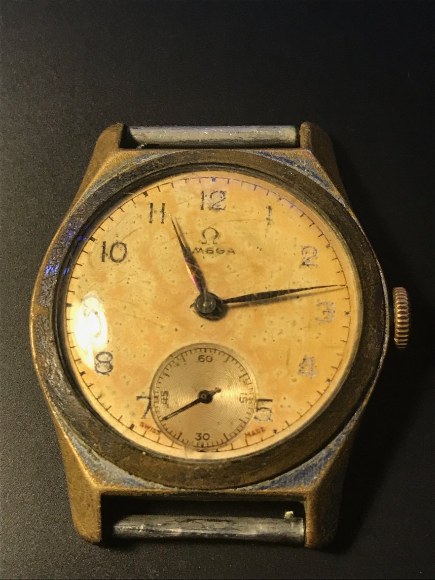

    I'm a newly here and looking for advice and hoping you guys could help.

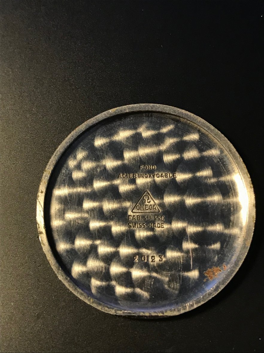

    I have this old Omega watch, that's pretty beat up, inside the case it has the serial number 9744497. I know nothing else about it, other than it runs smooth as silk and keeps perfect time. The back of the case is smooth, no engraving. The pictures make it look worse than it is.
    Any help identifying it would be gratefully received.
    Thanks in advance for any help.
    Gareth

    Wow gosh guys, I wasn't expecting a reply so quickly.
    I see what you mean about stainless steel, mine doesn't look stainless in anyway unless it's a coating which has been warn away to a brass like quality.
    Also the writing on the case looks different, on my one it looks a lot smaller, more delicate. Could it just be some of it has faded over time.
    Cheers guys.
    Also do you know what sort of strap it would have had?
    Gareth

    If you look at the text in the back it says "Fond Acier Inoxydable" - the "Fond" refers to the caseback, meaning that that particular part is in stainless steel (Acier Inoxydable). It is also found on watches with gold plating, for instance. The rest of the case is some sort of base metal (could well be brass), which has been surface treated.

    Do people get watches like this redone, new faces and improved cases, or replacement cases. I'd love to see it looking like new, but don't want to destroy something aged and possibly valuable.

    Possibly a nickel plated brass case which wasn't unusual at the time.
    I think it's an attractive watch, if a little bit worn out.
    A movement service and a tidy up (NO POLISHING) and it would be OK to wear.

    While the movement may be "crisp", it's obviously in need of servicing, so that is your first objective.
    The case has been worn to the point where all surface finish has been reduced by time and wear, just like us all.
    If it was mine I'd get the movement serviced. The case gently washed in a neutral based dish wash liquid, the dial cleaned with a cobweb brush moistened in angel's tears, and a new crystal.
    Then I'd put it on a new leather strap with new spring bars and only wear it when riding my Ariel Red Hunter along quiet country roads on an Autumn evening.

    Well, everything has already been said : cal 26.5 SOB (probably T2), ref 2023 (the CK letters stand for stainless steel/staybrite case, so not applicable here, probably a ref MG2023, MG standing for nickel plated metal).

    Even if the movement is working perfectly now, all its lubricants are long gone. It will wear out sooner rather than later if you do not give it a preventive service.
