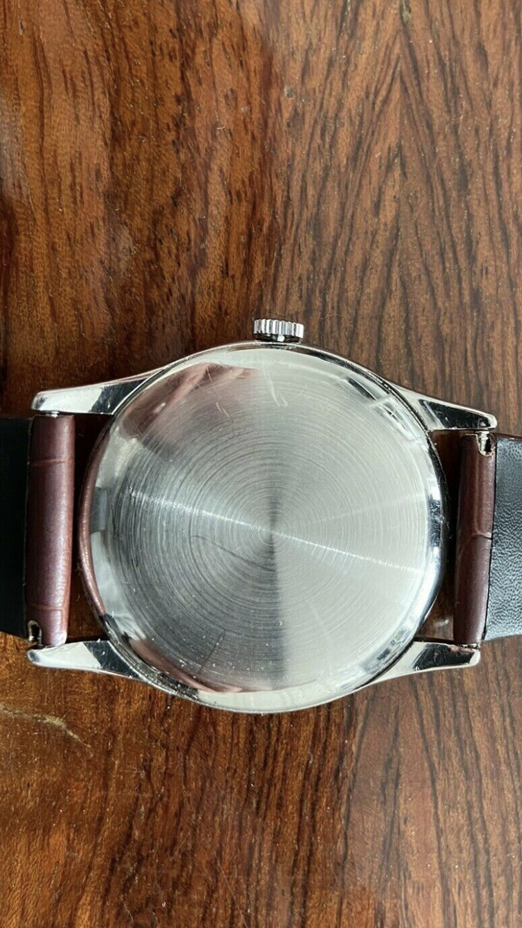

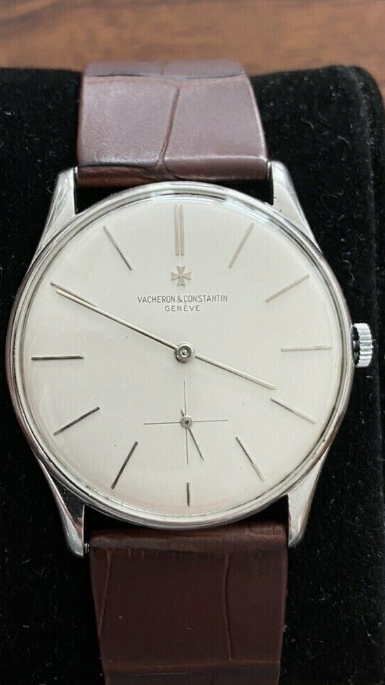

Hello everyone,
can anyone confirm from these unfortunately relatively bad pictures whether this Vacheron i found online may be original? I can't seem to find a similar model online and the "swiss" at 6 seems to be missing.
"swiss" seems to be missing, lettering seems fine to me (as a VC noob)
completely blank caseback on the outside

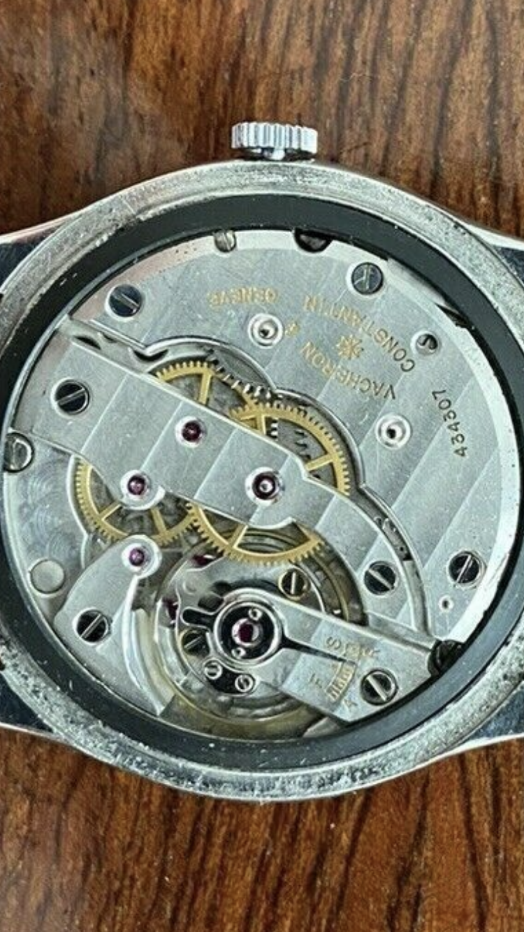

To me, the caliber seems to be missing some inscriptions (no. of jewels etc.) but i found a similar one online. Also, plastic caliber holder?

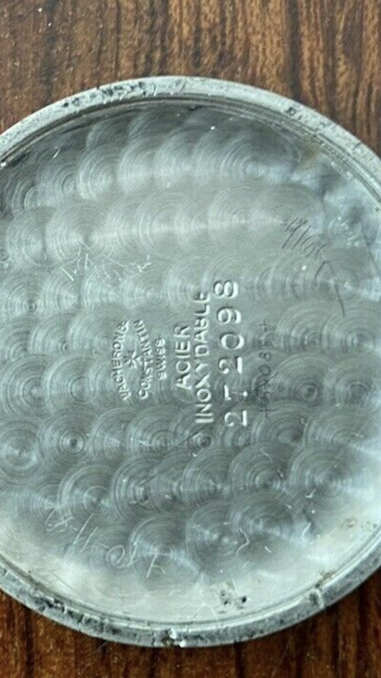

You can see some watchmakers' marks on the inside of the caseback.

I know nothing about these, but the case seems heavily polished, and there is a lot of pitting on the “rims”. It looks tarted up for sale
897
3,717
I found the ebay ad for this watch but the pictures unfortunately are not any better making it very difficult to evaluate the originality of this piece. It’s a frankenwatch. If movement is indeed from VC, which I don’t believe to be the case, it’s from 1935-1940. The dial is from later.

The movement is supposed to be a V453, but it is missing a ton of what should be there...

A high grade company as VC would never use a plastic caliber holder...
While I understand the reasoning behind this sentiment, I don't believe this is a reliable indicator of a watch being genuine. Case in point, this is a very genuine Patek Philippe that I serviced a while back:
The movement spacer was made of plastic...
So based on the spacer alone, I would not make a judgement...
Having said that, the vintage VC's I've serviced have metal spacers.
