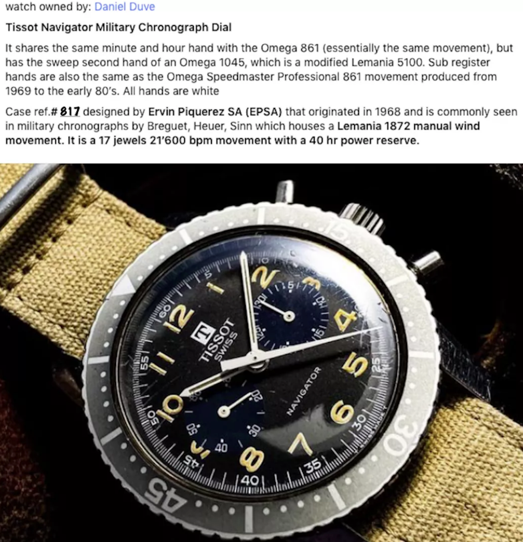

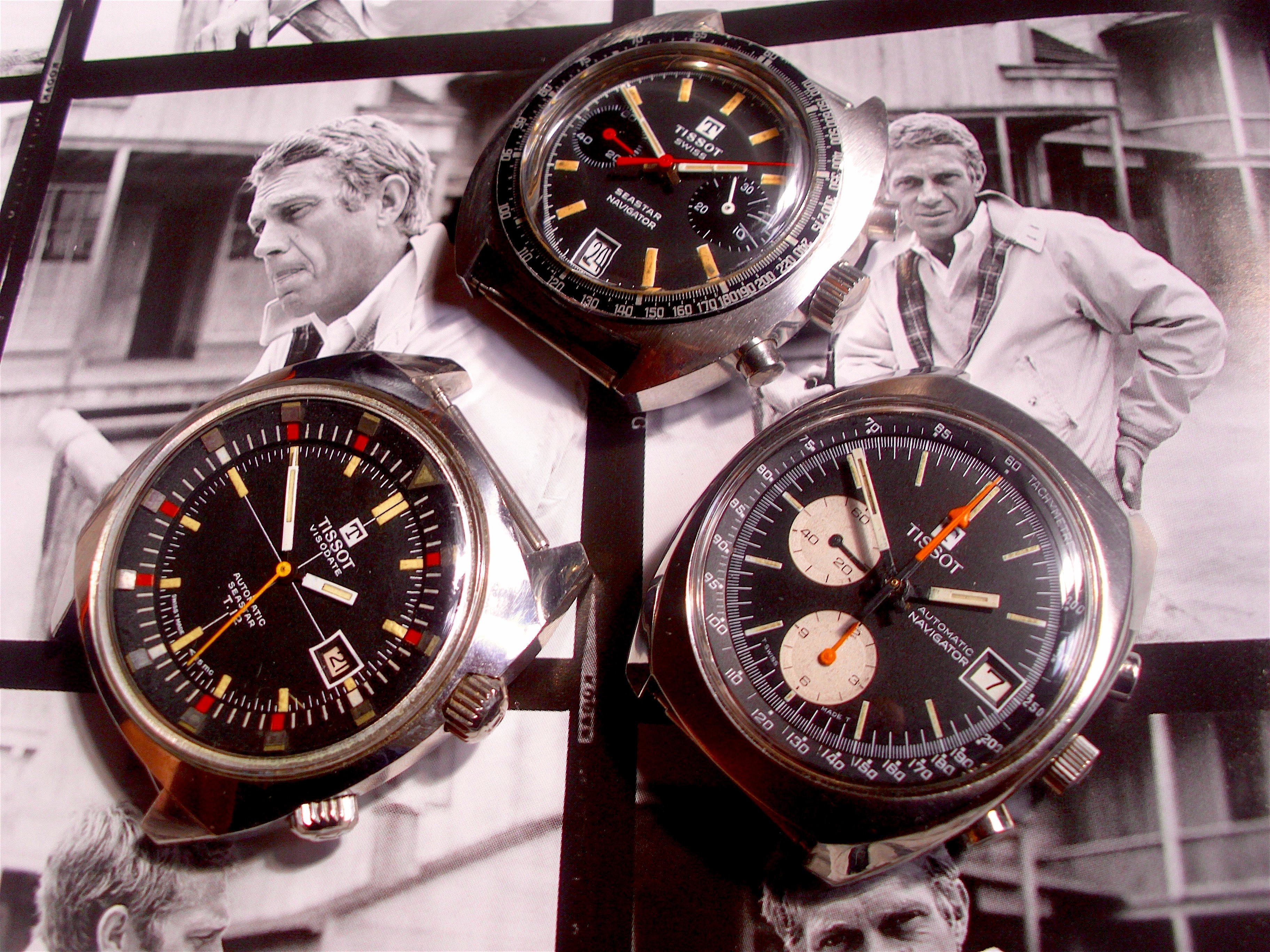

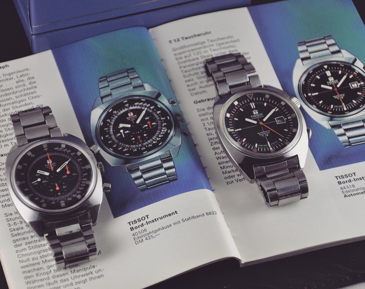

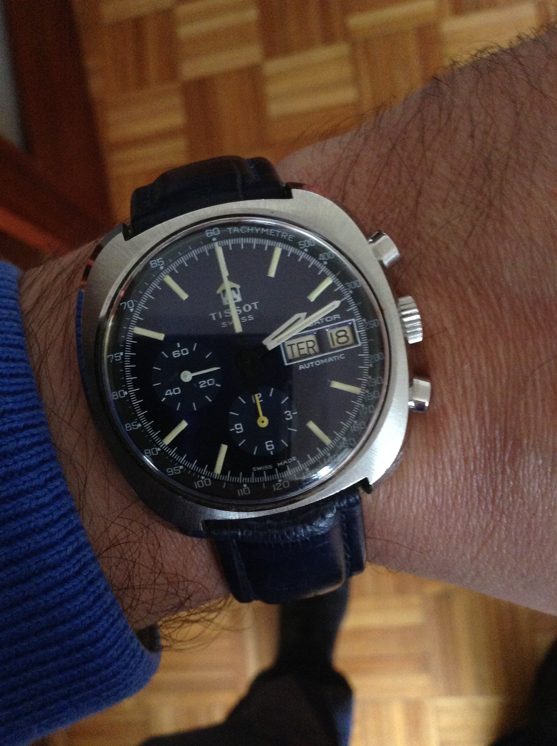

    I am starting a post where people can hopefully share INFORMATION, REQUEST FOR INFORMATION. and for SOURCING PARTS and or Knowledge for vintage Tissot watches the cousin of Omega ... hopefully people who might need advise, parts etc etc ... can find what they are looking for .... via other people on this page

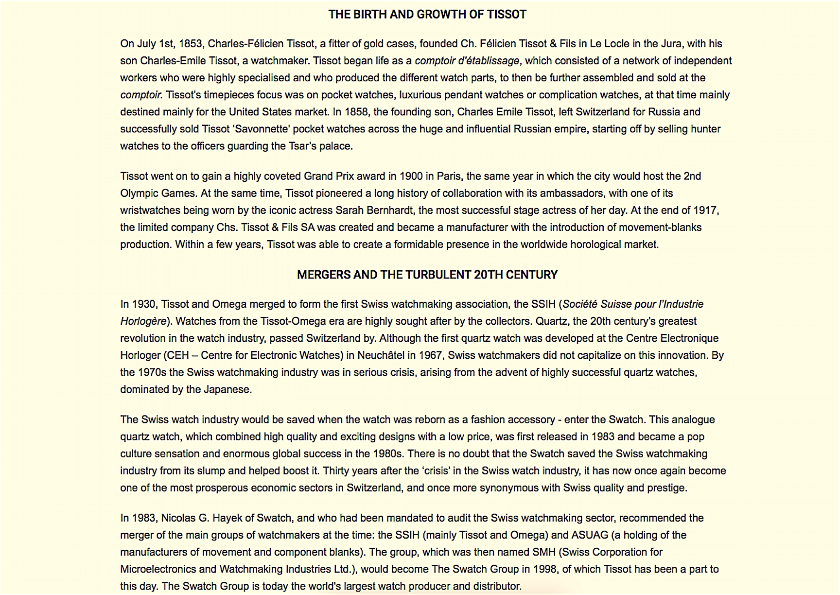

    Tissot merged with Omega back in 1930. Lemania, the movement maker joined the group 2 years later and became the chronograph movement maker for the brands. Having a captive chronograph maker enabled both Omega and Tissot to become official timing partners for many events such as the Olympics, Formula 1 and other sporting events. Tissot and Omega used a lot of similar or even same movements over the years.

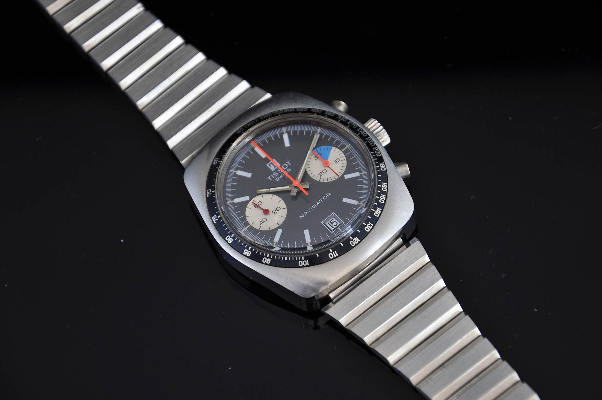

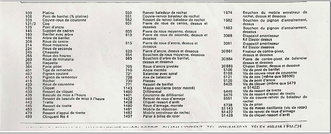

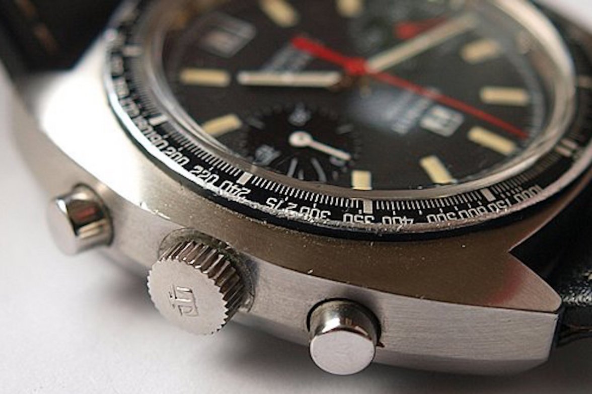

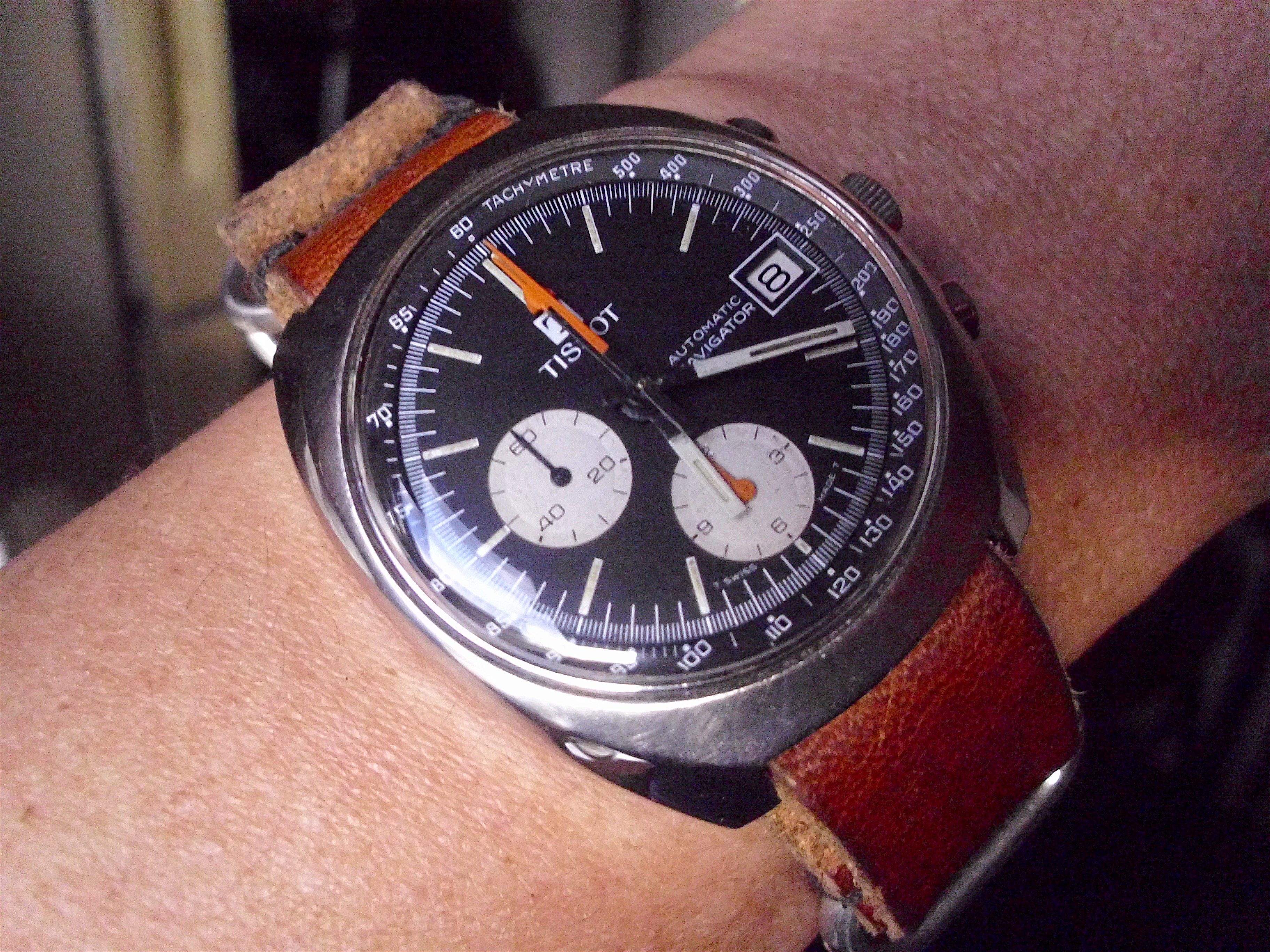

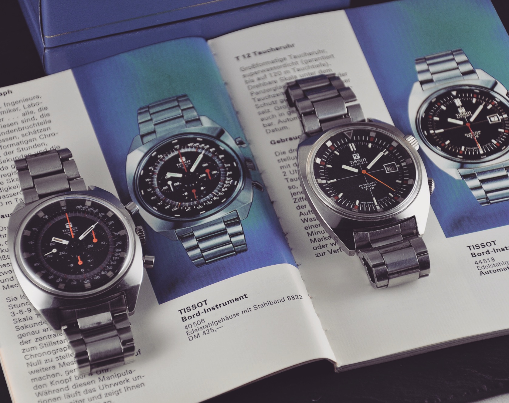

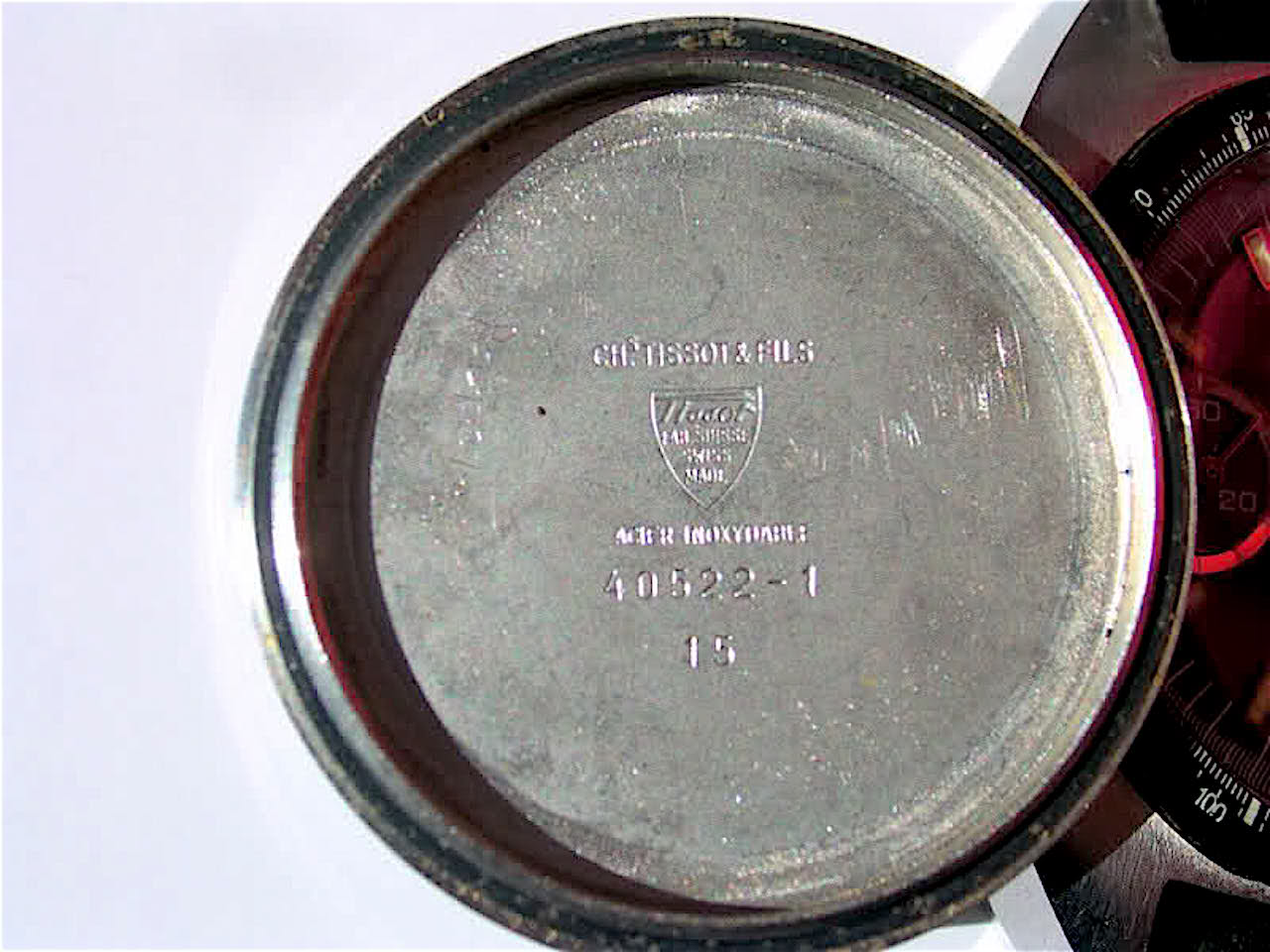

    Tissot_Adverisement_1968-1.jpg 61187710_10156377945974537_2754539054375632896_n.jpg 142731798_10157987210629537_2981822054215889059_n.jpg DSCI2724.jpg DSCI4782.jpg Screen Shot 2021-05-12 at 4.13.32 AM.png 123718776_10157788191429537_6193124626161632283_n.jpg Screen Shot 2021-05-12 at 2.15.20 PM.png Screen Shot 2021-05-12 at 2.15.20 PM-1.png 24-caseback-2.jpg 230001186_10158409851769537_1099133890658903005_n.jpg 206628645_10158334160009537_966382441968760604_n.jpg 202375629_10158333046769537_8345123640870993693_n.jpg 204711722_10158345564439537_895855754115768713_n.jpg

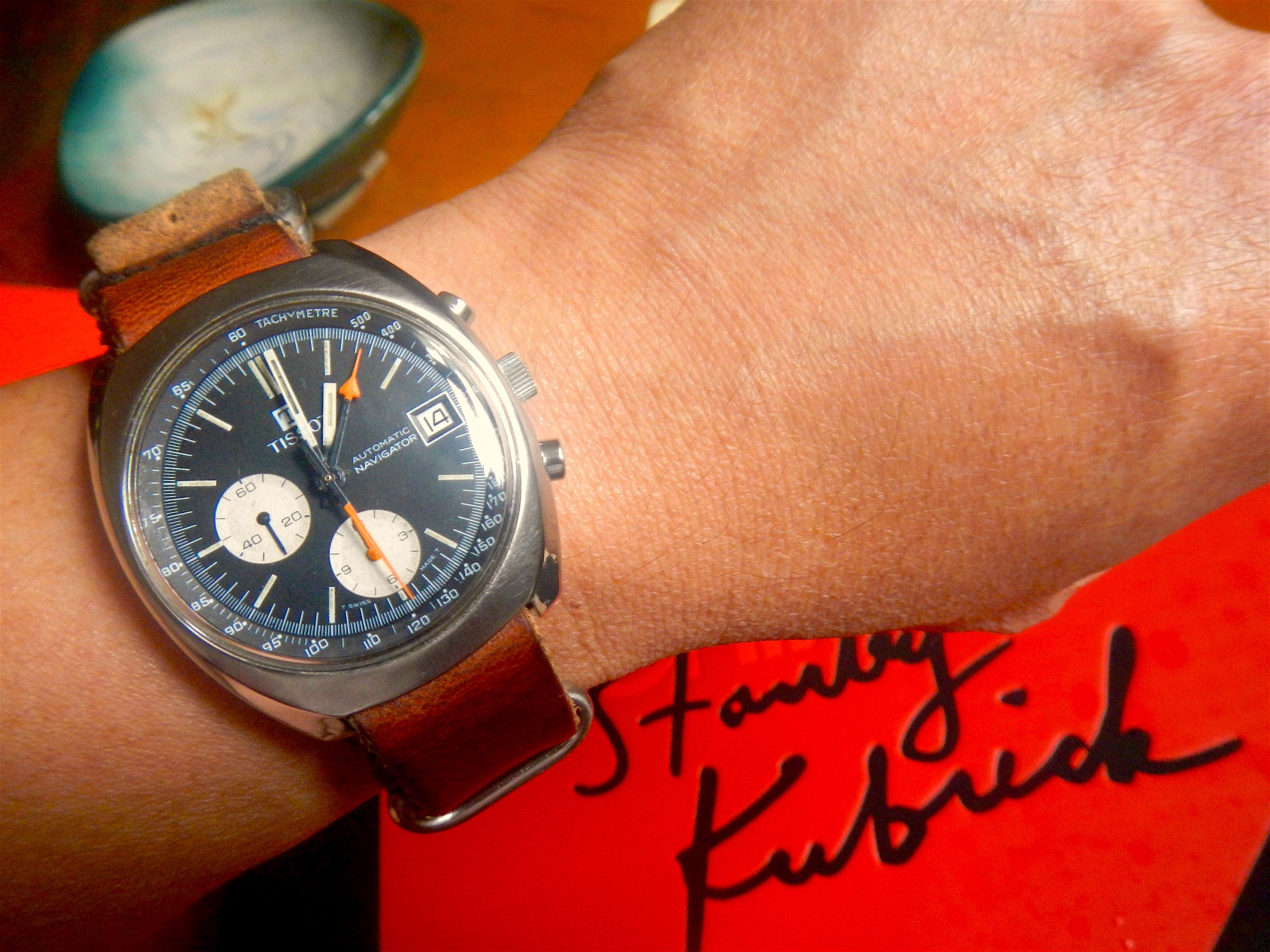

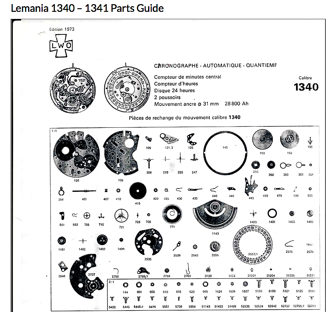

    thanks i would love to do a resto project for the 2 register chronograph lemania 1341 ... a dial and a complete set of hands would be great ... lets see if someone with parts will post here ... and hopefully in the future more people will use this thread for that

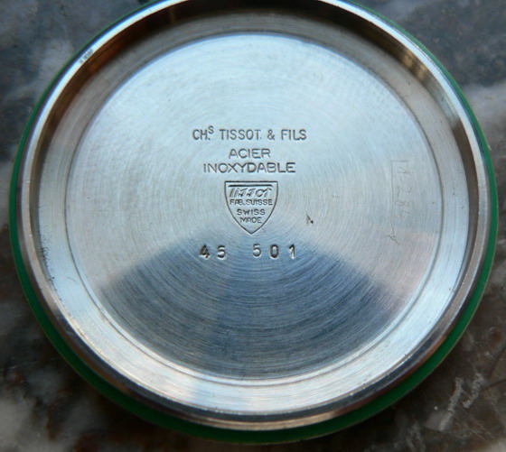

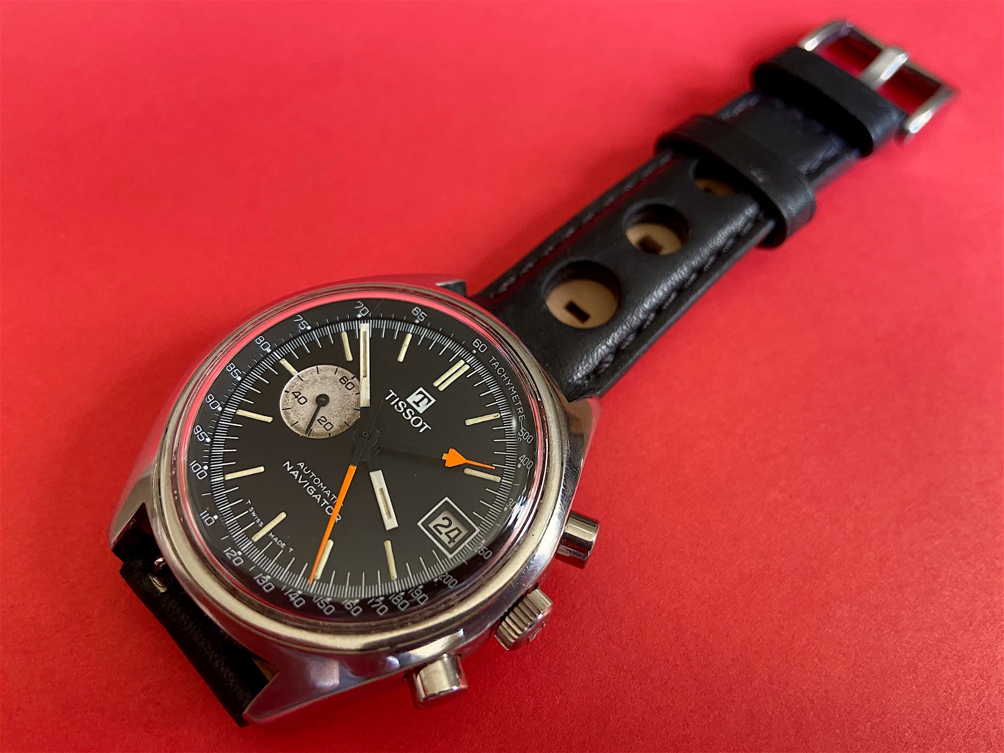

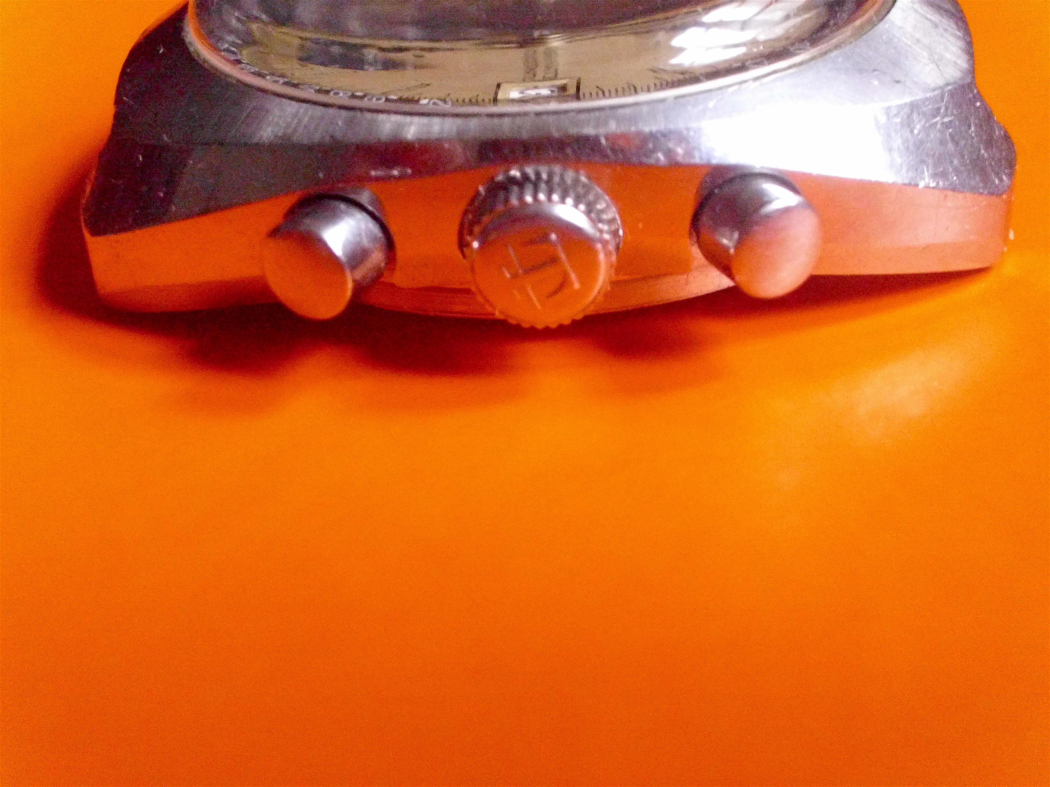

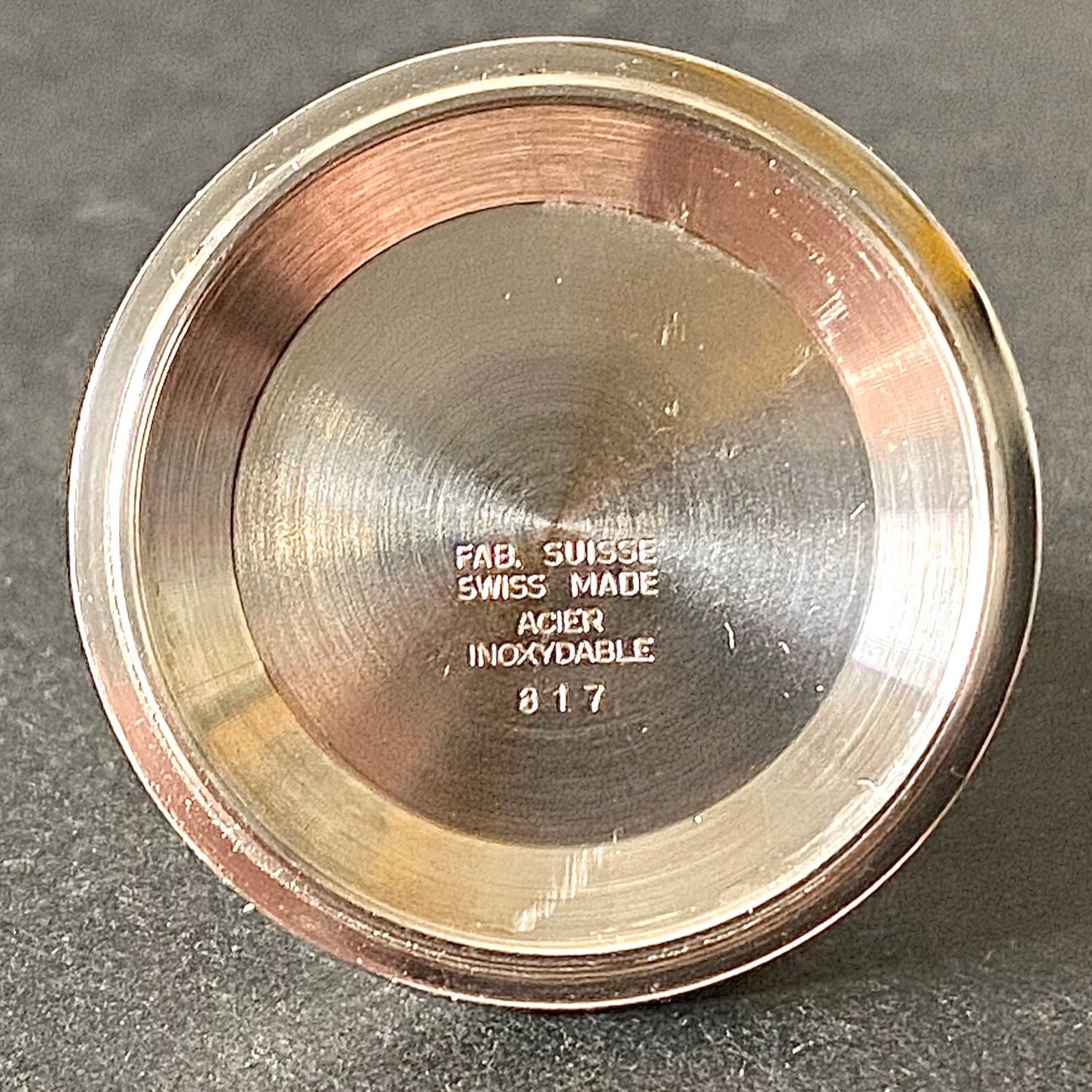

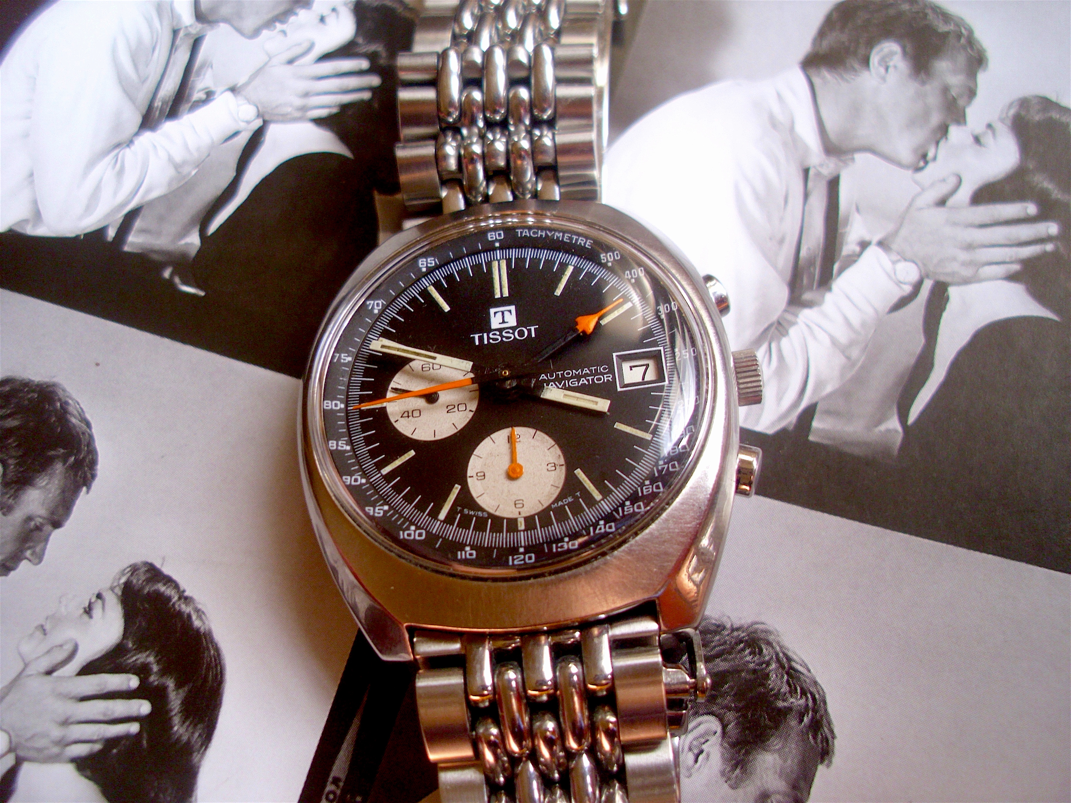

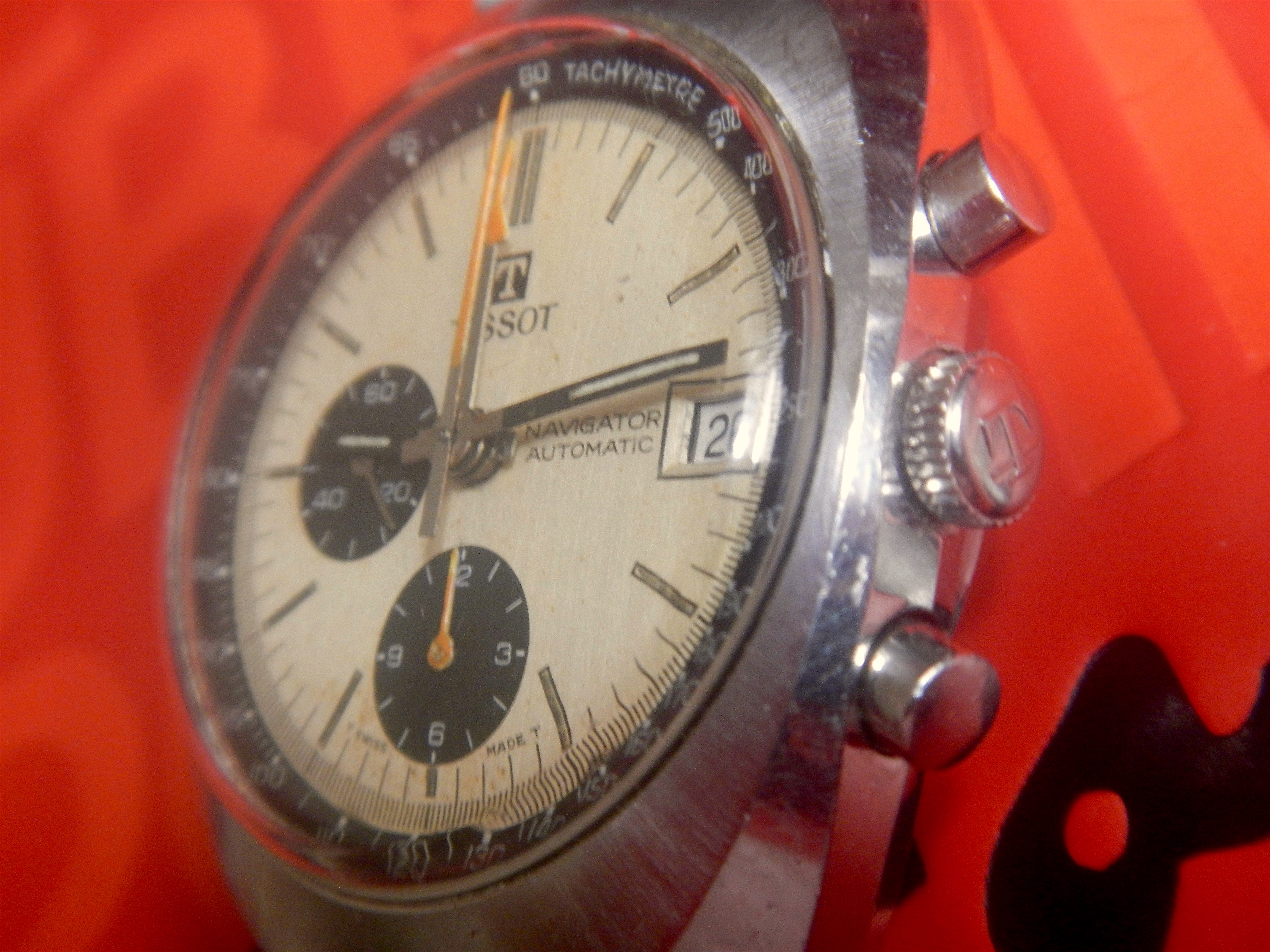

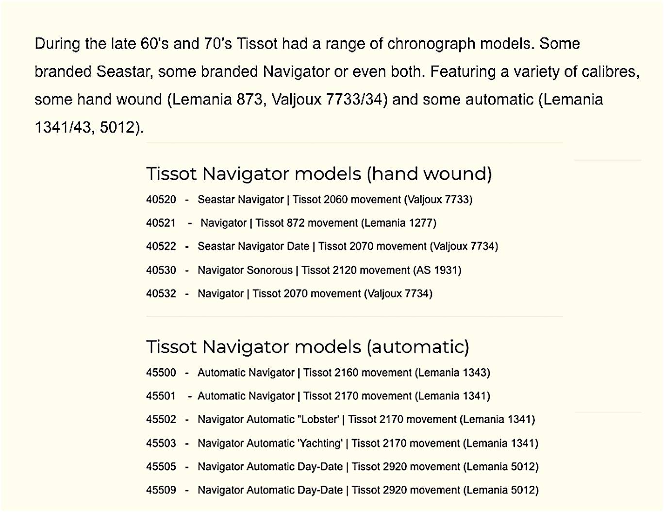

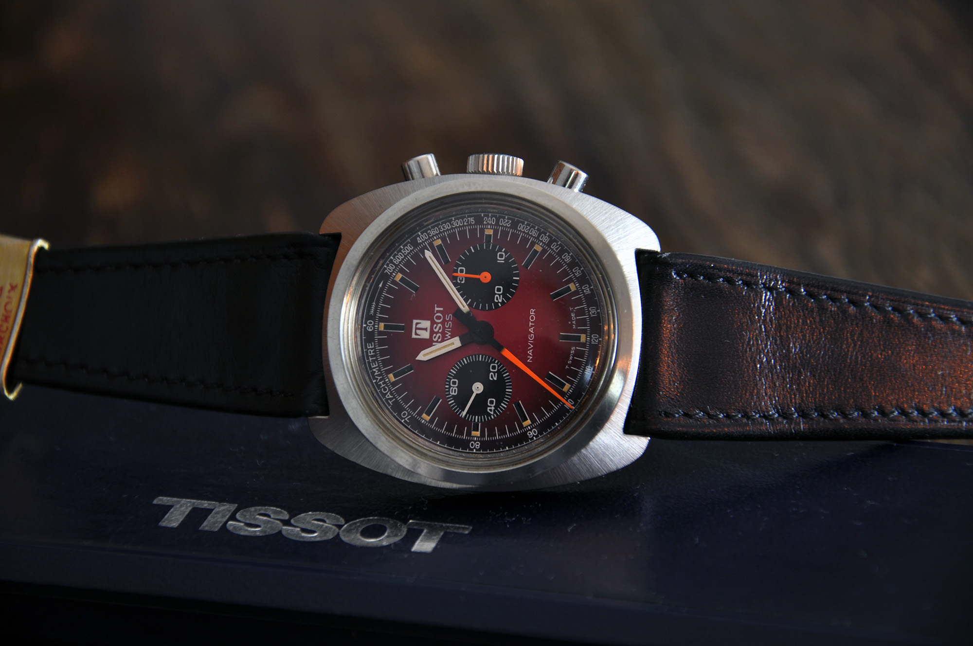

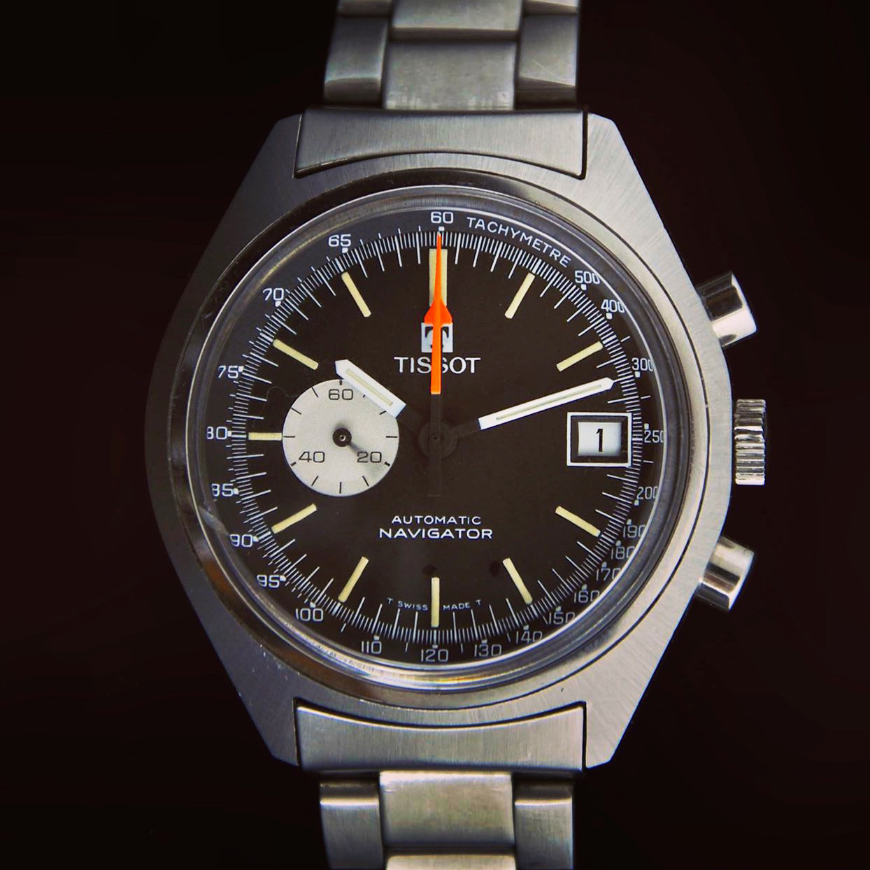

    DSCI4844.jpg Chronographe Tissot Navigator 6.JPG Chronographe Tissot Navigator 8.jpg Screen Shot 2017-09-06 at 2.54.28 PM.png Screen Shot 2017-09-06 at 2.57.57 PM.png INFORMATION / Reference ...

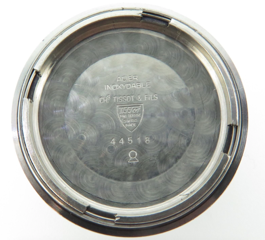

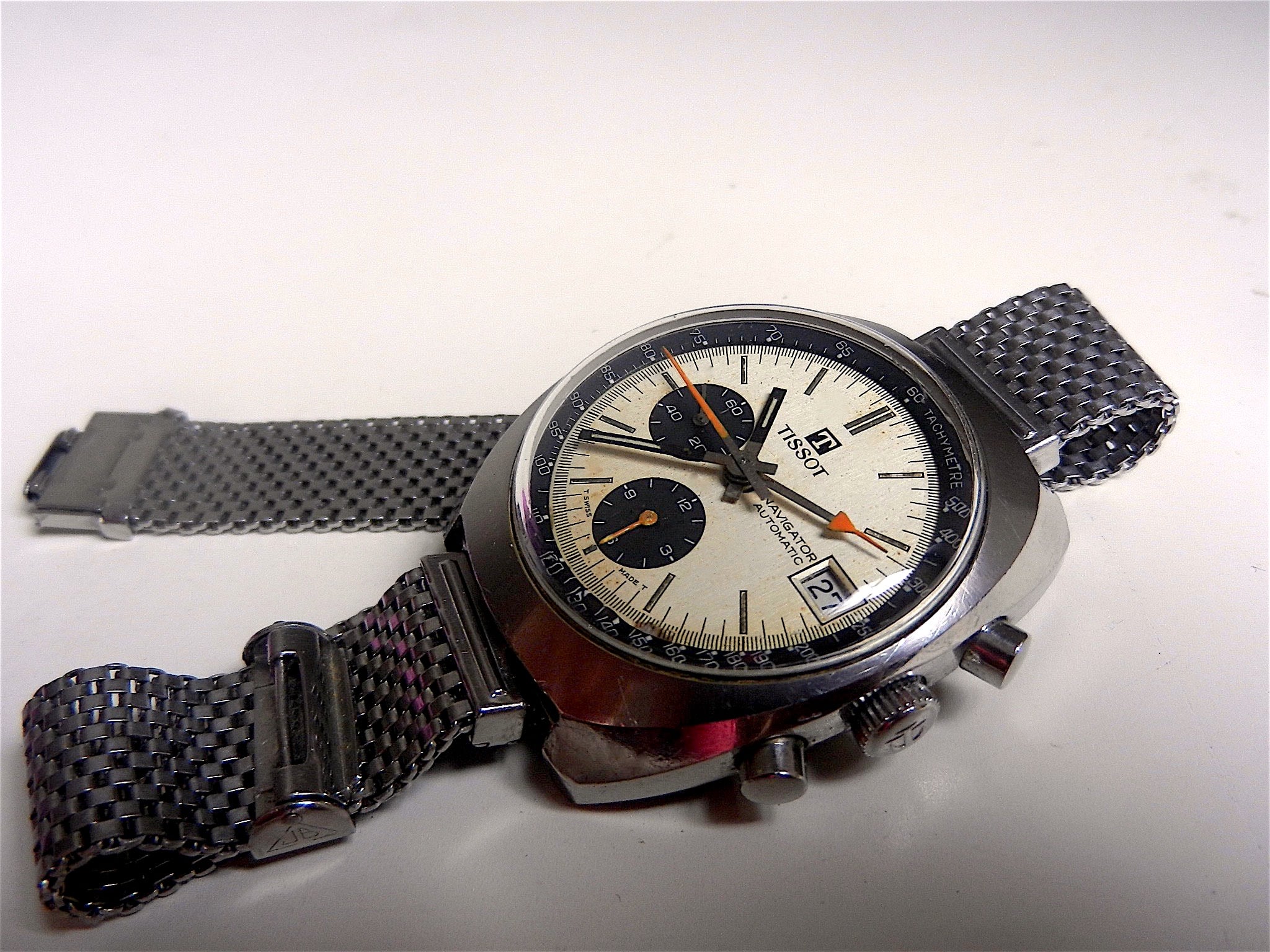

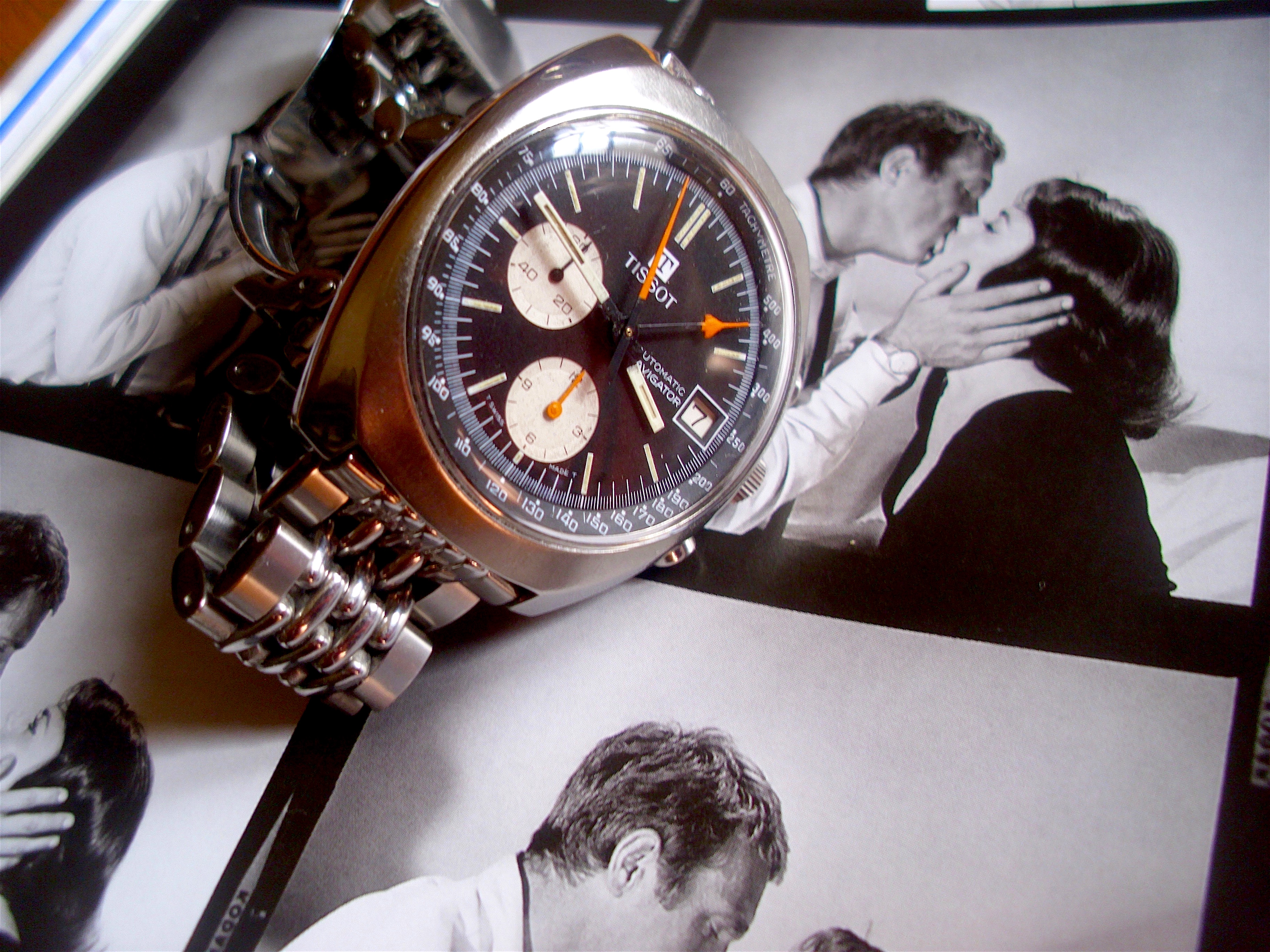

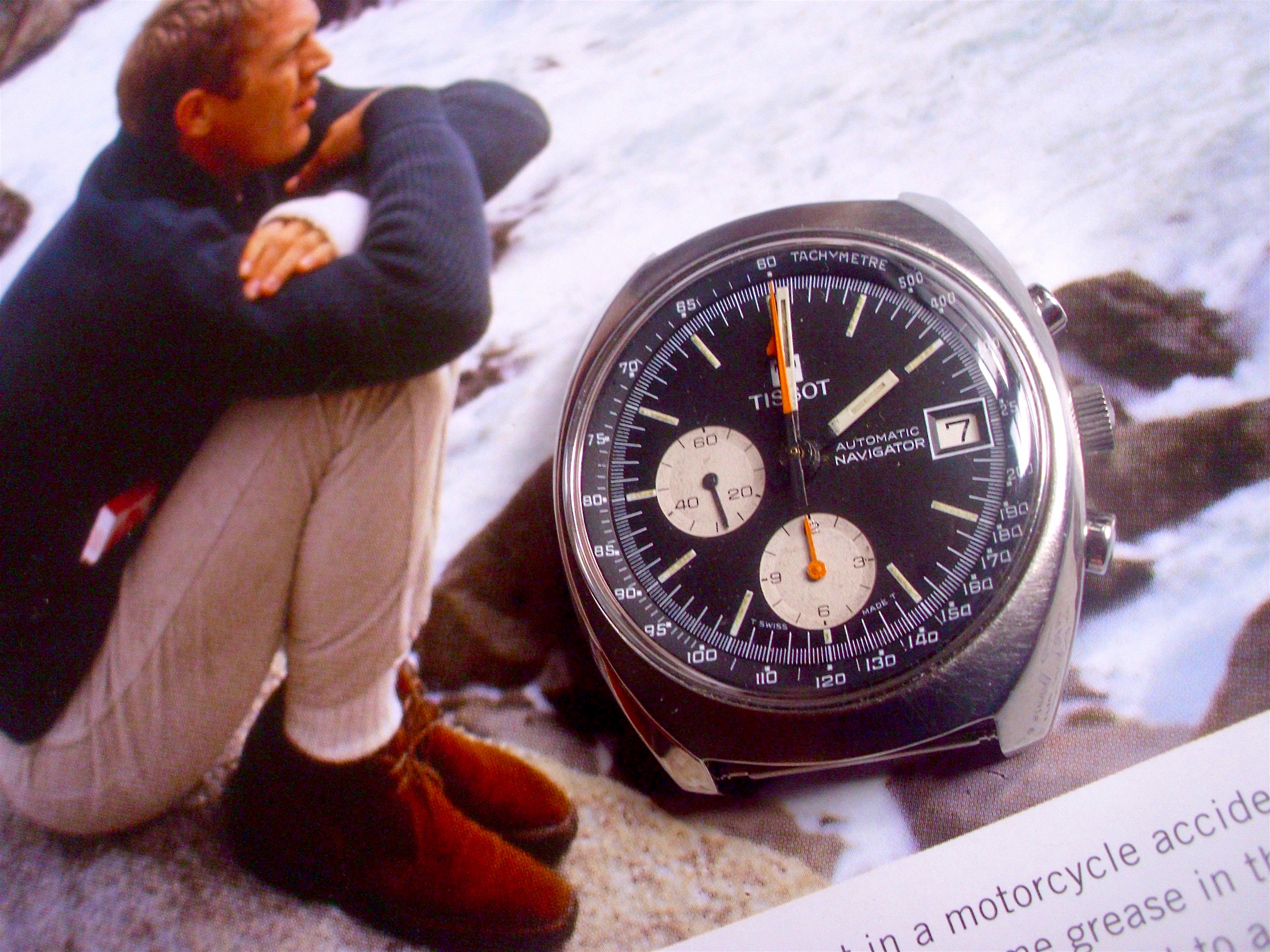

    Gents Tissot Automatic Navigator, Chronograph Lemania 1341
    Case: 45.501, Chs. Tissot & Fils, Tissot, Fab. Suisse, Swiss Made, Acier Inoxydable - steel, plastic crystal, screw back, 38.5x44mm
    Dial: Tissot Automatic Navigator, T Swiss Made T - mat black, silvered sunk sub dials for continous second and hour counter, luminous markers, ring with tachymeter scale
    Movement: 14481370, Tissot, Swiss, 17 Jewels, ball-bearing rotor, Kif shock protection
    Chronograph: 60s, 60min, 12h, center minute- and second counter, cam switched
    Date: quickset
    Tissot 2170 (Lemania 1341)
    Features
    automatic chronograph, 60s, 60min, 12h, cam switched, center-minute and -second
    sub second
    date: quickset
    Data
    13.75''', Dm=Do= 31.0mm
    H= 8.0mm
    17 jewels
    f = 28800 A/h
    power reserve 44h
    Mainspring / battery
    1.05 x 12.0 x 0.10mm
    Hands
    2.30 x 1.60 x 1.05 x 0.25 / 0.35 x 0.20mm
    Edited Sep 8, 2017
    YYTIN, simonsays, joeshoup and 4 others like this.

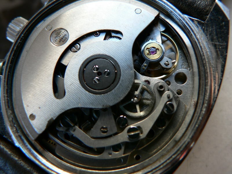

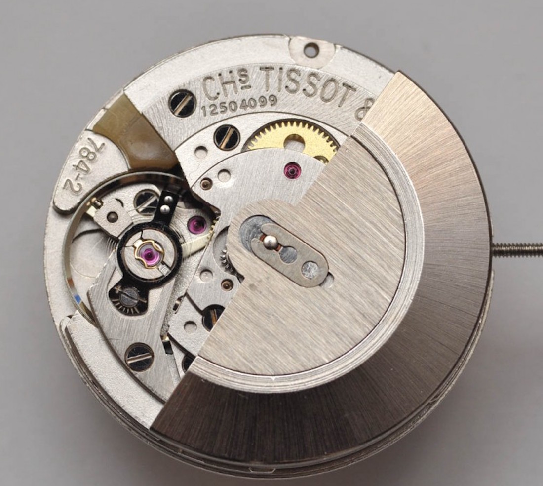

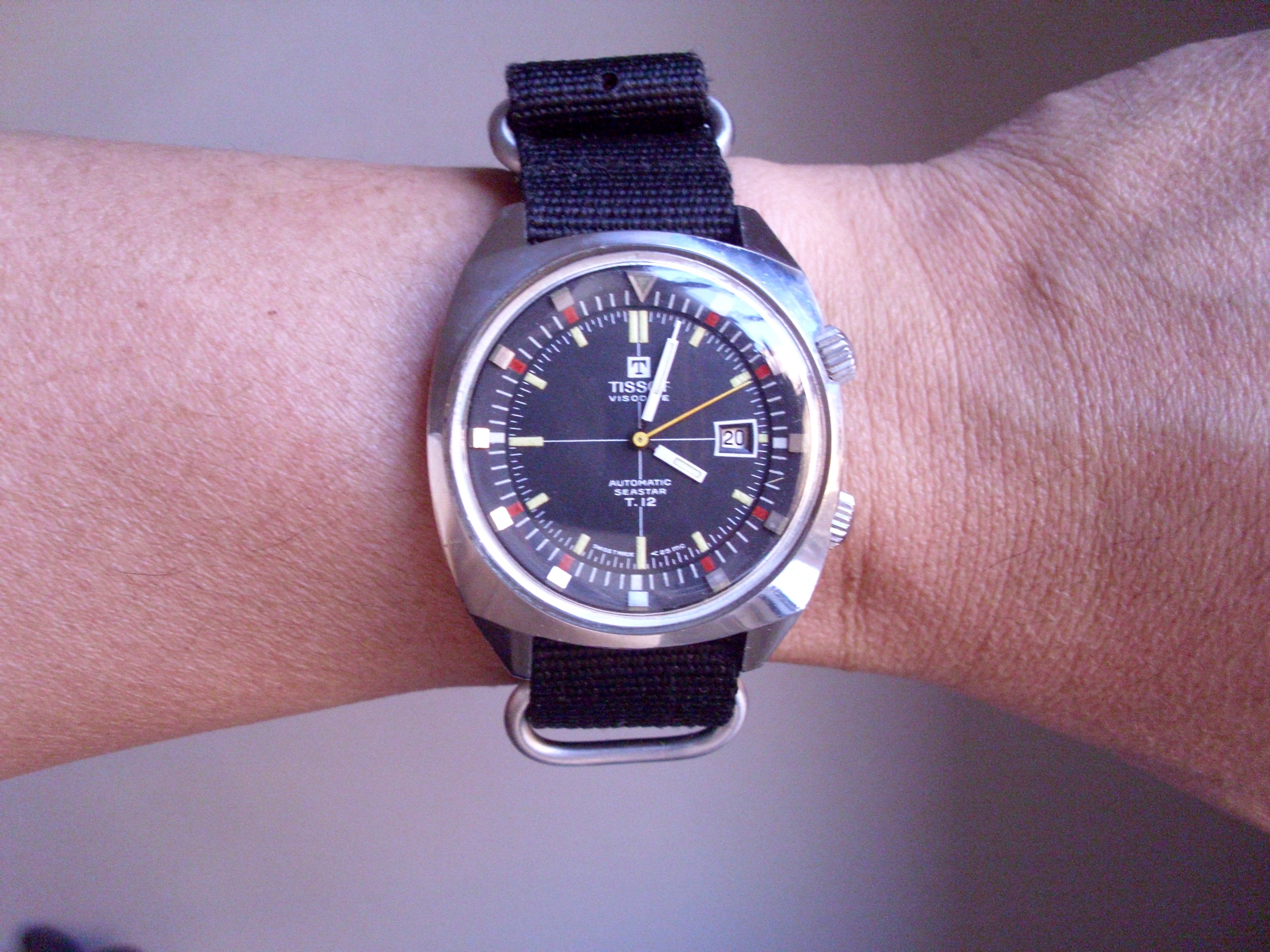

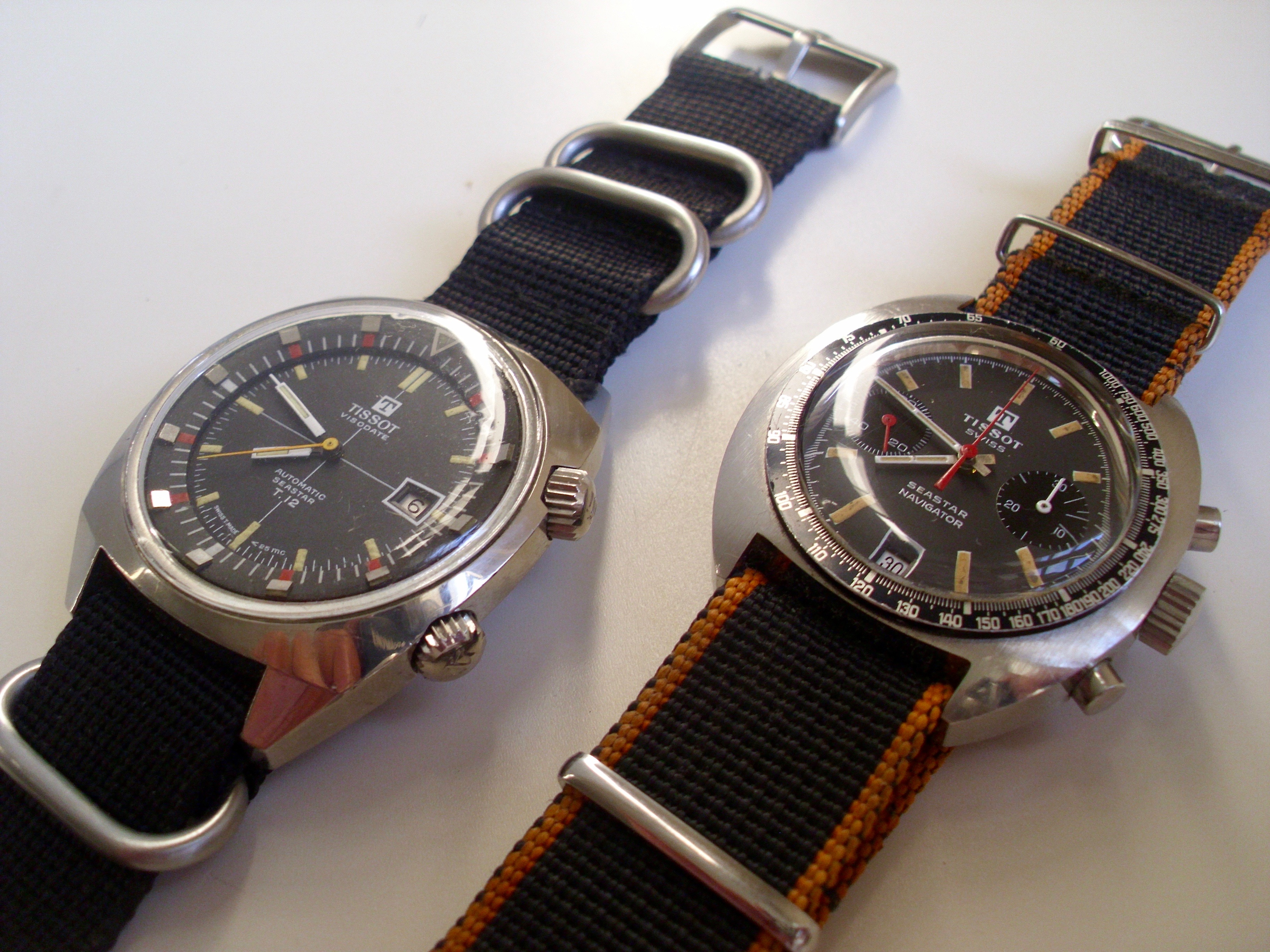

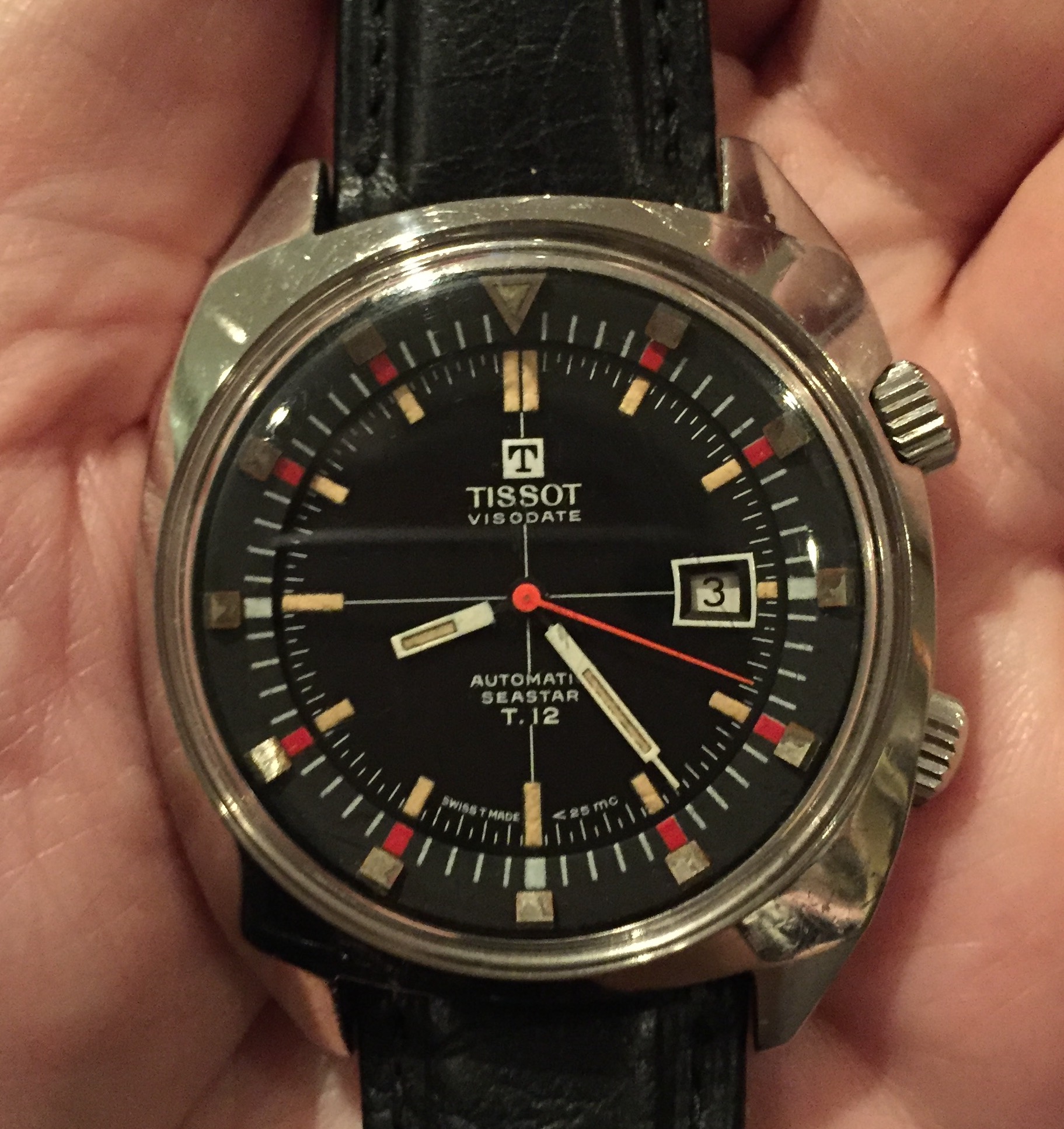

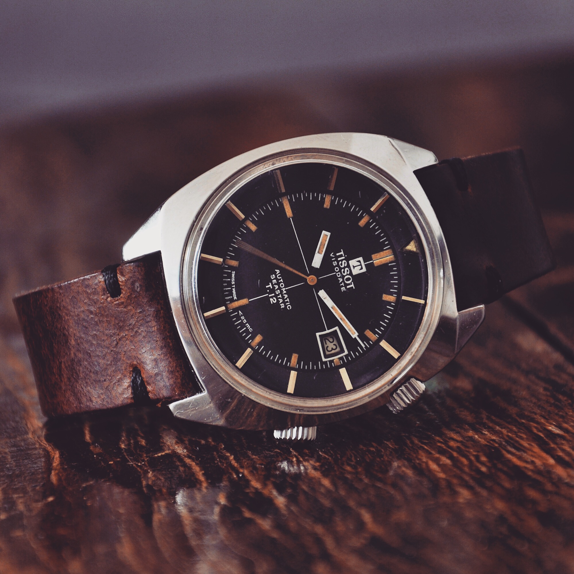

    Tissot Visodate Seastar T.12 Dual Crown Compressor Style Divers Watch ref.# T12 44518
    42.2 x 50mm. case, bi directional internal bezel, movement cal. 784-2
    Tissot 784-2
    Features
    automatic
    sweep second
    date: set by changing 21:30-24h
    Data
    11.5''', Dm= 25.6mm, Do= 26.0mm
    H= 5.35mm
    F= 1.4mm
    T= 2.0mm
    21 jewels
    f = 18000 A/h
    power reserve 45h
    Balance staff U2480
    Stem W2696, W3061 (Seastar Seven)
    Zf2960-X, 1.20 x 9.0 x 0.115 x 280mm
    Hands
    1.50 x 0.90 x 0.21mm
    DSCI3957.jpg tissot2.jpg tissot784_2_1-800x800.jpg Screen Shot 2017-09-07 at 7.58.37 AM.png
    YYTIN, Longbow, Montytrucker and 6 others like this.

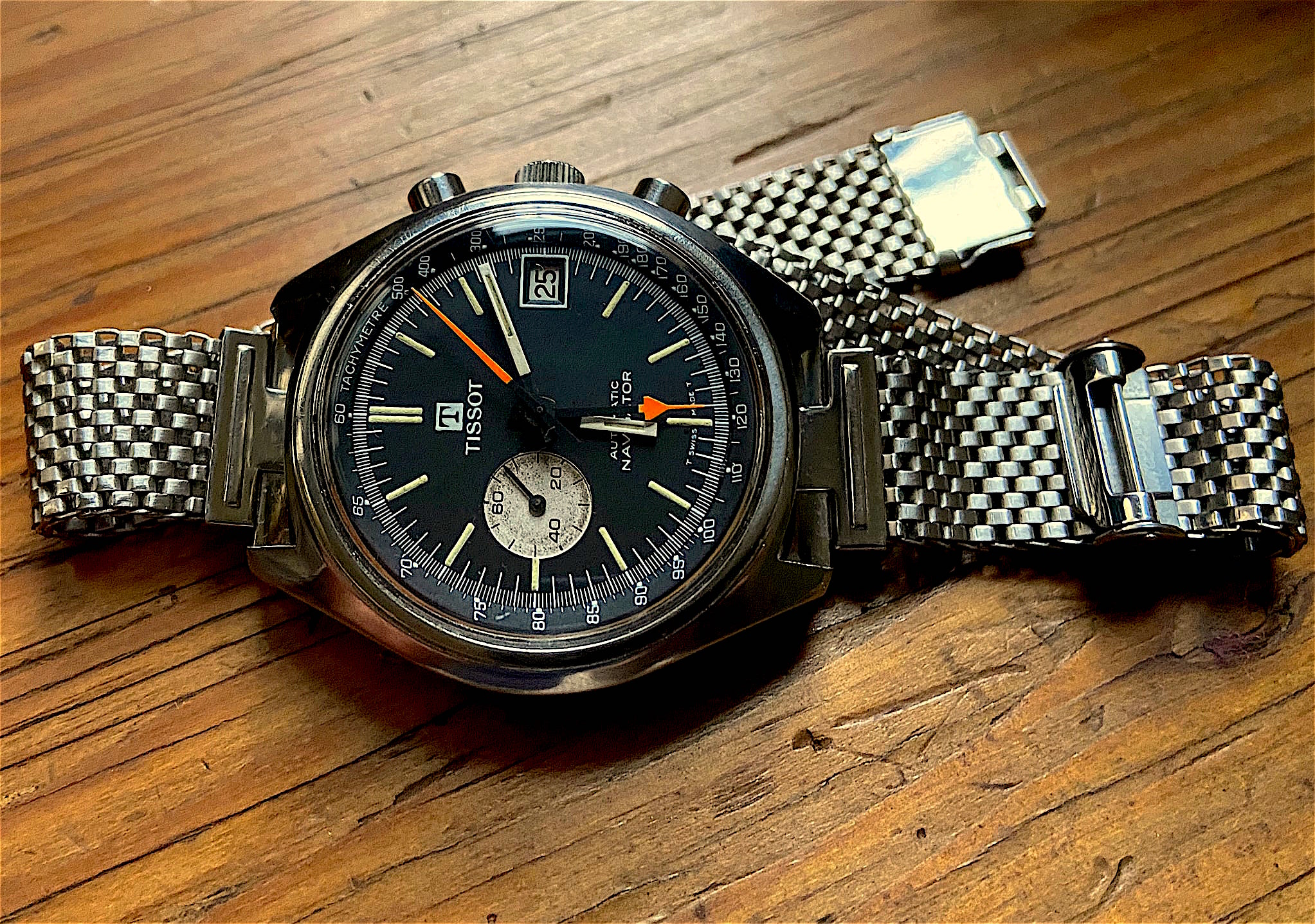

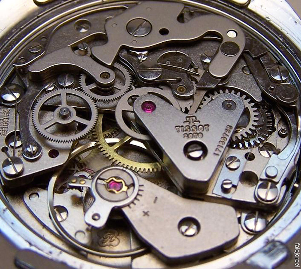

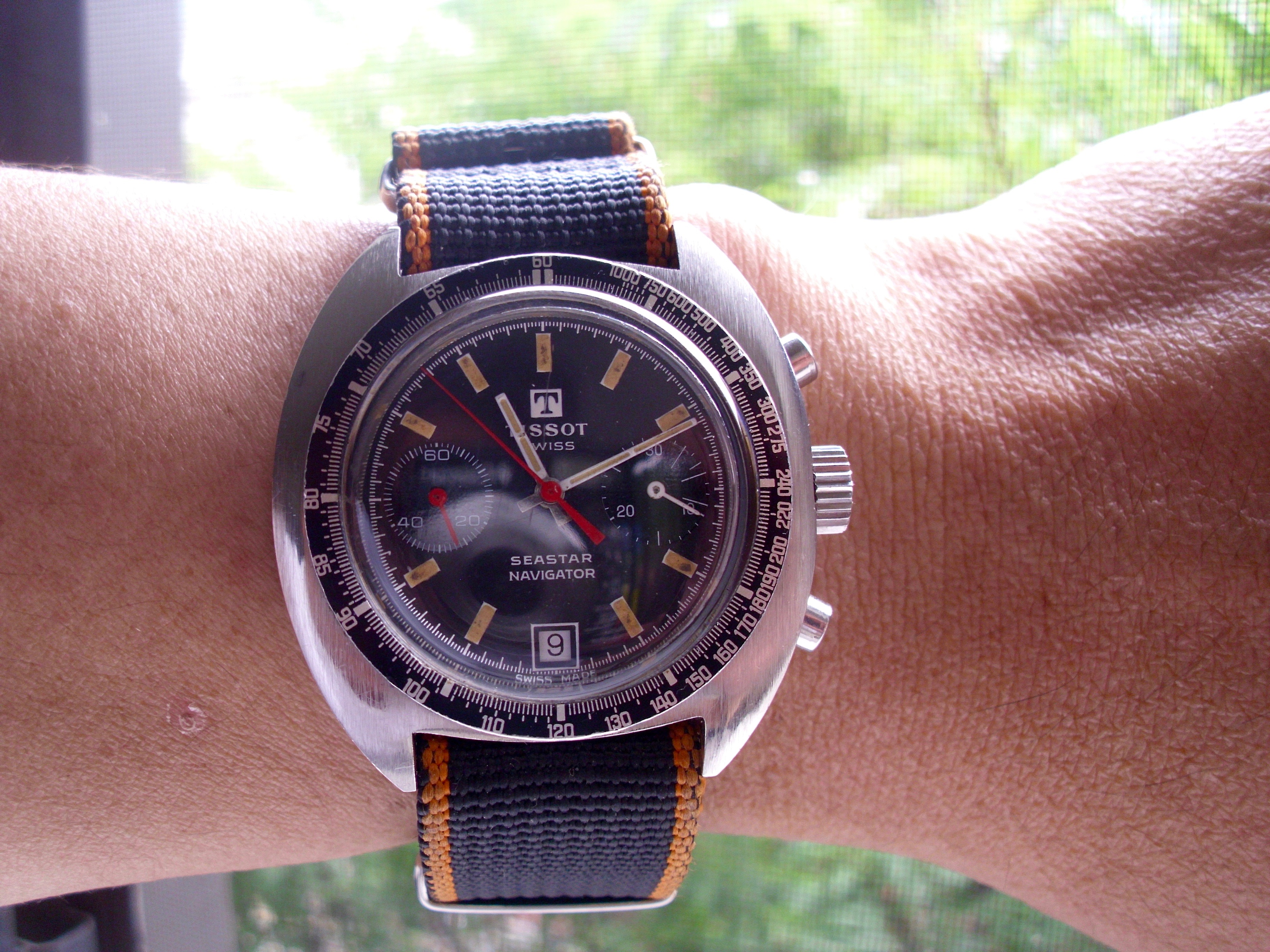

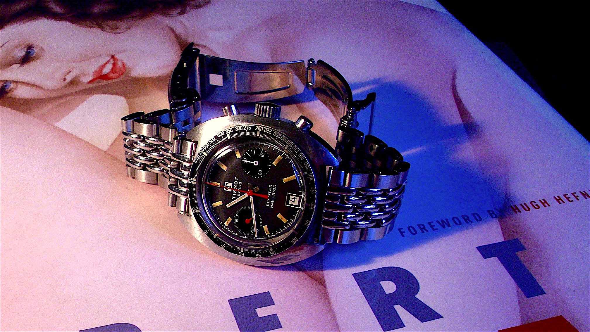

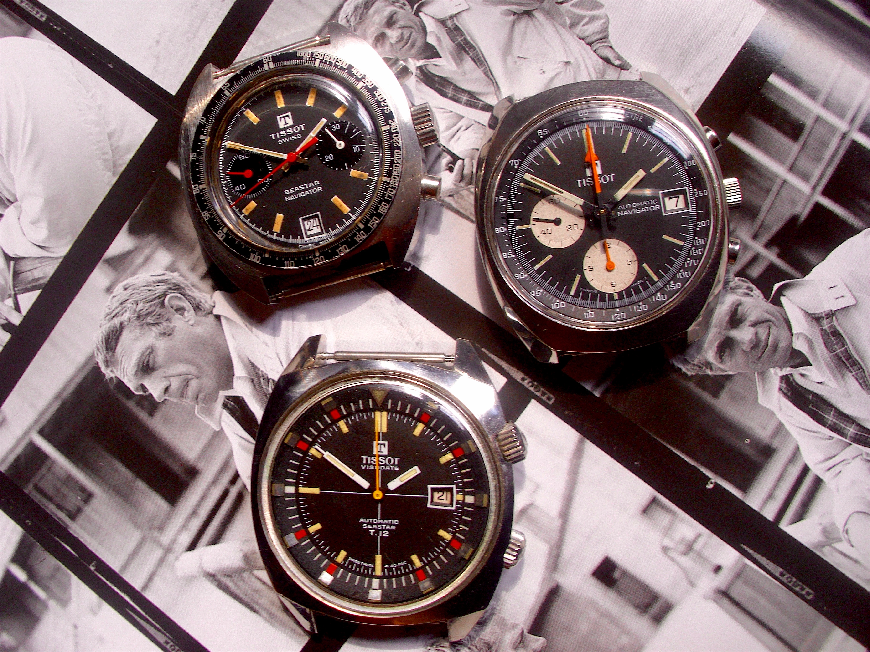

    Tissot Seastar Navigator chronograph cal. 2070 [Valjoux 7734] movement
    Tissot 2070 (Valjoux 7734)
    Features
    manual-wind chronograph, 60s, 30min, cam switched
    sub second
    date: set by changing 22-24h
    Data
    14''', Dm= 31.0mm, Do= 31.3mm
    H= 6.65mm
    F= 1.25mm
    T= 2.5mm
    17 jewels
    f = 18000 A/h
    power reserve 45h
    Balance staff U3106
    Stem W1188 / W3371
    thread 1.2mm / 0.9mm
    Zf1337, 1.60 x 12.5 x 0.13 x 430mm
    Hands
    1.40 x 0.95 x 0.27 / 0.27 x 0.18mm
    DSCI2339.jpg T2.jpg Screen Shot 2017-09-07 at 11.39.26 AM.png r8ttt1.jpg tissot-caliber-2070-valjoux-7734.jpg

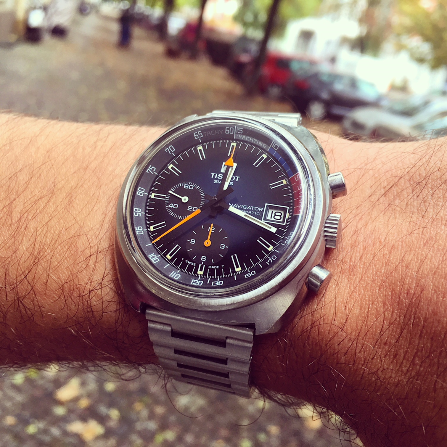

    Here is my Navigator with a Lemania 5012:

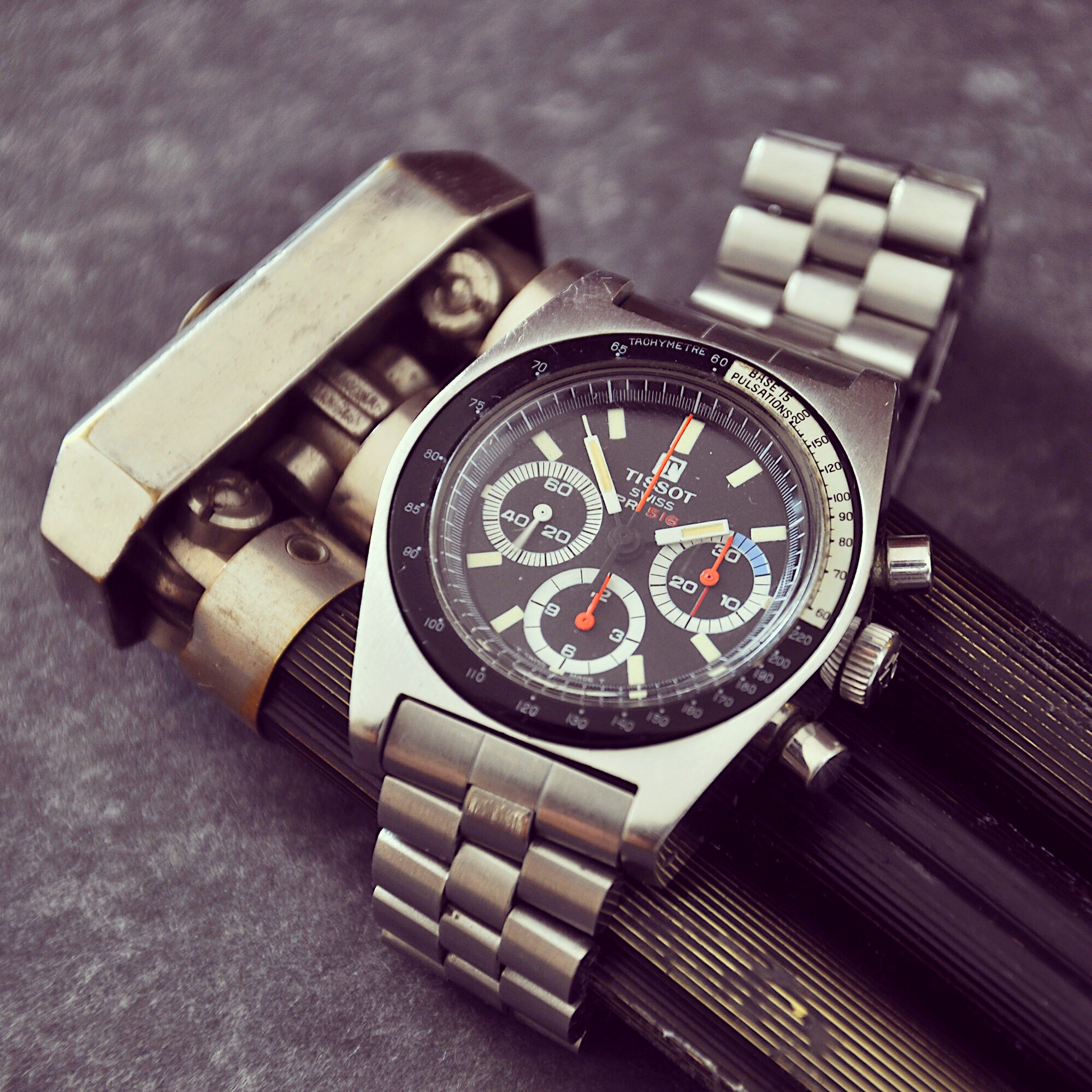

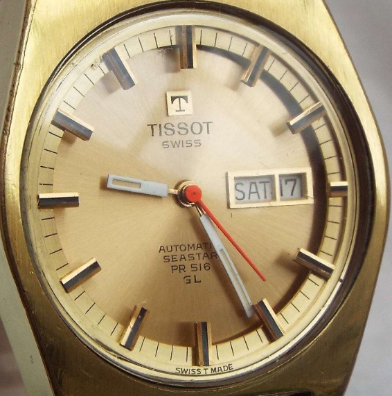

    1969 Tissot Seastar PR516 Ref. Z 40.508 - Lemania 1277
    [​IMG]
    1972 Tissot PR516 GL "Grand Luxe" - Tissot Cal. 2481 (equivalent to Omega 1481)
    [​IMG]
    Edited Dec 20, 2017
    YYTIN, Pazzo, Longbow and 7 others like this.

    Top tip: If you like a 516GL, look for the version where the minute hand swings underneath the hour markers, like this:
    Norfolk, Longbow, DaveK and 6 others like this.

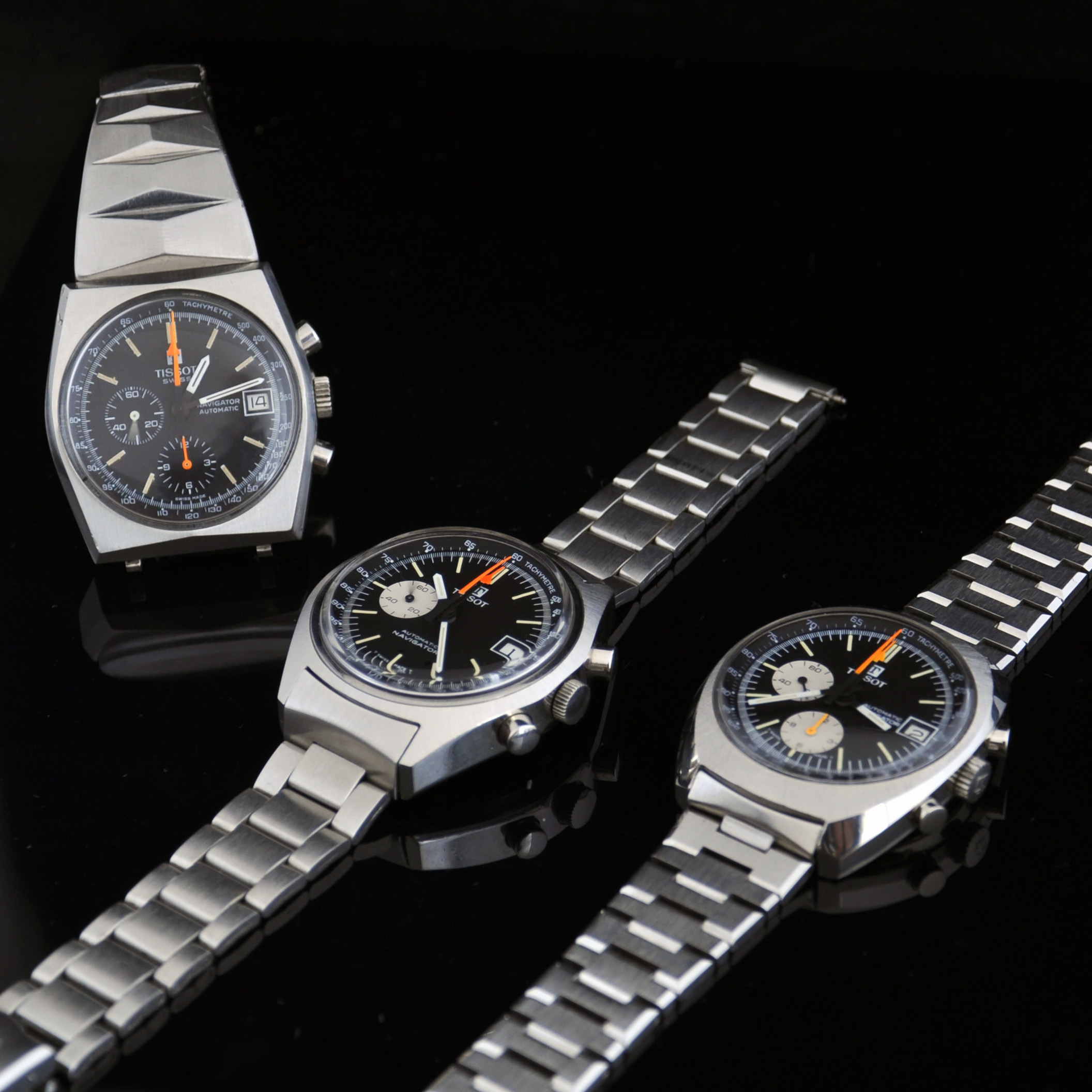

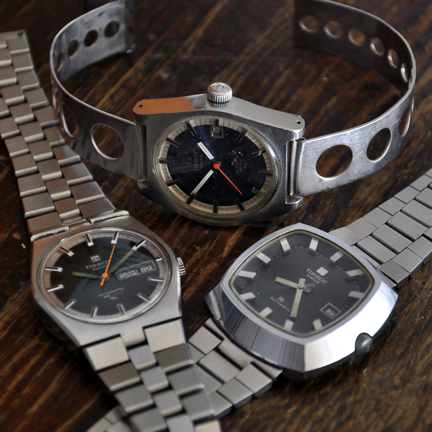

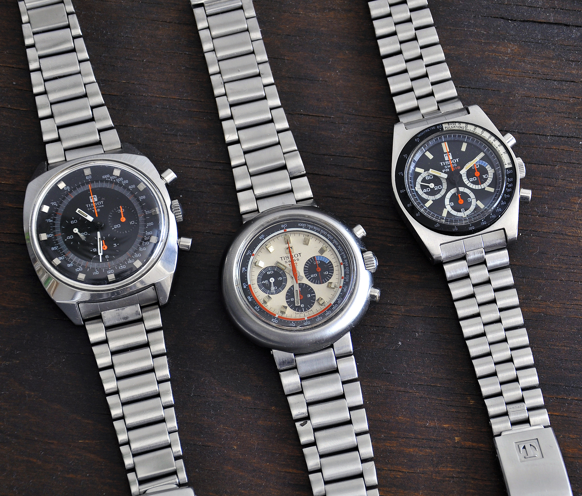

    Since my whole vintage passion started with Tissot, I'd like to contribute some shots of my current and former Tissot watches:
    IMG_8210.JPG FullSizeRender.jpg IMG_3070.JPG IMG_1755.JPG FullSizeRender.jpg IMG_5198.JPG DSC_0004.JPG DSC_8927.JPG DSC_3226.JPG DSC_8415.jpg DSC_8449.JPG
    Lancaster, YYTIN, X350 XJR and 21 others like this.

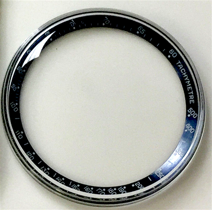

    CROWN and CRYSTAL ...
    Original TISSOT CROWN measures @ 6.35 mm
    Original Plexi Crystal with inner Tachymeter measures @ 36.1 mm

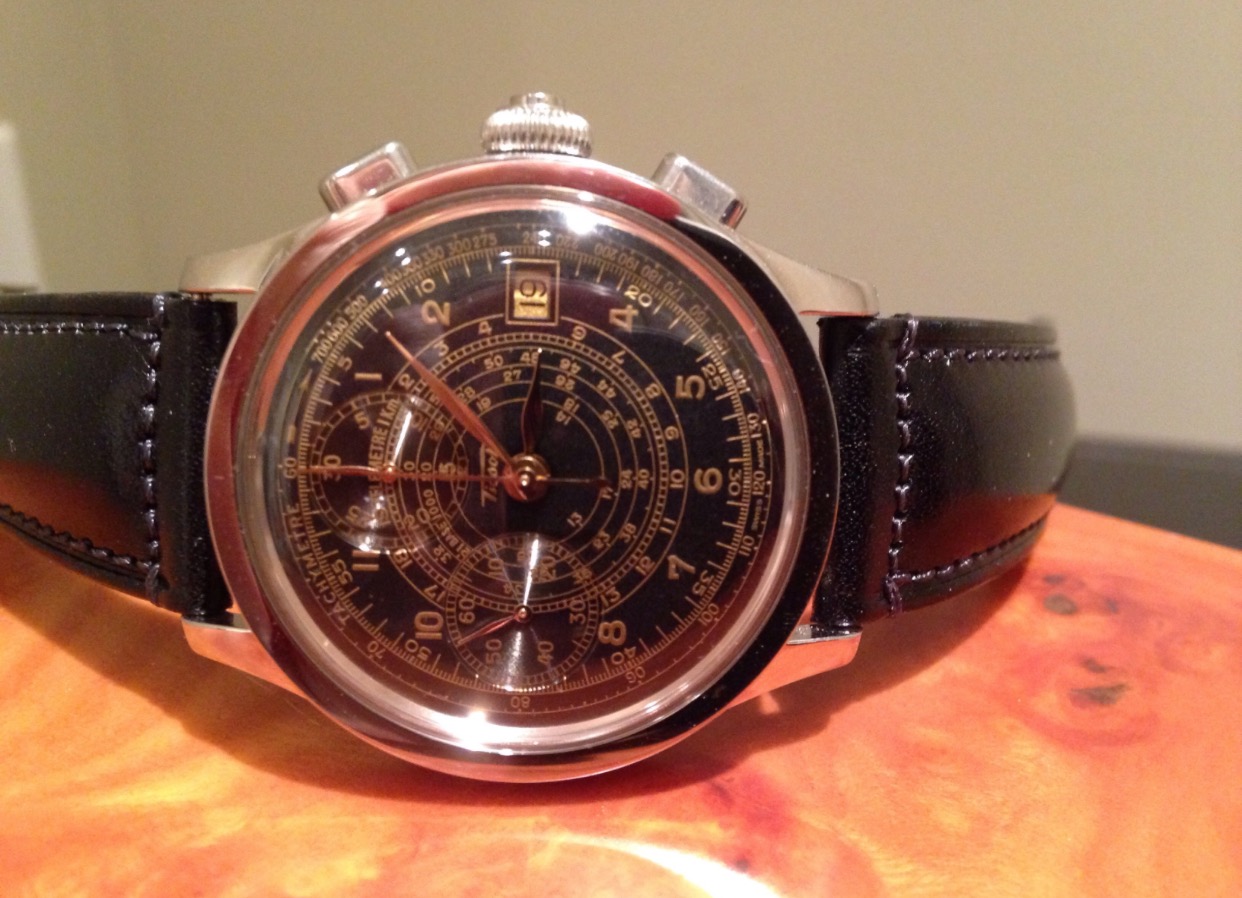

    Talking of Tissot.......I also like the limited edition heritage range of watches that were produced around 15-20 years ago. Here's one of mine IMG_20170606_142500396.jpg
