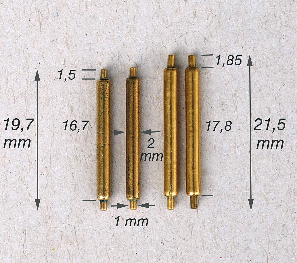

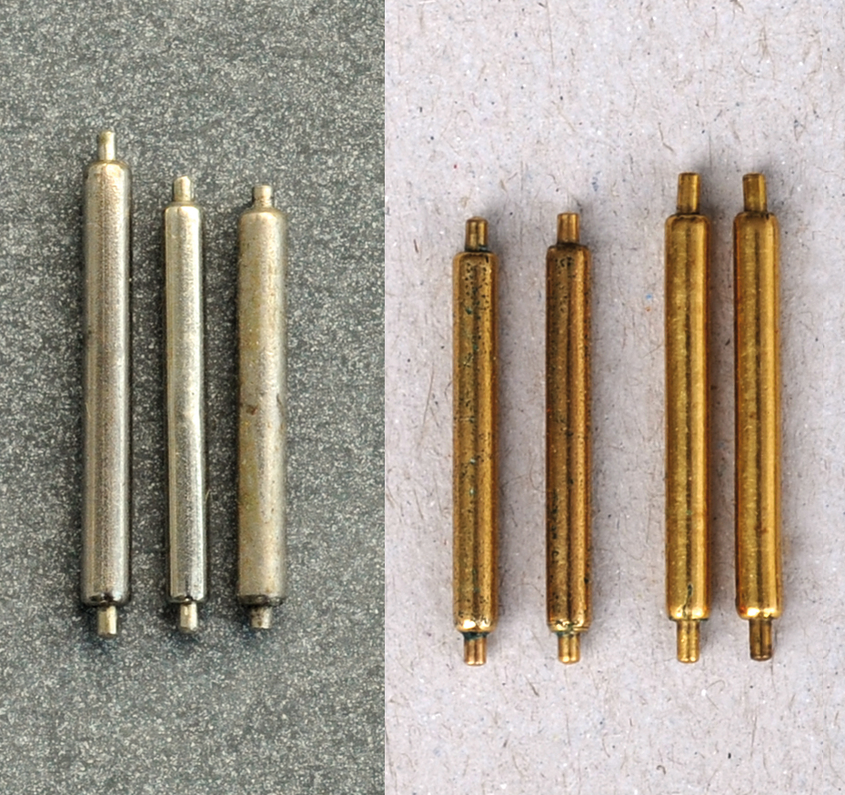

Hi OF,
I am looking for (very) vintage shoulderless spring bars as shown in the photo below - sizes 17 and 18 mm
material: steel colour (nickel plated brass?), brass or gold
Important: bars must have 1 mm tips
3,646
7,756

No, the AD is wrong - is there any shoulder? I can´t see any and I am aware there are spring bars with a shoulder only at one end but they look different.
You ask why I want vintage spring bars and not new ones?
Firstly because they should match my early vintage watches
secondly because they are different in dimensions:
These would be the best match for my watches.

I have received links to online offers (ebay, yahoo.jp) but all of those spring bars have 0.8 diameter tips...
I need bars with 1.0 mm tips hence I am asking for vintage specimens. 0.8 tips won´t fill the holes...

Many of the 30ies and 40ies watches which have open lug holes, many references with cal 23.4 and 30 (T1, T2, etc)

Ah, so you want a bar with a longer tip that may or may not fit flush with the outside of the lug?
3,646
7,756
Obviously now you got it...
Its not without reason that I have posted a photo with detailed length and diameters.
Such bars would fill the hole completely and fit flush with the outside of the lugs.
