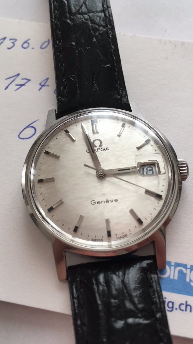

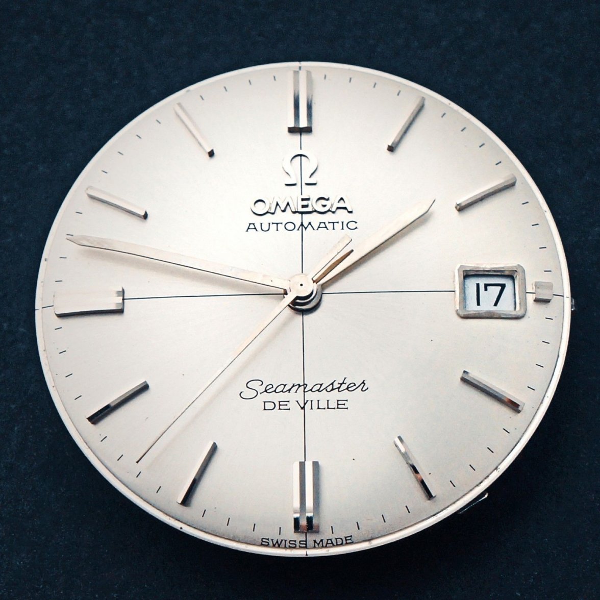

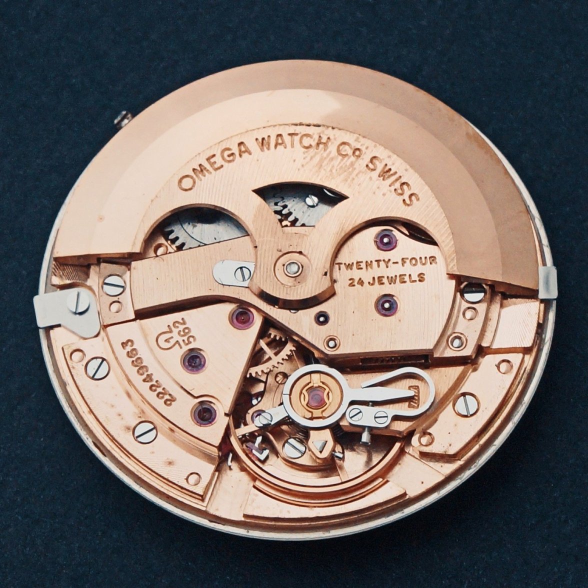

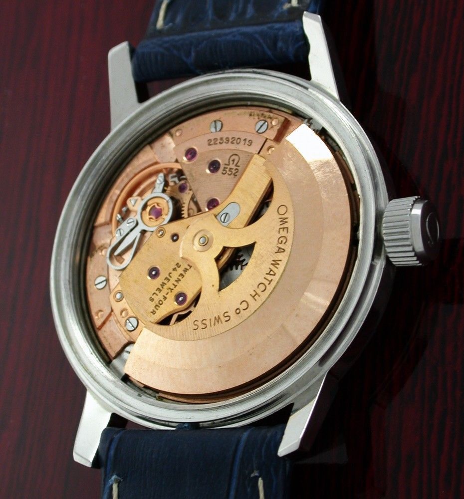

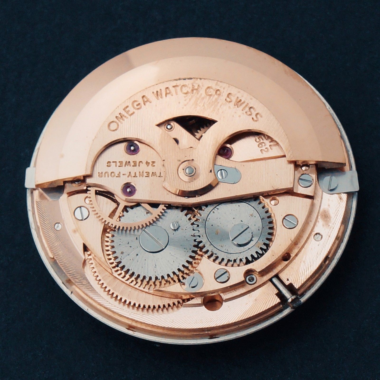

    First off, thanks in advance for any insight, such a welcome to find this forum. I started looking at redials and after reading here for a while was convinced there were better ways to spend my money...although some redials look quite enticing. I've been researching Seamaster's in the 60's era, but am running out of time to research before this particular auction ends. I was hoping to find a decent black dial on stainless seamaster, however as you know most are redials. After looking through all the available catalogs I could find from the 60's, I noticed none have black dials. Also noticed that none of the catalogs had crosshairs, so probably there's a lot of room for additional features not listed in the catalog.
    While I have a ton of questions, I'll stick to the subject (mostly). I reached out to the seller and they claim to have purchased from the original owner and this item is untouched, except for removal of the back for pictures. Wondering your thoughts on the validity of the dial. Also, what do you think about the spots on the movement? Thanks, -Jeremy
    Edited Oct 28, 2018
    Samir likes this.
  2. kradakisland Oct 28, 2018
    19
    4
    MORE....1965, Stainless Seamaster DeVille, 66.020, 562, 24 jewels, 34mm, 8X signed.
  3. X350 XJR Vintage Omega Aficionado Oct 28, 2018
    12,612
    29,909
    The dial looks fine as does the movement, except it is in need of a complete service ($150-250 US).
    Photos of the assembled watch front, back and inside the case would be helpful and where is the price now?

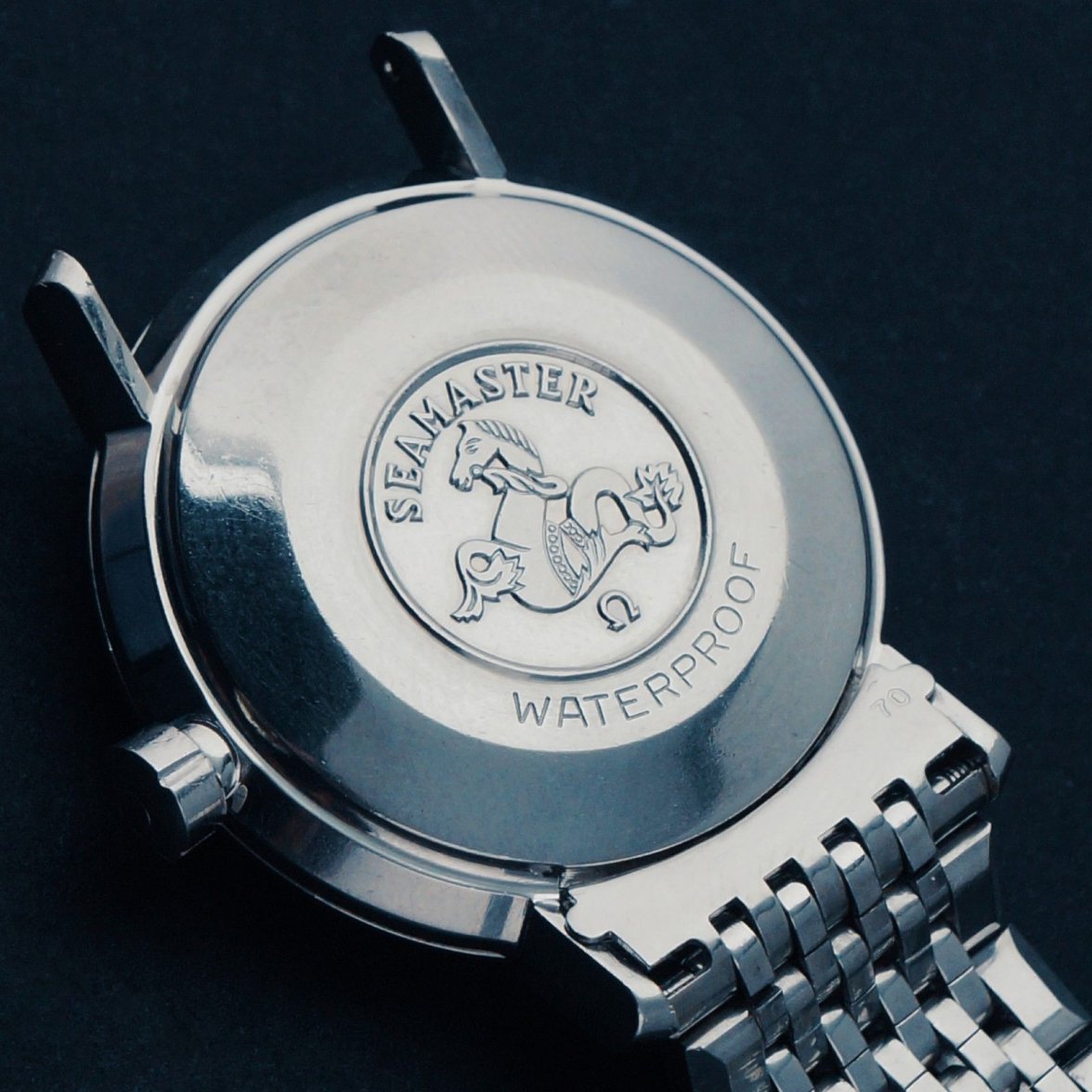

    A few more pix...
  5. kradakisland Oct 28, 2018
    19
    4

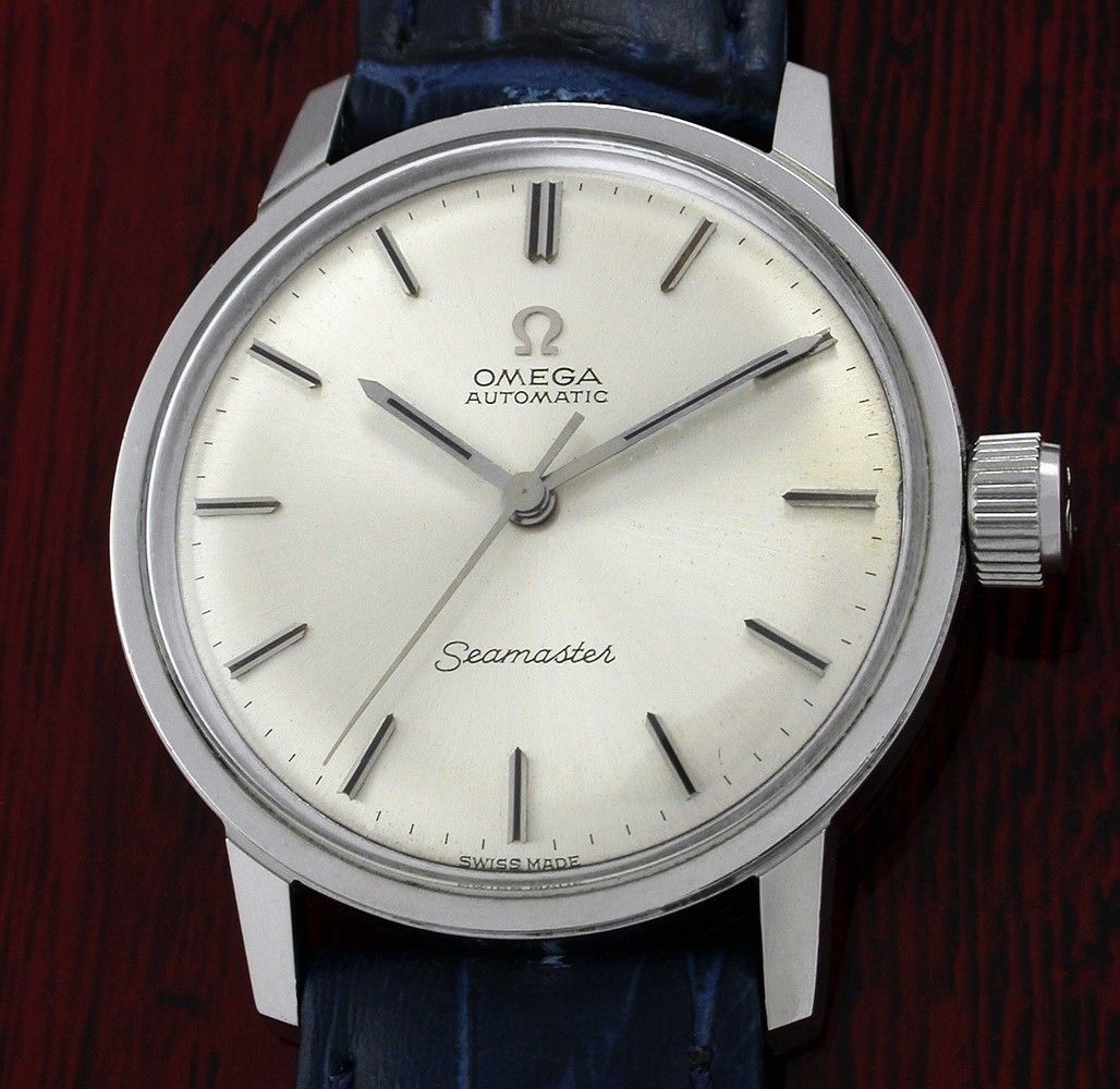

    BTW, thanks for your post. It's at 1500USD, but I have zero inclination of value...other than looking at other vintage seamaster options under $2k USD. Buying a second omega (other is a Ti 300M Chrono bought new in '01) with plans to keep and wear frequently.
    Was also watching this one (under 500USD, claims all original), but it looks suspicious to me because 1) the two A's in automatic aren't identical 2) the two 'e' in seamaster aren't at the same angle 3) the transition from S to T in seamaster looks blotchy 4) and the middle leg of the "M" looks offcenter...OR I could be just seeing things..which is why I'm on this forum.
    Edited Oct 28, 2018
  6. jimmyd13 Oct 28, 2018
    3,156
    7,166
    The first does look excellent but, as noted above, is going to need a service. I don't see any service marks on that caseback nor so much as a scratch on a screw slot, so it probably never has been opened. Still, at 1500 (USD?) that's really strong. I can understand the price given the condition but this isn't a really desirable model so it's at, if not already above, its top end.
    The second has far too many reflections to tell for sure but the dial seems fine. The case is showing a fair few scars from daily life (and rough strap changes) but, again, seems honest.

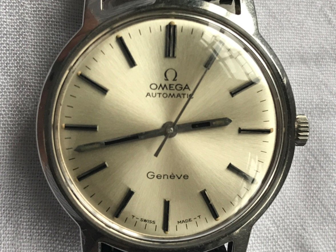

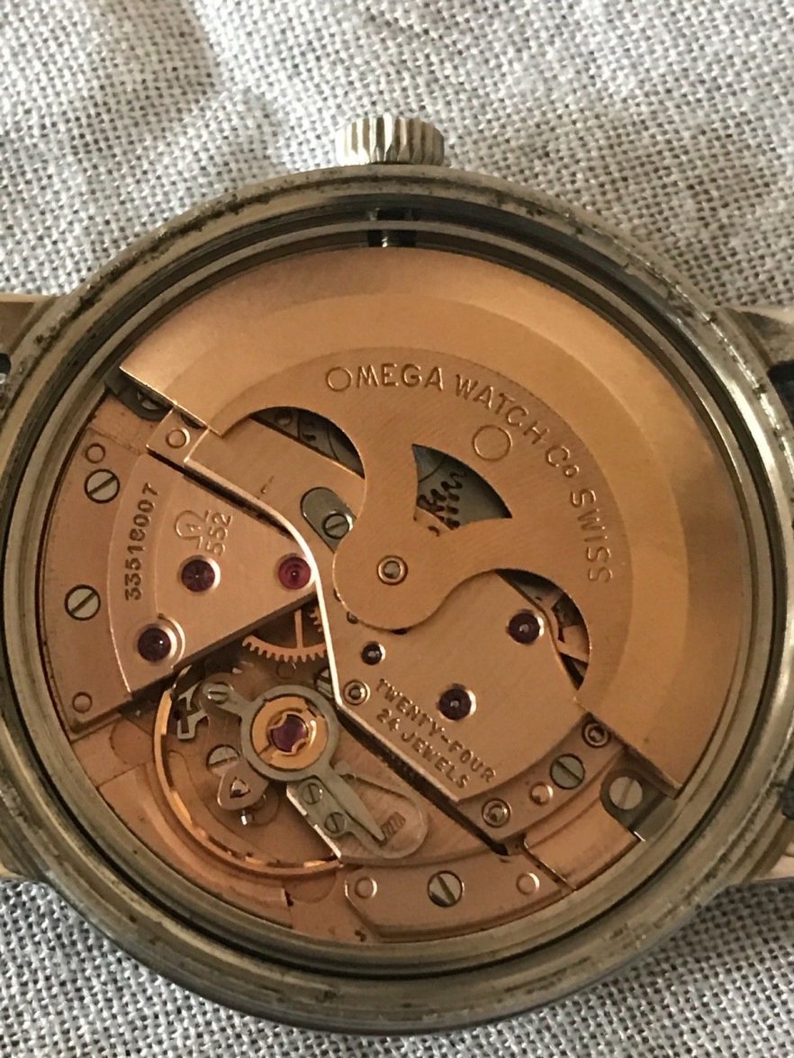

    Any insight on validity of this example? GIVEN: Geneve, 165.070, 35mm, 552mvmt, signed crystal, signed crown; CLAIMS: unpolished, not restored, dial/mvmt/crown/case original. Looking on vintage omega db 165.0070 has different crown...can I use this REF to compare? TIA

    Relume probably if you look at the different colours of the lume used. Crown isn't the right one

    Should there be or not be "T" on either side of "SWISS MADE" for lume?
  15. Edward53 Nov 19, 2018
    3,127
    5,384
    An obvious redial. Swiss Made in the wrong place for starters.
