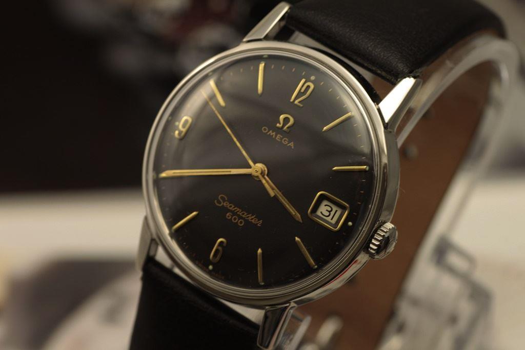

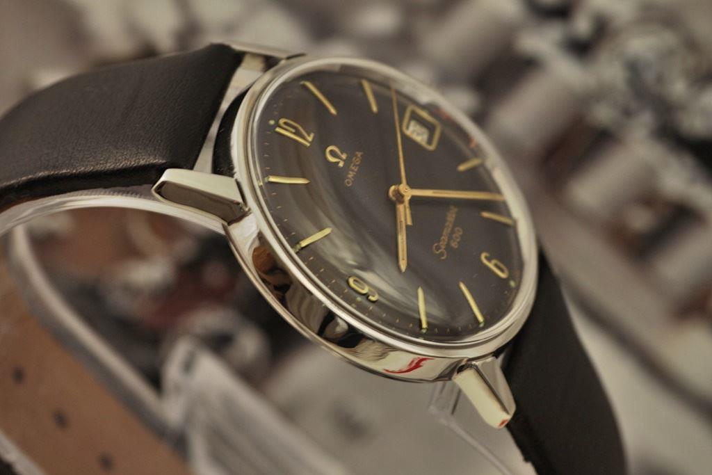

    Hello there!
    I'm new to the forum and found it while looking around for information about a new interest of mine which is omega watches. Started out with a inherited pocket watch and now I'm looking to buy a Seamaster.
    What do you guys think of this one? Is it redialed? Is it even fake? Worth? Any other tips for a newbie in the game?

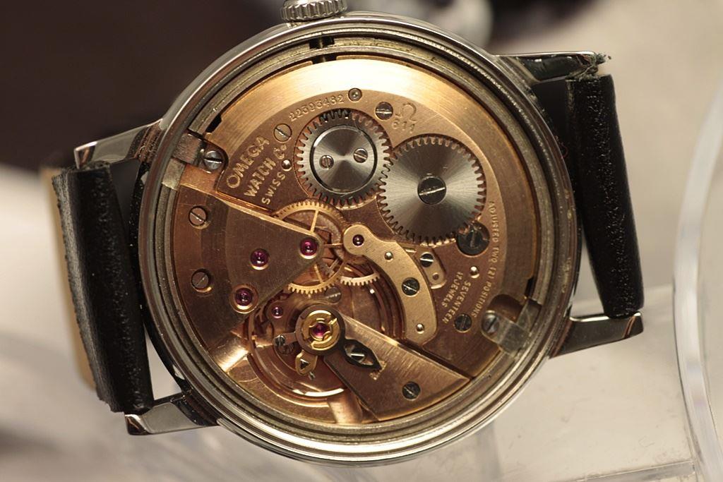

    Seller claimes it to be a Seamaster 600 cal.611 Serial 22392432
    Thank you!
    Edit: Seller also claims glass and strap is new but this doesn't bother me as much as the dial. :)

    I'd wote redail, and the case is polished beyond what's acceptable. Keep looking is my advise.

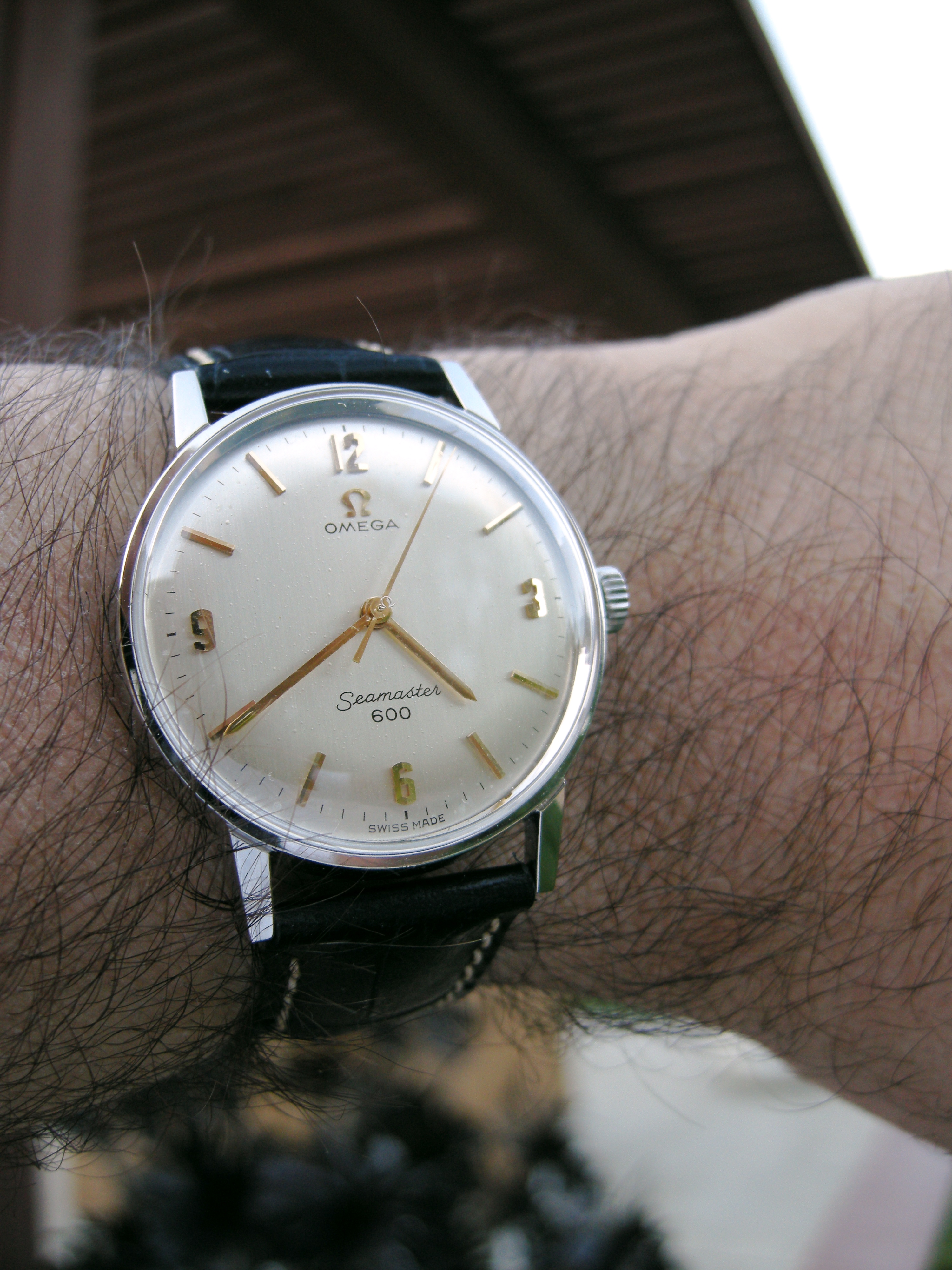

    If it's a refinished dial, it's amongst the best I've seen. Compare with an original cal 601 equivalent:
    [property of a friend; my photo]
    Script is spot-on; lume artfully applied.
    Leaning towards an original dial; if it turns out to be refinished, I'd like to know who performed the work.

    Redial.
    Biggest tell are the gold figures, polished and smooth edges, original would have nice crisp edges.

    I noticed that, and the texture of the paint as well, but the matching script is difficult to ignore. That's where most refinished dials reveal their origins.
    If it proves to be refinished, the work is commendable. And that's coming from a guy who hates re-dials.

    Happened to find the ad on a local auction site a minute ago, and it says the dial been "renovated".
    Sorry Dr No, it does not say who did it ;)

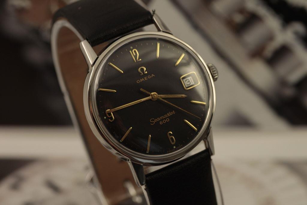

    I can see a couple of honest Seamaster 600's on that site that I would take at closer look at if I was shopping for one. Not black dials, but those are very rear finds if not redone.

  13. Vicke Feb 9, 2017
    455
    769
    J-Carlos likes this.
  14. J-Carlos Feb 9, 2017
    6
    Yes i have seen it! And it definitely caught my attention. But i think as well as you said that it's a bit hard to tell from the pictures about the dial.
    What is your opinion?
    I asked now for a better photo of the dial and more information. But another thing about this seller is the way he writes.. All caps and not very grammatically correct either.. Hope I receive the answer before the end of the auction which is tomorrow.
  15. Vicke Feb 9, 2017
    455
    769
    Nothing stands out as obviously wrong, but without better pictures it is a big risk buying it.

    The S in the OP is completely wrong, IMO. In fact, I don't think that S resembles any original S from Omega. I don't know what you meant by matching script either. The full Seamaster script is also completely different from the watch you posted, especially the "e" letters.

    Sorry, just seeing this now. After reviewing the photos a second time, I can see differences, particularly with the small 's' in Seamaster.
