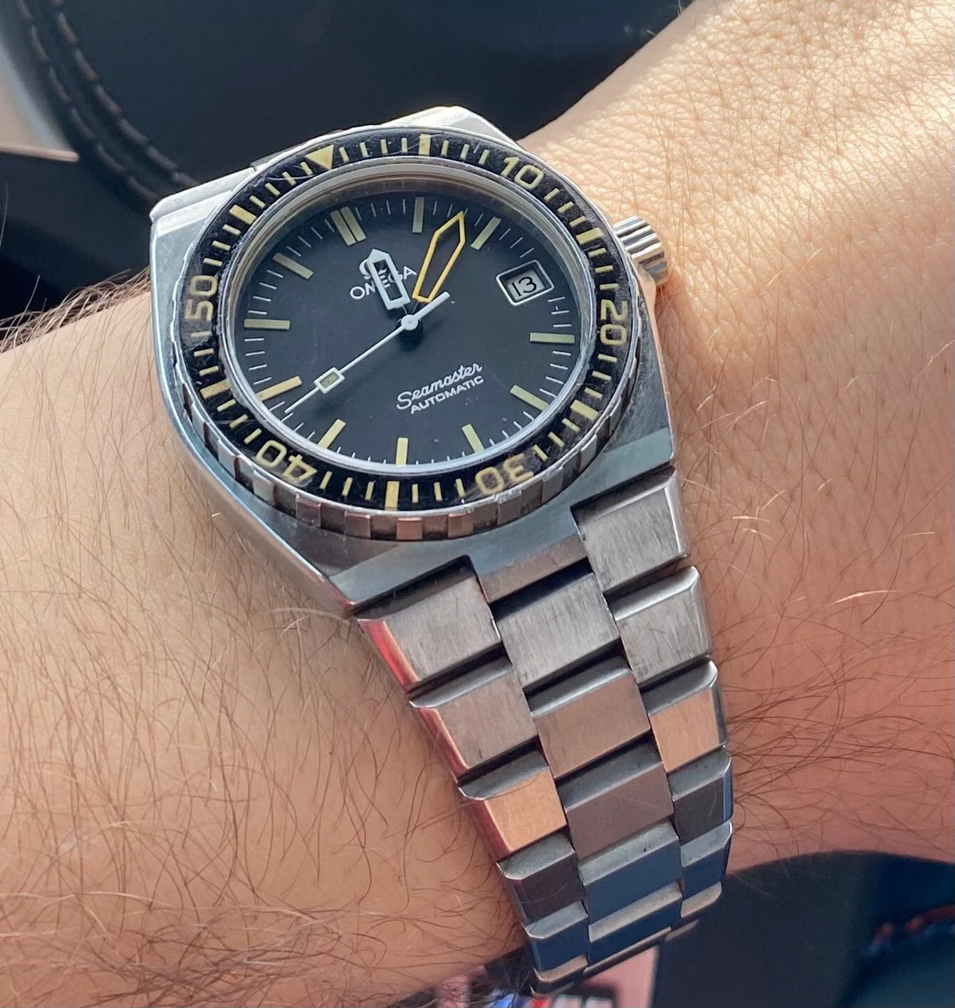

Hi all, I've been looking for one of these older Seamasters for a while and have seen more than once where the lume(?) on the hands is gone? Was wondering if anyone has any knowledge of this situation? Does the lume just deteriorate and fall off? Any info is greatly appreciated!

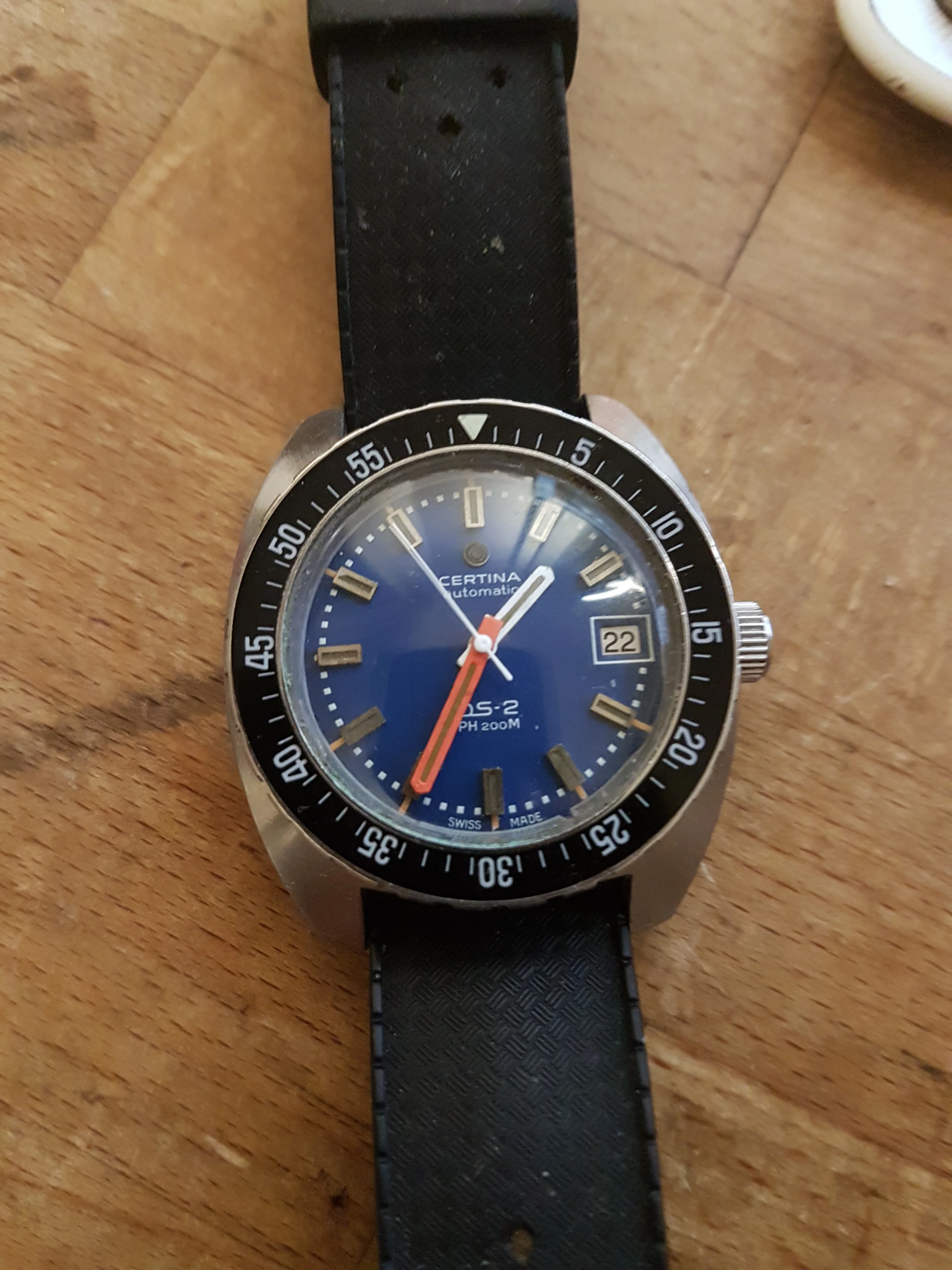

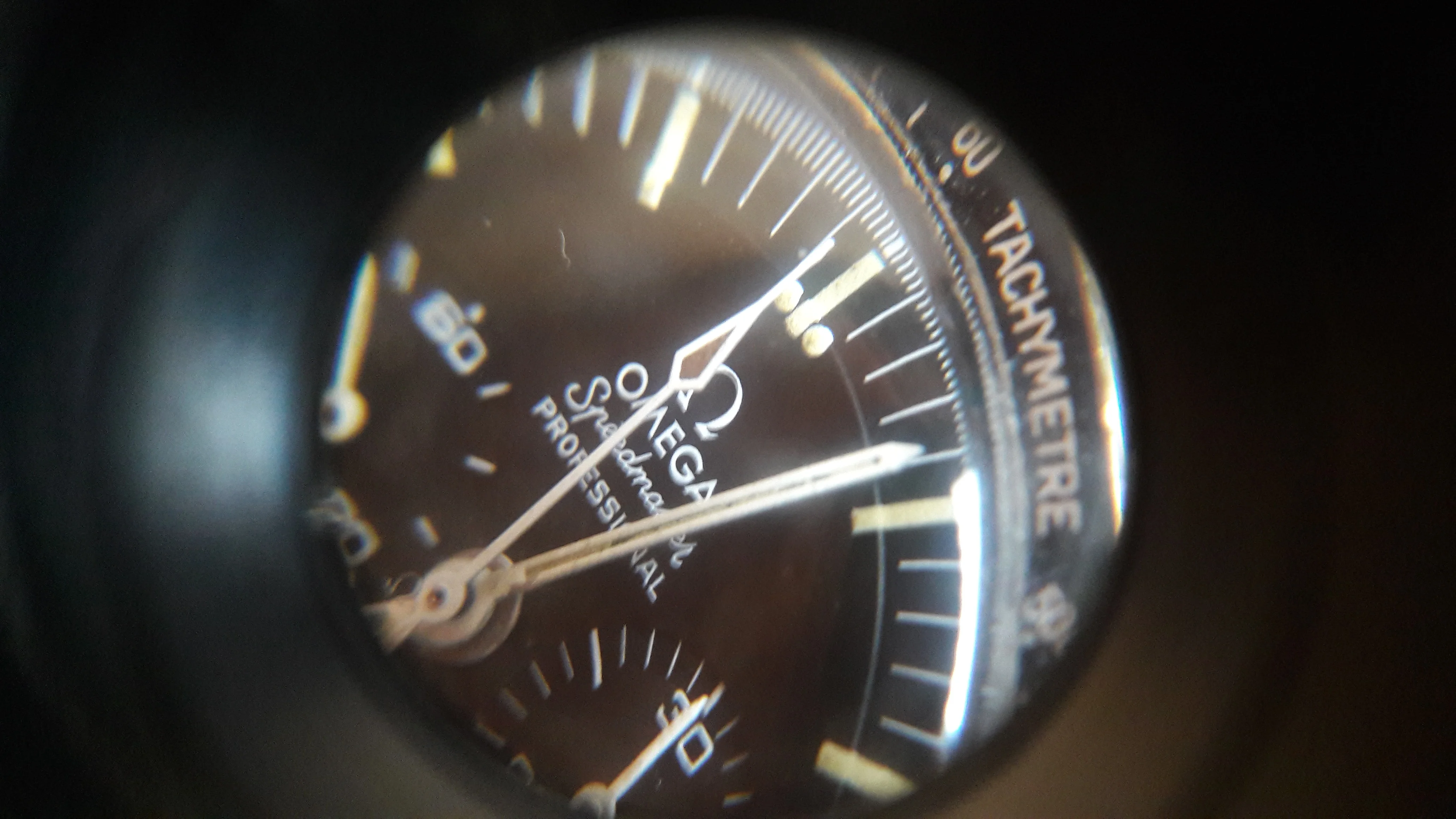

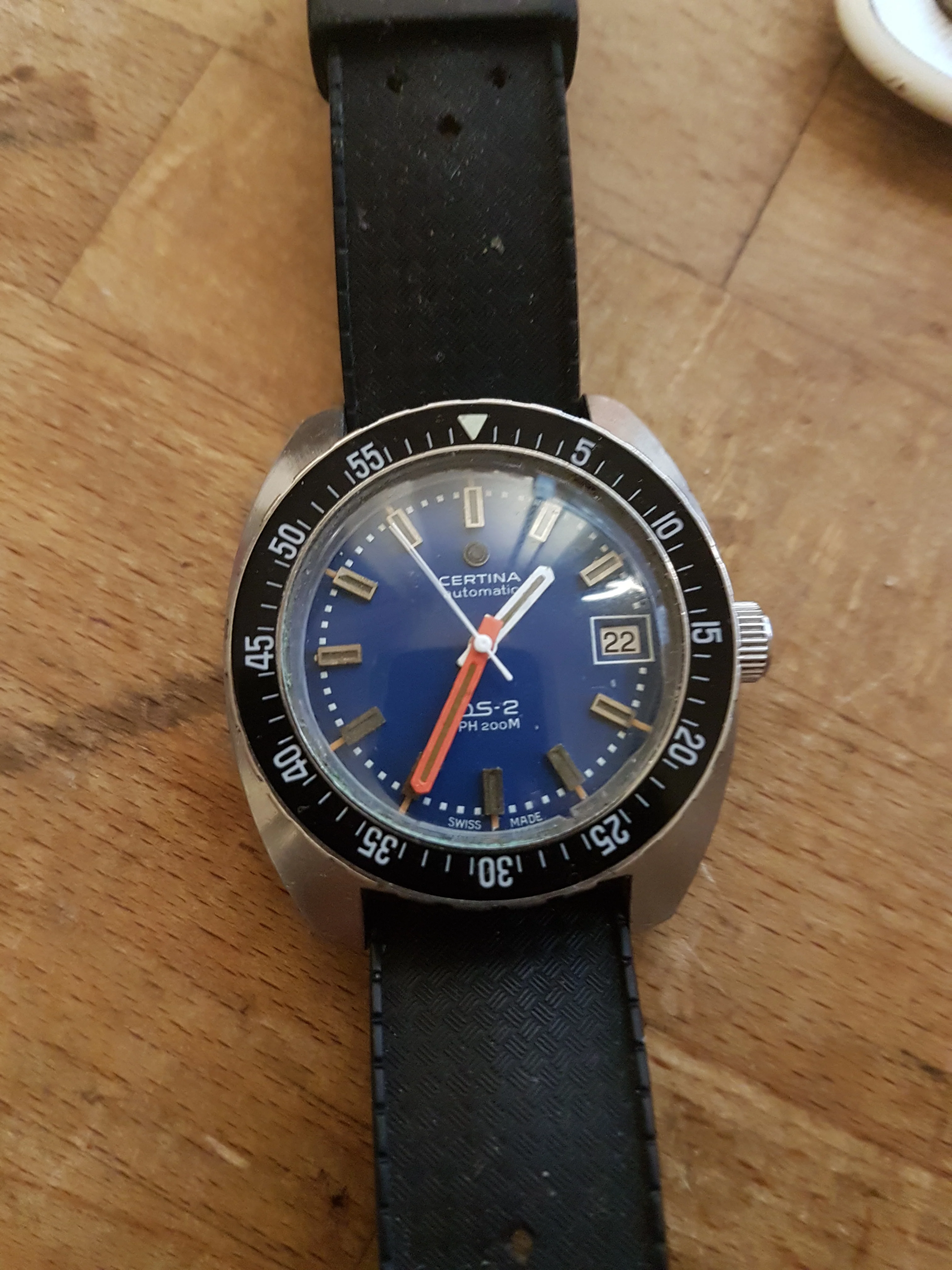

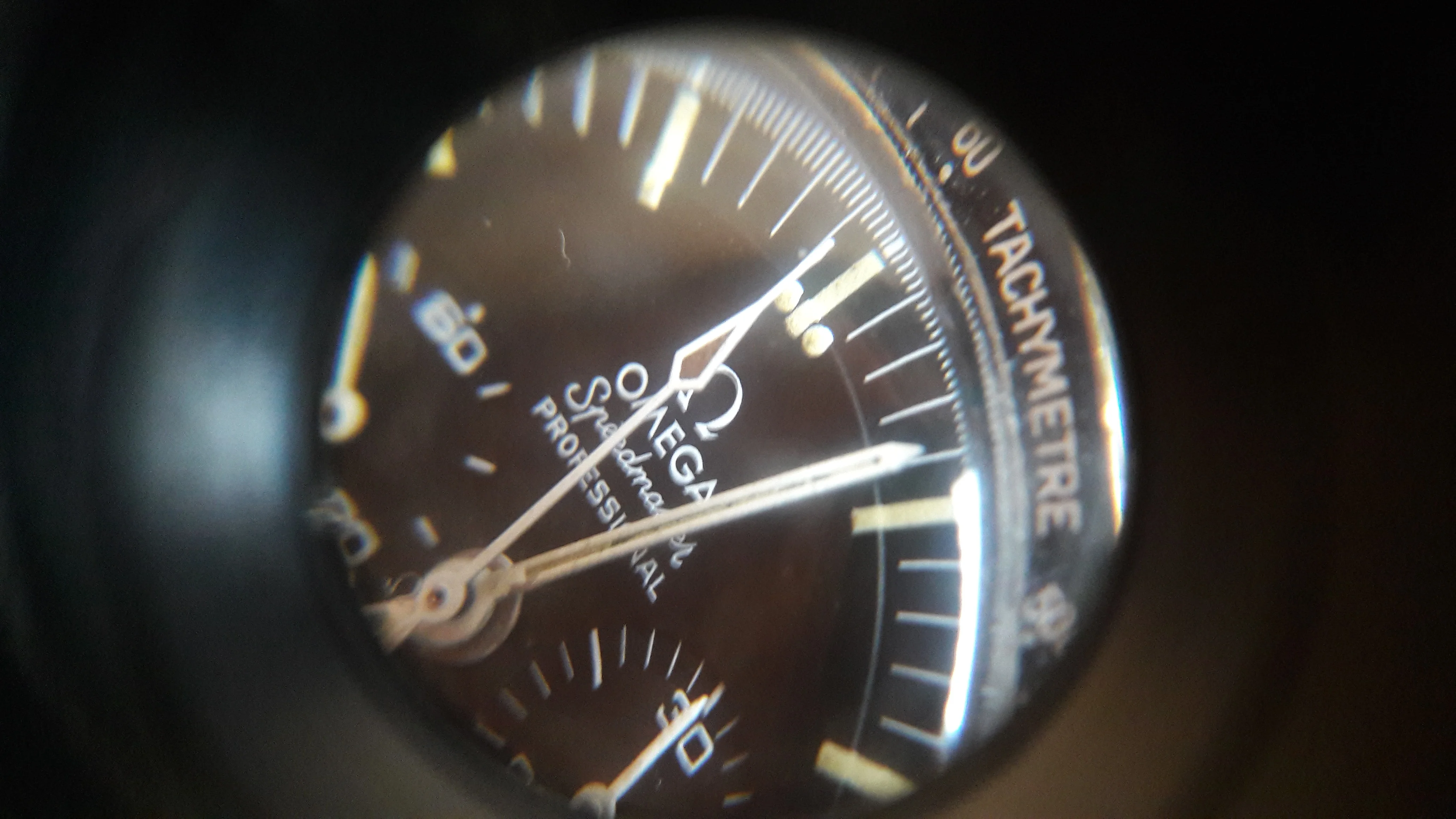

This happens. the larger the surface is, the bigger the risk. When I fix this kind of hand i use a mix of pigments, luminova, and thinner.
this often gives good results. the lume is not as bright as if it was alone.
exemples on a vintage Certina diver and a chrono hand.
