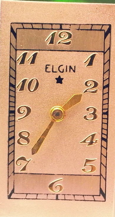

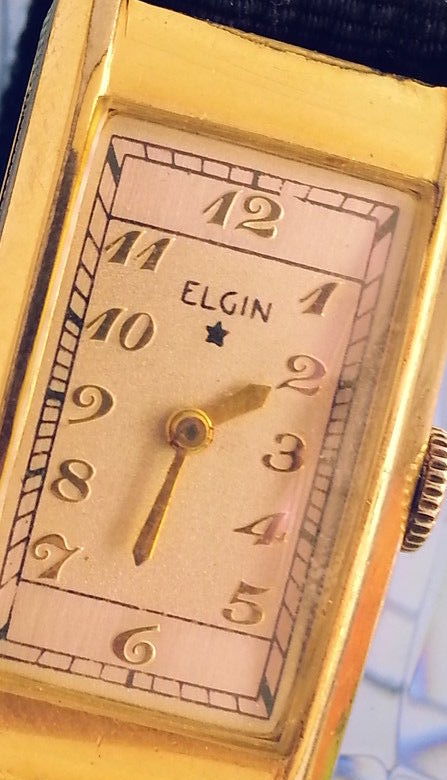

    Hi there people,
    Would love to hear your thoughts on this dial.
    Any comments on its signed dial and markings?
  2. autoquartz Apr 4, 2017
    34
    23
    I figure i could start: I am suspicious of the shaky words and lines on the dial...
  3. gatorcpa ΩF InvestiGator Staff Member Apr 4, 2017
    12,204
    15,718
    Almost certainly a redial. However, with American wristwatches the practice is more accepted.
    Quality could be better, but not terrible.
    gatorcpa
  4. SeanO Apr 5, 2017
    1,306
    1,443
    the only real "tell" will be to get the dial off the movement and look for the refinishers mark on the back of the dial.
    as gator said above it's no deal breaker with these sorts of watches.
  5. shaun hk Fairy nuffer Apr 5, 2017
    1,425
    1,516
    What is the refinishers mark ?
  6. SeanO Apr 5, 2017
    1,306
    1,443
    when someone like International Dial refinishes a dial for a customer they place a mark on the back of the dial indicating that they have done it (similar to a watchmakers mark on the inside of a case indicating a service has been done).
