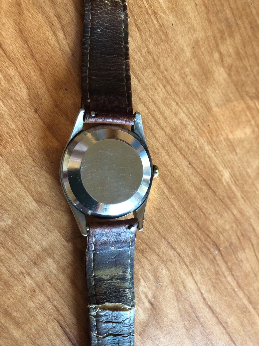

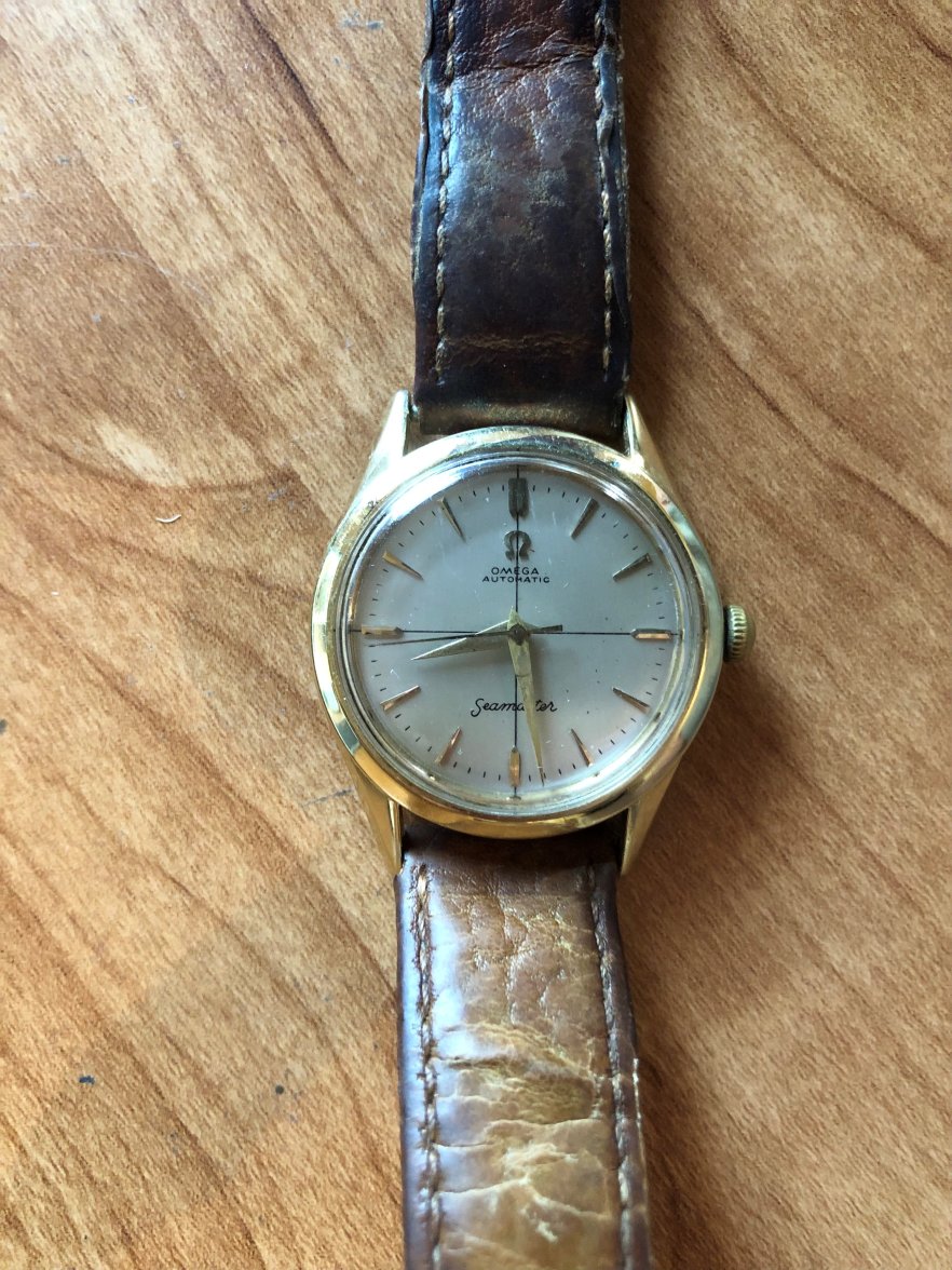

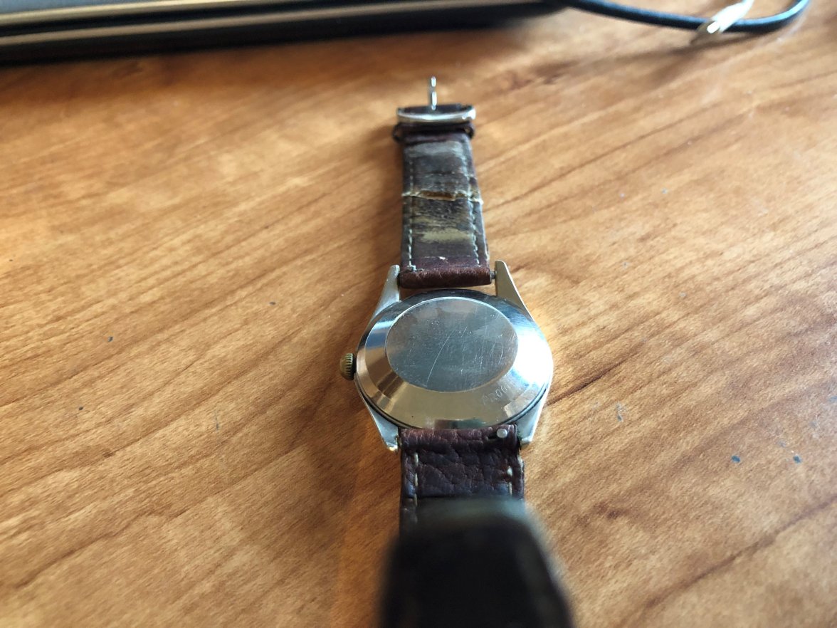

Hi experts,
we inherited what looks like a vintage Seamaster. however it does not have any "Swiss Made" on the dial and there is nothng on the back except a really faint "WaterProof" on the angled back bezel which I've tried to capture in a photo.
Would love to know - Fake or real and what model?
any help appreciated!
Steve
8,284
29,296
Vintage? Yes. Original? No, the dial is refinished.
Real? We would need to see the movement and inside of the case back.

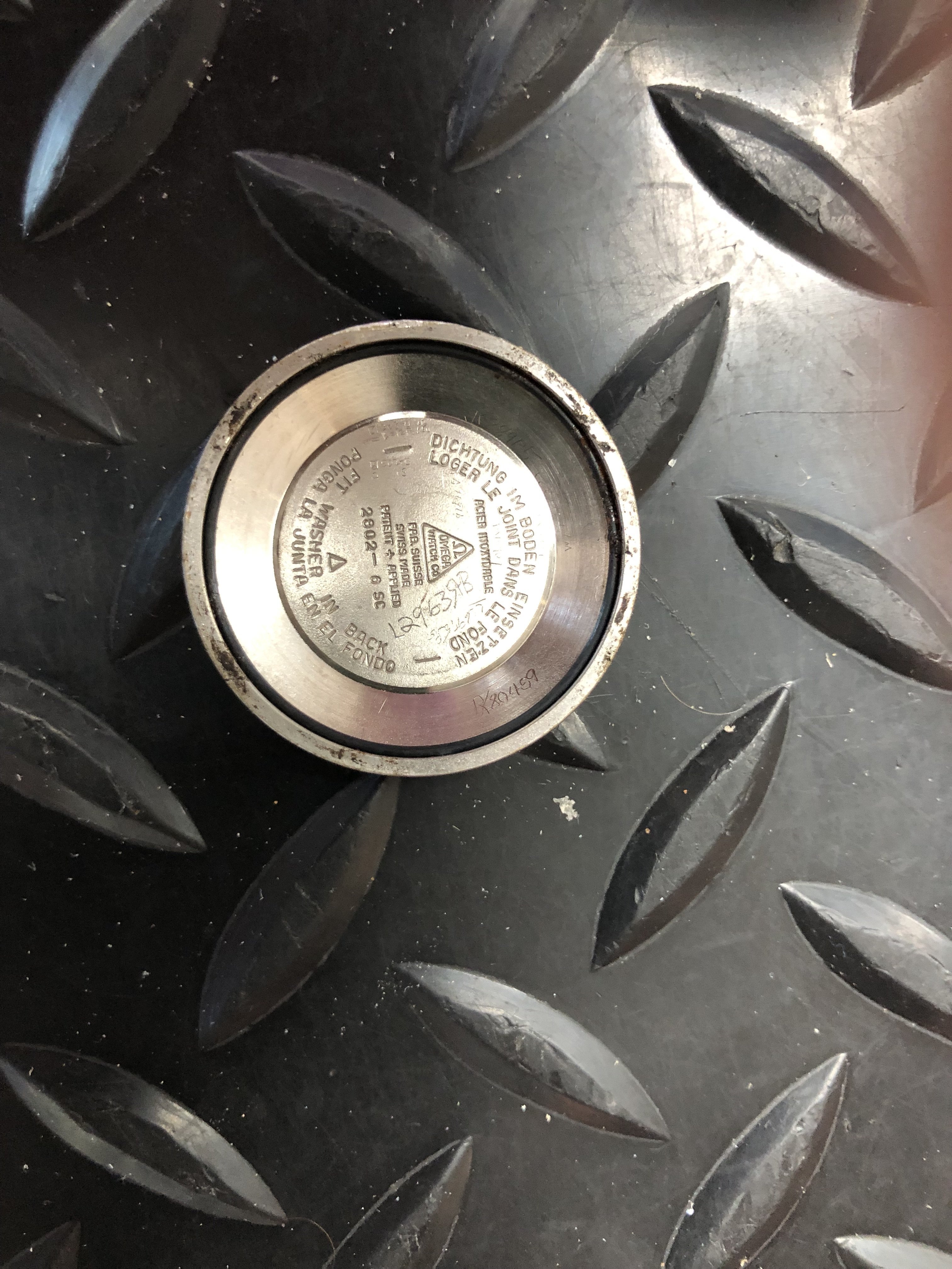

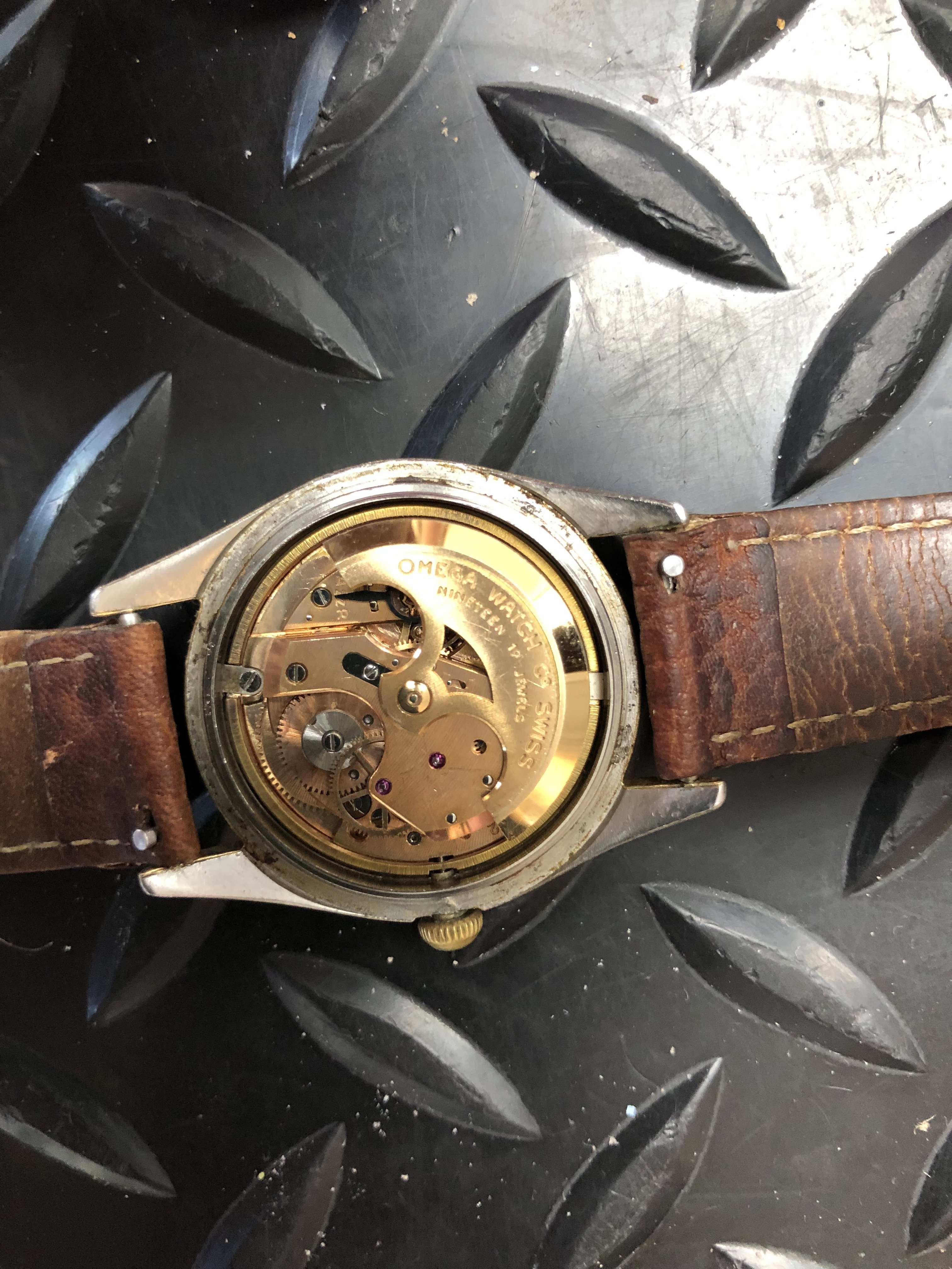

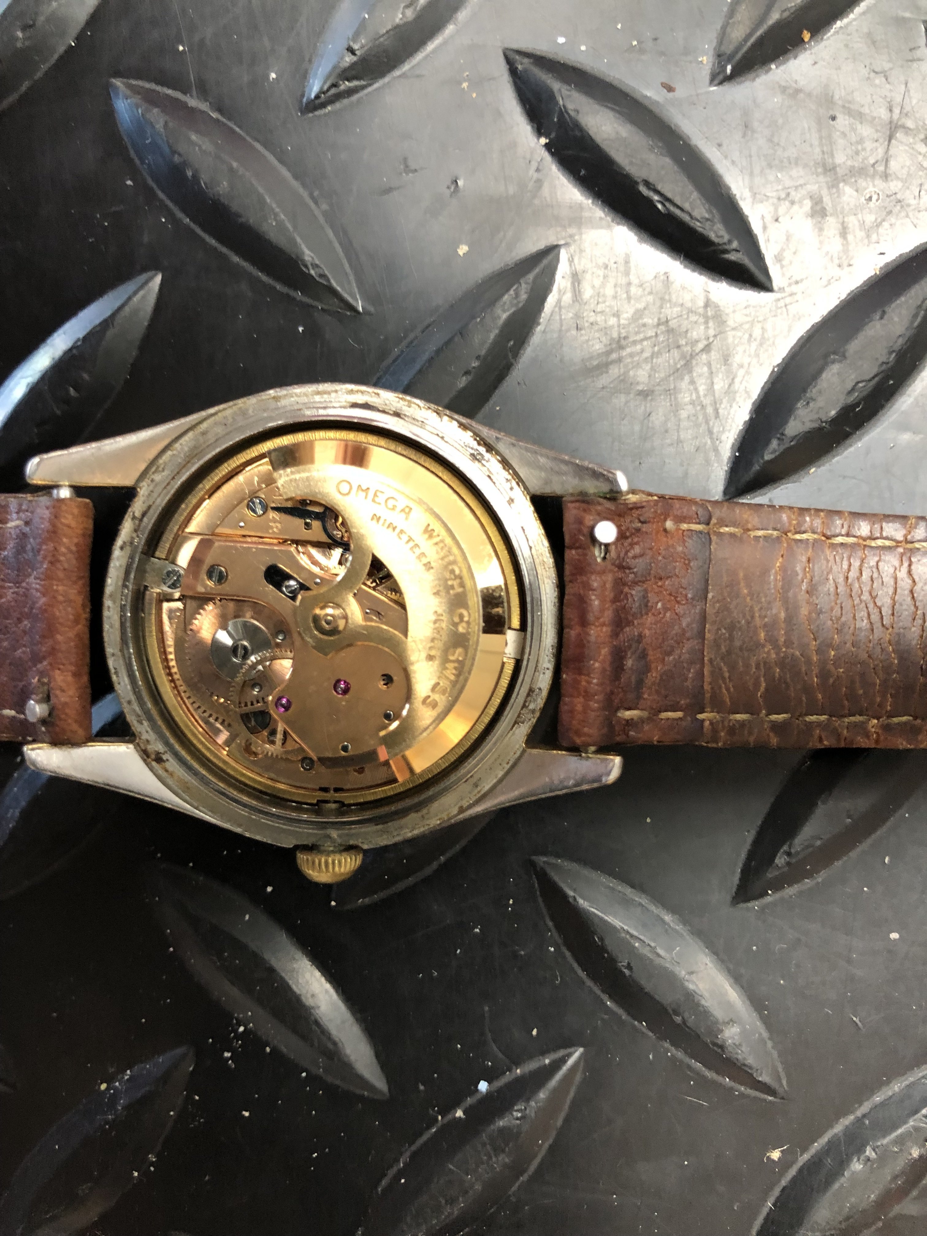

5

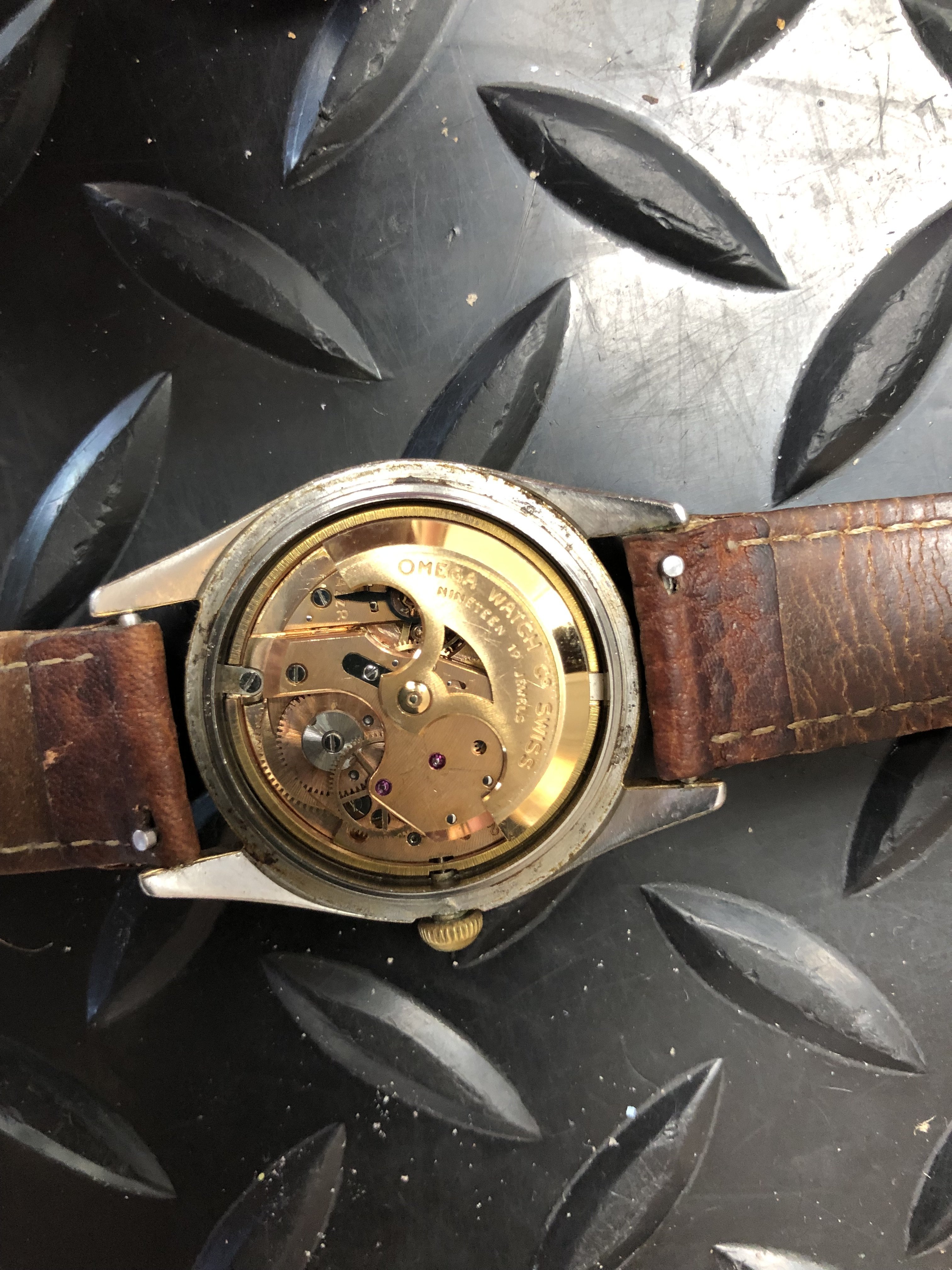

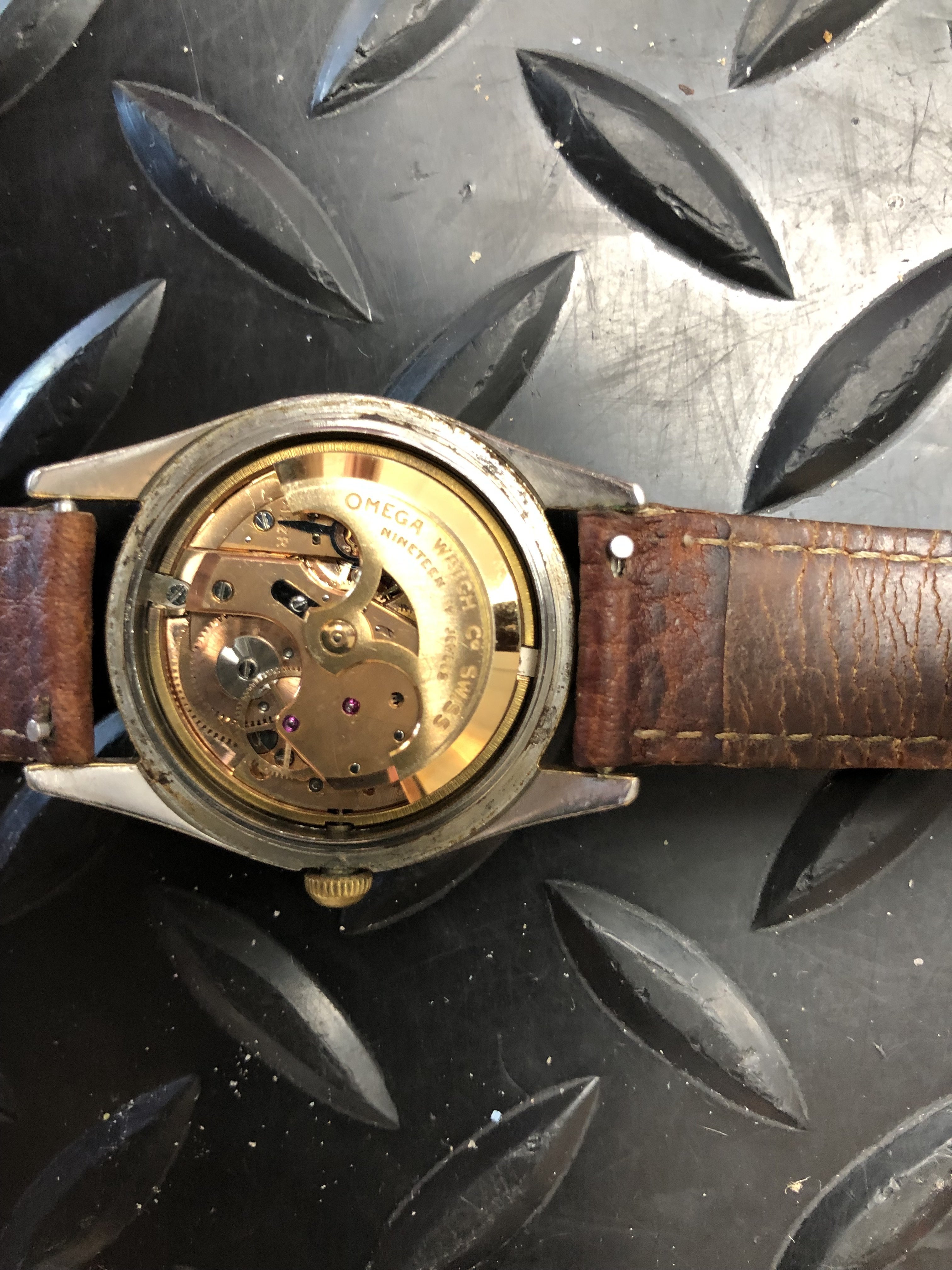

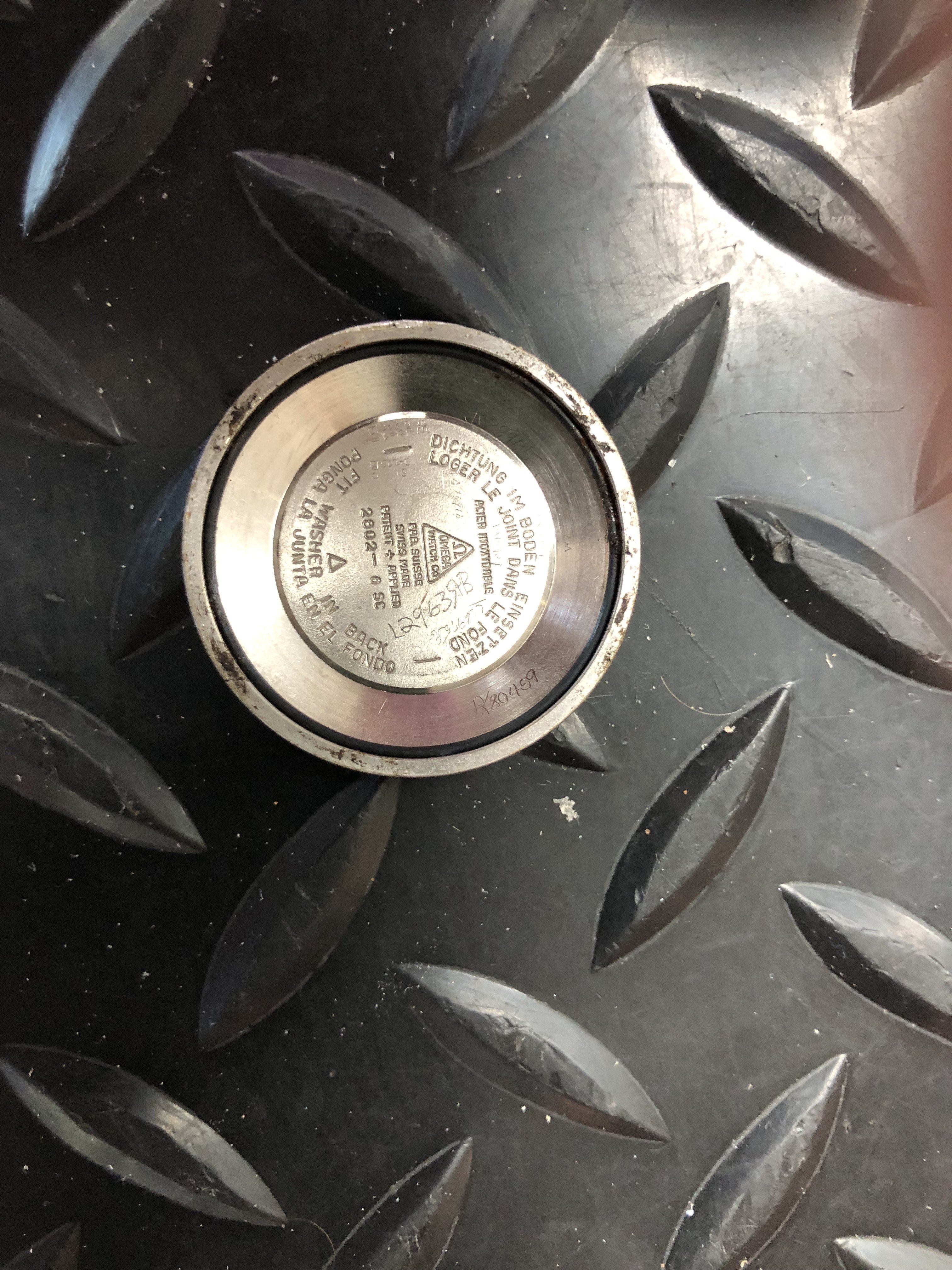

thanks for all the advice - appreciate it!
Here's the inside and the inside of the back cover
907
1,742
Now you know it is a case 2802. If you move the rotor you can find the caliber # and the serial number.
907
1,742
Not fake. Looks to be in good shape, but get in serviced if you plan to wear it. Should be a cal 471.
3,013
4,781
Redial perhaps, not fake.
Will need a service as the oil will be dry.
A good watch.
