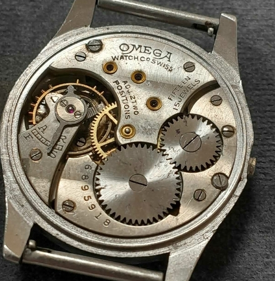

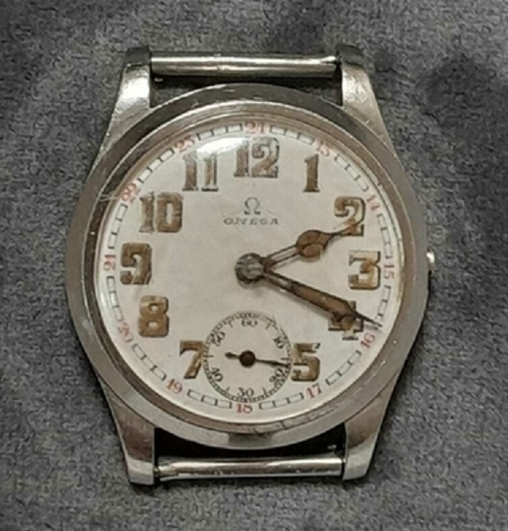

Posts 256 Likes 151 myk11 路Feb 2, 2024 Hello everyone ! Help identify Vintage Omega wristwatch Thank you
Posts 8,881 Likes 62,903 TexOmega 路Feb 2, 2024 Yes, I can confirm. That is a vintage Omega wristwatch.馃憤

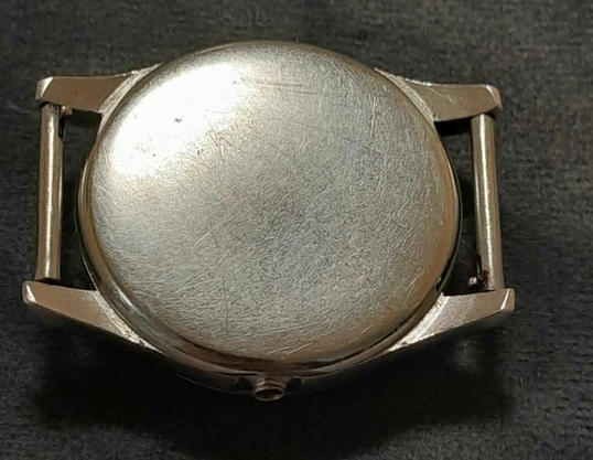

Posts 8,881 Likes 62,903 TexOmega 路Feb 2, 2024 Appears to have an 1910ish movement(OMEGA FONT on the movement plus serial #) in a later case. Don't lick or snort the lume

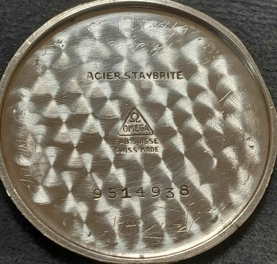

Posts 13,493 Likes 31,814 X350 XJR 路Feb 2, 2024路Vintage Omega Aficionado 689xxxx would be ca 1928 so the case seems age appropriate. Calling @Tire-comedon for help on this one.
Posts 13,677 Likes 19,049 gatorcpa 路Feb 2, 2024路惟F InvestiGator Here is an old post with some date charts. https://omegaforums.net/threads/wha...e-in-the-omegamani-serial-number-chart.68711/ I think that a movement from the late 1920鈥檚 and a case from the late 1930鈥檚 is just too large of a gap. IMO the movement is a correct cal. 26,5, just not the one that went with this particular case. gatorcpa
