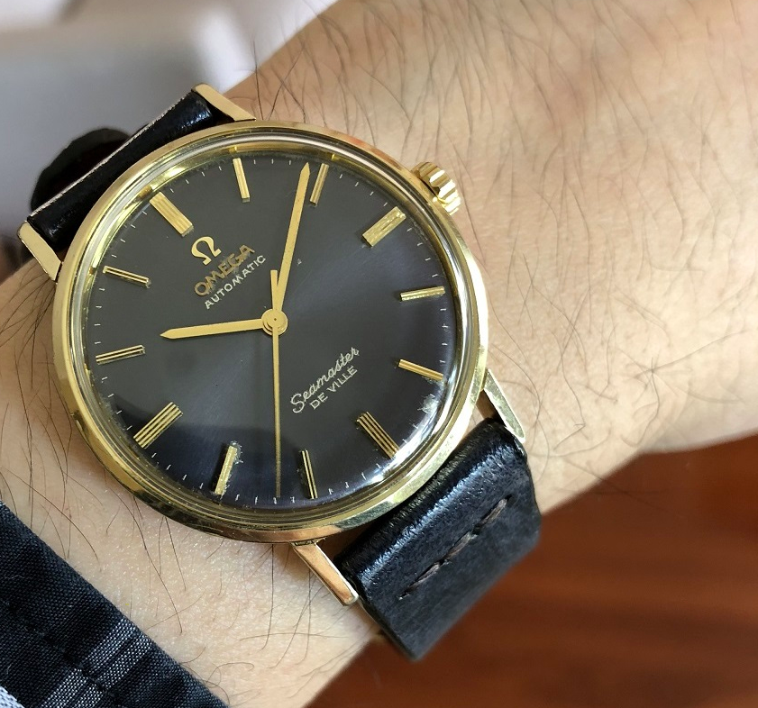

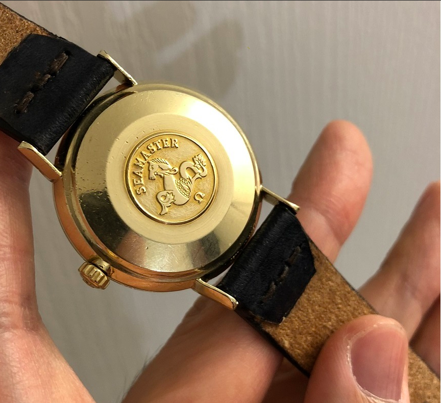

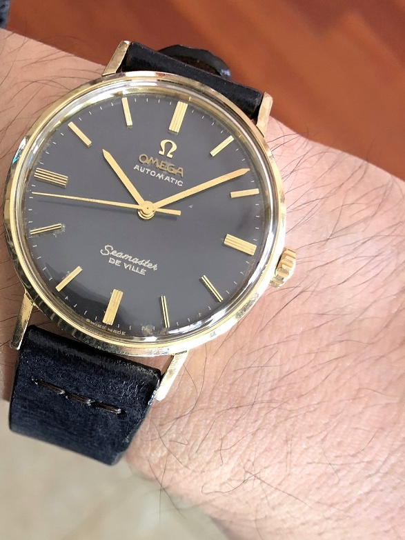

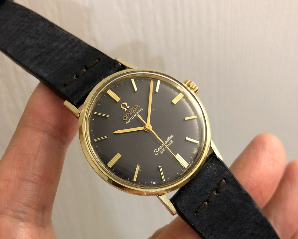

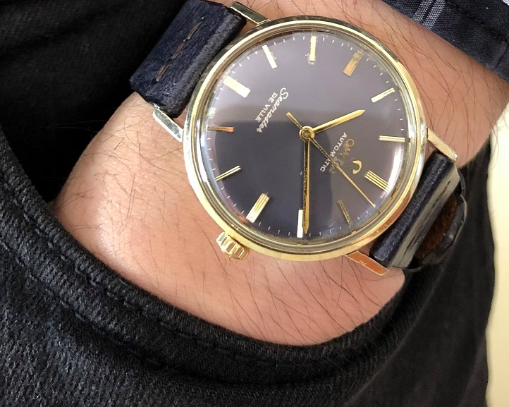

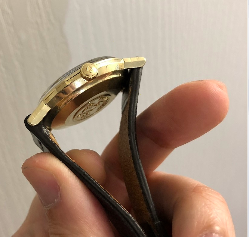

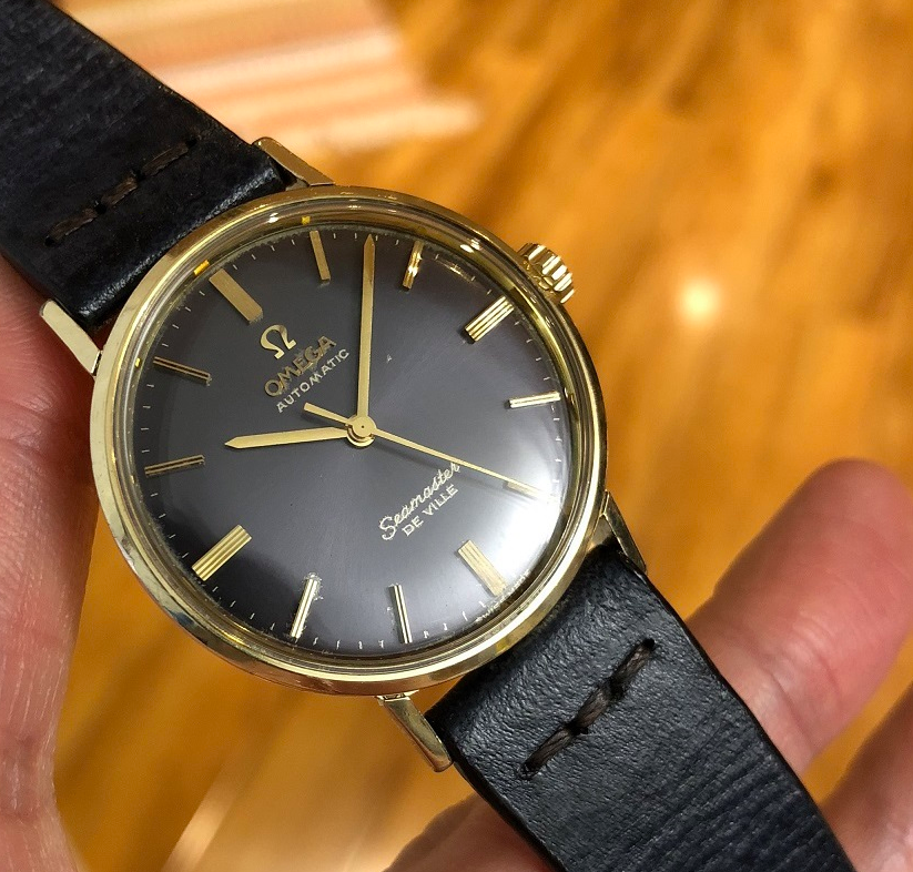

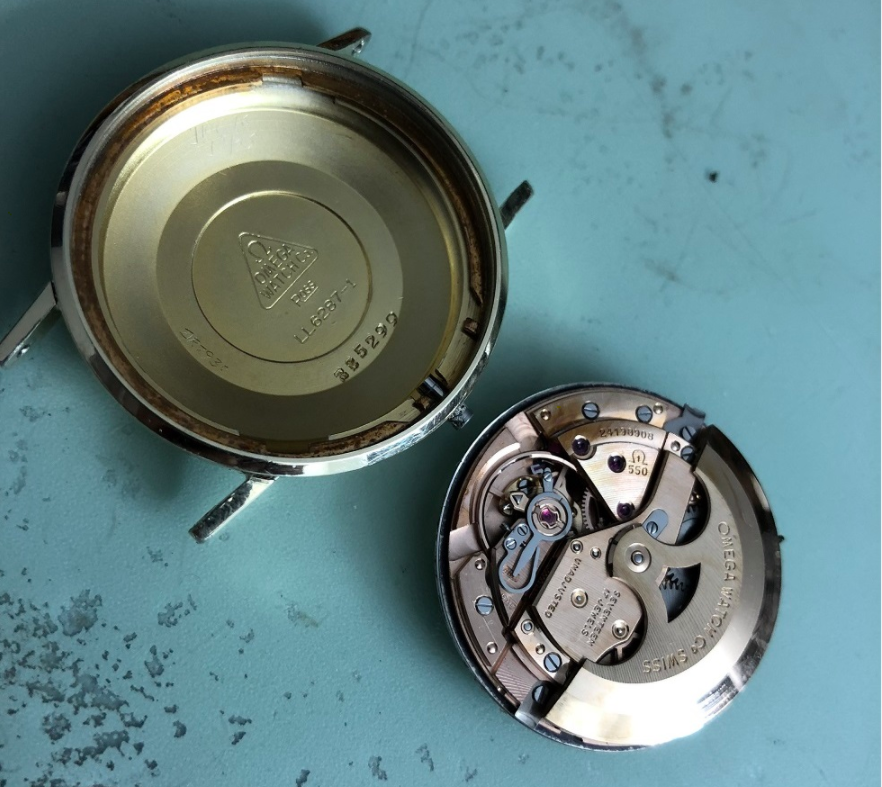

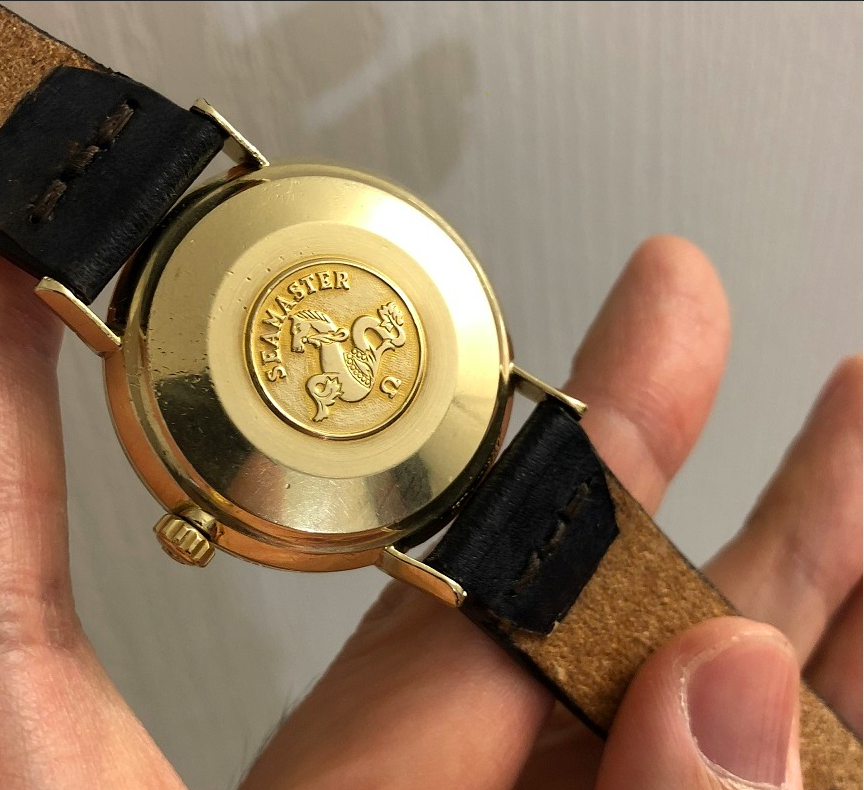

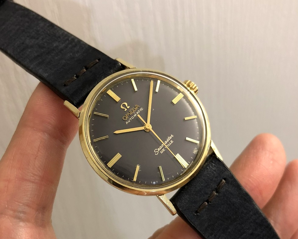

Hi guys,
I would appreciate your advice/feedback for this watch that I found. In my opinion, it's all original except strap and buckle.
Here are some characteristics :
Circa: 1966
Model: Seamaster De Ville
Caliber: 550
Movement serial #: 24198908
Jewel count: 17 jewels
Movement type: Automatic wind
Case model: LL 6287-1 (335299)
Case material: 14k Gold filled
Case gasket: Does not take a gasket
Crystal: Acyrlic New crystal
Crown: Signed
Case Diameter excluding crown: 34mm
Case lenght lug tip to lug tip: 40.5mm
Dial: Factory original finish
Hand type: Index (original)
Thanks a lot in advance for your input!
32
9
I forgot to mention the price (USD 1650). Is it worth it ?
Please feel free to give any advice to a newbie like me
Lud
1,120
1,792

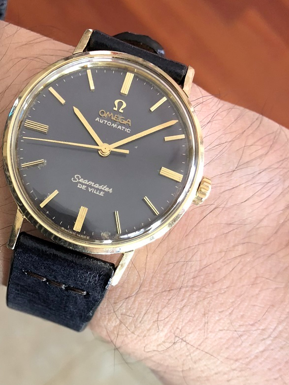

The dial looks to be original but better pics would help to be certain.
Is that dial damage at the 27 minute marker?
The case looks decent and everything about the watch appears original.
Price is way too high at $1650.
2,720
5,554

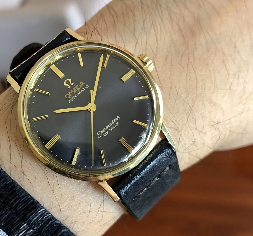

There is dial damage at many points. If this were a solid gold watch it still would not be worth the price.
2,086
2,899
If you take your time and look around a bit, I'm convinced that for US $1,650 you can buy two nicer watches that match your taste.
32
9
Thanks all for your feedbacks/advices. That's helpful.
I'll look around.
346
1,261
Not a bad watch, but not worth the price at said above....
8,174
36,709
I find it quite charming, even taking the dial degradation and case wear into account. Unfortunately the price point is for me about 2.5x too high. At $600-$700 I'd say it would be decent value, but above that it starts to look expensive for what it is.
32
9
Thanks for your inputs. I'll pass on this one. I'll find one at a more decent price.
297
267
I'm no expert but, I do think the black dialed Seamasters do command a higher price. How much more, I can't answer that.
