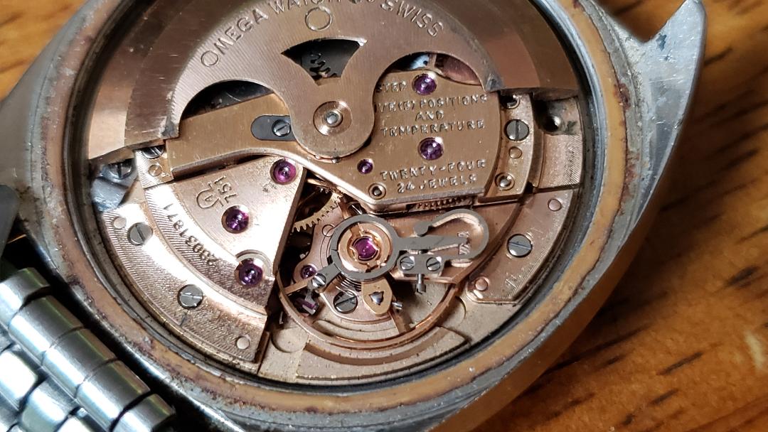

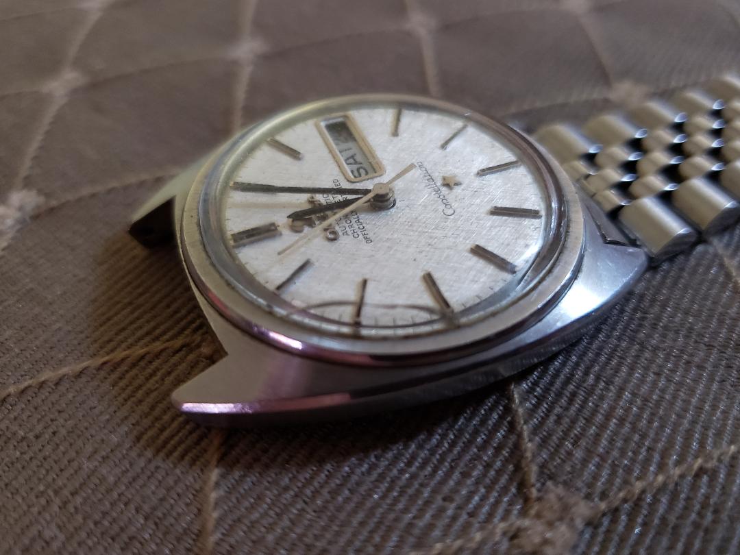

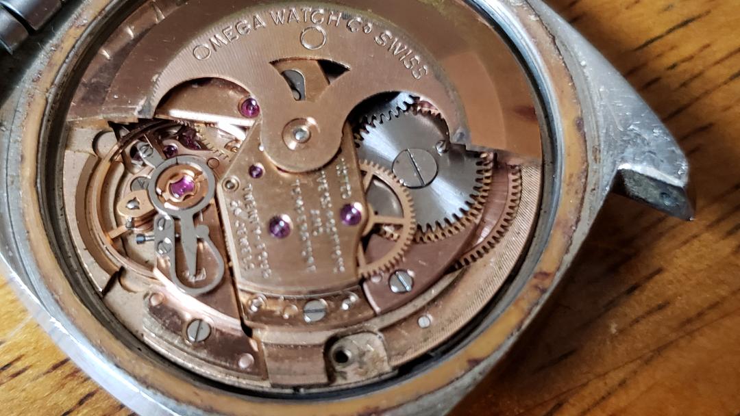

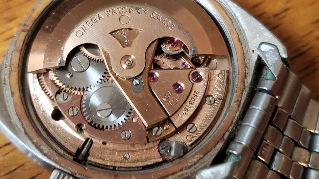

My father gave me an Omega 168.019 stainless steel in the mid 70 not long before I left my family, escaped the communist and seeking freedom in the US. It was pass around in our family, had been neglected and forgotten. Finally I located and got it back from my brother. My brother had it repair once along with replacing a cracked crystal (not an Omega crystal). The watch is currently not working and the crystal is cracked. The hands and the day/date are still operable by moving the crown/sharp. I would like to repair it for memory sake and may be give it to my son. My watch services shop (who had done work on my Rolex and Vintage Omega 168.018) had pass on it for reason that the original crystal and parts are hard to find for this watch model. With the help of one of the OF member, I was able to find a correct Omega crystal for the watch. I could send it to Omega for the service but refer a hand on experience watchmaker. Thanks

Easy to do. Service no big deal. You might need a rotor axle, because the rotor is scraping the back. And pls. Get 2 correct case clamps and screws to have secure in the case. Kind regards. Achim
30,285
78,160
Would be unusual to need the axle - however it needing a new rotor pinion is a certainty.
