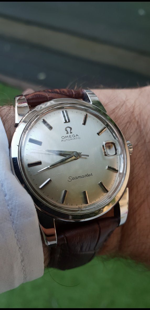

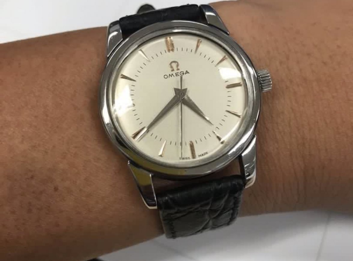

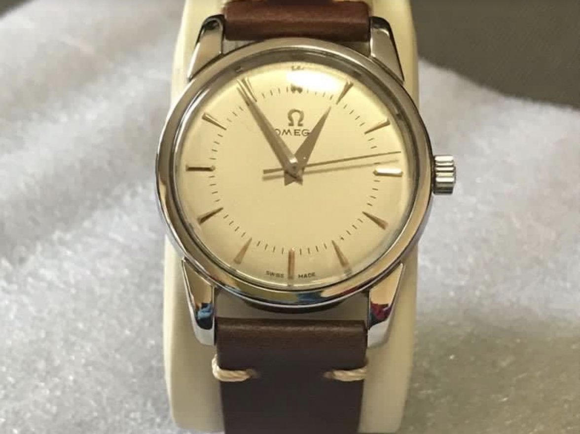

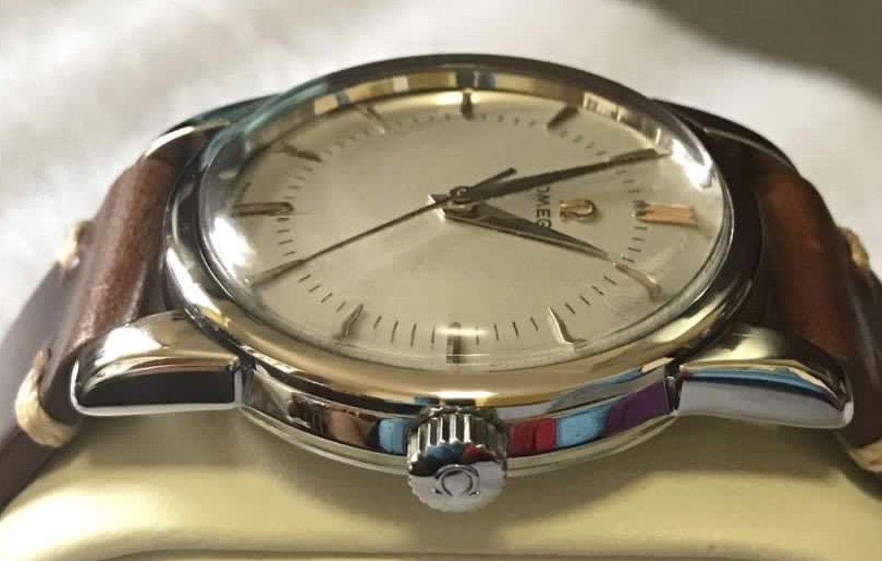

Pretty certain that the crown is not original, and honestly, the dial has my redial antenna tingling, but not 100% on that either. Case edges seem soft for what they should be too.
2,720
5,554
Welcome to the form. The case has seen a hard polishing, I would say that is most likely a redial. Once again 馃槨, we need the price for a full evaluation. If it is $100 go for it. If it is $1000 no way.
2,086
2,899
I think the dial has been refinished (I'm not even sure it's the correct style for this reference) and the hands are not matching the dial.

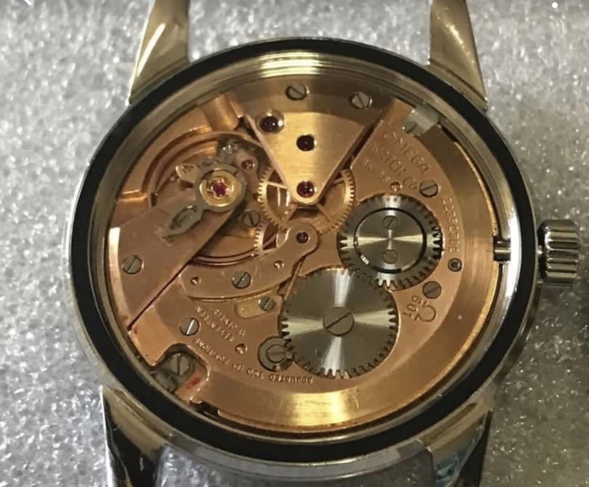

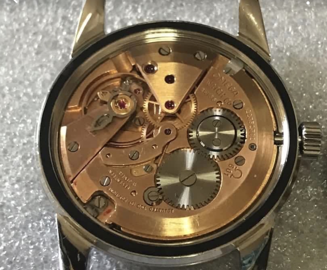

Then ref. 166.009 should have a date feature automatic cal. 562 movement as well, which doesn't match the cal. 601 movement.
Looks like a put-together (franken) watch to me.
I agree, my first response, "that's a mutt."
This. For $100-$200, it's a nice looking fashion piece. For much more than that, it's not worth spending money on.
