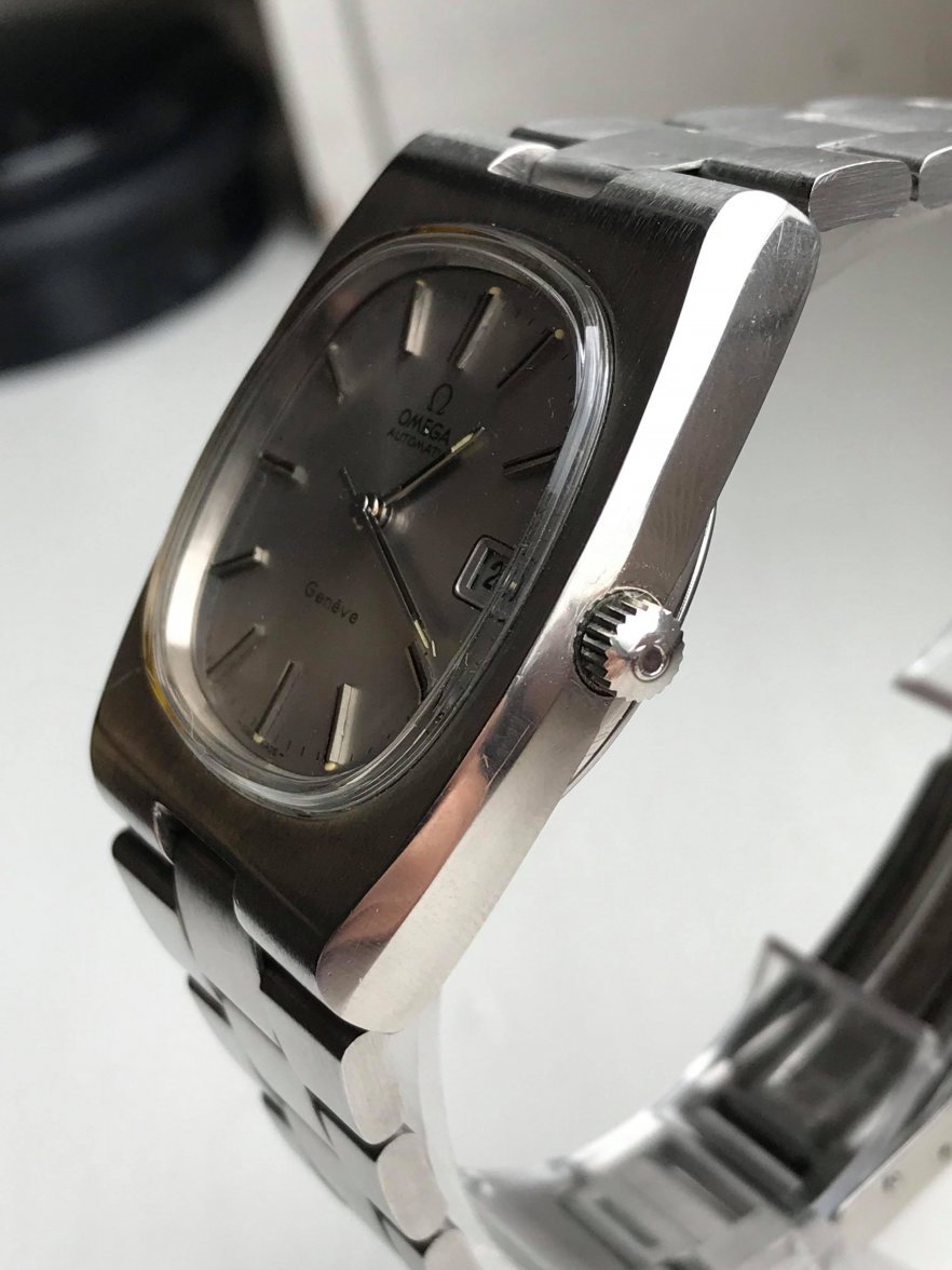

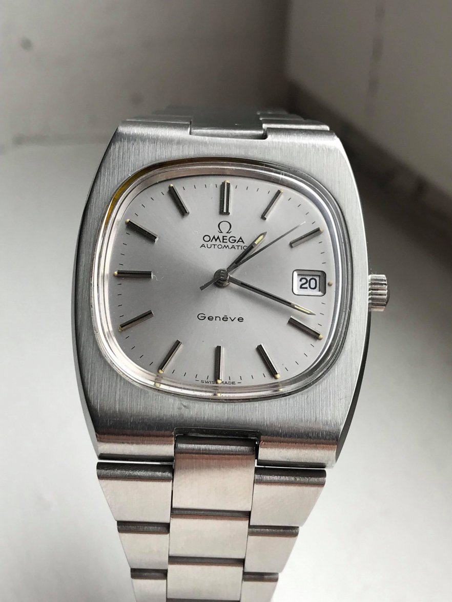

Offered at 605 dollars (550 euros). Is this a good deal or should I offer less? Any extra information on this watch is very appreciated!

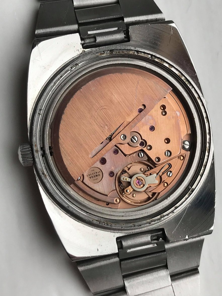

The watch dates to 1973/74 and the cal. 1012 movement is a series 1000 movement that is not considered to have been Omega鈥檚 best work. There are fans of the TV case and the dial in this one looks decent. There is some pitting of the case, discoloration of the movement and minor damage to the bracelet. All in all a decidedly average example. For around $600 you can find more interesting Seamasters or even a Constellation from around the same period. Like any vintage watch - does this one move you and can you see it on your wrist for years to come?

For my own education, where's the pitting? I'm practicing my skills for a future purchase.

Have a close look at the outer groove of the back of the case - where the gasket should be - you will see pitting. It is not fatal but doesn鈥檛 help in making this a compelling buy.

Ah, yeah, pretty obvious now that you point it out. Still lots to learn. Thanks!
