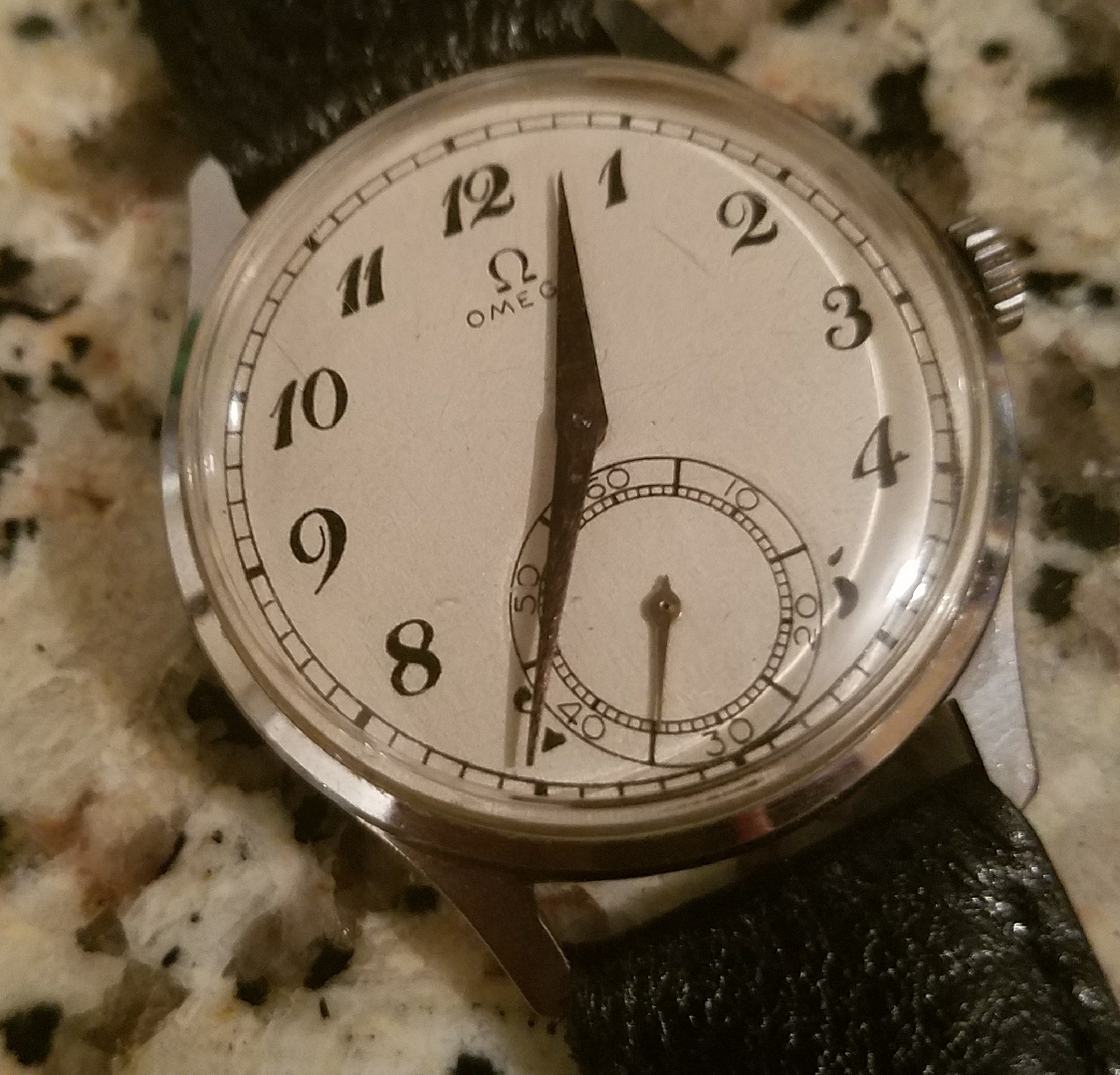

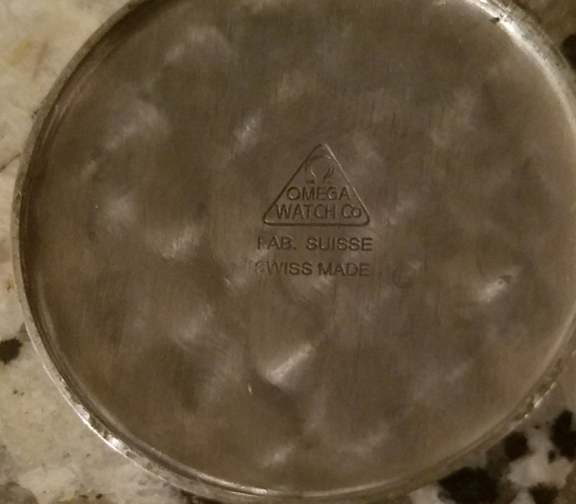

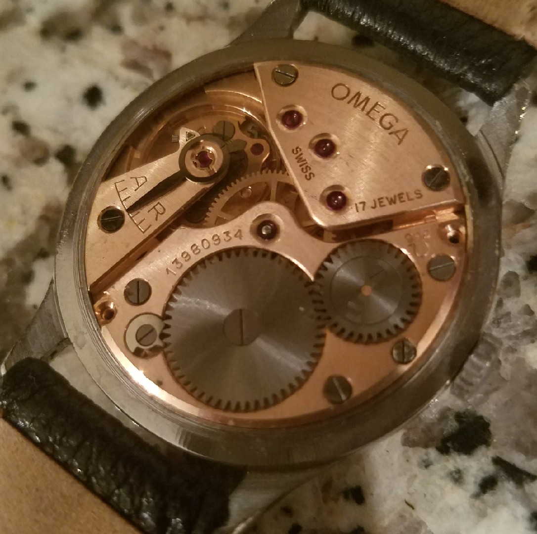

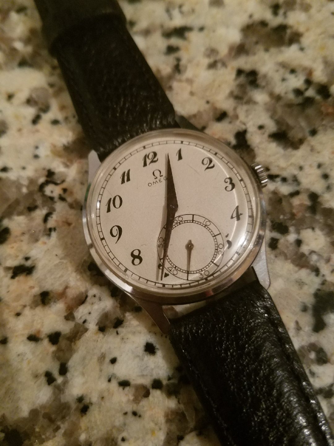

    I recently acquired this Omega from a watch trade. I'm more of a Rolex guy, even though I do own the Bond SeaMaster. I believe this to be a re-dial, but again, not sure. It has the 266 movement, and a breguet numeral dial. What has me stumped is that on the case back there is no model number. Keeps excellent time and is a gorgeous watch. Just curious if anyone knows model, authenticity (I feel fairly sure it is an authentic Omega), and value? I appreciate any help!

    Redial. Only the movement looks to be genuine. Omega logo was stamped on the case back by somebody, not by Omega.

    What exactly is it that makes you think the case is not an Omega case?

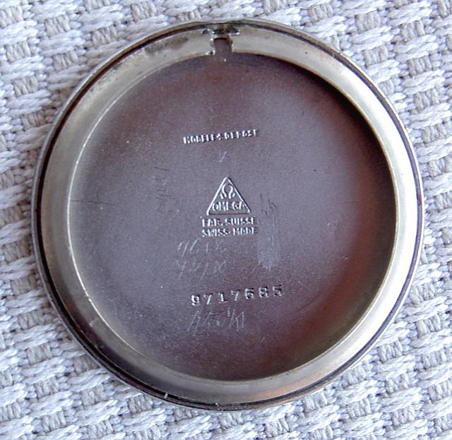

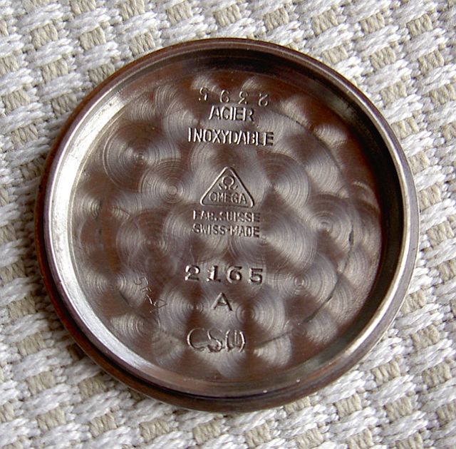

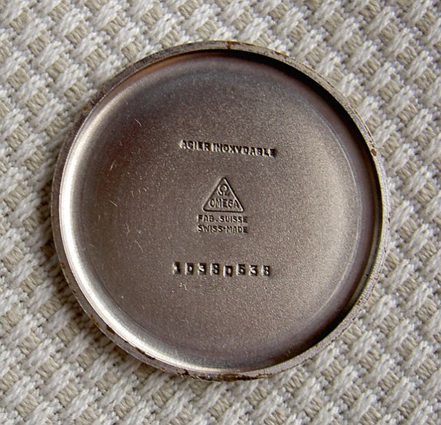

    e.g.
