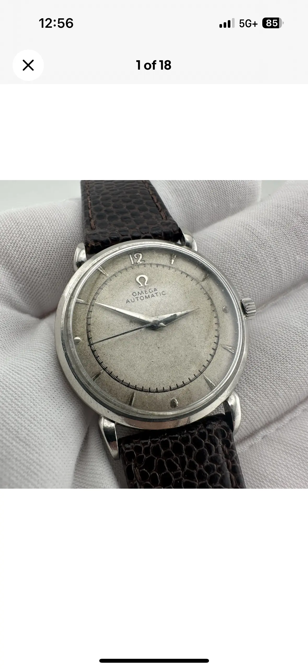

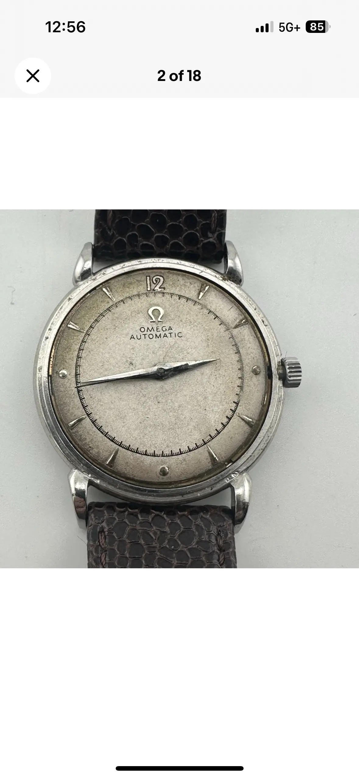

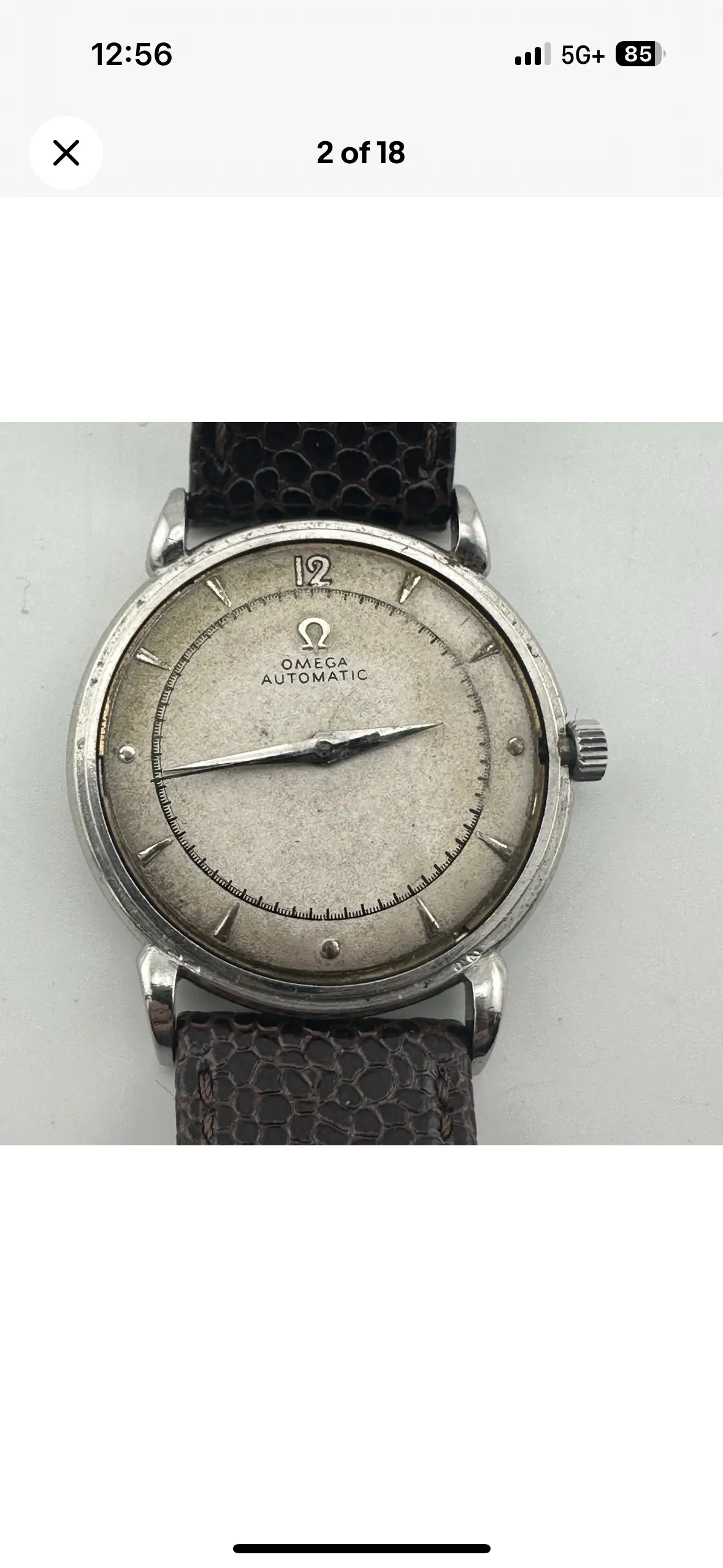

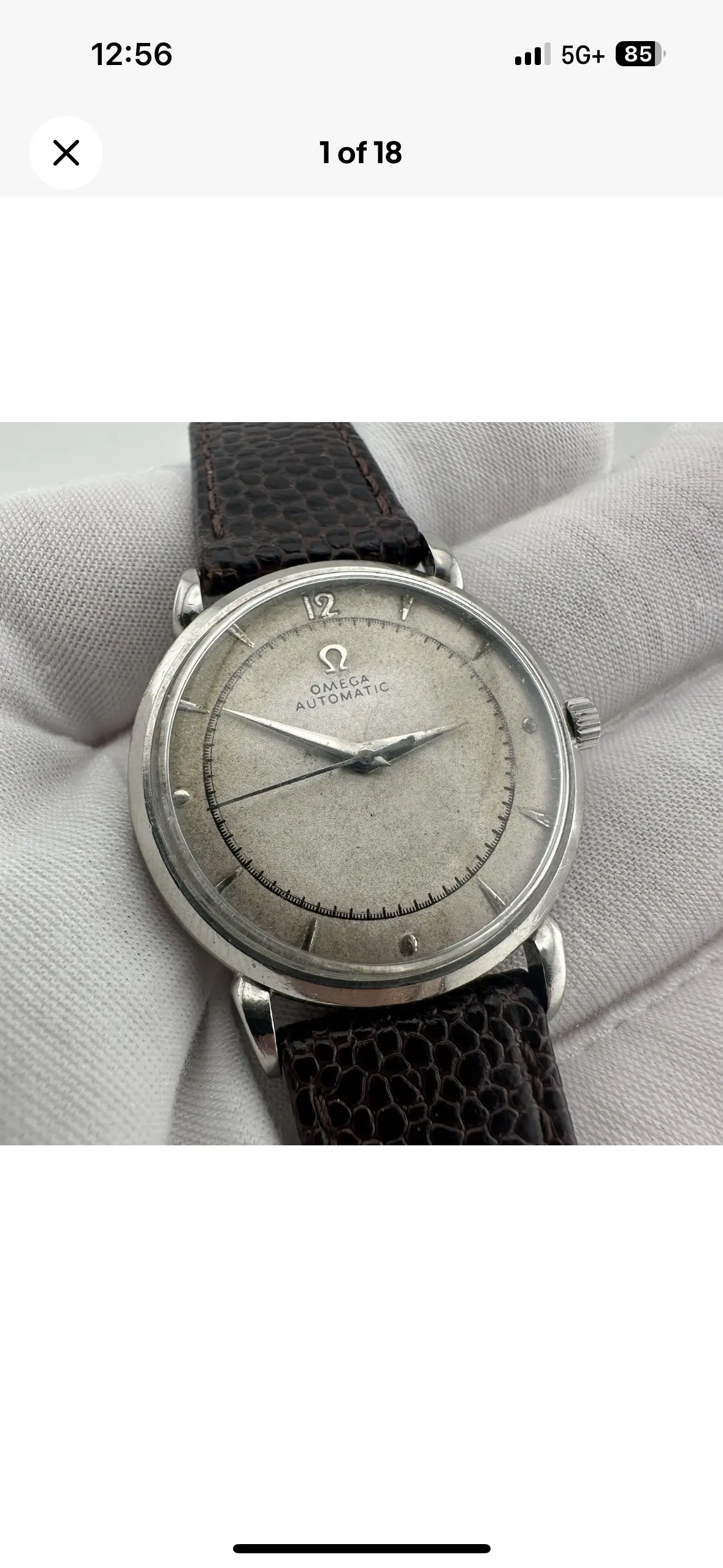

Genuine but not original. The dial has been repainted and not well.
28
That’s what I was thinking but couldn’t quite tell the 12 seemed off and the dial seems small for the case
912
1,255
The font is terrible too, in addition to the (re)dial being in terrible condition!
2,671
2,856
The 12 is probably the LEAST bad part of that dial... And yes, either some sort of inner ring is missing, or the dial is comically small for that case.
28
Thank you everyone for saving me from an expensive mistake still learning and just getting into it but at least i could tell it was not quite right half the battle I suppose
