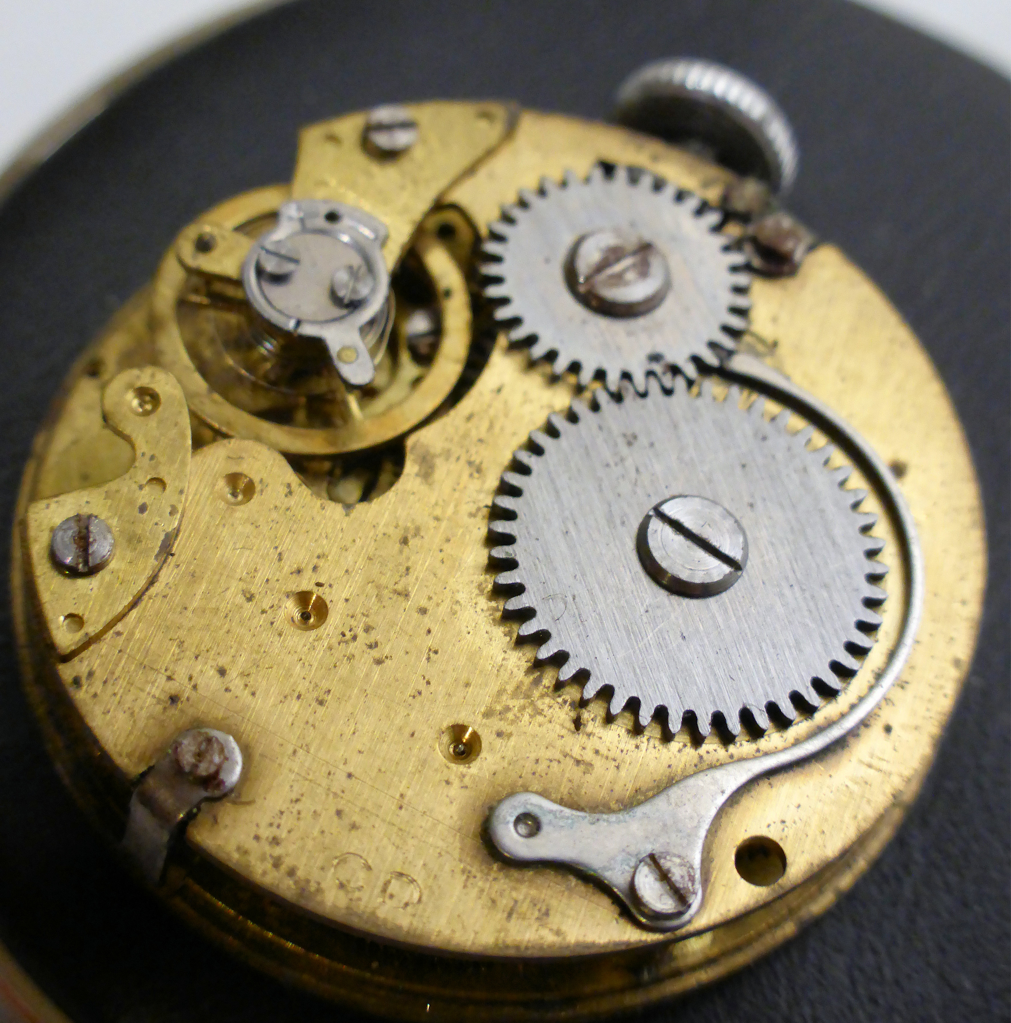

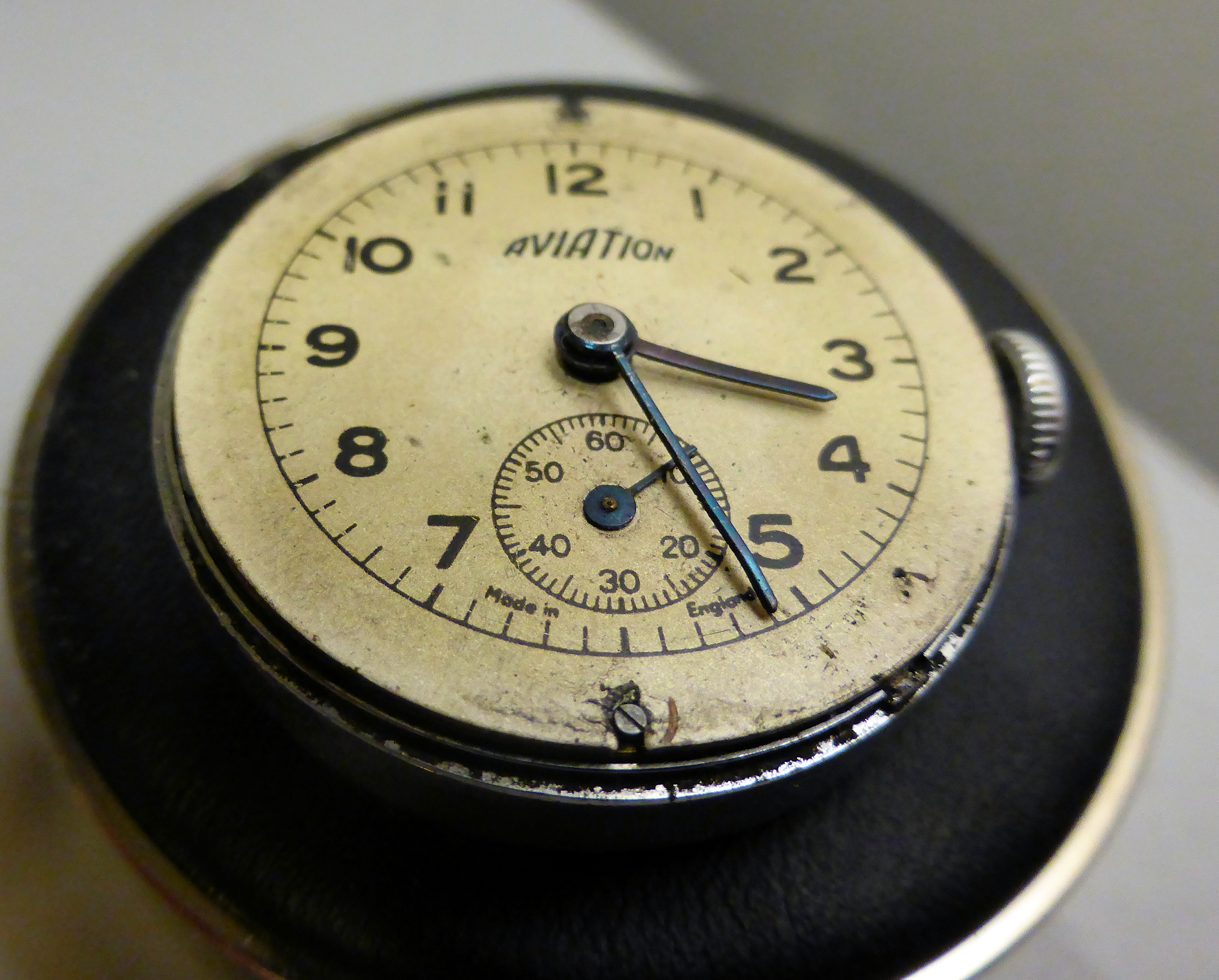

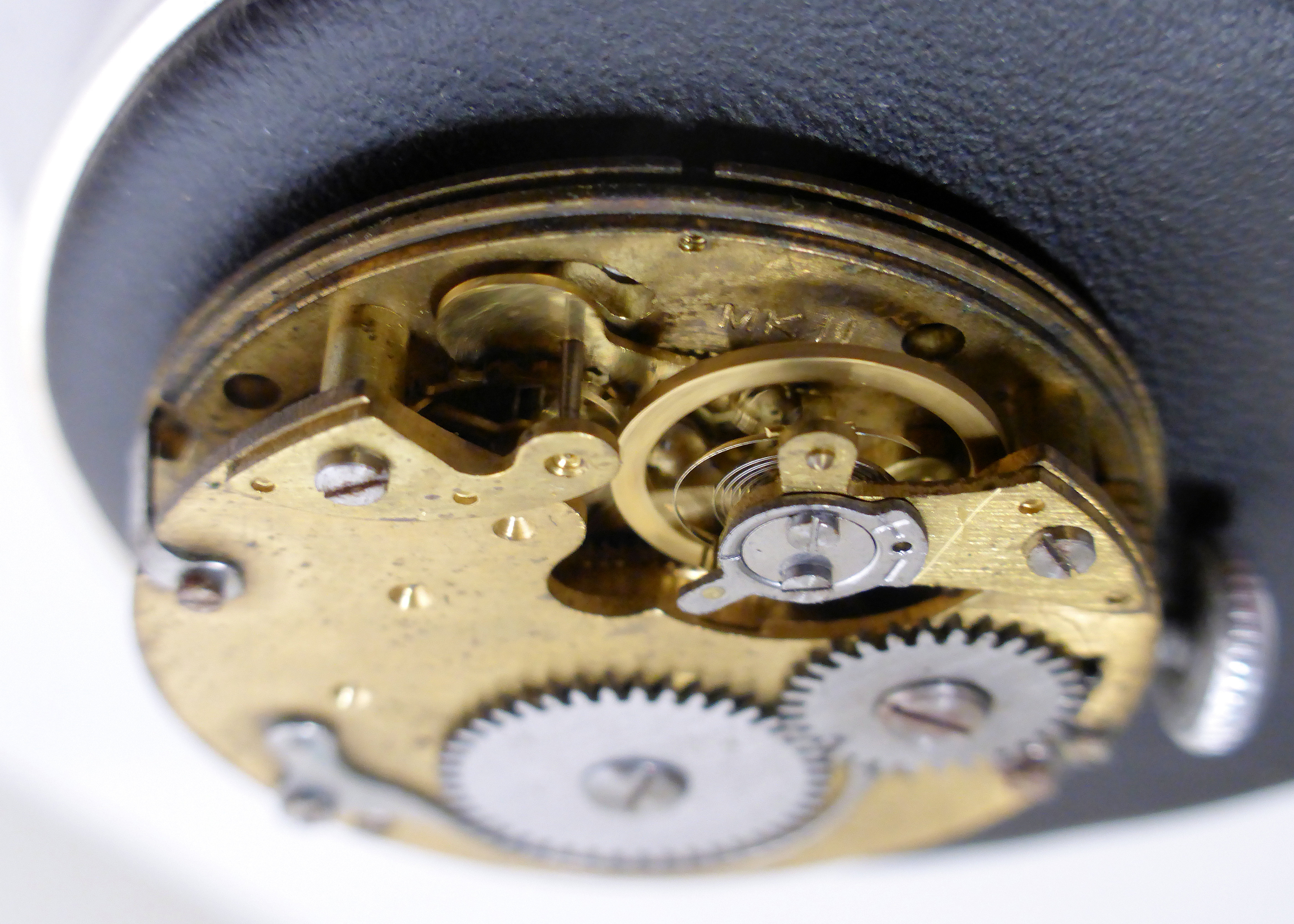

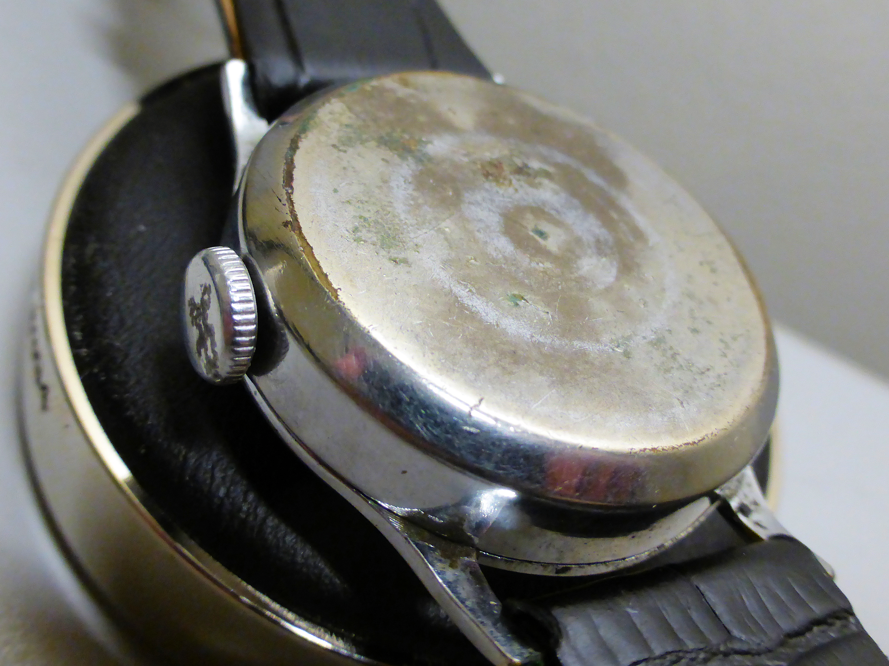

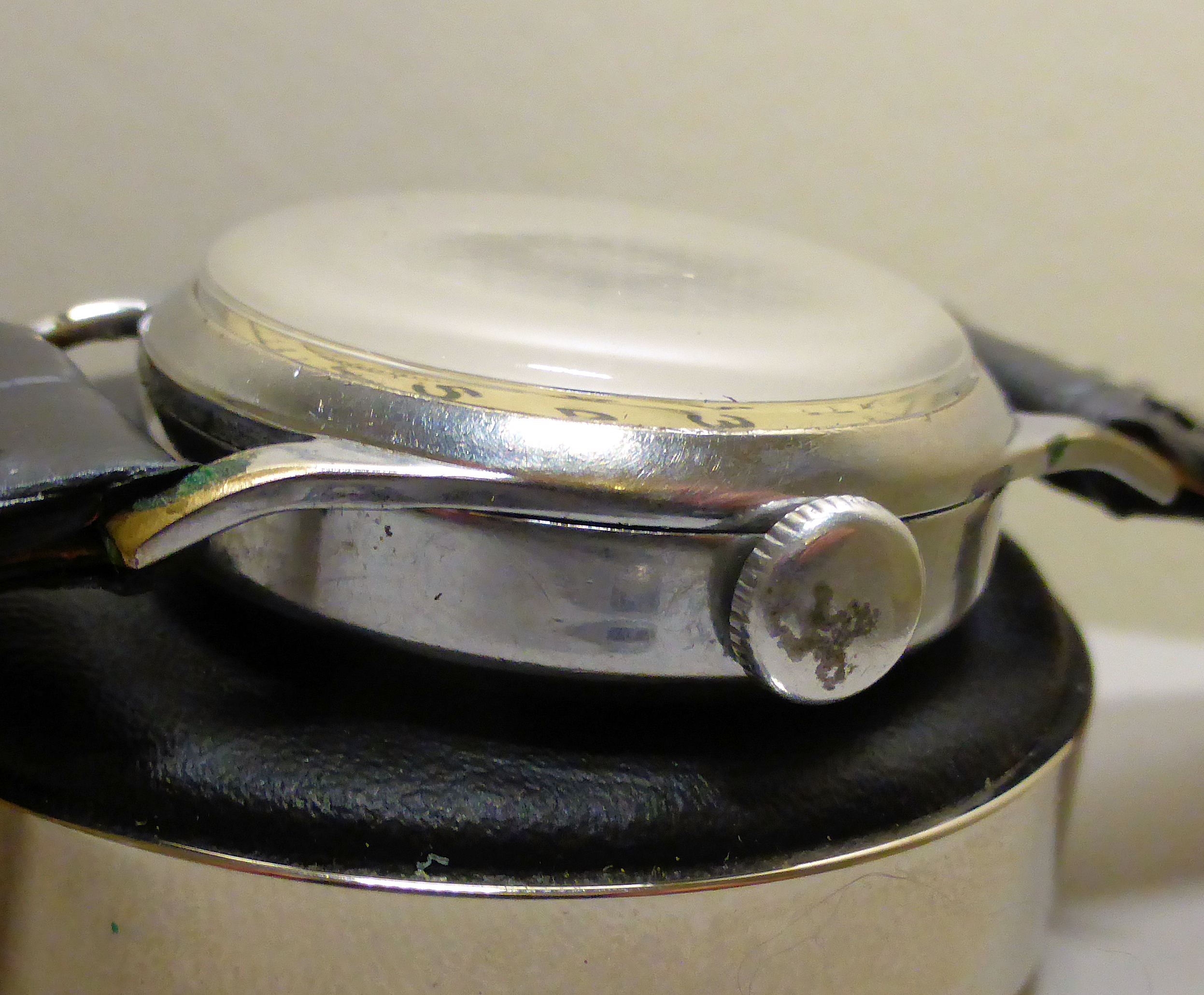

What can the team glean from these pictures?
Many thanks in advance for any help and feedback on the movement and case style.

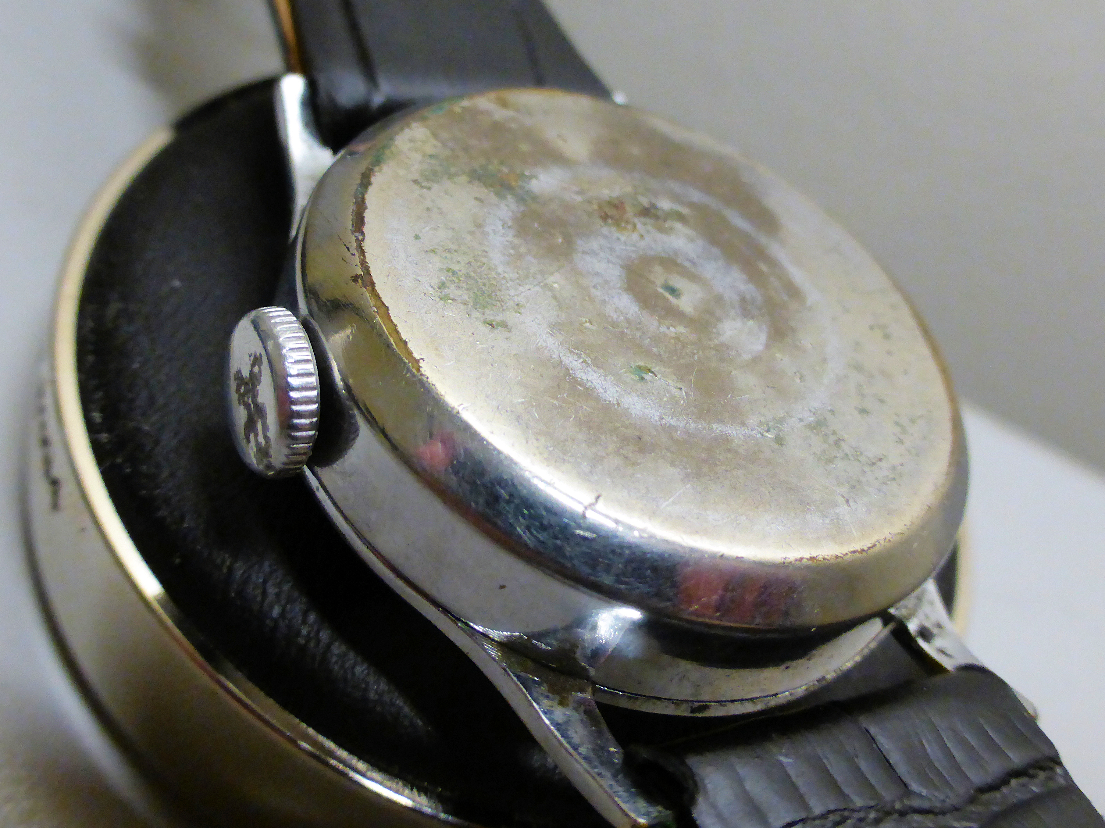

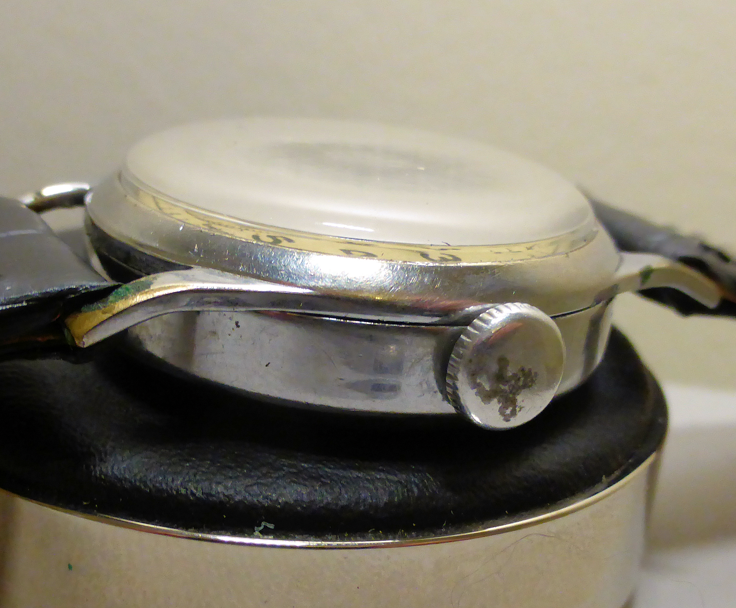

I should add the watch was a gift so it was private / not official military issue which you can probably tell from the case etc anyway.

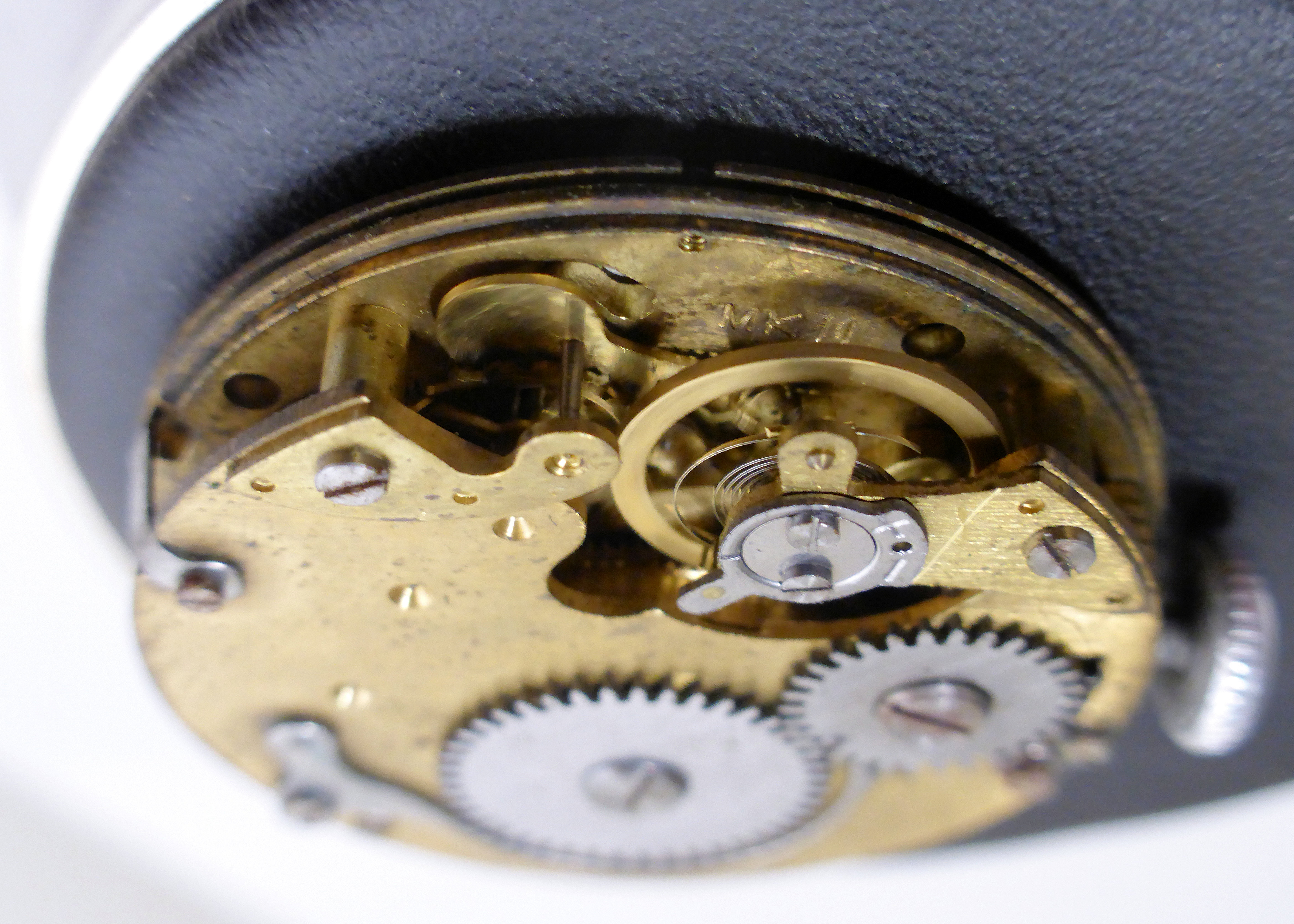

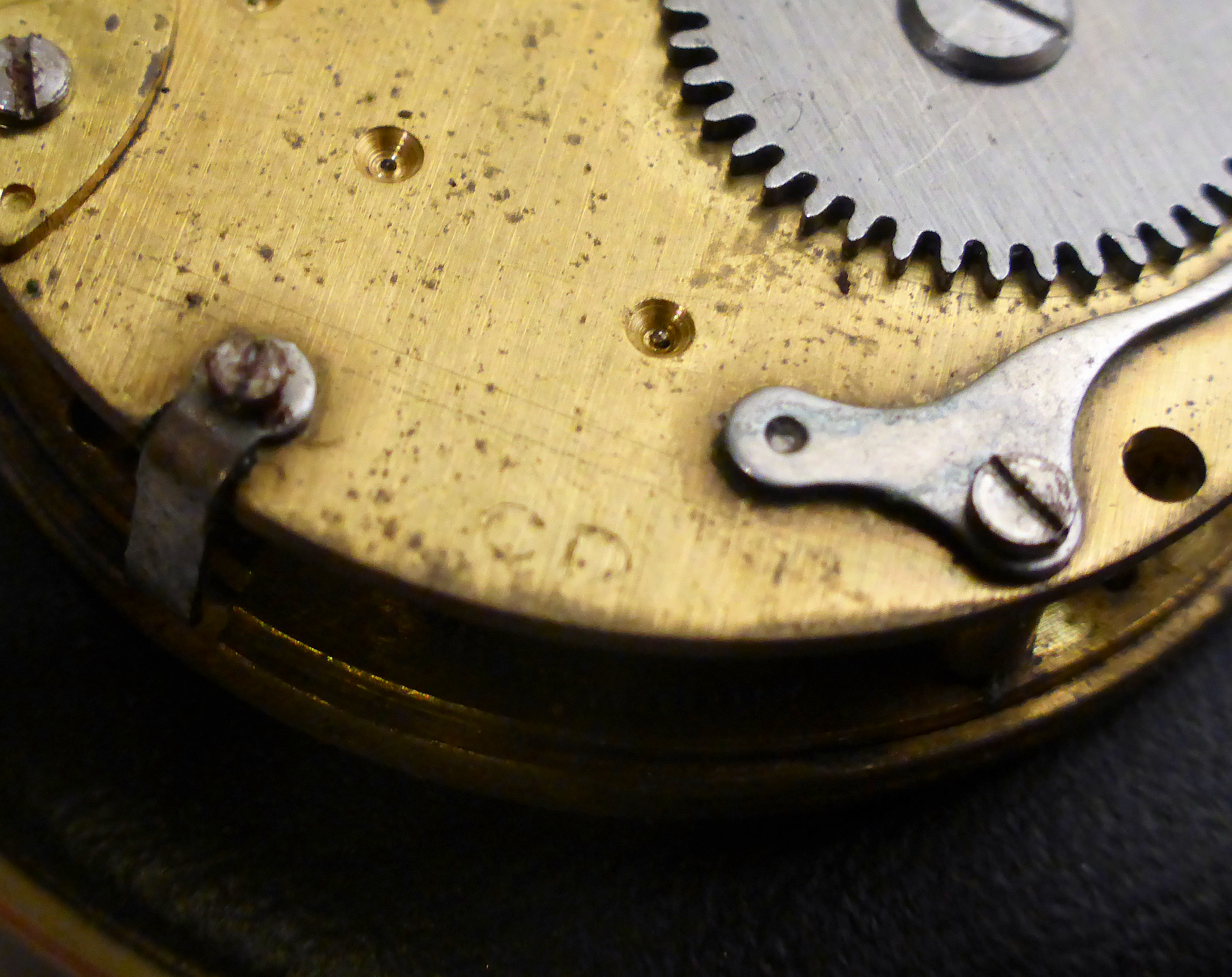

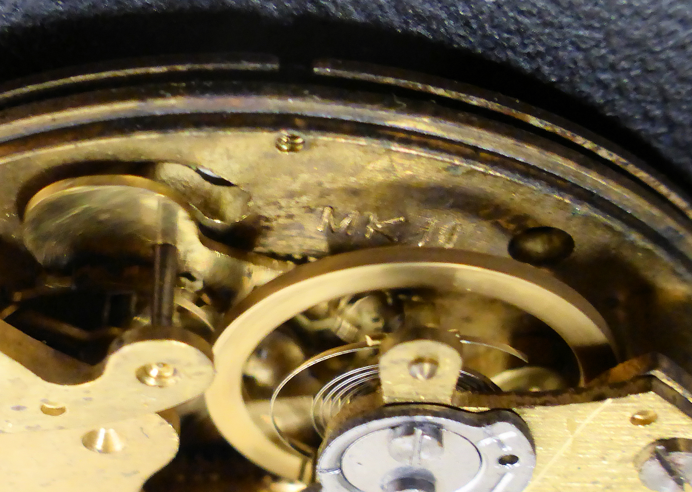

First photo = Letters are CD ?

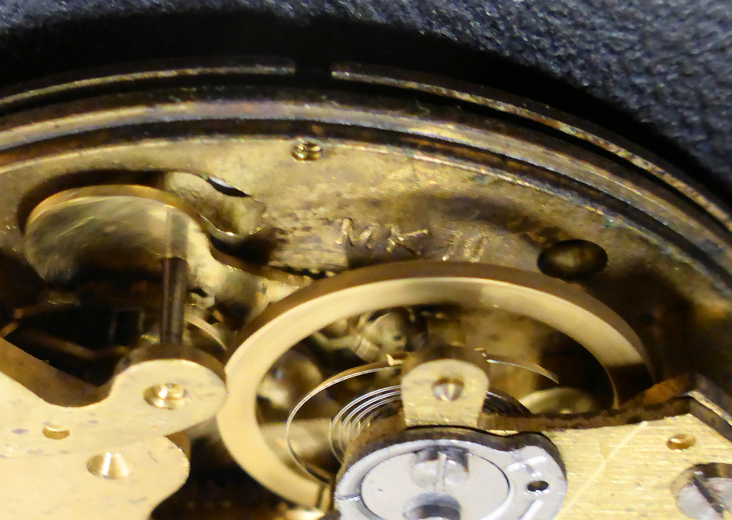

Second photo = Letters are MK 10 ?
Thanks. Yes I think the same. The 10 is not clear on the picture / could be a letter. I got some info from a watchmaker yesterday and will post that later. It is a cheap economy movement but I guess times were hard back then.

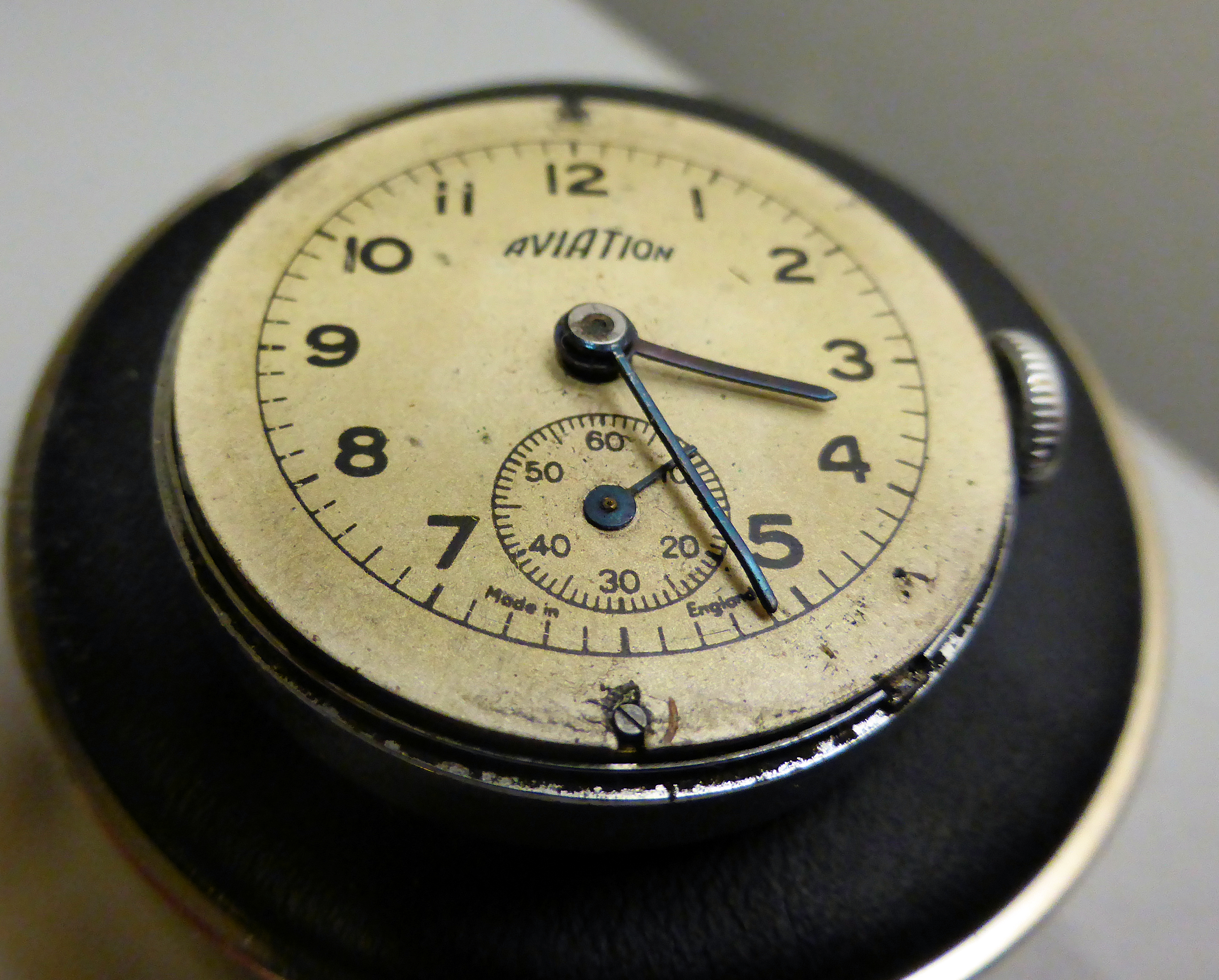

Hi team forum - I have some extra information. Any help much appreciated. I will also link this to a previous thread below to give some data on the Brand (thanks to everyone who helped on that).

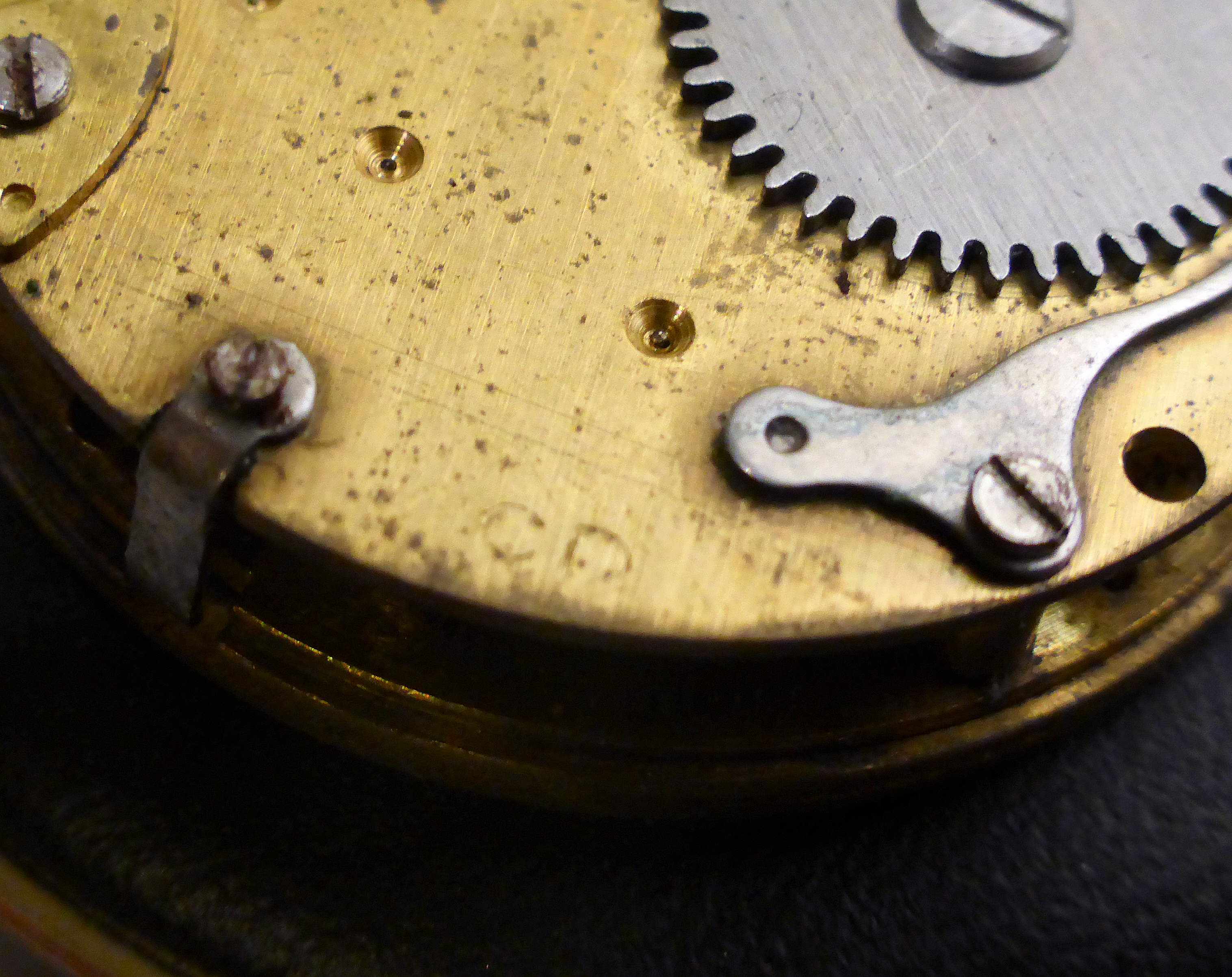

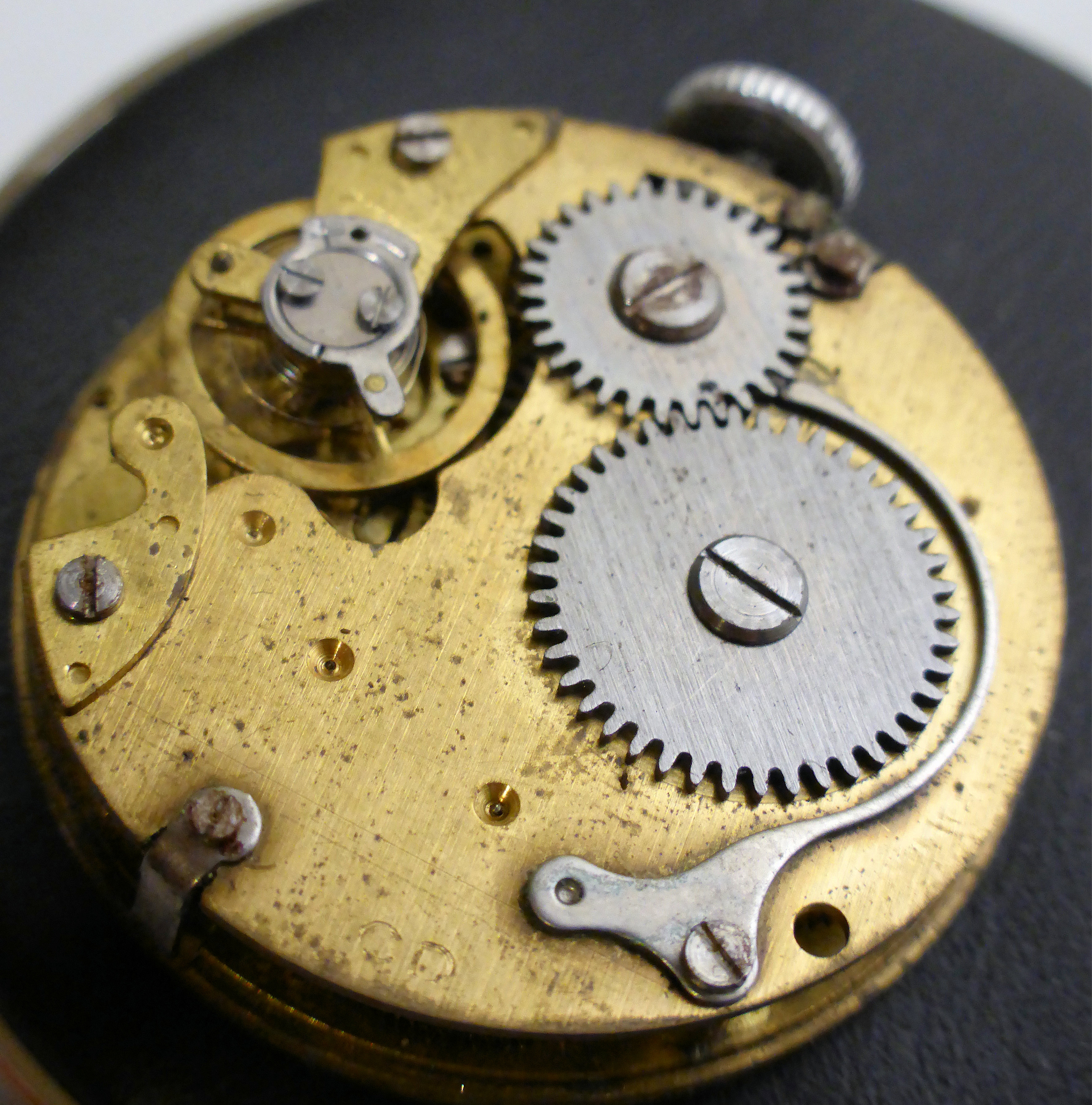

A watchmaker has confirmed this is a budget end pin-lever movement as invented by Georges Frederic Roskopf. I have not been able to identify the manufacturer to help date it. It is 30mm I think.
I suspect the watch was made by the Services watch Co which combined with the Aviation branding would seem a logical choice for a family to select as a gift to a young RAF pilot. The link below shows they were active pre-war as a significant retailer of 'Services Sports Watches' by casing up a variety of German (Thiel) and Swiss (Oris) movements. Their Aviation Watch Co subsidiary is believed established around 1938 so that could also be a match for the dates. Their location (Leicester) is also interesting given the back story I have. Oris did use pin-lever movements in the thirties but I imagine they would be branded in some way - the same with Thiel I assume?
The young pilot did not think he would survive the war (he was correct) and also the budget movement / sentimental value makes me think he would not have worn it on many (any) missions - hence why the watch has survived.
Currently I dont have anything to date the watch other than the family testimony which is compelling. I would like to have something more concrete before I encourage them to go public with the extra information as a lot of time has passed and memories can let us all down.
Services watch Co were also active in the fifties and as per the thread below other companies did use the Aviation Brand.
Any feedback much appreciated - could this be a 1939/1940 watch from the info above?
