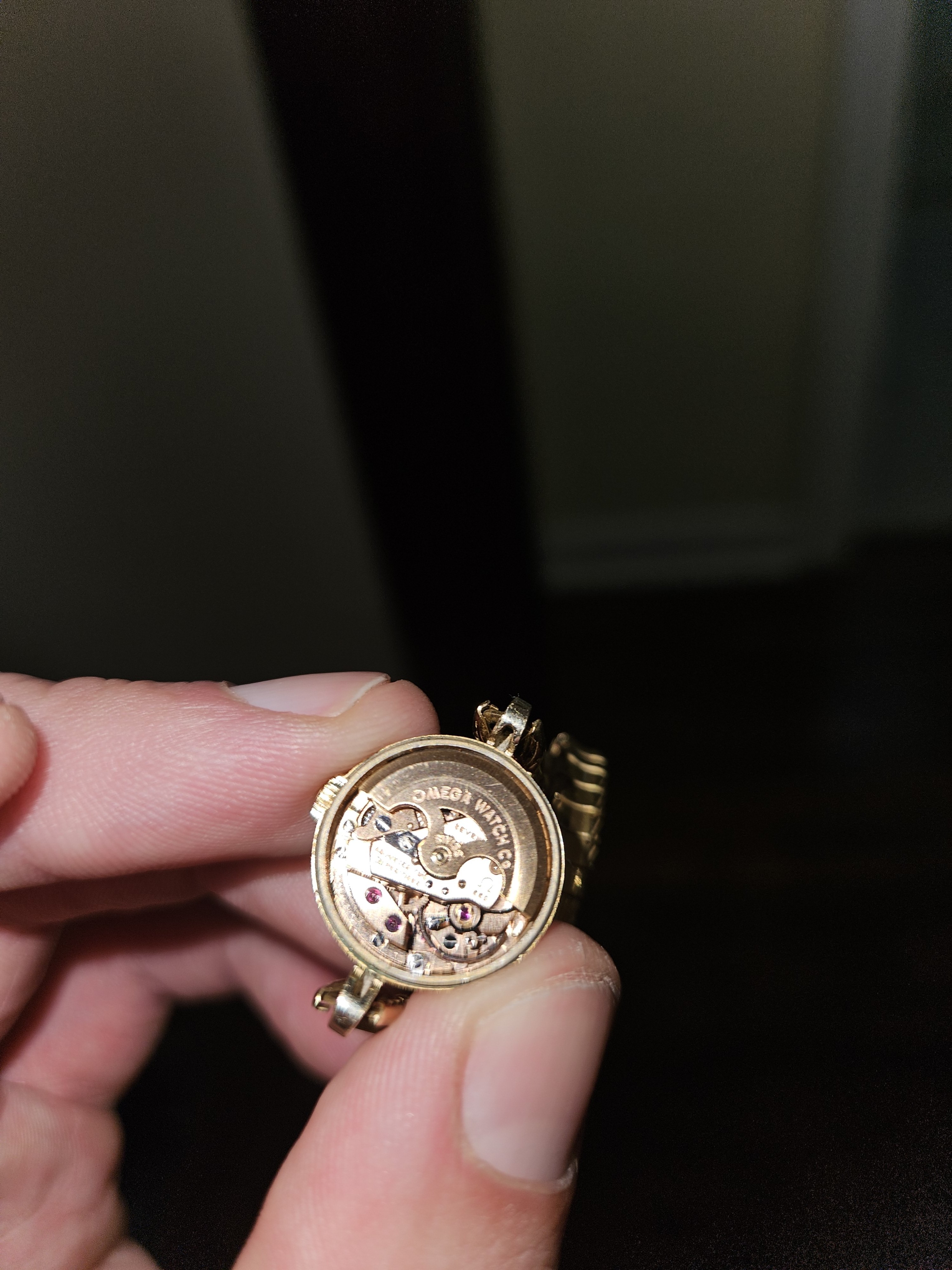

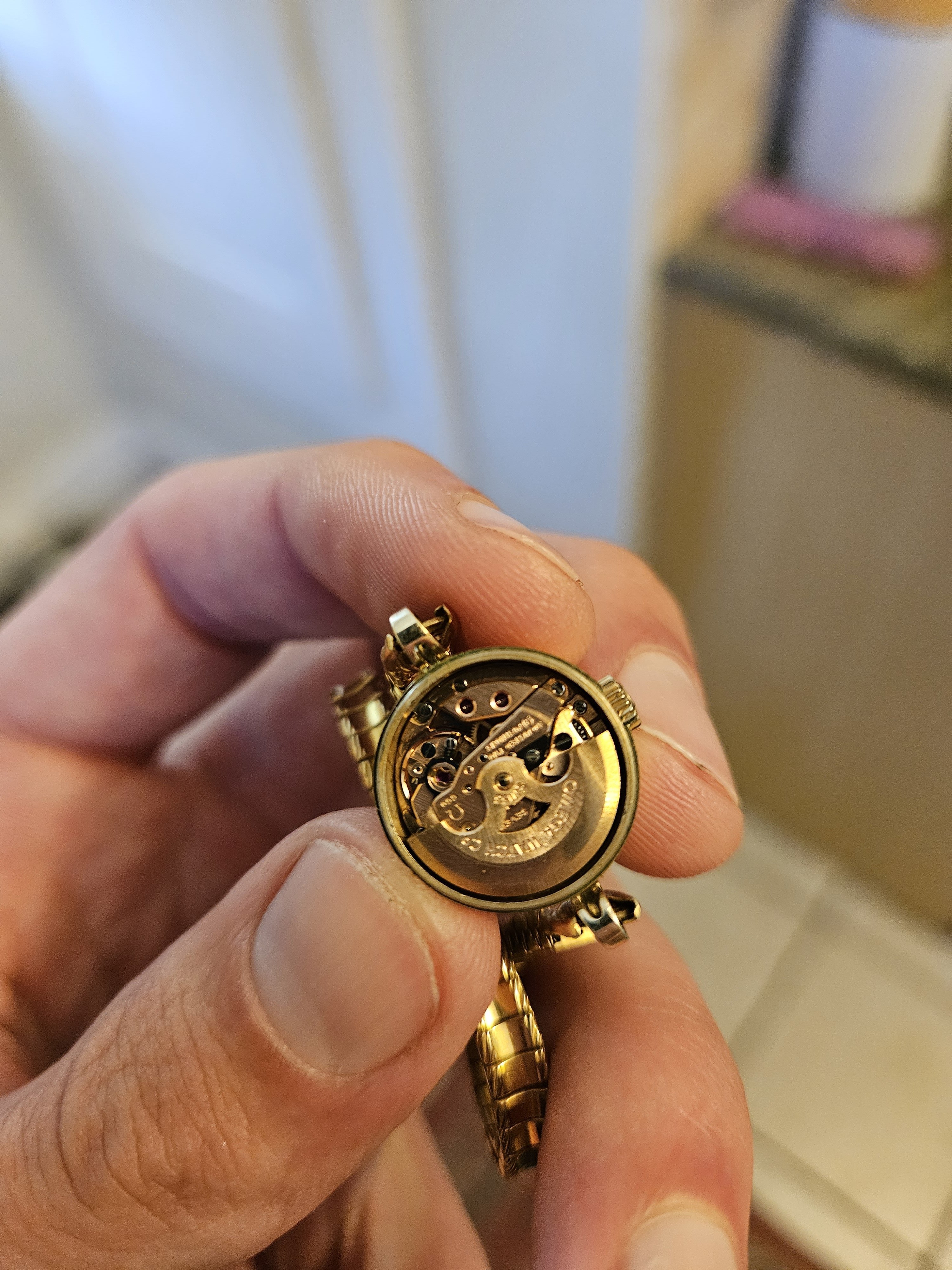

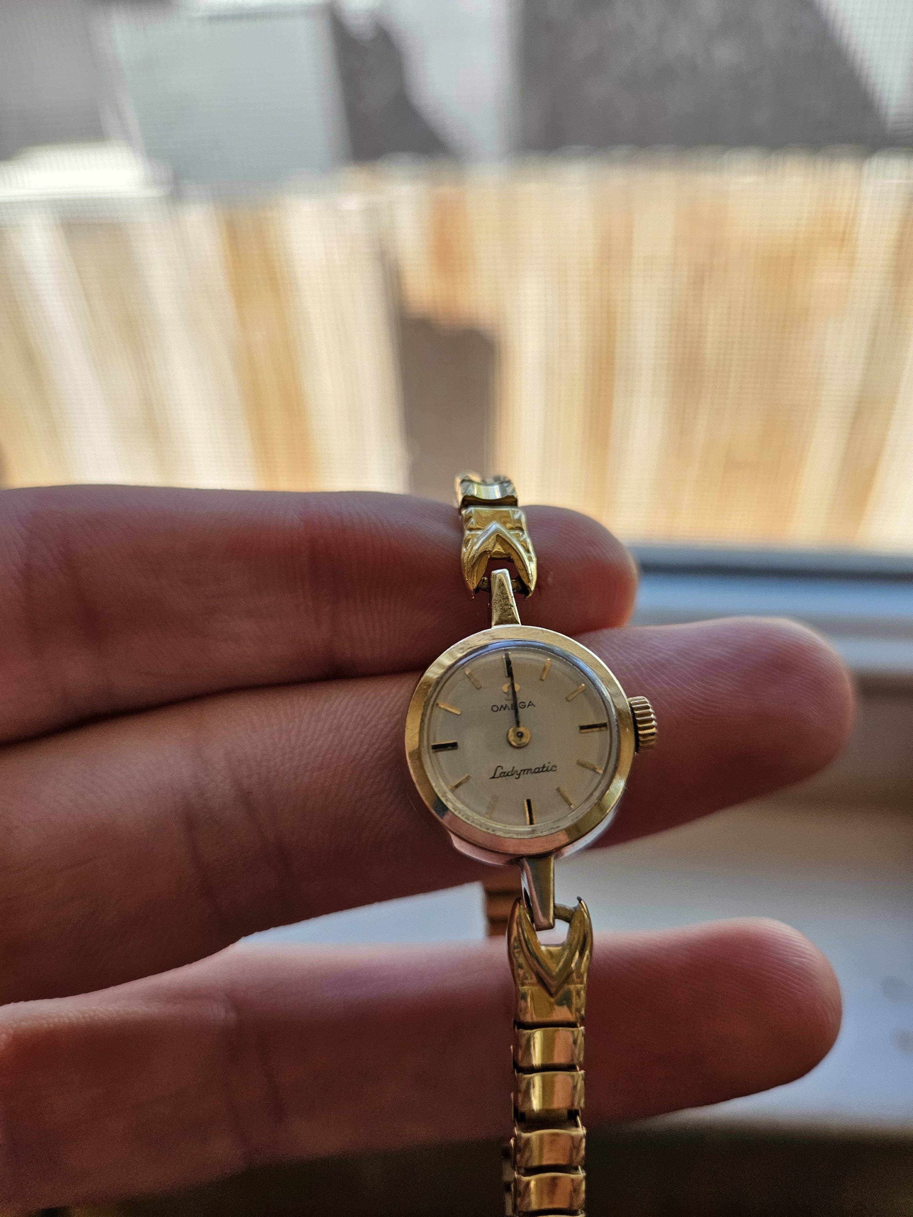

I have a vintage ladymatic with a 660 movement that recently stopped running. Action is normal on the crown when winding and setting the time, but the balance wheel wasnt moving at all when i opened it up. It looks like I can get a movement on ebay for about $100. Is it a bad idea to give it a go and try to replace it myself? Cost of repair is almost certainly worth more than the watch?
If I did attempt to repair this myself does anyone have any advice? It is not super clear to me how to remove the crown/stem on this movement. This would definitely be smallest movement i have ever attempted to replace.

Sounds like your watch needs to be serviced.

I figured that much, but as I stated above, the cost of servicing it would probably be more than the cost is worth. Just figured I should look at all options before i went down that route.

Buying another un-serviced movement would be a crap shoot at best.

What makes you think another movement will work properly? It may need servicing too. This one may be in perfect condition but with oils which have seized up.
Unfortunately, owning vintage watches is an expensive endeavor if you’re in a country where the cost of watchmakers’ services are expensive.
If you can’t afford the cost of maintenance, which is perfectly understandable,
you should simply turn your attention to modern quartz watches.

As much as I like supporting self service. This is NOT the watch to start on.
I have been playing about with my A Schild 1138 watches in preparation to start servicing the half dozen or so 671/681 watches I acquired over the last year.
The bridges on this small automatic are stacked one on top of another. Add in the date complexity and there is a lot what can go wrong.
Unless one has good bench practices and worked on a number of watches, A self service to save on the costs is not going to have a happy ending.
Watchmaking can be a rewarding hobby. Like most hobbies it is like opening up your billfold, remove several 100 bills and drop it out the window in a large city to let the wind carry them away.
Note the above, these watches can be cheaper by the dozen, But the time spent will never be recovered.
