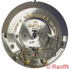

The only Certina movement that I have uncovered that was used by Hamilton was the Kurth Freres (Certina) 25-45 automatic as shown. I have two Certinas with that movement. In my opinion, this movement was on a par with the best automatic wind movements of the era, by most of the prominent watch manufacturers.

Hamilton called this KF movement grade 661. The link shows a KF 25-45 movement, Hamilton grade 661 movement with the rotor marked Hamilton. If one were to be looking to acquire a Hamilton grade 661 watch, better to search Hamilton 661 than KF 25-45. For an idea of what styles of Hamilton watches used this movement, there are several listed on a “popular” on line auction site at the present tme.

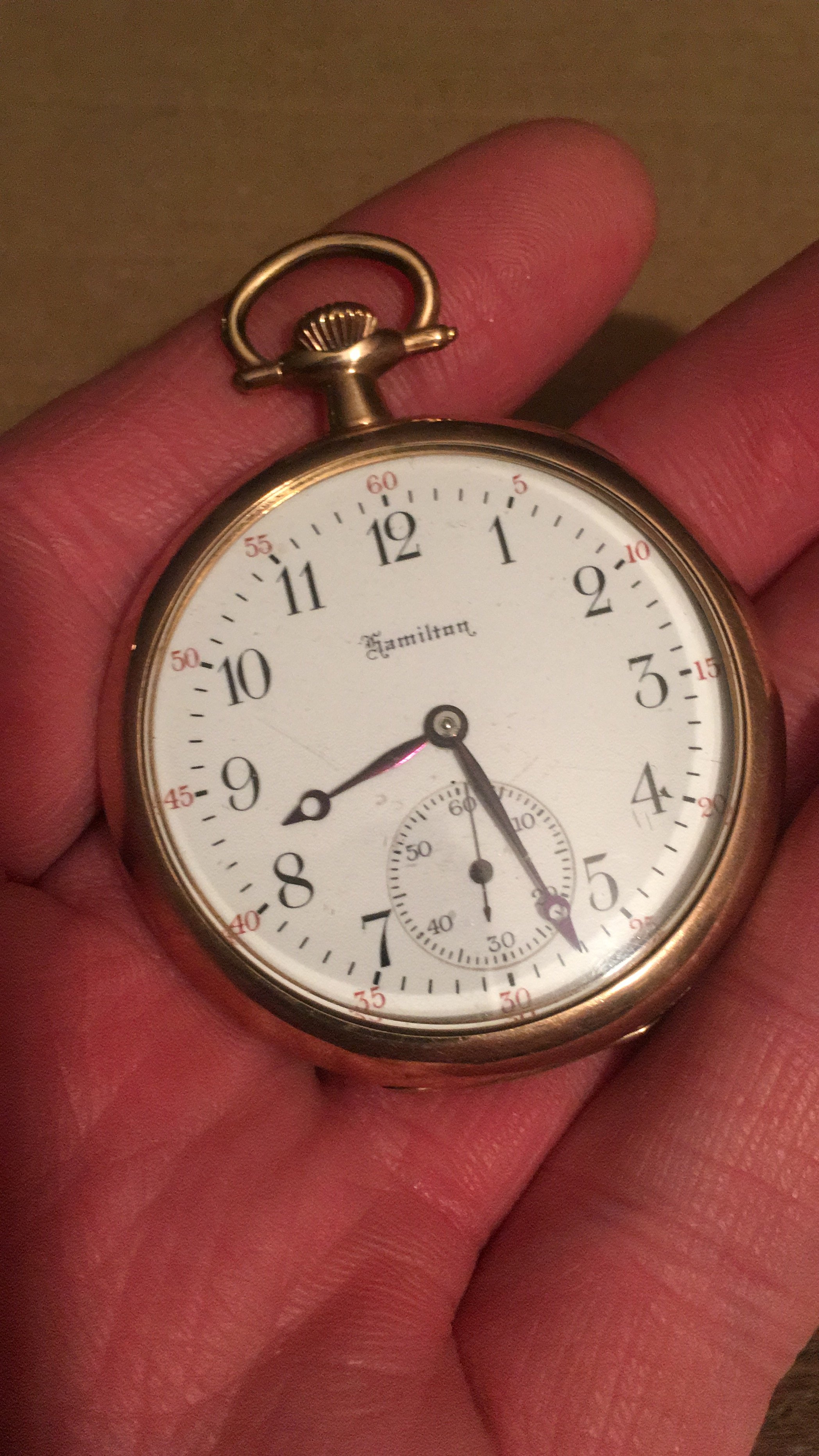

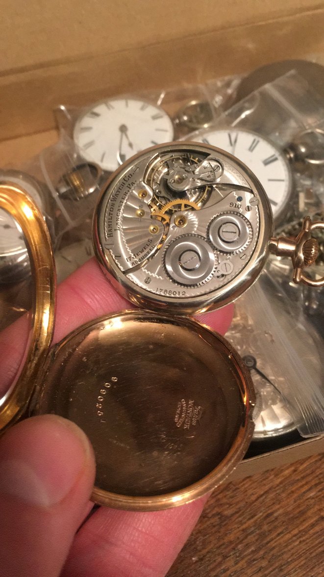

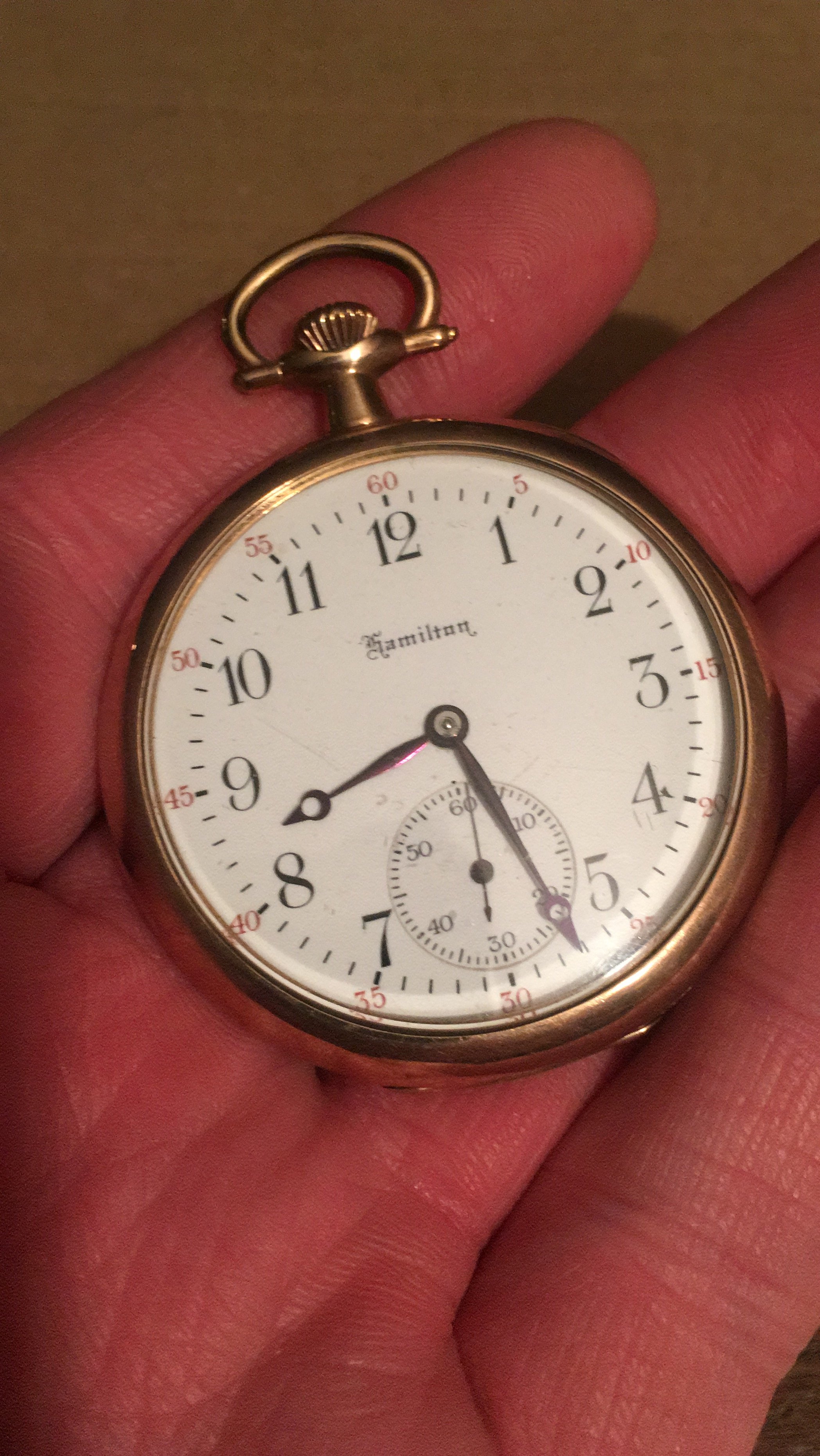

Are you also interested in Pocket Watches ? I gonna sell my vintage Pocket watch collection and have a very Nice Hamilton pocket watch.
Also many English pocket watches but that is not what you look for
