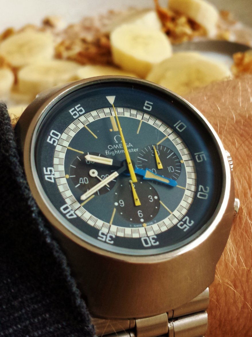

  3. speedy4ever Moonwatch Only Author Nov 27, 2014
    639
    782
    Nice, but never seen 3-6-9 dots inside minutes scale...interesting

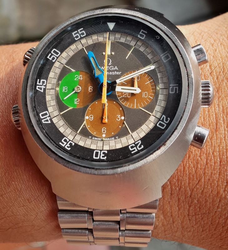

  7. Privateday7 quotes Miss Universe Nov 28, 2014
    5,753
    2,903
    All dots present variant: two on 12, one each on 3,6 & 9.
    Oh.....and extra chocolate milk at subdials ;)
    cristos71, Dogmann and TexOmega like this.

  18. speedy4ever Moonwatch Only Author Nov 28, 2014
    639
    782
    Mine is a sister: no dots at 12, yellow hands, chocoloate dials and yellow pushers. Serial 29.133.xxx
