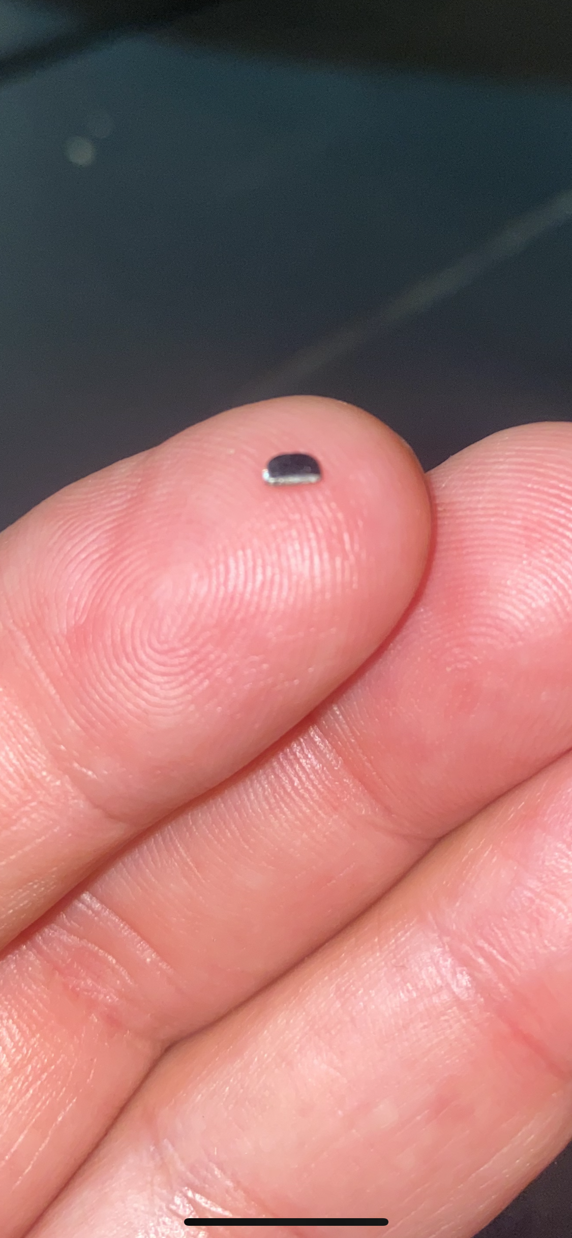

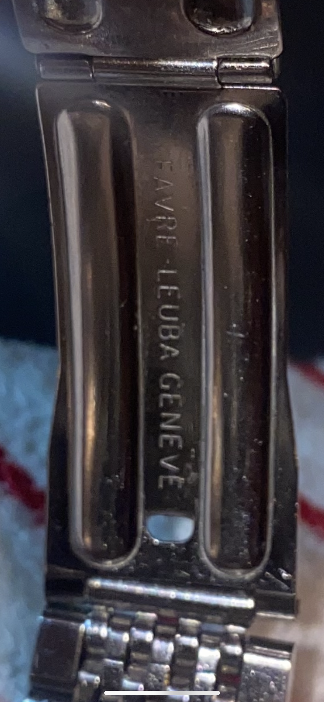

Hello my friends,
Had a lovely FL bracelet break last night. The tiny pin that klicks into the buckle hole and hplds it closed
fell off. Is there anything i can do to save it? ::facepalm1::

It's called a tab, and once it breaks off as they often do you have to replace that section of the clasp with one from a donor bracelet.
The other option is to fit a better vintage clasp.

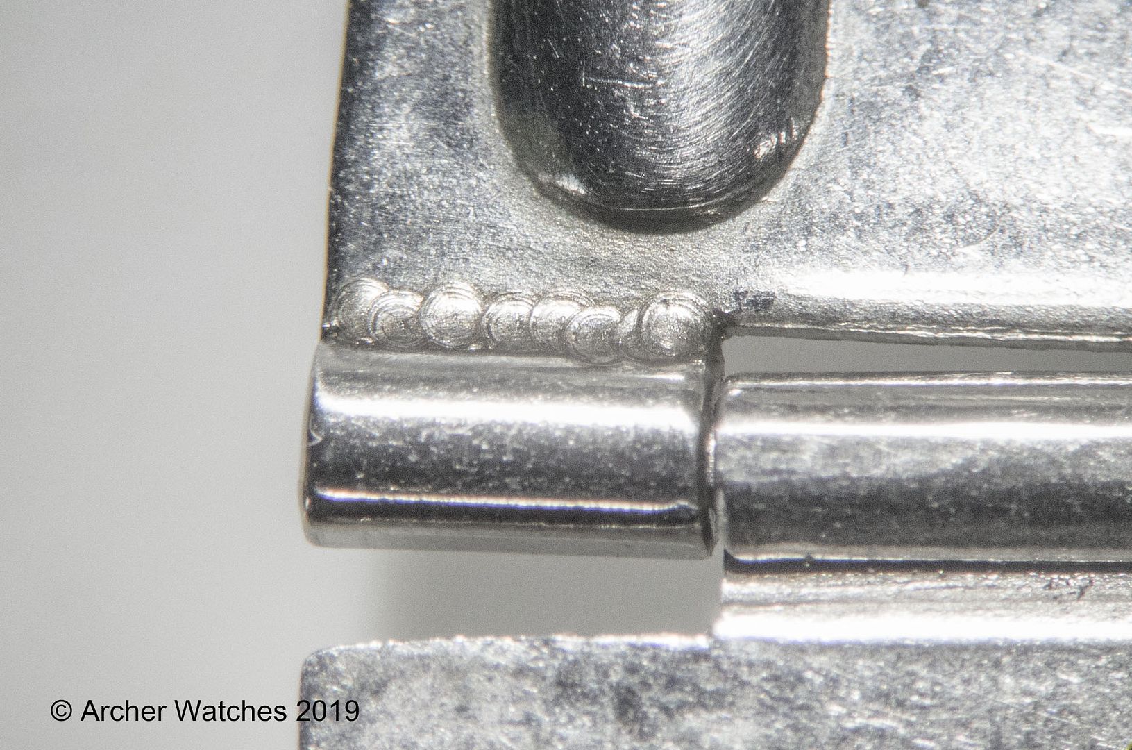

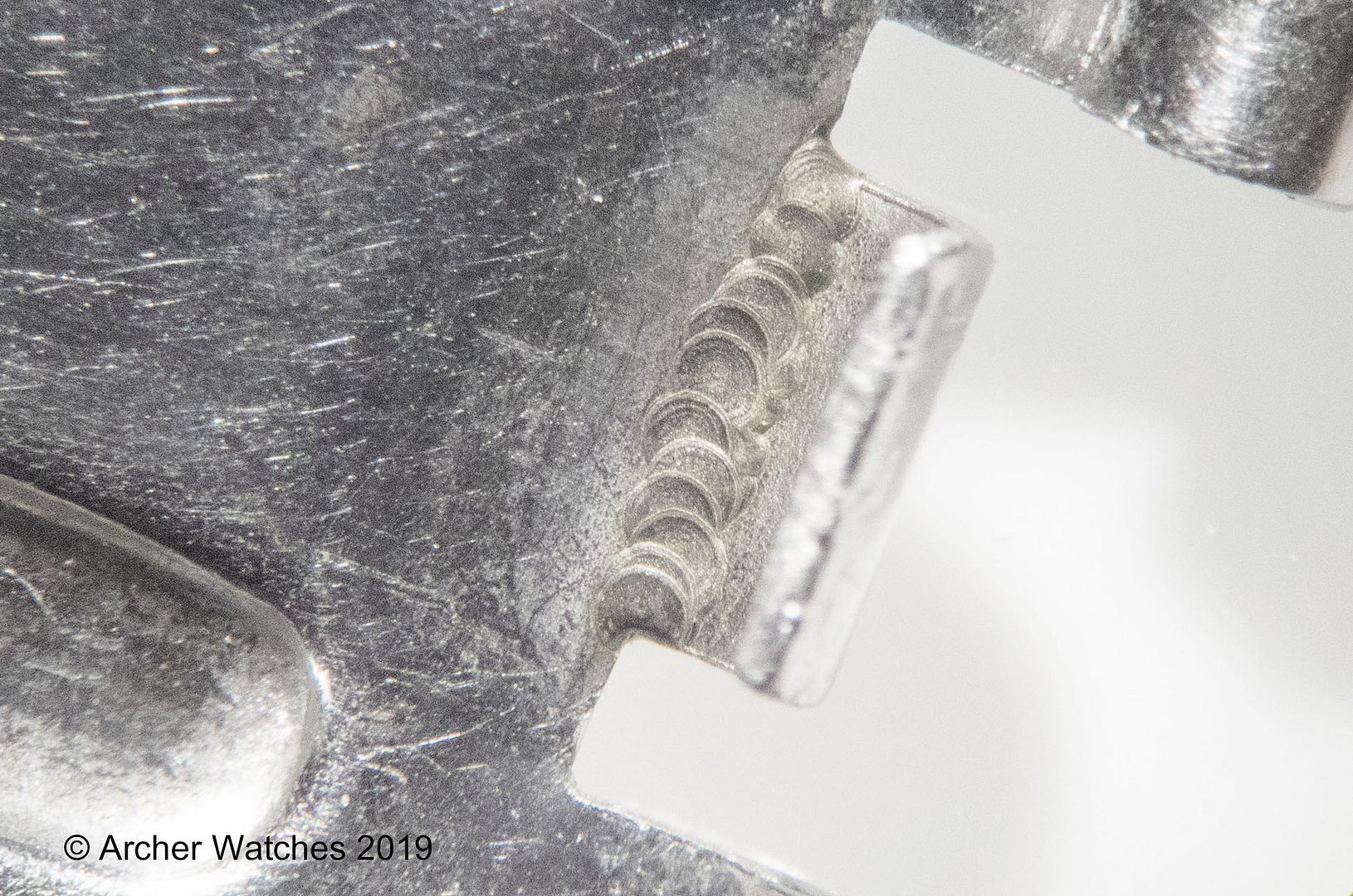

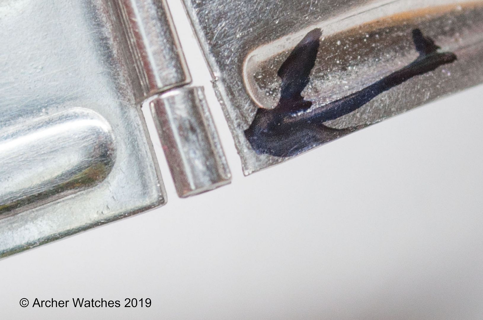

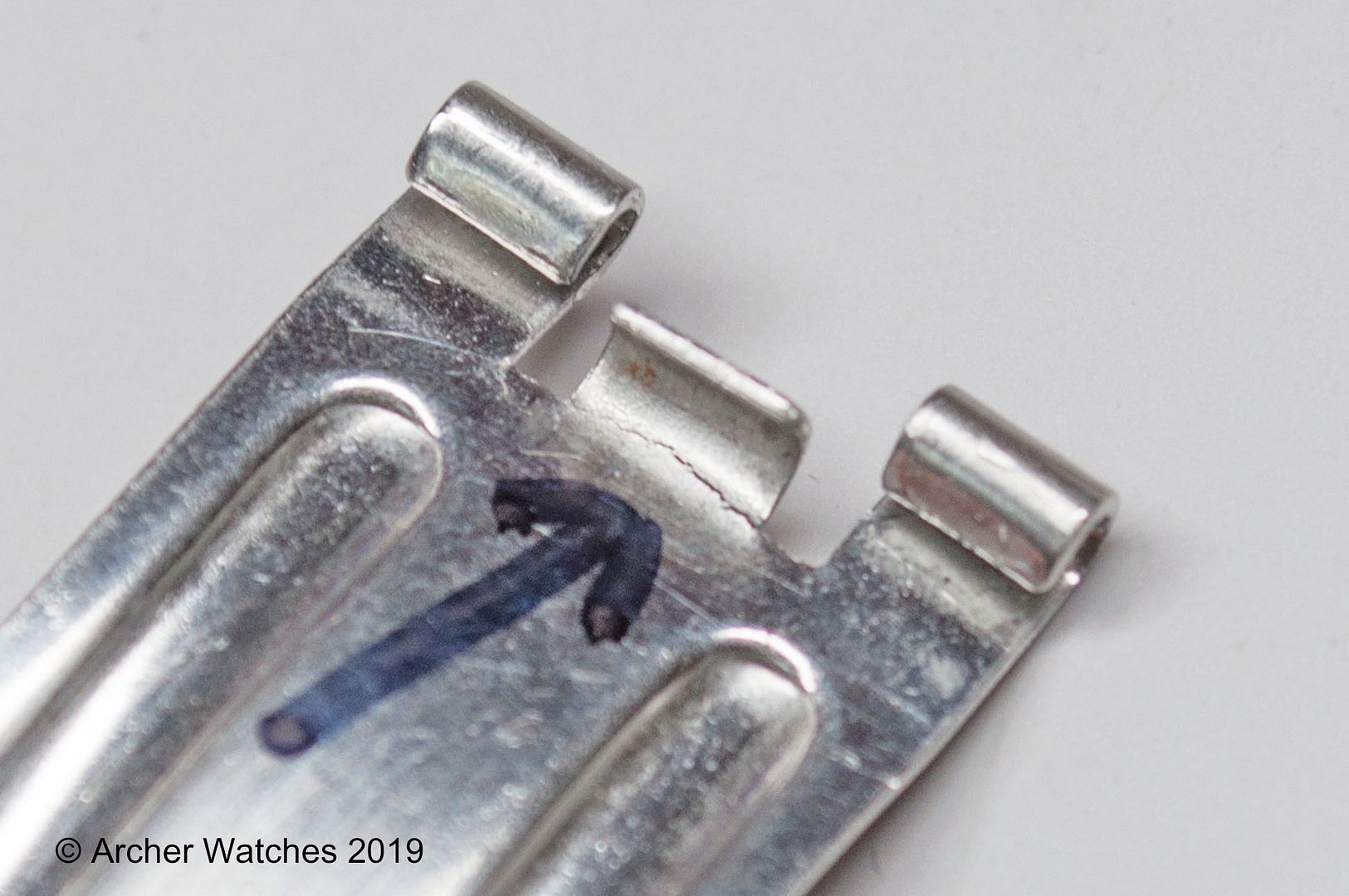

If you still have the tab that broke off, I would suggest trying laser welding. I caught this one before it snapped, but it was ready to go at any time...
Laser welded it and it's all good...
Also used laser welding to secure the tubes that sometimes crack...

Incredible job, wow. Funnily enough a friend offered to help with lazer welding but I don't have the tab sadly. He might be able to cut a peice of steel and make a new tab.
