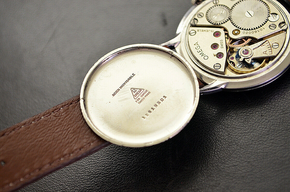

Vintage 30T2 jumbo got wrecked in service, where to get replacement parts
7
Well only the 37mm diameter case back, but I'm kinda out of luck finding a replacement. Any ideas?
Factory cant help, service says they don't have parts... Located in Europe.

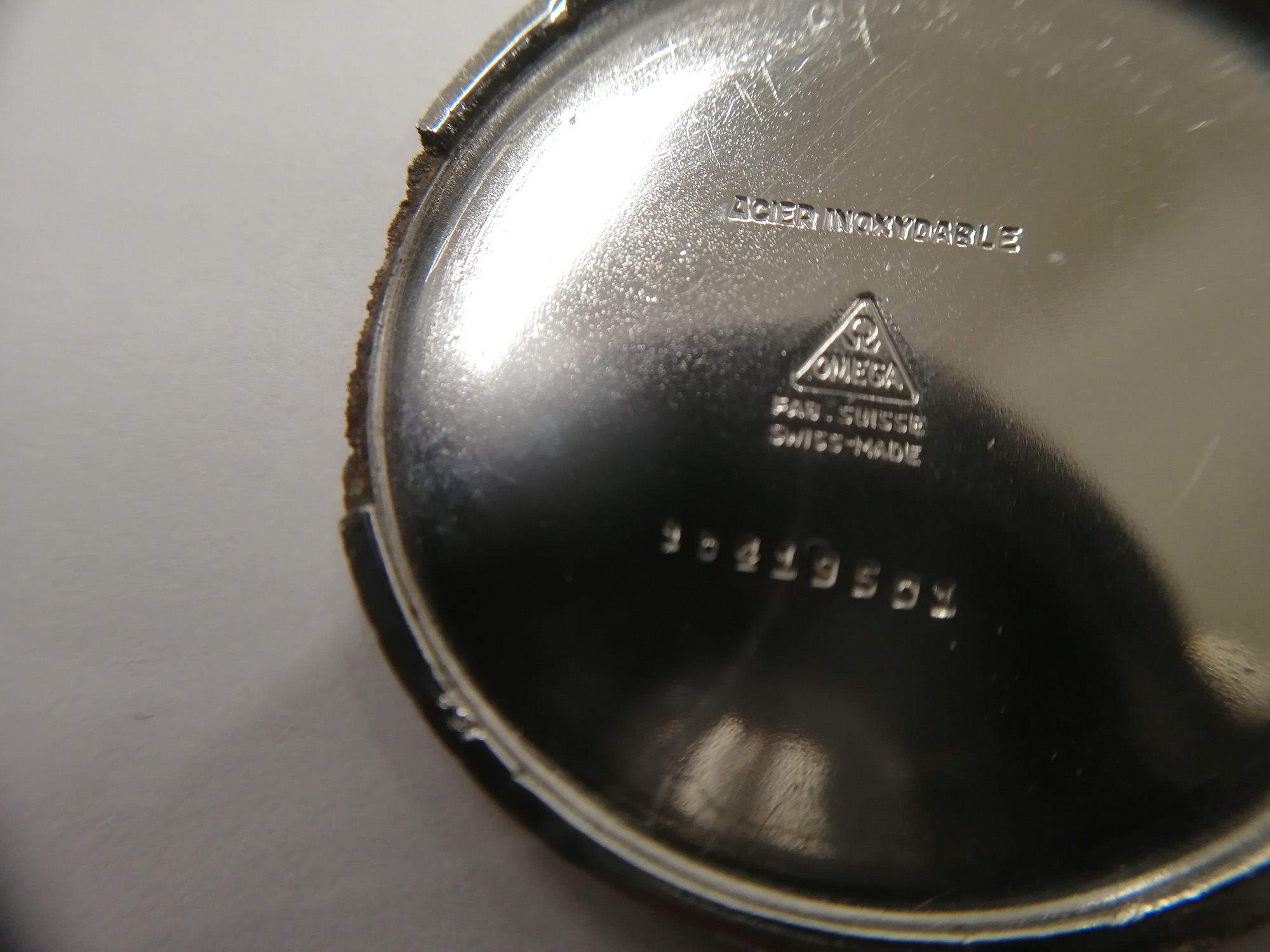

your back looks corroded in that area and just couldn’t handle the stress anymore and broke off.
you could try a metalsmith to weld a section in and finish to fit
finding a back is slimmer than finding a case
384
375
+1 for a repair. Look for someone who can do microwelding and have a watchmaker fabricate the broken bit.

I would send replateit.com the pictures you posted and ask if he can do it.
609
789
In Italy there are many who could laser-weld steel there, one of the best is Laoratorio Portanova in Bologna. They have years of experience and woud be able to refinish at the end to match the current look/
7
Apparently the service I took the watch has a laser welding machine, but the case back is so corroded that it cant be fixed... So I'm double out of luck.

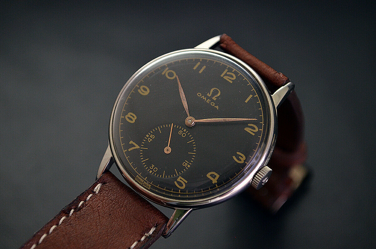

Ended up finding a ref 2325/5 donor watch with a better case, but water damaged movement.
If I find a case back in right size (31mm interior and 33,5mm outer) the donor might end up restored back to its original glory.
But original case back was beyond salvage.
