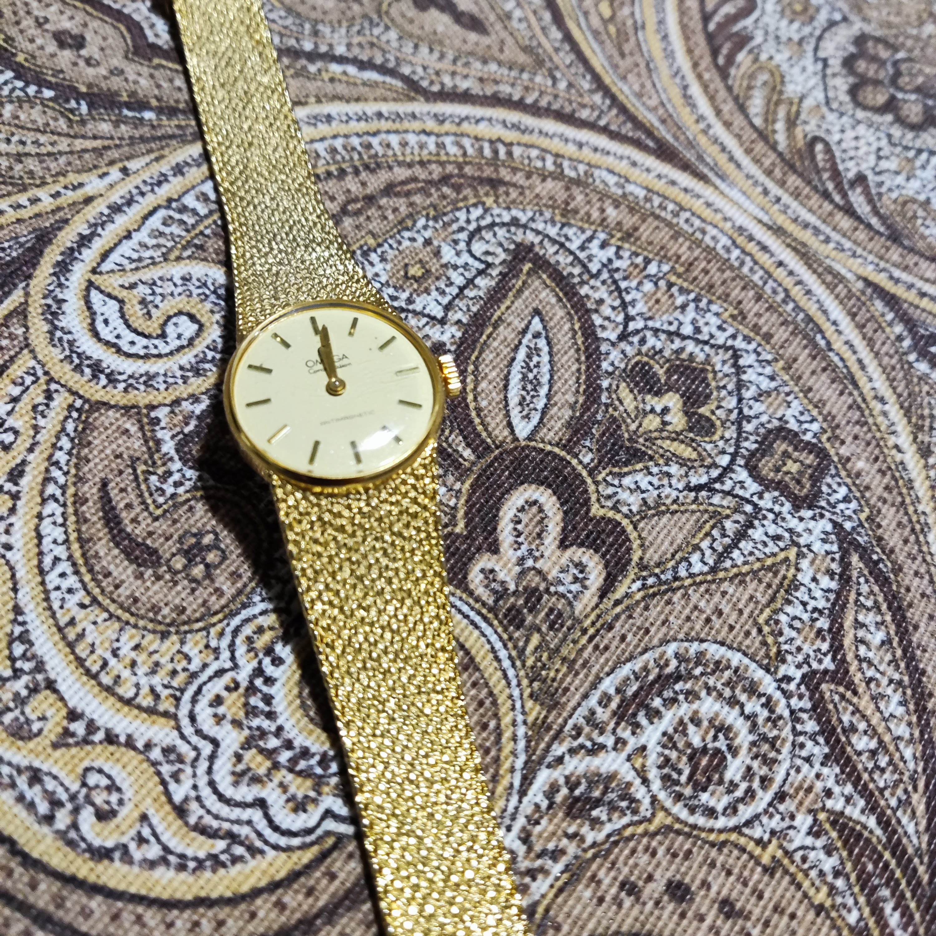

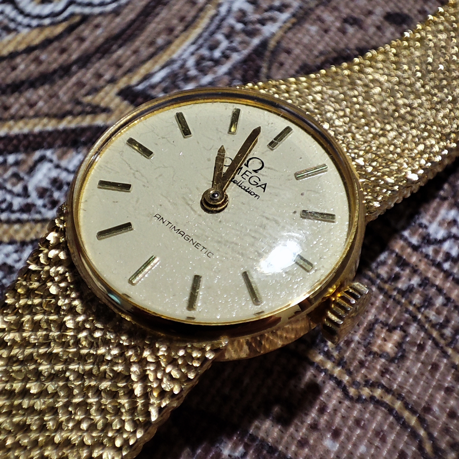

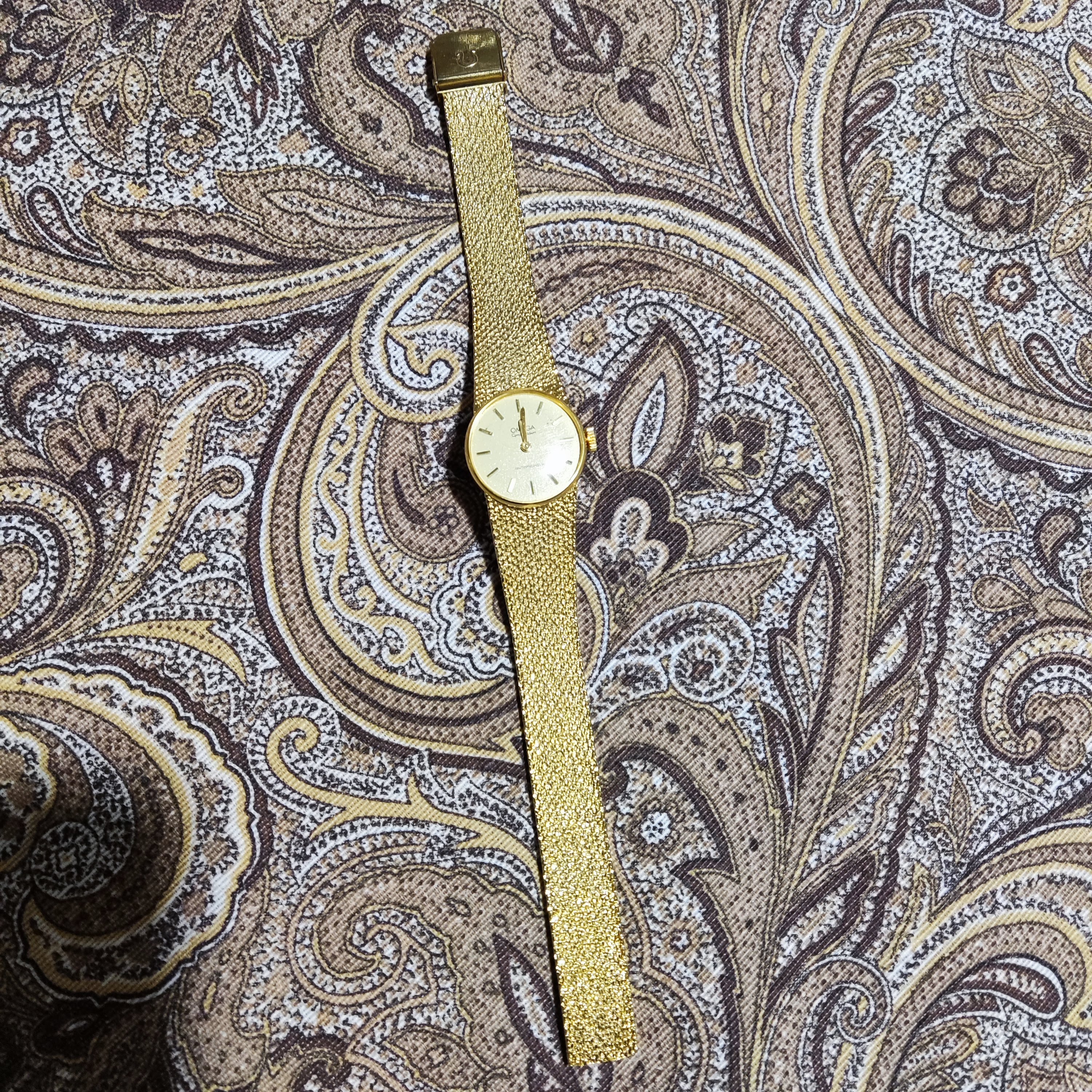

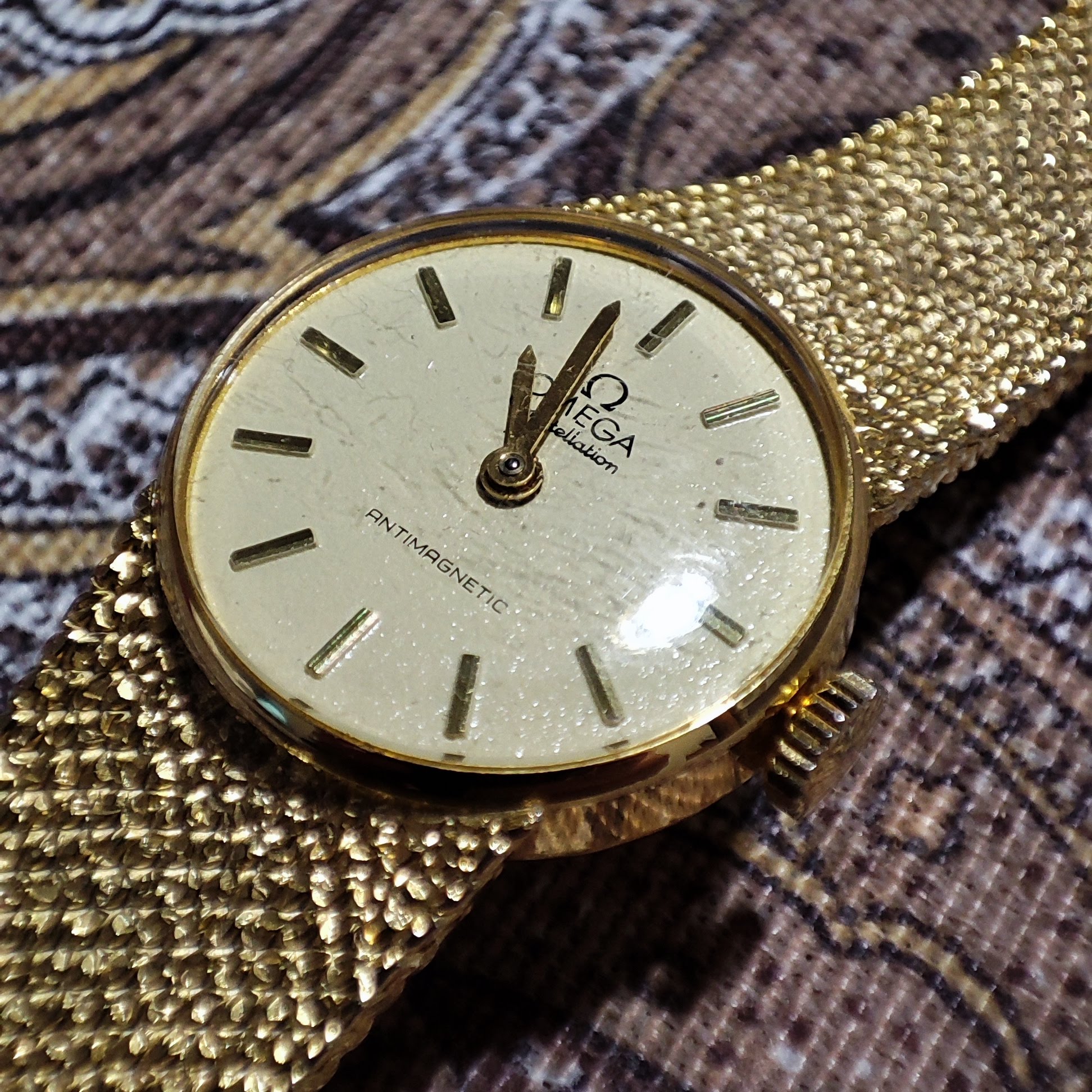

Hello,
sadly my mum recently passed. Going through her staff, I've found a golden watch. To be honest, I don't remember my mother wearing this watch, but I've seen it in some of her pictures of special occasions from the 80's or 90's. In my family, we've been through difficult times in the past, so I don't think my father could afford this kind of presents for my mother. Though, there's a chance that it could have been a gift from my uncle (he did some business in the jewellery field) or my grandparents.
I don't take it for granted, my parents were good people and a couple of times they've been victims of frauds, so it could be a fake watch. Anyway, I'd be glad if you can help me find out if this watch is authentic.
Thank you in advance for your help.

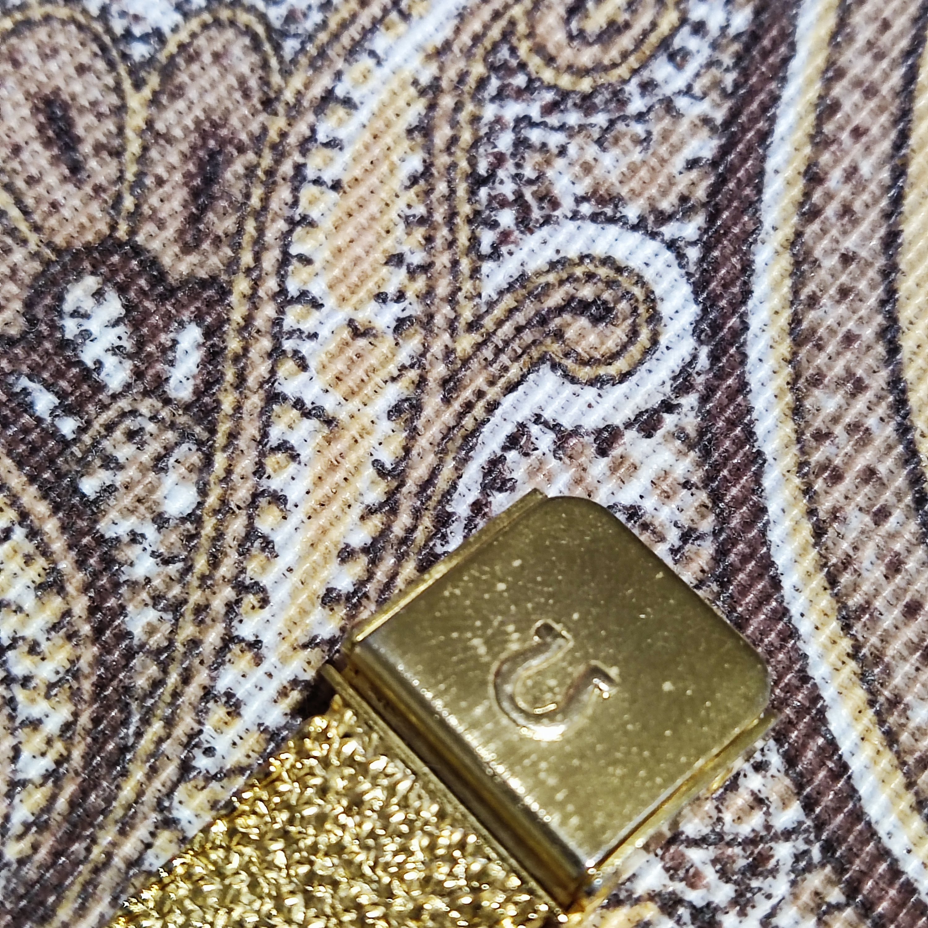

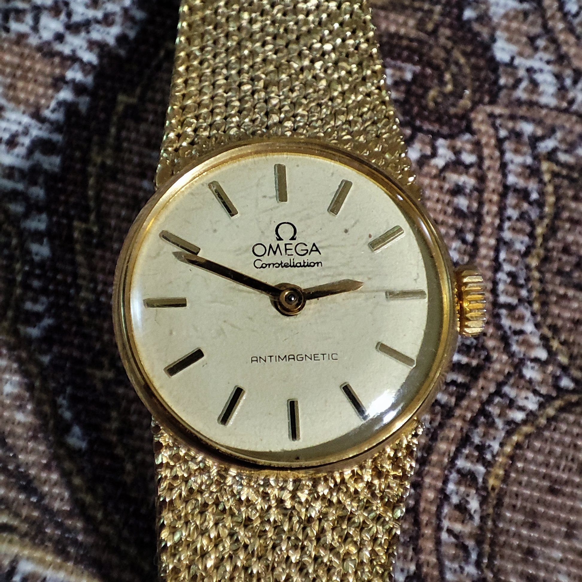

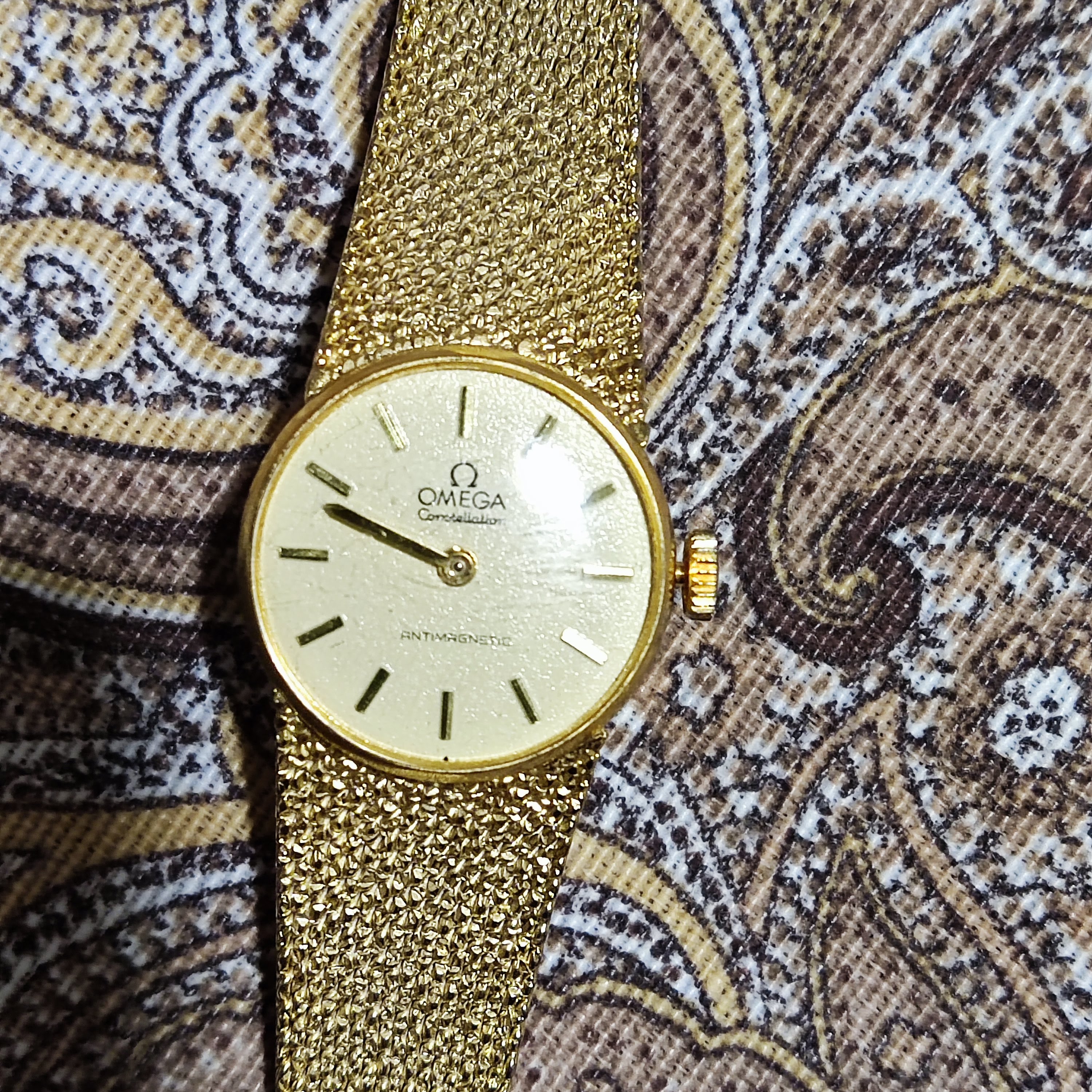

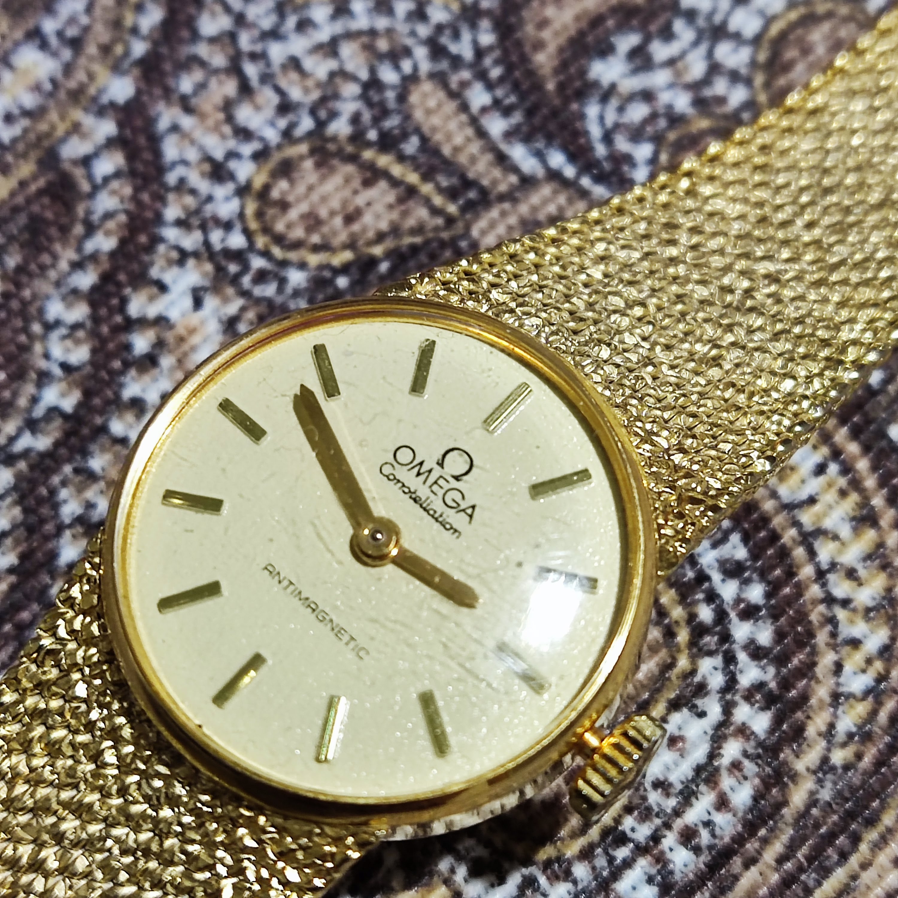

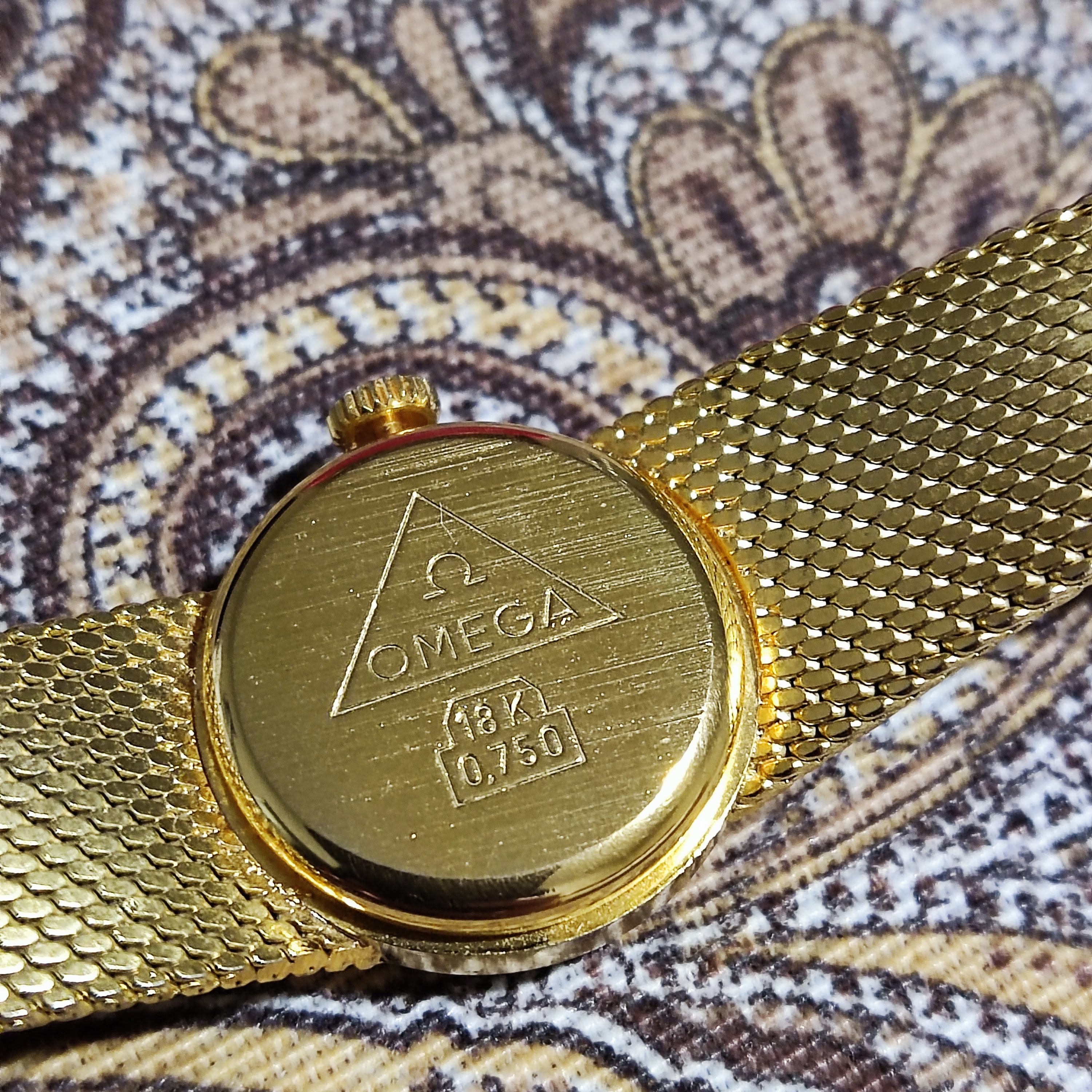

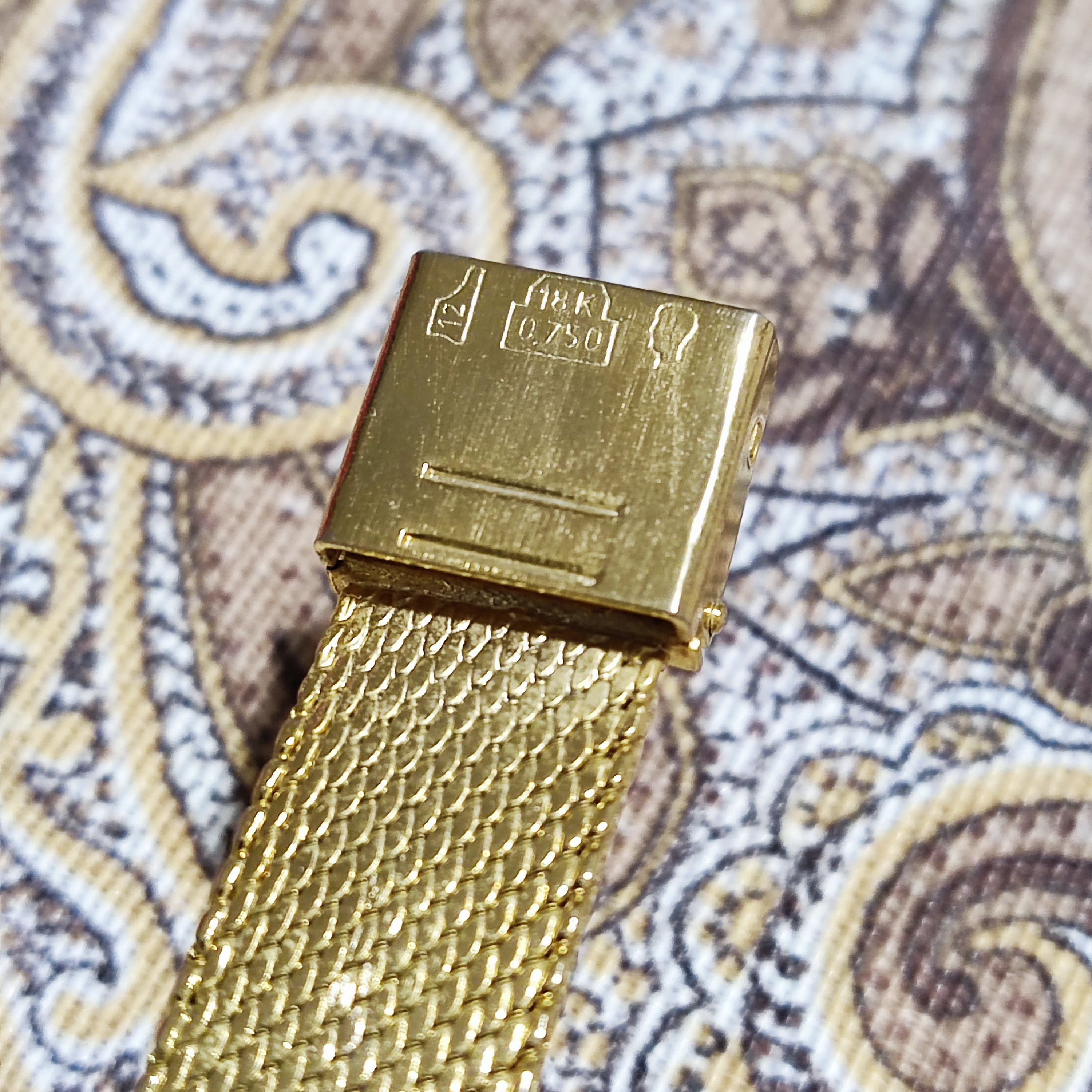

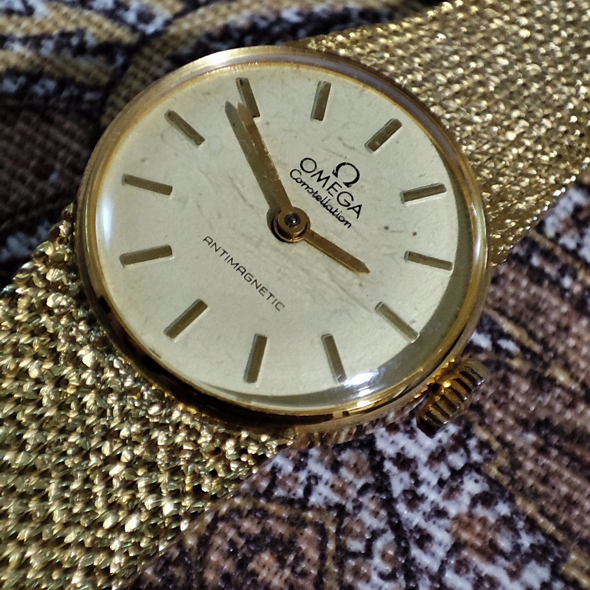

Many things tell me this a fake! The “Constellation” name was only ever used by Omega on men’s chronometer watches. The awful printing on the dial. Omega would have used a gold applied Omega symbol on the dial, not a cheesy printed logo. Omega wouldn’t put “Antimagnetic” on the dial. The dial is die struck. Omega would have used applied baton markers on the dial. The poor quality hands. Omega didn’t put their karat stamp on the outside of the case back. Omega wouldn’t use that Omega symbol on the outside of the case back. Omega wouldn’t use that kind of cheesy clasp on an 18-karat bracelet! Others may add more. There is a piece of the clasp missing at the tongue end. This is a pathetic, horrible fake!
well, thank you for your reply. It's a bit sad. I'll see if it is gold at least.
Don’t waste your money having it tested. It is NOT gold, only gold plated.

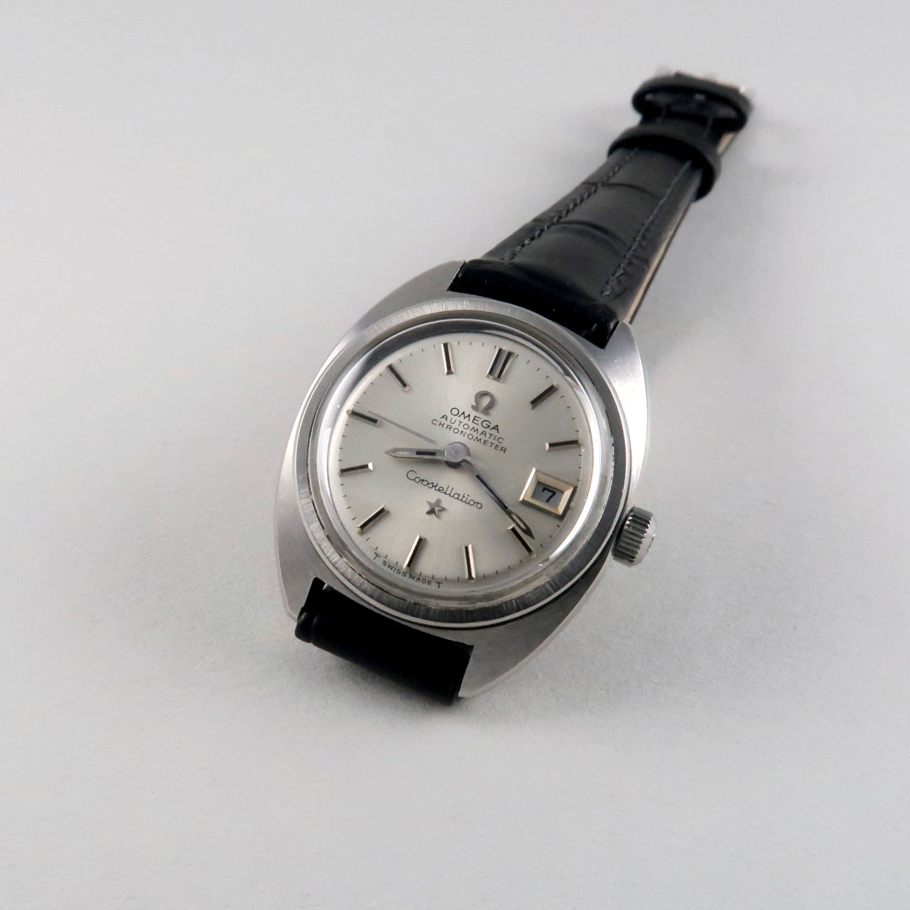

20180317_224831-png.530157

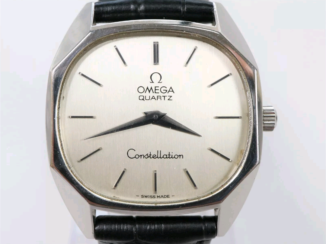

Here you go - a women's Constellation and a non-chronometer Constellation with a printed logo 😁
...Not saying the watch in the OP is correct - nor gold - though!

However, there's no need to waste time with the watch the OP posted, it's an obvious fake and will be made of brass with a thin plating of gold.
These fakes, or more correctly, counterfeits, were made in the thousands during the 1950s/1960s etc and were often called "highway gold" (or European language equivalent) as they were hawked at service centres along the highways of Europe, among other outlets.
