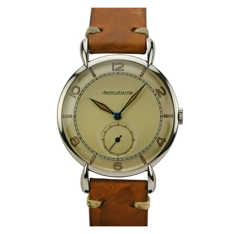

    Looks like a very nice old JLC. Dial looks original to me, movement seems right. Radium looks to be intact.
    You need to be careful with the case. Some of these have chrome plated cases that can be damaged easily. Then they start rusting. Price is more than fair.

    I found this similar model and the movement is slightly different (next to the serial number is not written swiss as it is at my one), the moving wheel with the spring (in german its "Unruh") looks a bit different, the ebay one has 4 insteat of 5 stones at the front (at the ebay one is the 5th one replaced with a screw) and the movement covers are different: http://www.google.de/imgres?imgurl=http://www.farfo.com/images/jaegermilitary.jpg&imgrefurl=http://www.farfo.com/sold/jaegermilitary/jaegermilitary.html&h=400&w=300&tbnid=IrhkzVNUg5eXtM:&zoom=1&docid=2rjqjPU-Vj6SNM&ei=aVuCU5Bp0vXhBLzjgNgC&tbm=isch&client=safari&iact=rc&uact=3&dur=556&page=1&start=0&ndsp=19&ved=0CFkQrQMwAQ
  5. Porsche964 May 25, 2014
    22
    here I found another one that looks like mine, which was sold for 2200$! http://www.google.de/imgres?imgurl=http://www.kalmarantiques.com.au/resources/1/jaeger-lecoultre-watch-es33.jpg&imgrefurl=http://www.kalmarantiques.com.au/1940-jaeger-lecoultre-469-a-es3373.aspx&h=1400&w=1400&tbnid=unxuh_mRzGTgDM:&zoom=1&docid=epPa3CnE0TpZsM&ei=aVuCU5Bp0vXhBLzjgNgC&tbm=isch&client=safari&iact=rc&uact=3&dur=621&page=2&start=19&ndsp=28&ved=0CKMBEK0DMBg
    The movement of this watch looks exactly as the movement of mine, but "swiss" isn't written on this one too. The dial looks a bit different because the minute and second scale is on the outside while mine is on the inside of the dial.

    In my opinion, all three of the watches are all original. Yours has "Swiss" on the dial and on the movement. This is normal for these watches. I have seen many JLC dials with similar markings to all the watches you've shown here.
    It is not unusual for there to be running changes in movements or cases. Also, these may not all be exactly the same watch.
    I think you need to continue your research further into this style of watch.

    Thank you gatorcpa! I compared it with other watches of this kind and I am pretty shore that it is a real one. I am pretty happy because mostly you pay about 1000$ for such a watch and I payed only 470$. Probably that was a really good deal.

    Yes. It was an excellent deal. That last seller's watches were almost all recent redials. Excellent work, possibly even done by JLC contractors, but still redials.
    I really like yours, because there is nothing but good, honest wear on that watch. It is extremely difficult to fake that kind of patina.
    As I said on your other post, sometimes you just need to be patient and ask questions. Preferably before you win an auction. However, this time you were very lucky to get such a nice watch at a low price.
    This can happen on Sundays, as the professional buyers on eBay need a day off too!
