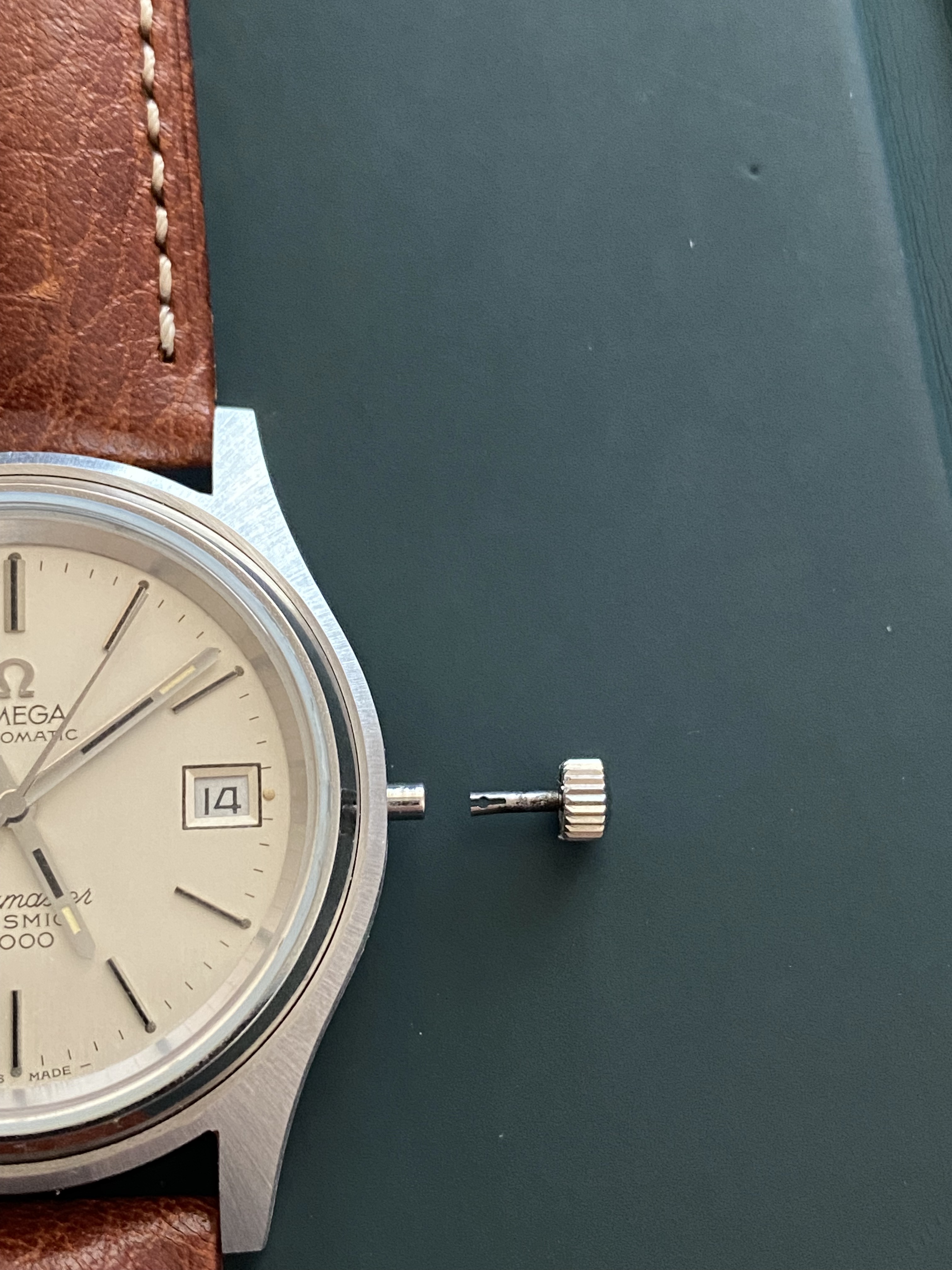

So the crown and winding stem came off.
The crown is new from a service last year, and I thought the winding stem was also replaced.
Anyways, can you guys help me out and recommend a US watchmaker that I can mail the watch to and one that can properly open a Seamaster Cosmic 2000 case?
Also, is this just the winding stem that needs to get replaced, as the crown is still new?
Thanks!
1,076
1,787
Hi, looks like a split stem. You could try pushing it back unto the male part of the stem. I would require a slight force to re engage. If not use a small needle nose pliers to close the gap slightly on the female side and try again.
30,270
78,121
The female portion of the split stem is spread open, and needs to be replaced. That one is certainly not new, so I doubt it was replaced recently.
The case doesn't need to be opened for this, so a new female split stem can be fitted to the crown, and it can simply be snapped back together.
Part number for the new female split stem is 081ST9999.
Cheers, Al

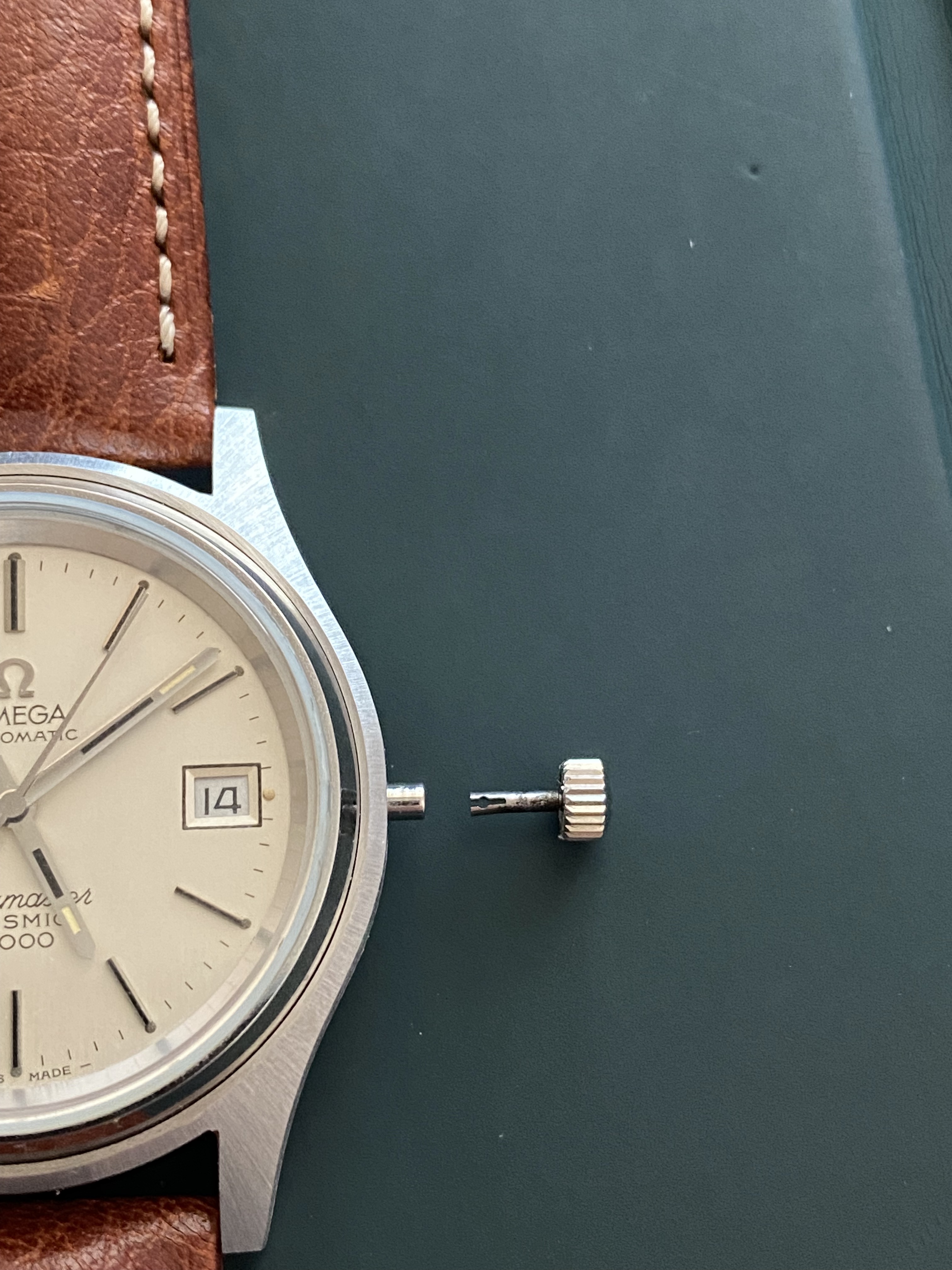

Thanks!
2 piece stem.
Looks splayed out.
Some one said close it up with needle nose pliers.
Put a shim or needle in between so as to not pinch it closed all the way.
Then put back into the tube, push lightly rotating till it moves inward.
Then see if you can push er home with a click.
Just don't be real agressive or you will have more problems.
If you are in AZ I would look at it.
Mike
30,270
78,121
I've tried this in the past, and often they just snap when you try to close them up. If they don't snap then, they can snap off when you try to push the female part of the stem onto the male part. That means you now have a part of the stem broken off and floating inside the case, so it makes a simple repair into a more complicated one as you now have to open the case, in particular with this case design.
The female split stem parts are cheap, so although trying to bend it back is an option, to me it's not worth the risk.
Cheers, Al
