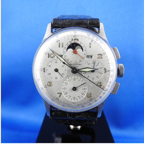

    Afternoon all,
    Thinking of taking the plunge and getting my first UG, have a number of modern Swiss watches, but I am astounded by the quality and complication you get for the relative price in UG. The enclosed looks like a nice example - 1960s apparently, I just can't find any dials the same on the net - nice patina, but any thoughts on if it has been re-dialled? The reference they quote is 22242/1107421 with a Calibre 481.
    Any thoughts appreciated!!!

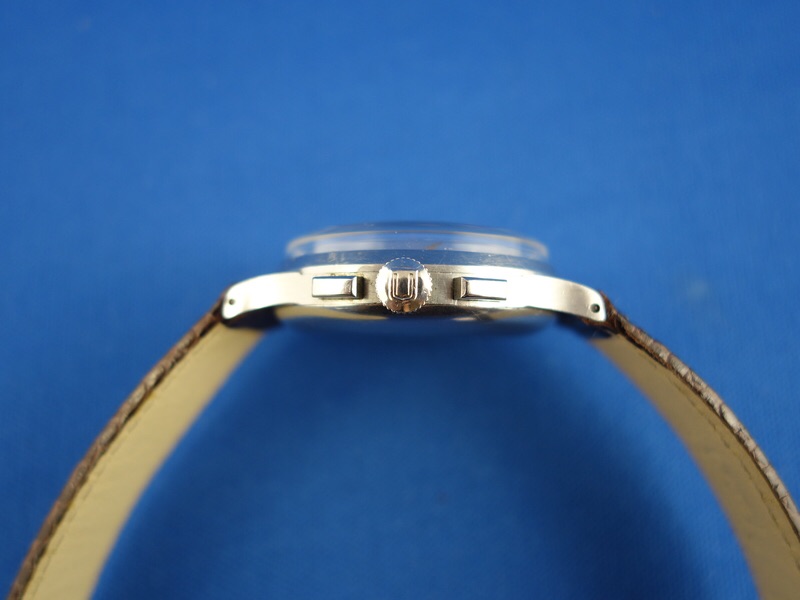

  2. jordn Wants to be called Frank for some odd reason Aug 9, 2015
    713
    2,011
    1107421 serial number dates this watch to 1945, but this dial (not refinished) type with stick markers and indented date register was typically used in early to mid 50's Tri-Compaxes (with some late 40's outliers). The hour/minute hands and the crown are genuine UG parts, but they are not native to this case either. I've only seen these alpha hands used in late 40's and early 50's time only watches, and it is my belief that signed crowns were not used until the early 50's. I should mention, however, that while there is a generally established progression of dial types and other parts used in UG watches from the 30's to the 60's, there is no precise chronology to mark these changes. That being said, I can say with approximately 95% certainty that this is a franken watch.
    Edited Aug 9, 2015

  7. nicolas07 Aug 10, 2015
    197
    238
    Hi,
    Maybe another point is that, if I am correct, moonphase for 40's tri compax should have a face on it while later ones have not.
    Again, this is not like a completely fake dial but as Jordan says it is what we can call a franken watch as it is made of parts from different era/watches reference.
    That being said, the overall condition is clearly good and it is a very nice looking watch!

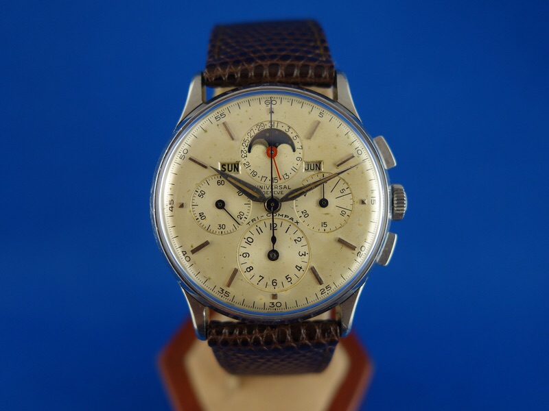

  11. aussywatch May 15, 2016
    4
    6
    Hi All - another one has come up at about the same price. Late 1950s, Cal 481. Any thoughts gratefully received!!!!

  12. rolokr Jun 8, 2016
    1,195
    1,918
    Very nice looking example !
    Larry S likes this.
  13. MMMD unaffiliated curmudgeonly absurdist & polyologist Jun 8, 2016
    4,642
    31,001
    Agree, looks like a winner.
    Larry S likes this.
  14. Larry S Color Commentator for the Hyperbole. Jun 8, 2016
    12,469
    49,507
    Buy this one.
