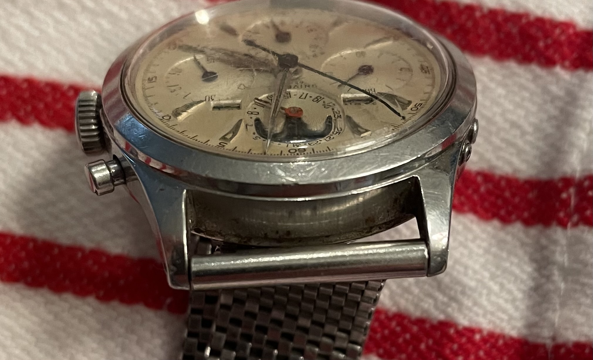

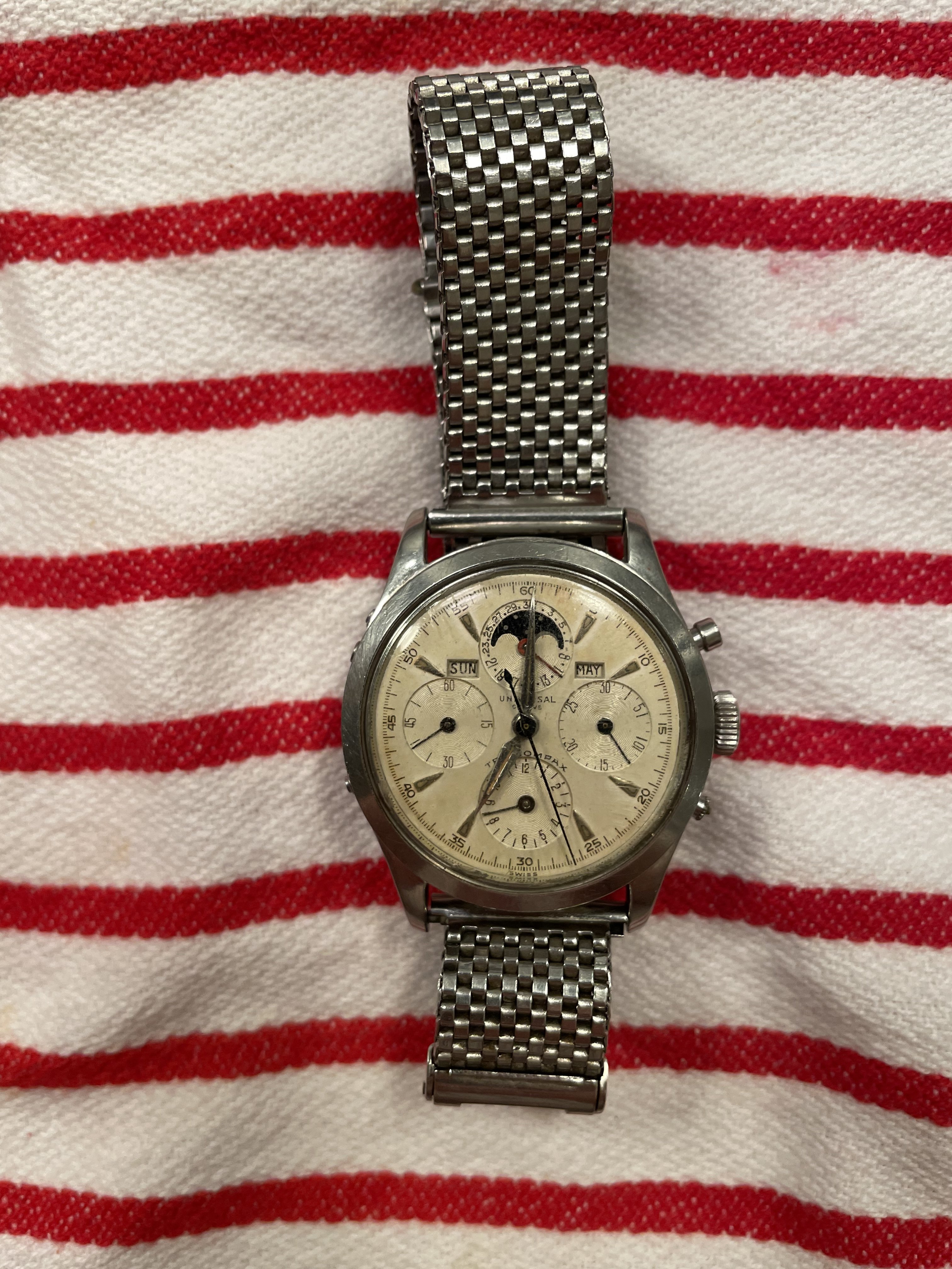

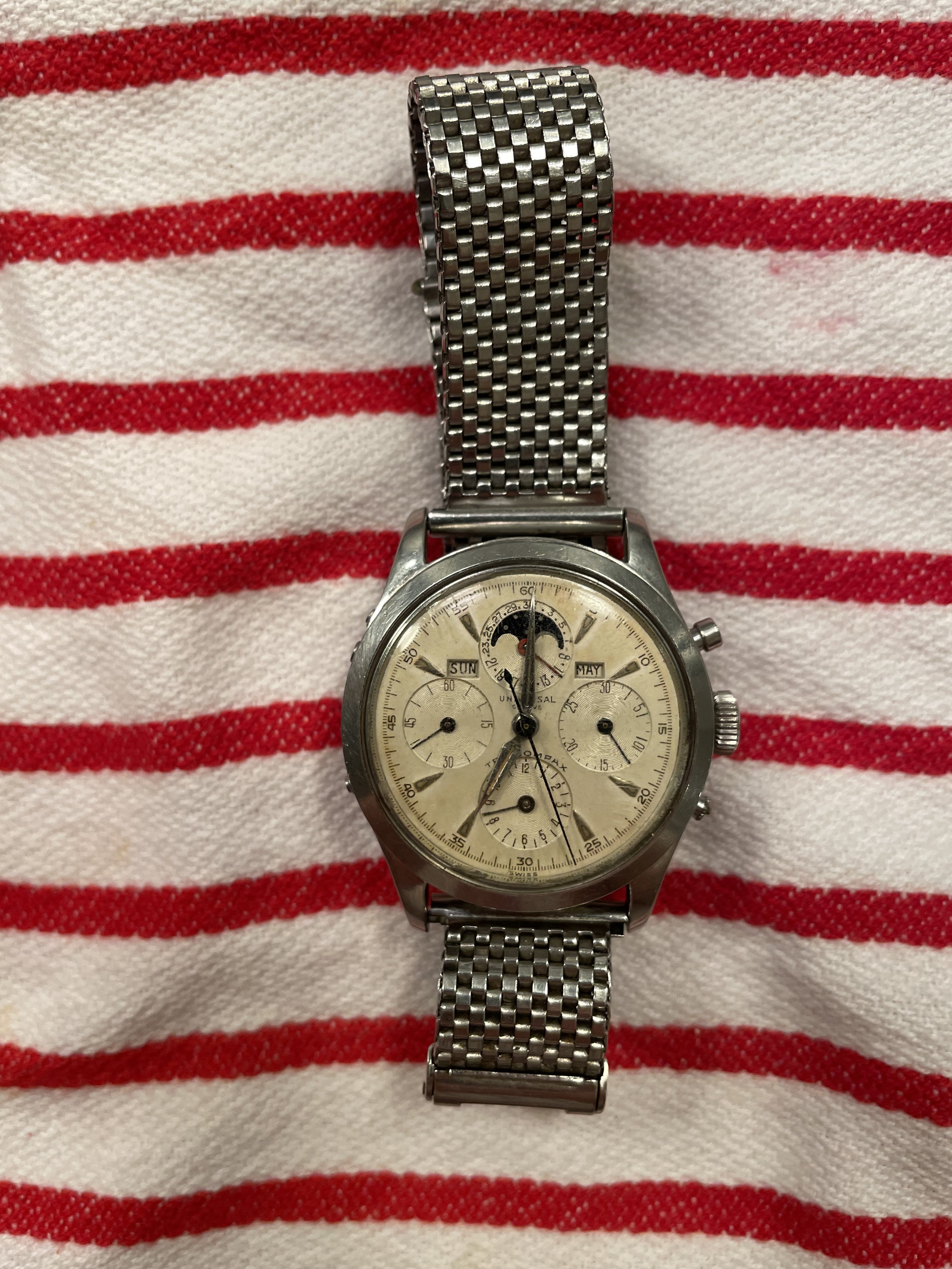

Hi all— recently inherited my grandfather’s circa early 1950s (I think, based on info here) Universal Geneve Tricompax.
I know nothing about watches, but after a quick internet search it looks like a cool thing to have, and a great way to remember him by. However it needs some TLC.

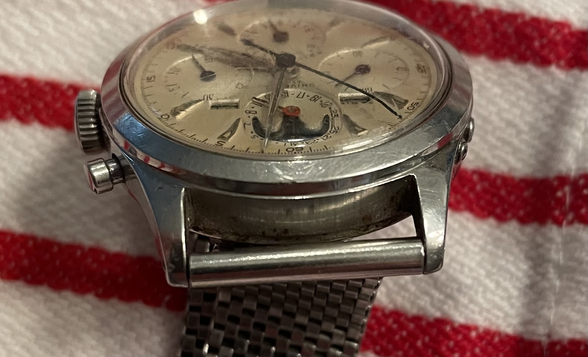

What would be the best way to get it serviced/rehabilitated? I live in Tennessee and don’t really know where to start to look/who to trust with it. It doesn’t have a pusher, the case needs some rehab, the crystal is a bit scratched, and I’m sure it hasn’t been serviced in probably over 15 years.
Just want to do right by the watch and the guy who wore it. Any advice?

Good news is that this a valuable watch in honest condition. Not many of this model are out in the market. If that’s a GF bracelet, all the better. We’d need more pics on that. The bad news is the missing small pusher. That’s going to be a challenge to source. If the watch was all intact, 6-8k, so it’s worth restoring. Collector grade models can go higher. Were this mine I’d service the movement and replace the pusher, take scuffs out of crystal. No case, dial or hands work. You will kill the value. Two thoughts.. RGM in Mount Joy PA does restoration work on UG. I’d also recommend MJ Watch Service in Glenview IL. (They are great with UG). I’d reach out to both. I’d budget a grand to get this sorted. In both cases, send as much detail and discuss before shipping.

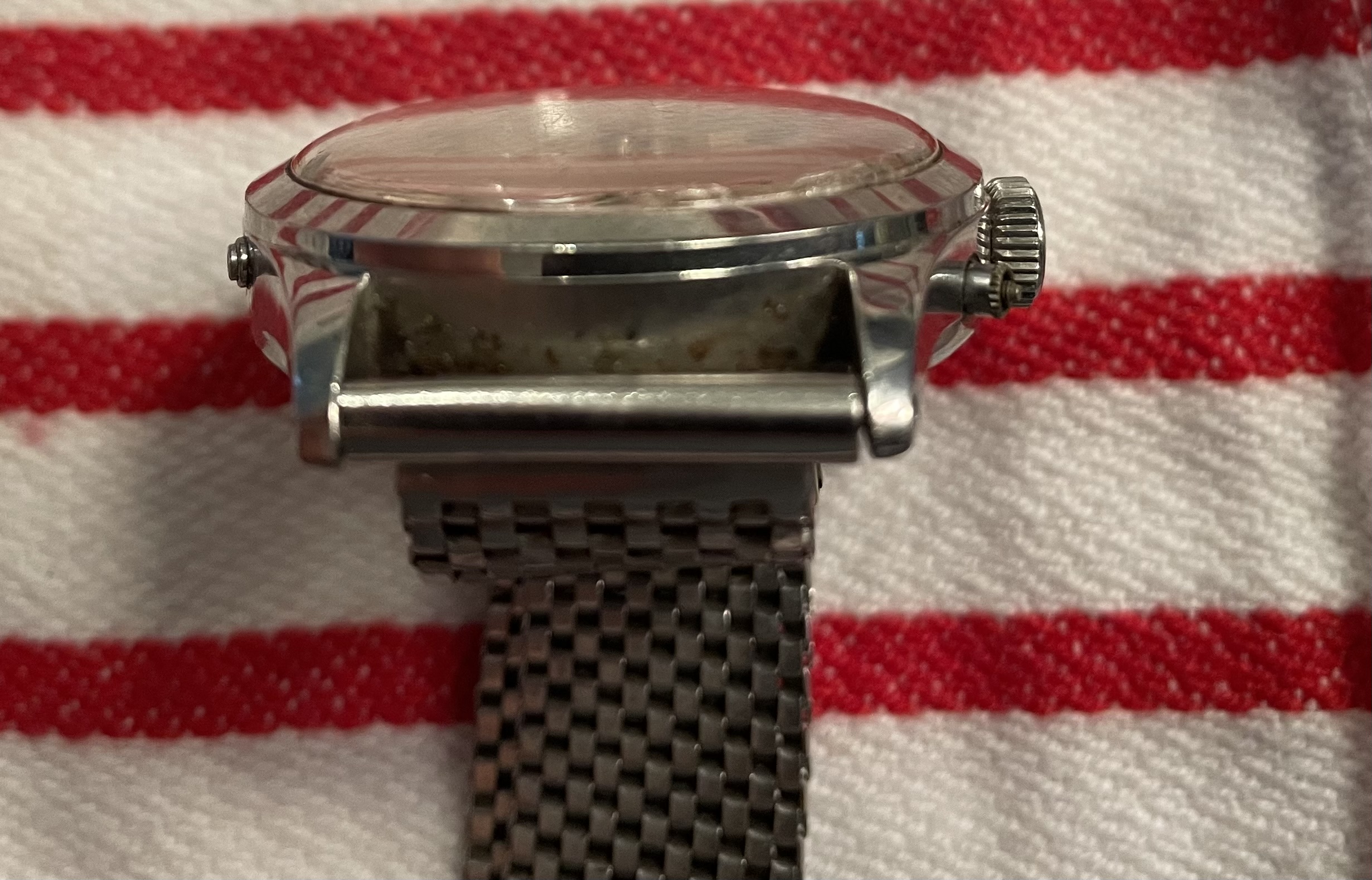

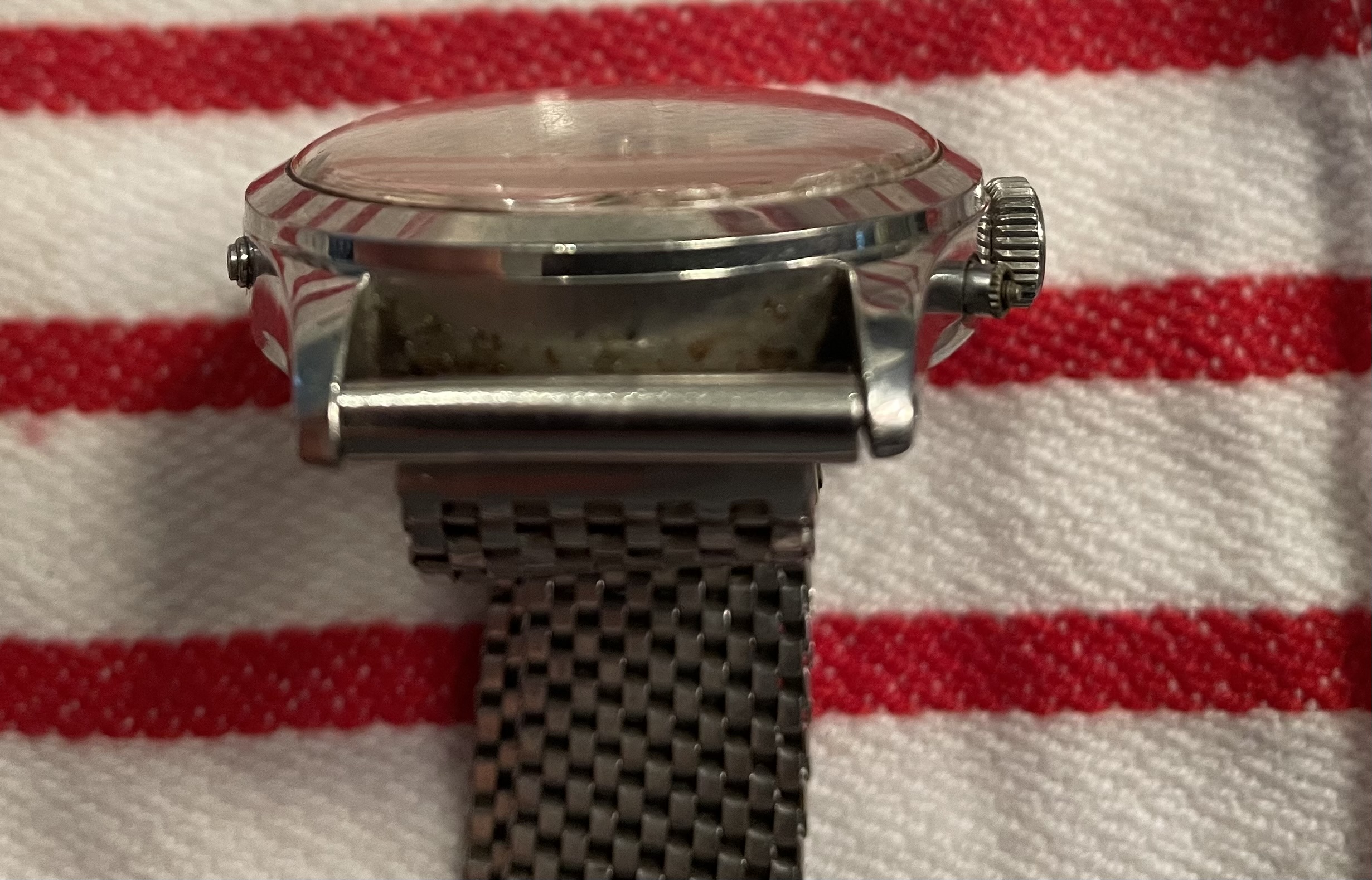

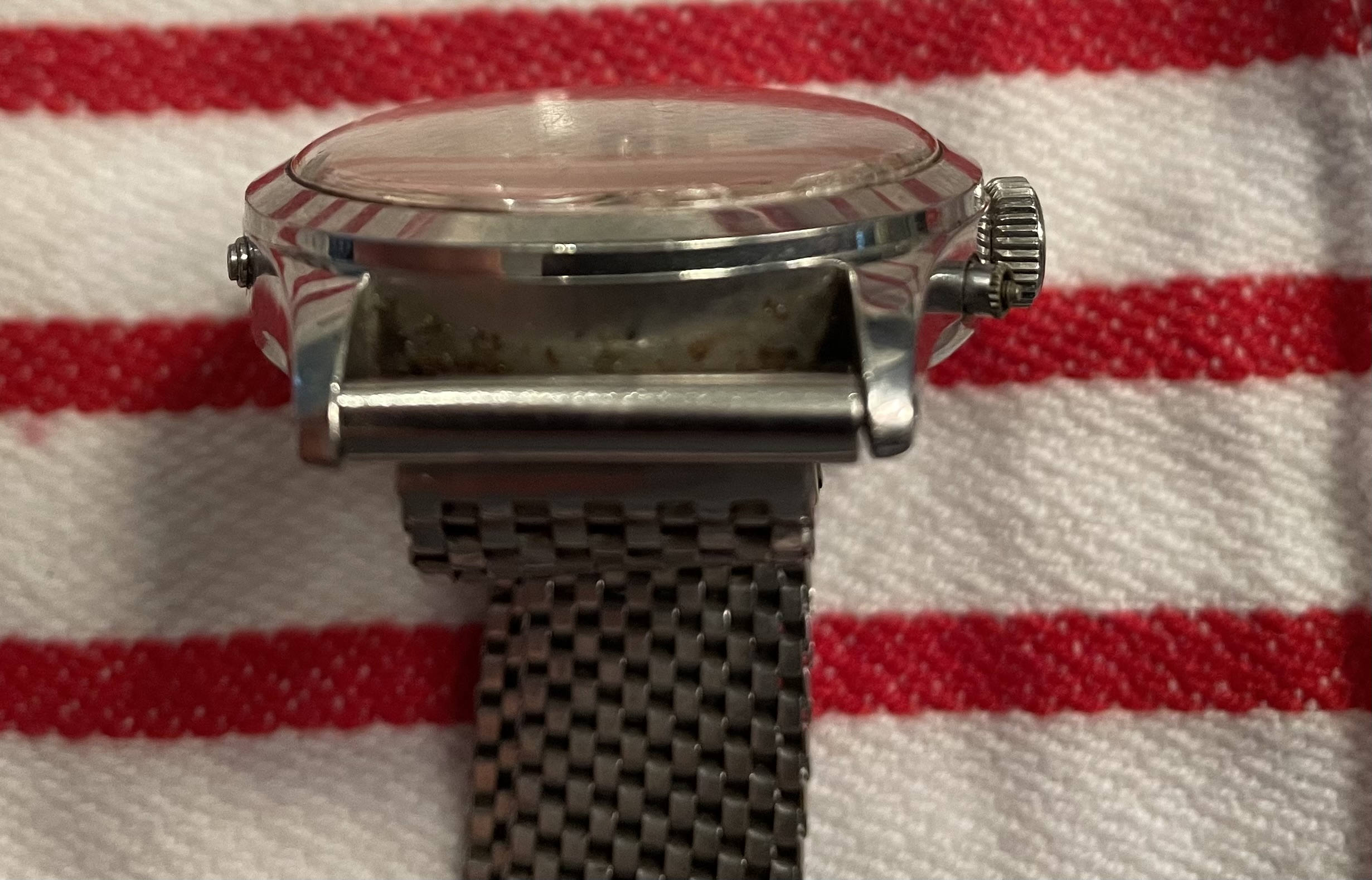

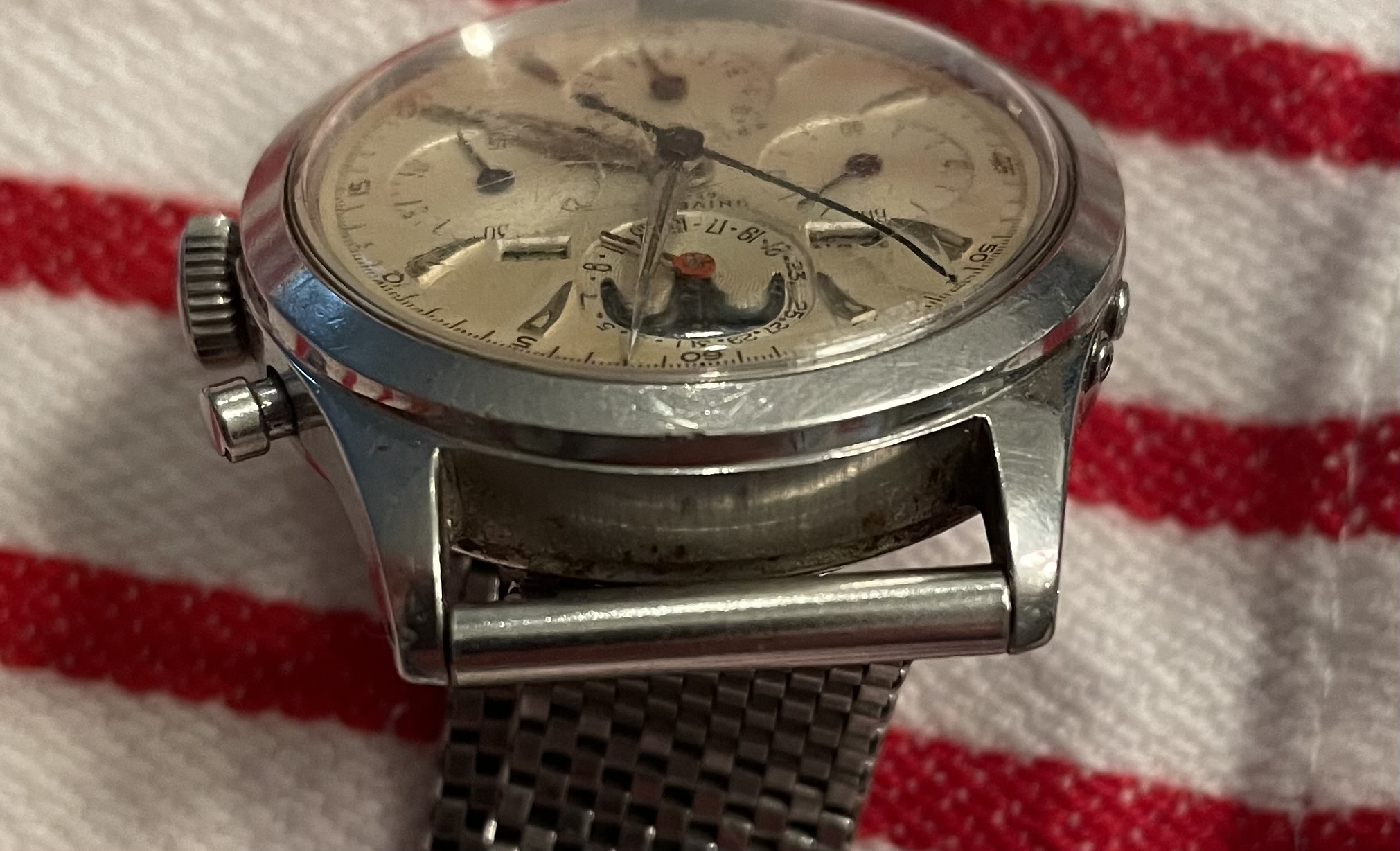

Here are some pictures of where there's oxidization on the case. You said no case work, but would getting these spots out be a bad idea?
Sorry if the answer is obvious, but again, total noob here. Really appreciate the help.

It’s just dirty SS case. Watchmaker will clean it. No polishing though. GF = Gay Feres …

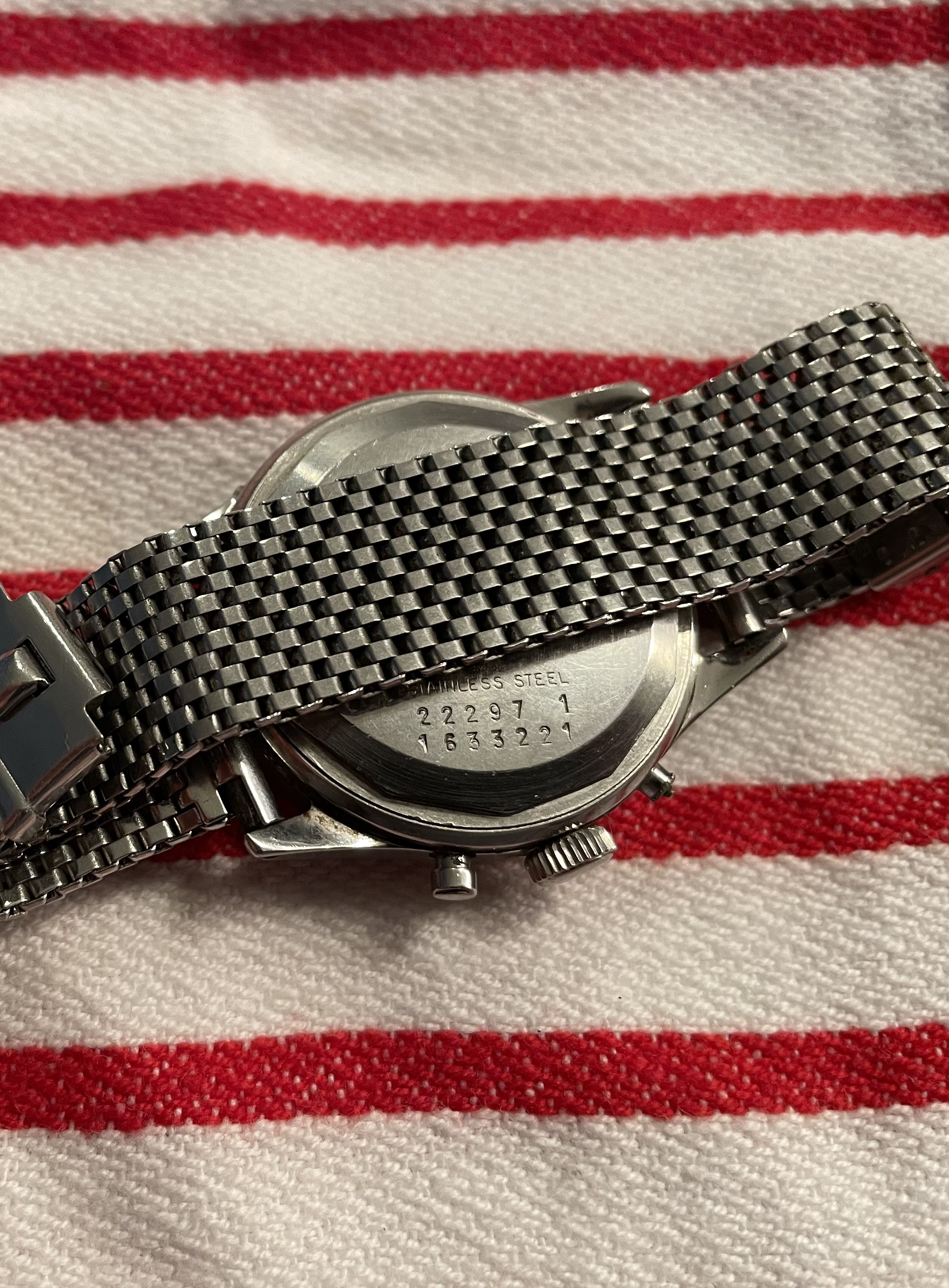

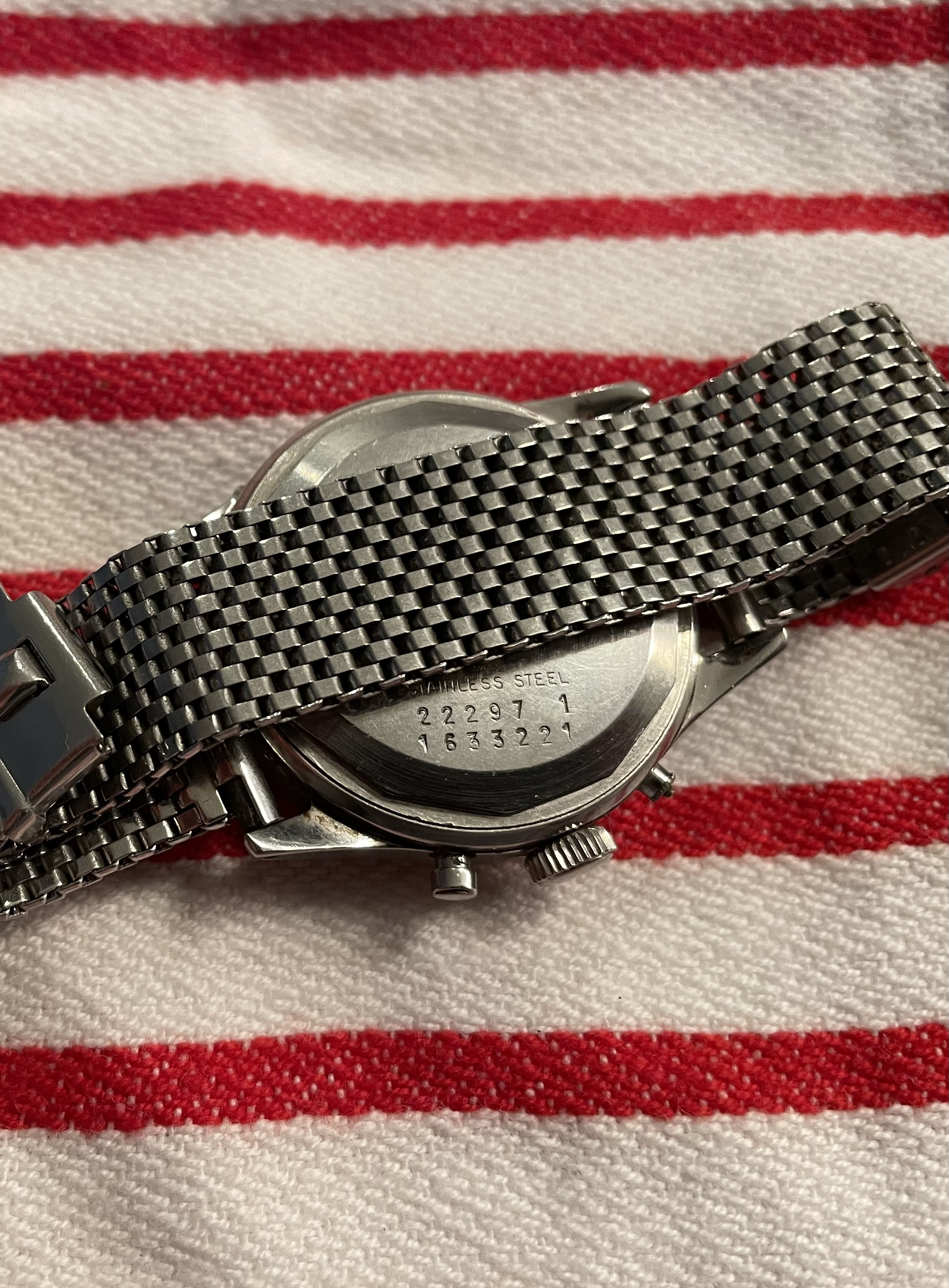

Beautiful Tri Compax, congratulations. Looks like a 22297/1 ? Are the case reference and serial visible on the case back ? As Larry said, I think that pusher cap is a very tough part to find, but maybe you can get lucky with patience. In the meantime, fit the closest pusher you can find, get it serviced, and enjoy

Absolutely beautiful watch, wear it in good health.

Really great tri, congrats! +1 to what everyone else has said here, no polish and dont replace/touch dial/hands - be sure to specify this with the watchmaker, as a polish is usually standard with a full service. You’ve inherited a desirable and beautiful watch.

As previous users said, have a good (!) watchmaker service it, and as advised, cleaning the case rather than polishing it, Once of that done, you will have something you will enjoy wearing and that possibly go on to the following generations 😀

22297/1 SS indices. Mine has same shape indices in gold but is a /2.

It's the 22297/1.
Great watch! Since we are talking in codes I think it looks
more like a JB than a GF😉
The band is a "Forstner Komfit." The band just barely fits my wrist, so I may want to change that out. Open to recs on bands that would look good with it, if anyone has strong opinions.
