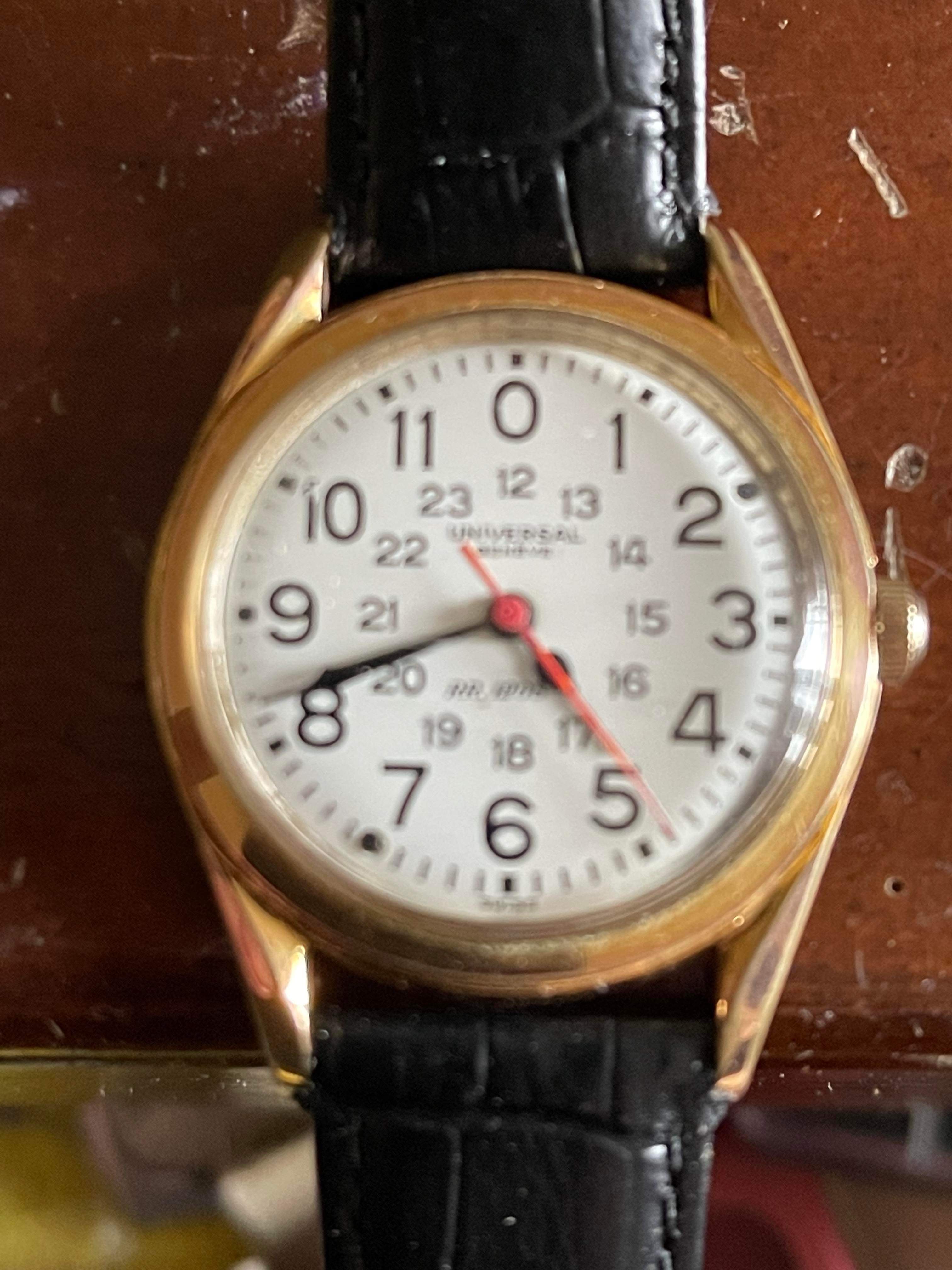

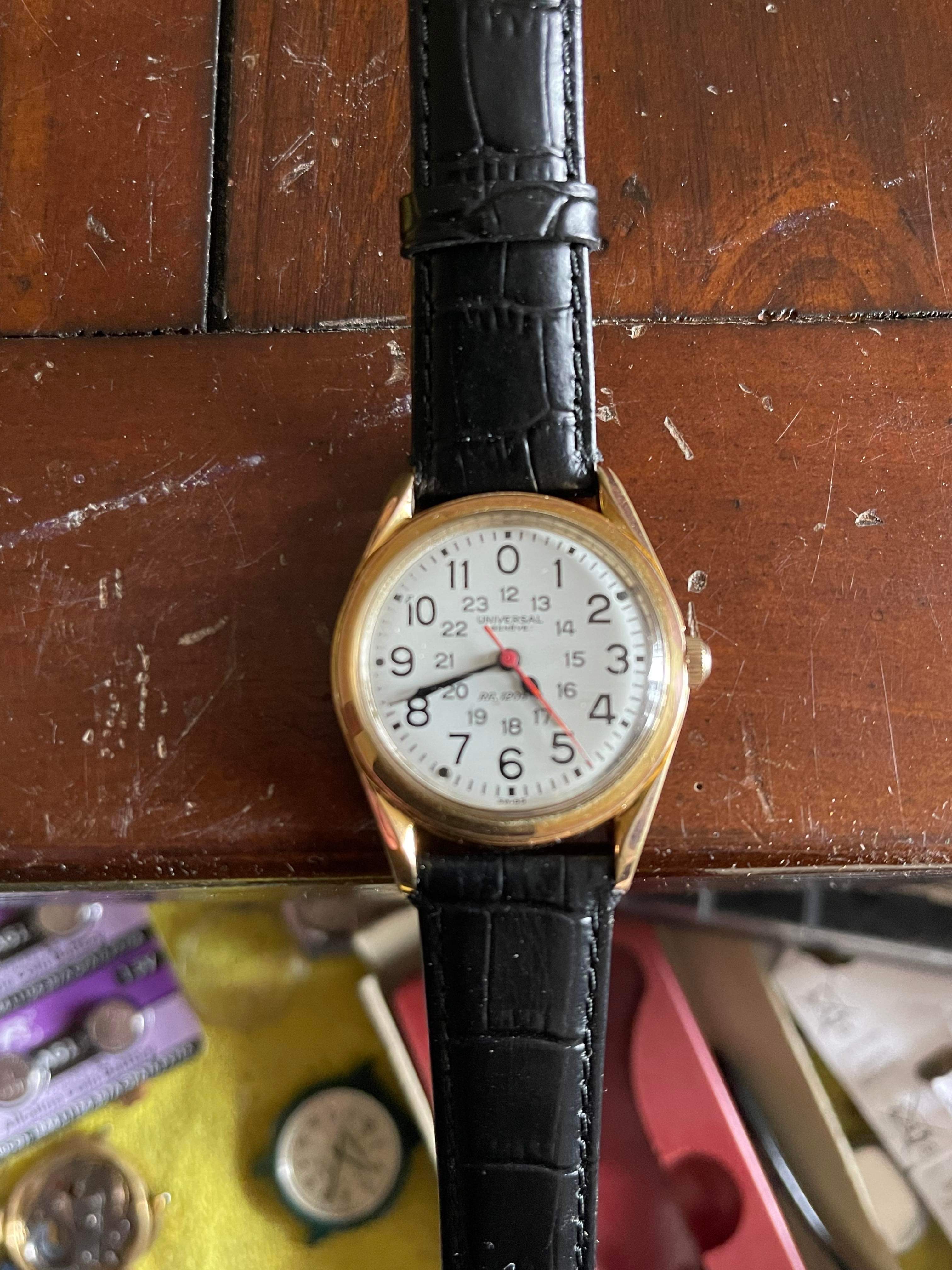

Been offered this Railrouter 1205-0, would love any advice...
Questions I'm having:
Did they do the Railrouter in gold-cap case?

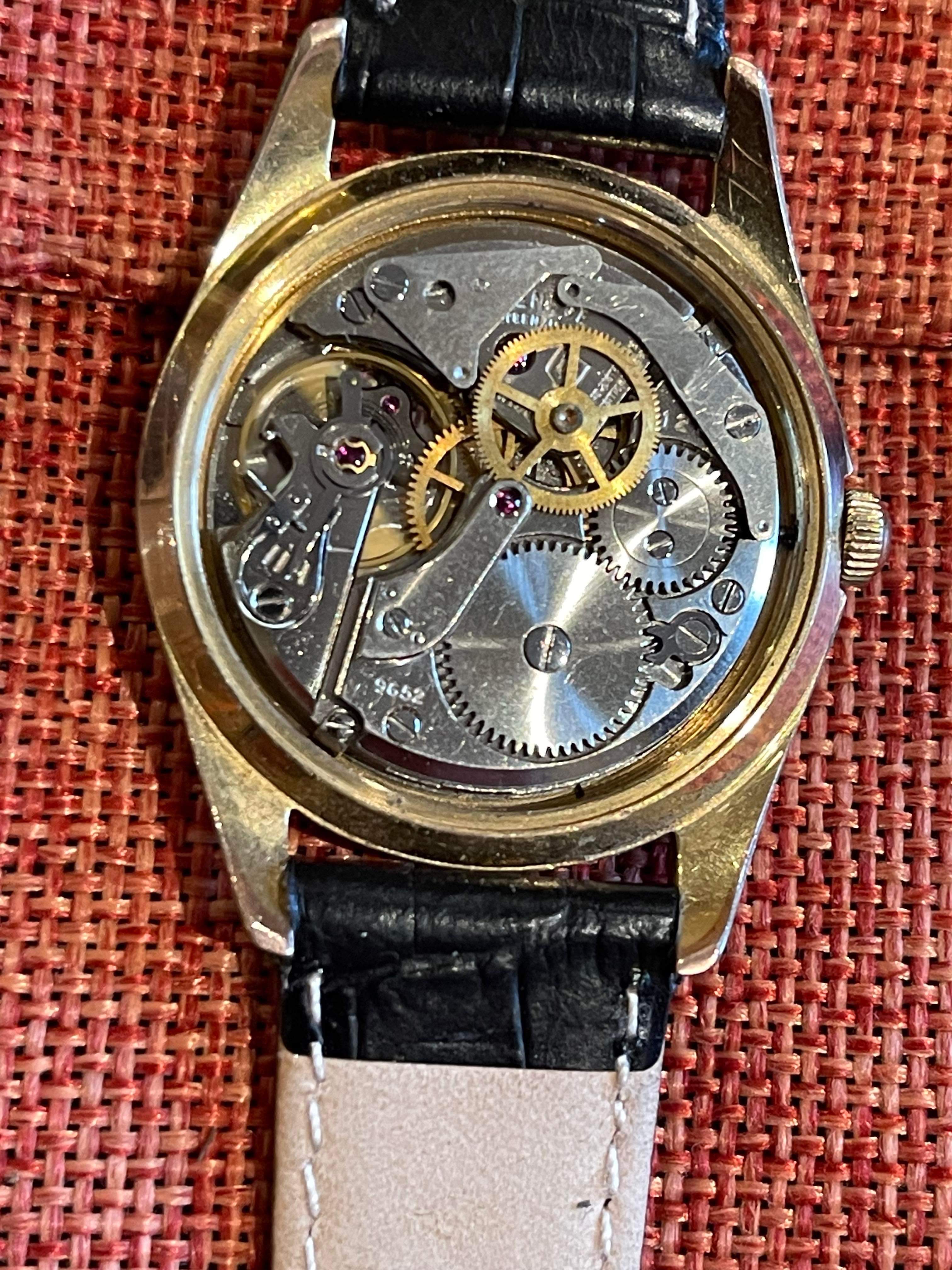

Is this the right movement? It does look like it has the hacking seconds function.

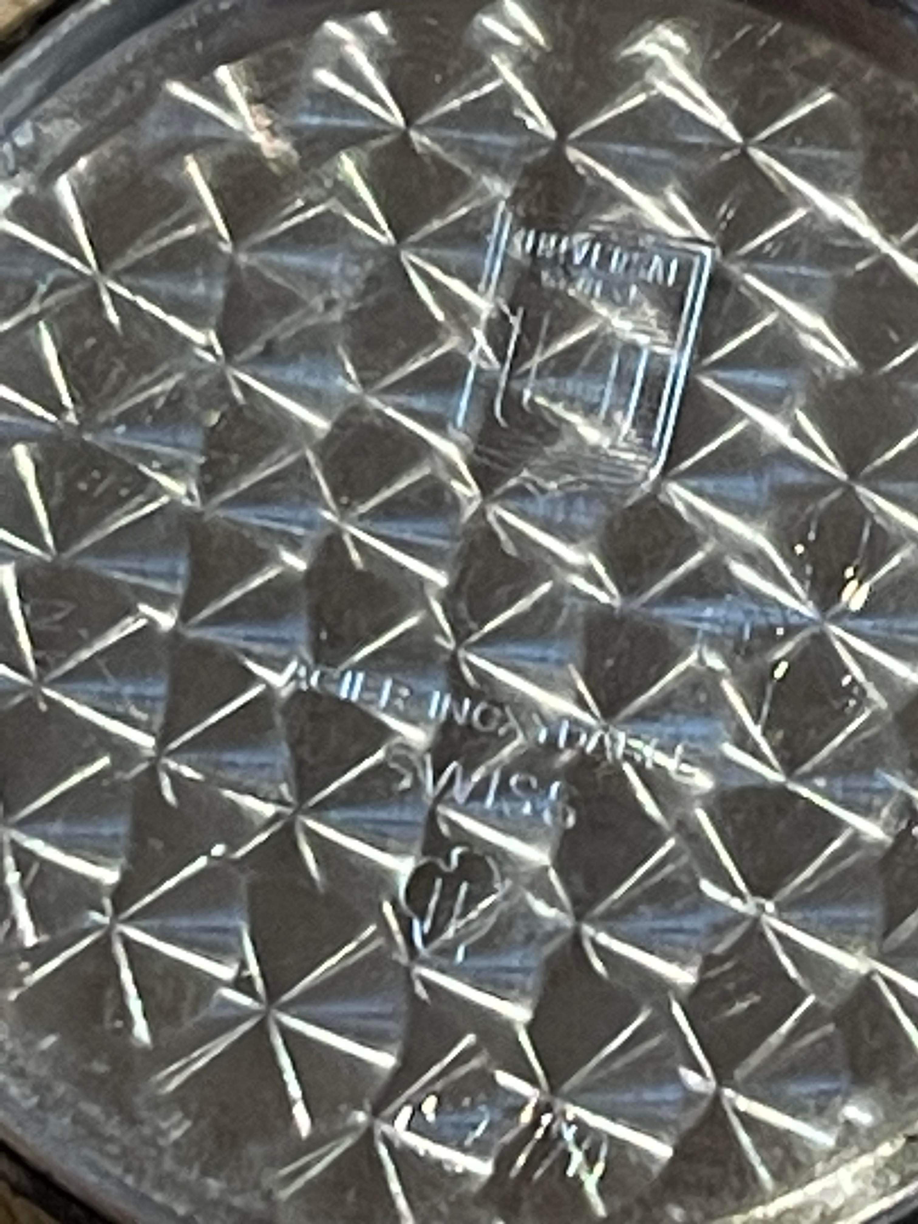

Caseback looks somewhat correct...crown is not correct I think.
Also, the font on the dial looks slimmer than other examples I've seen online. File_002.jpeg File_003.jpeg File_000.jpeg File_001.jpeg

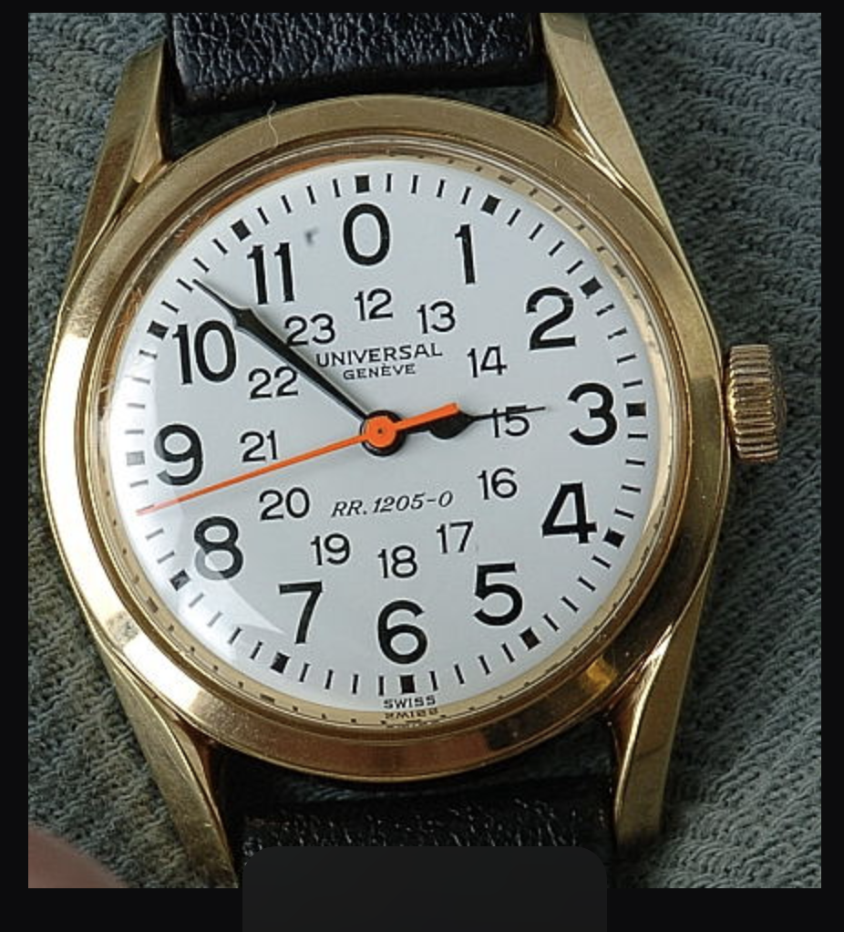

This is another example below for comparison Screen Shot 2023-04-03 at 9.54.02 PM.png

I think the gold cases were an optional "upgrade" for the standard S/S model. They used to crop up on ebay sometimes, I bought a NOS case and crown with signed plexi. However, a word of warning...my original watchback wouldn't fit the gold case so I had to use the NOS casebook which of course doesn't have the movement nos. which identified my watch as a chronometre.
If you do a search on here you should find an article about the various railroad wristwatches which were produced including the UG iterations.
