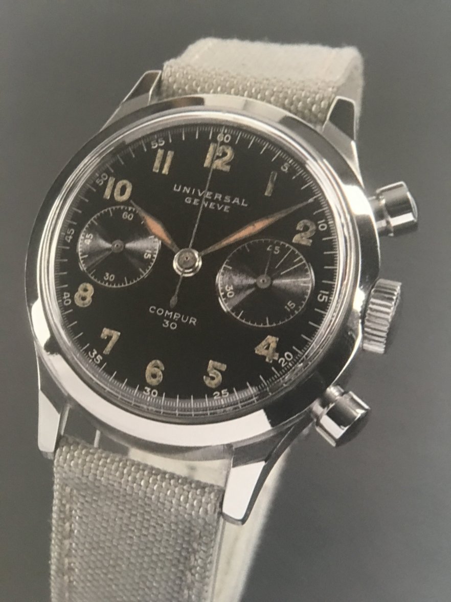

These dials are legit enough, but I'm not so sure about them being born in these Spillmann cases.
The two above are in the same style, but made for the smaller calibers obviously. However, please note that the reference numbers start w/ '1' - meaning that they were encased in gold. The dial font used on these so-called "prototype" dials is period correct to the serial number date found on the Mentawatches example, but these fancier dials were usually paired with fancier cases a la...
(photo cred: @LouS)
Far from hard proof, but the Spillmann cases were used more for watches that were tool-oriented like the Luftwaffe Compur or the Aero-Compax.
Does it matter? Perhaps not. I certainly wouldn't mind owning one as I find these dials to be some of the best UG ever made, but I've also heard that these dials were changing hands privately. If @BenClymer wouldn't mind enlightening us on how he came across his particular example, it would certainly be of huge help to us.

Could be true... but if you look at the dials on pg. 289/290, like Jordn says, those are likely meant for smaller calibers. I'm only guessing at this point, but look at the spacing between the left subdial and "compax", and the right subdial and "compax" on the pics in Sala - that's a lot smaller vs the example with Mentawatches -- if we think that the words "compax" is the same size, then it means those subdials are closer together, etc.
In short, the dial in the OP's example is meant for a larger caliber which means its designated for a larger case. What kind of case or pushers, I can't say for sure, but it has to be a 38mm case because it just doesn't fit otherwise.
