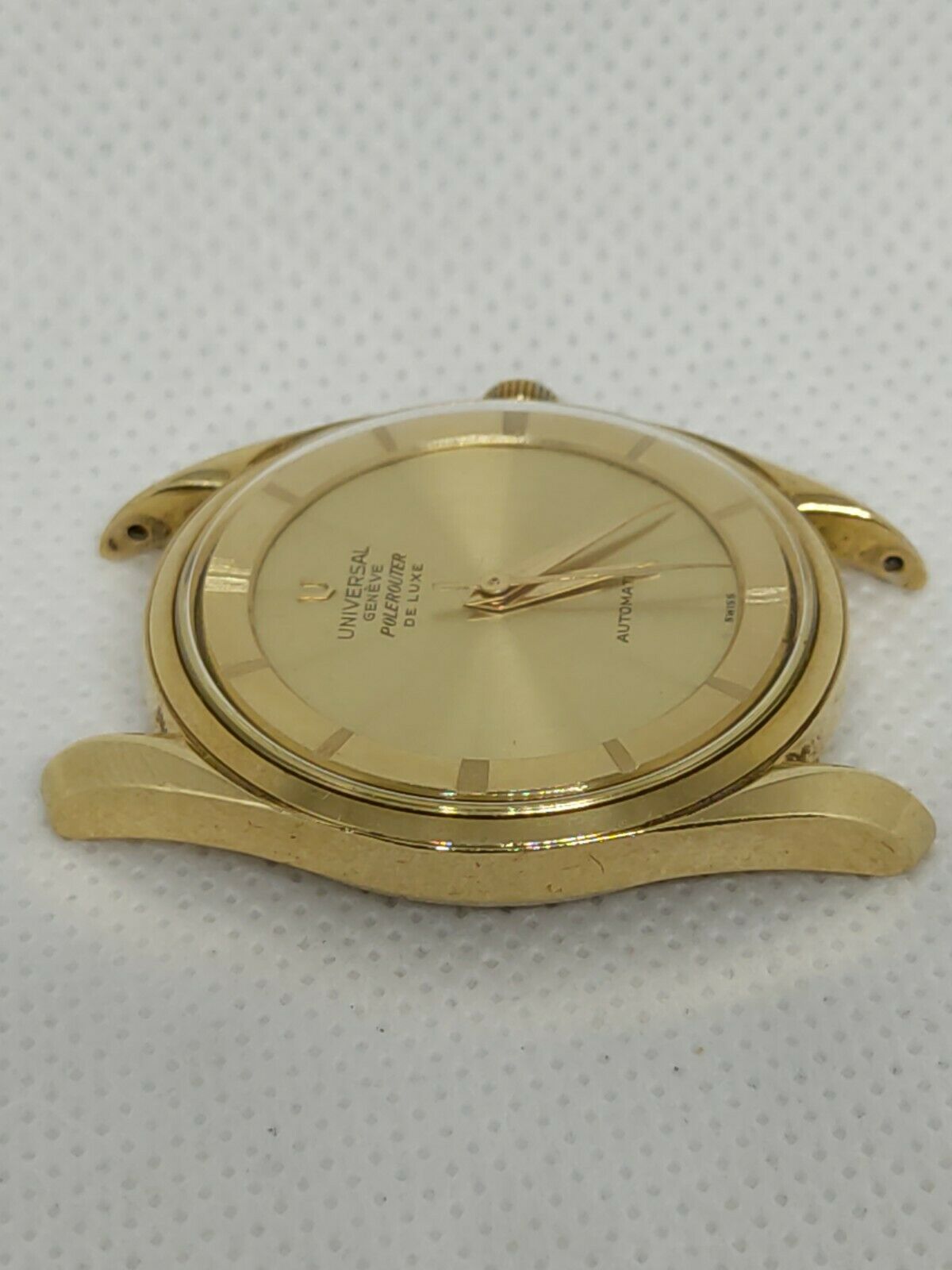

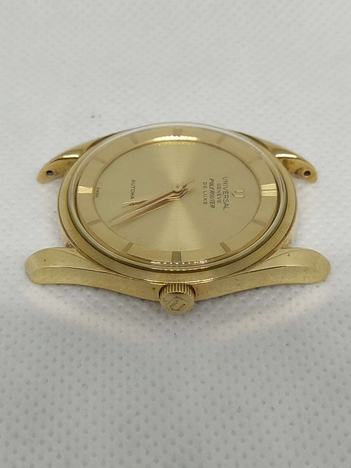

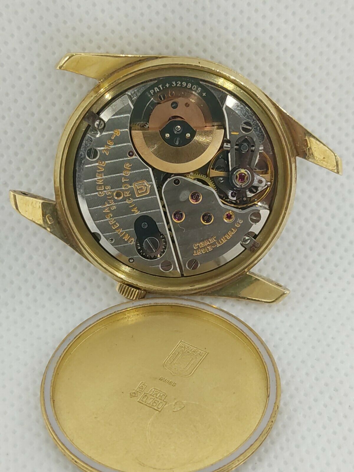

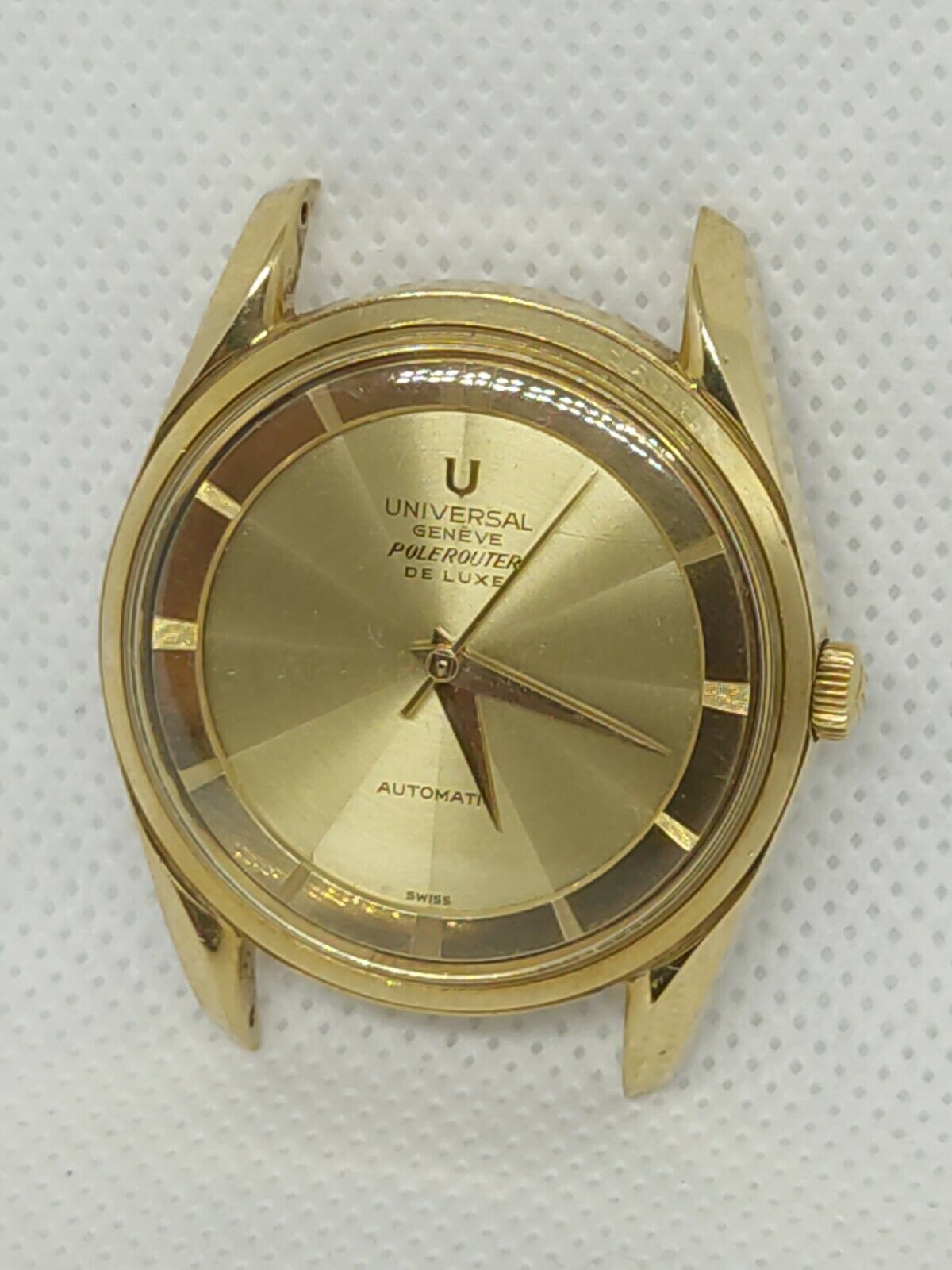

Hello,
I found this on E-bay and being a novis on the Gold De Luxe Polerouters, I would appreciate any input.

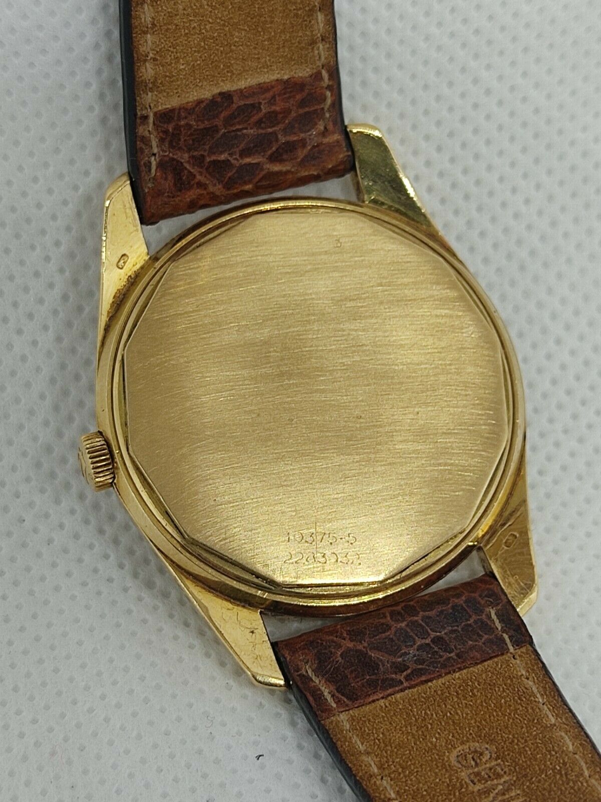

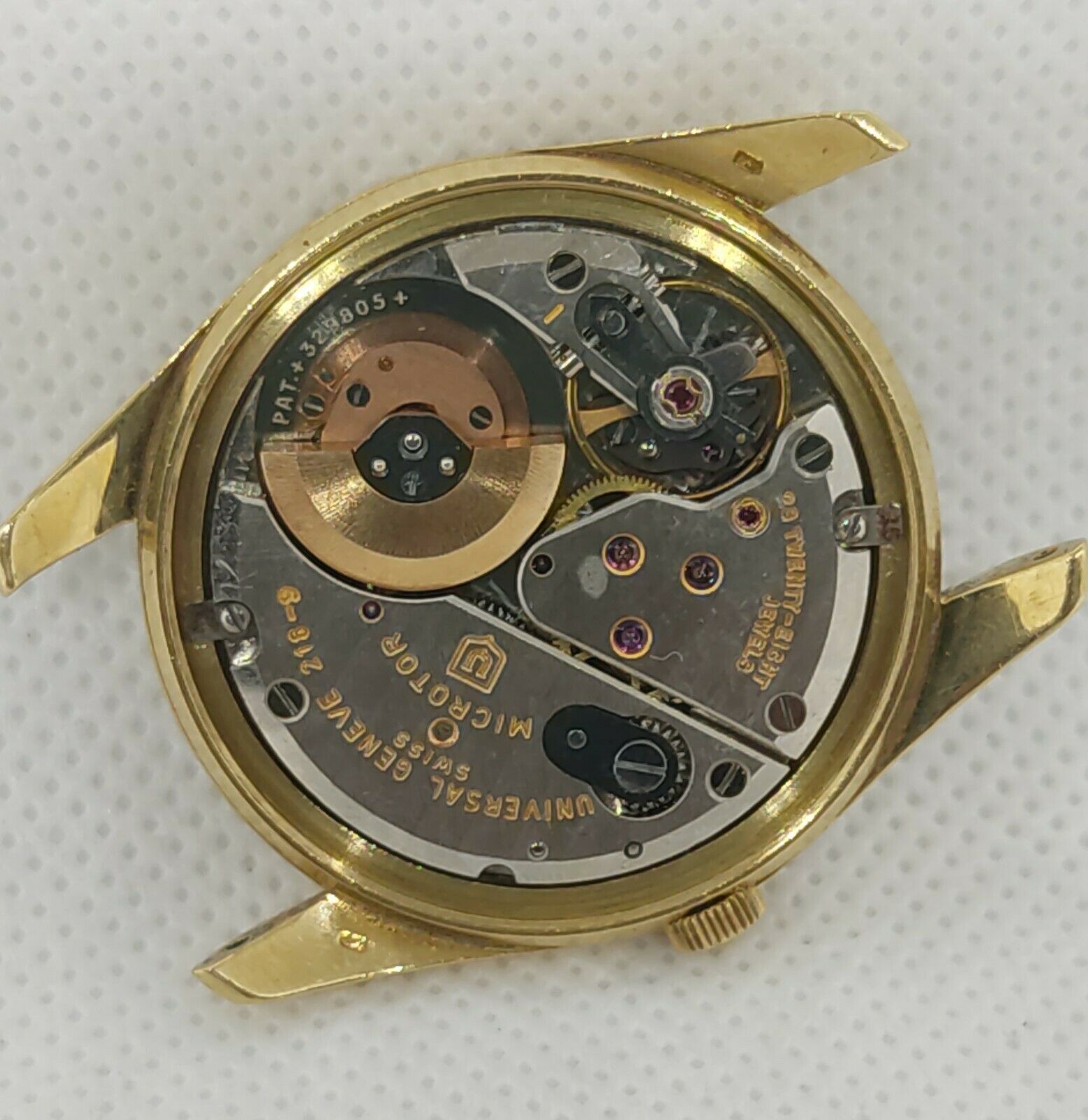

Personally I find the back case looking strange with the sanding marks..... other then that it looks nice
Link; https://www.ebay.com/itm/392987915319
Pic below

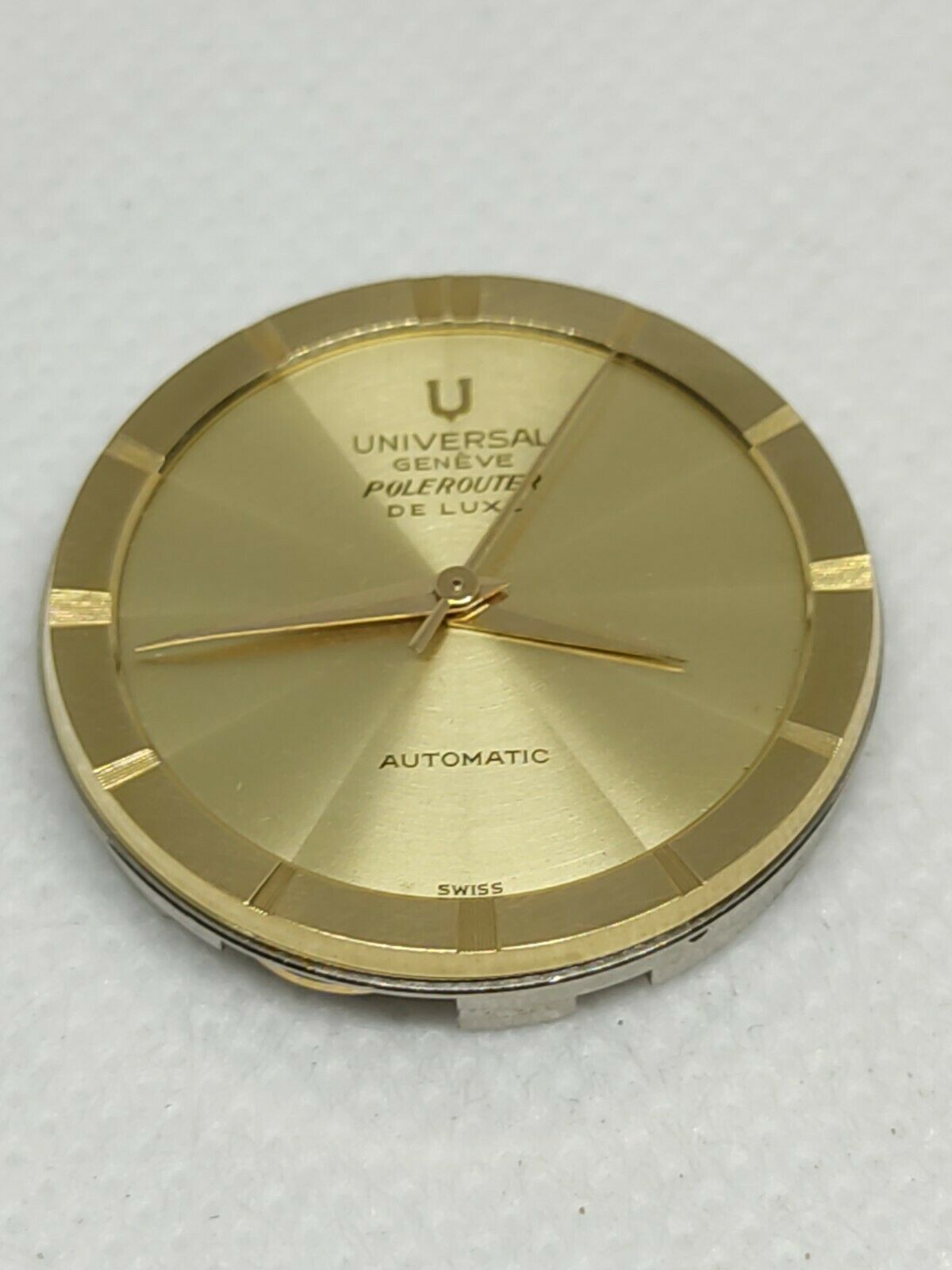

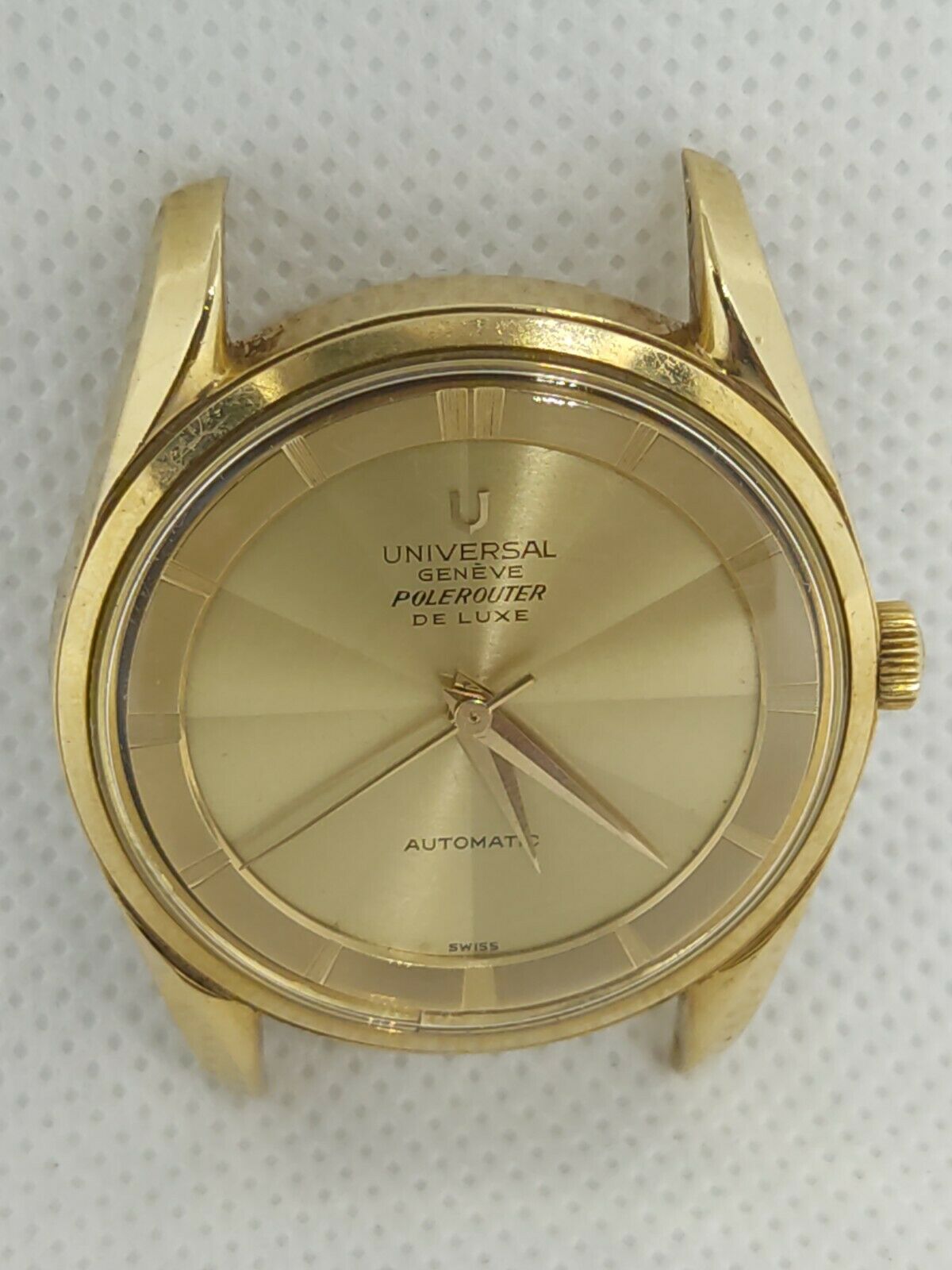

I definitely have a very limited knowledge of these, but the inconsistency in the 'E's and 'O's in the word Polerouter would have me combing dial photos for comparison.
1,211
3,071
Agreed. The De Luxe text is also concerning.
