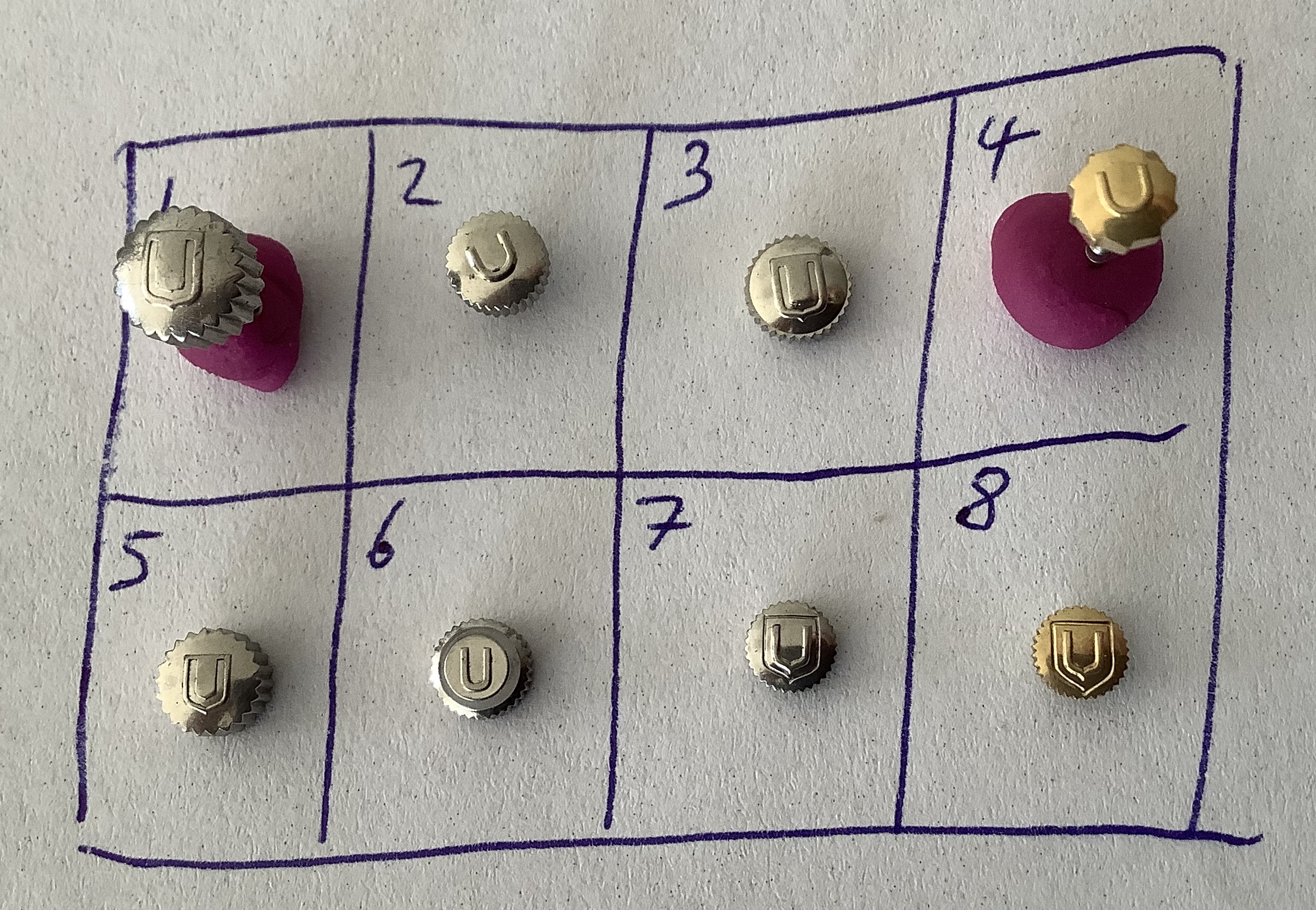

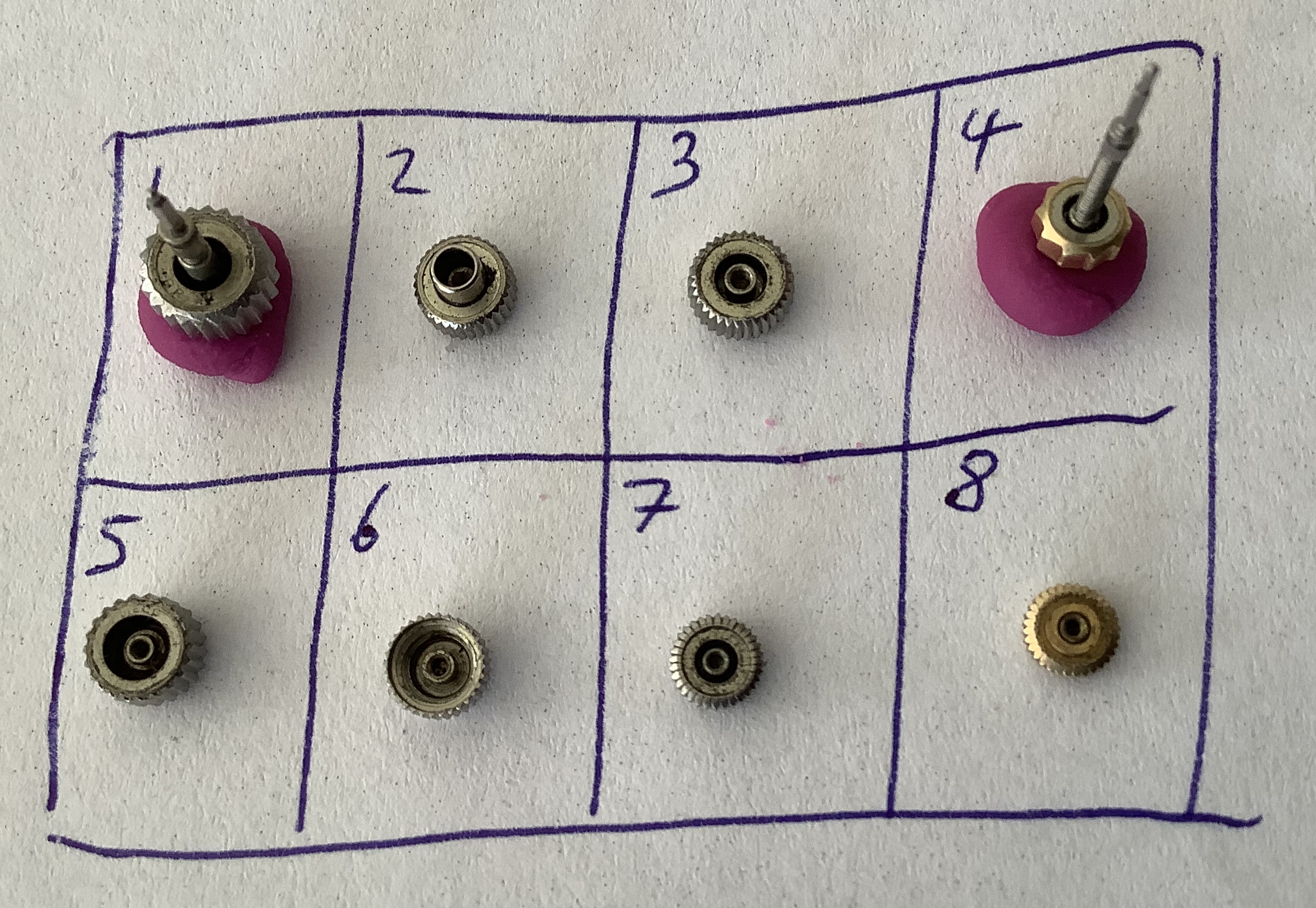

I believe 4 is a saw-tooth style unisonic crown, and 6 is from a polerouter, but the others not sure.Dimensions are written as diameter - depth.
1) 6.13mm - 3.82mm
2) 4.99mm - 2.60mm
3) 5.33mm - 2.73mm
4) 4.37mm - 2.29mm
5) 5.17mm - 3.37mm
6) 4.91mm - 3.06mm
7) 4.48mm - 2.26mm
8) 4.49mm - 2.21mm
1,783
4,126
You're right on 4 and 6 could potentially be for a Polerouter Super. I have seen several Unisonics with number 2 crowns.
2,597
5,656
Any ideas on no. 1 guys ?
The tube size appears to be 2.20mm..

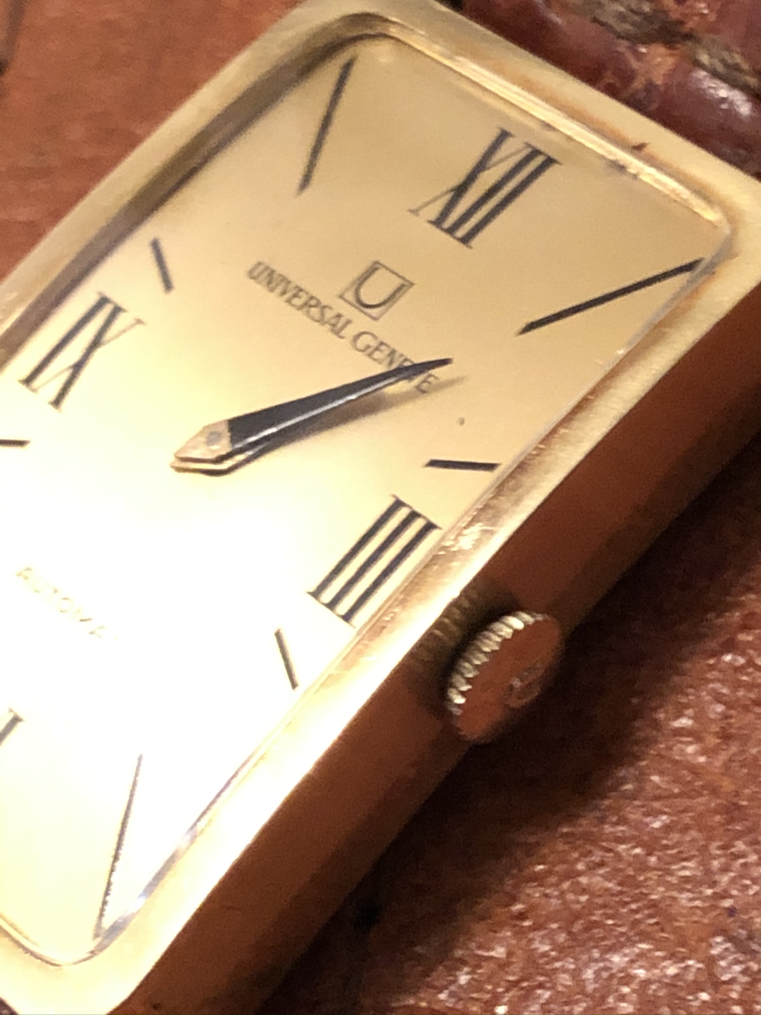

Can someone help me with which size crown I am looking for? I recently got a cushion case model 869126 but it has a replacement crown.
My incorrect crown
Example with proper crown

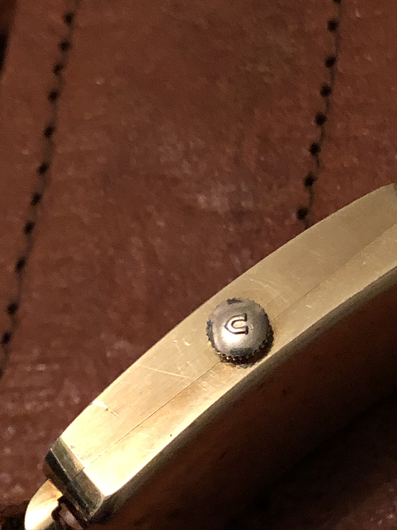

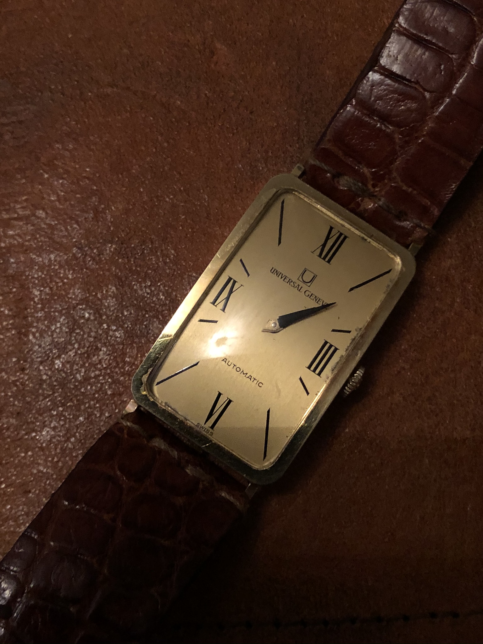

I have a 60s UG and am sending a pic of the crown. In case it helps.]
