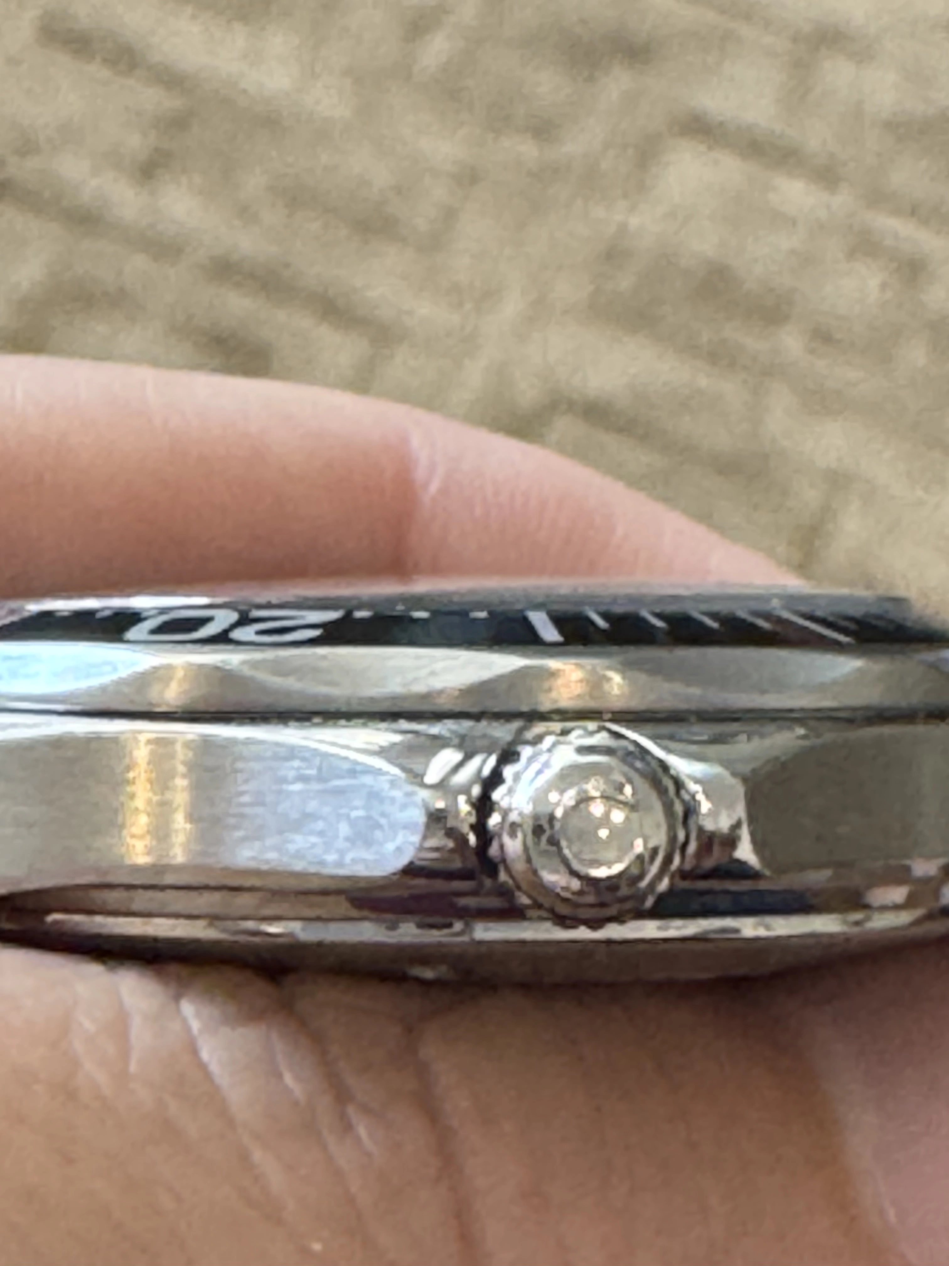

Question from a newbie to Omega and luxury watches in general. Just got a Peter Blake 2254.50. It is a 2007 piece that came with box and all papers. I just love the look of. Got it from a reputable dealer who acquired it from Japan. Only had it for couple days but am really enjoying it.
Only issue is, that I notice when I run my finger around the bezel I can feel that the crystal is maybe .5 to 1 mm or so above the bezel at 12 whereas it’s flush at 6. The dealer says he didn’t replace the crystal that he believes is the original.
So the question is should I be concerned? The dealer is willing to take it back and have his watchmaker inspect and fix if needed but I don’t know if it’s worth the trouble.

Usually an uneven gap between crystal and bezel on one of these is down to either a badly located or bent bezel, but the picture here does indeed make it look like the crystal isn't set flush. If the latter is the case, it would be a concern as there is no way it will be water resistant if not sitting flush against its gasket. A no longer flat or incorrectly located bezel is a more likely cause IMO. It is quite easy to bend the bezel assembly if you try to remove it incorrectly from one side only.

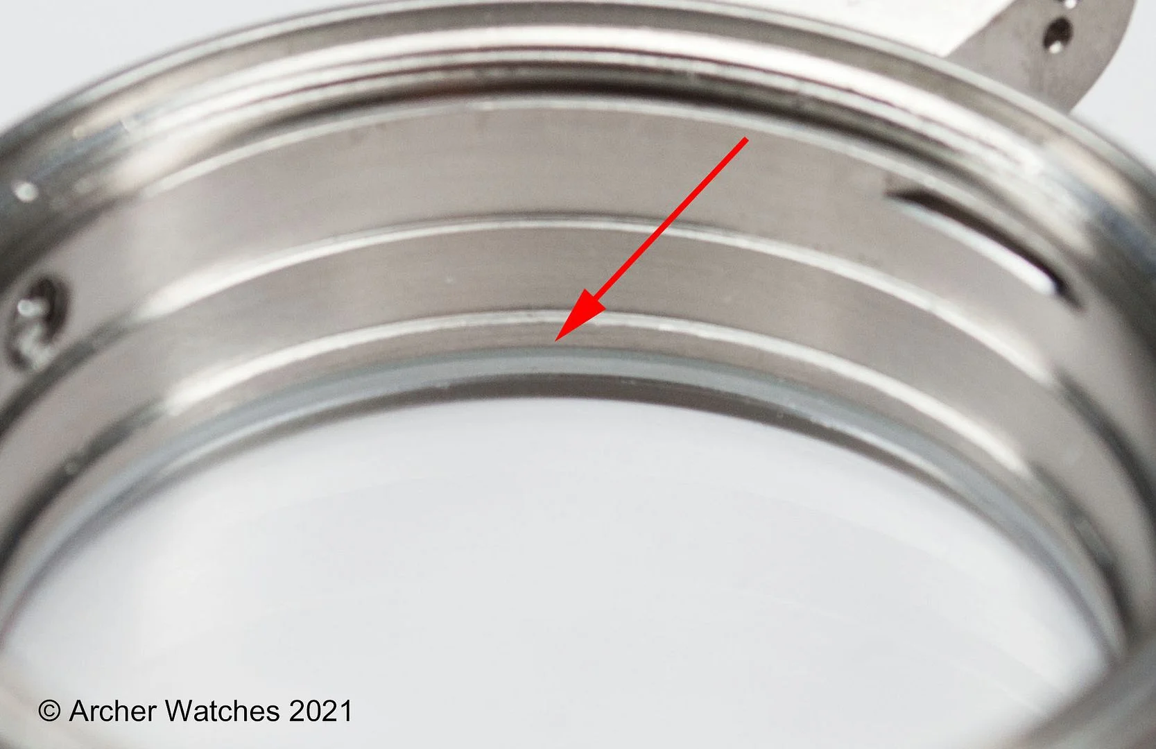

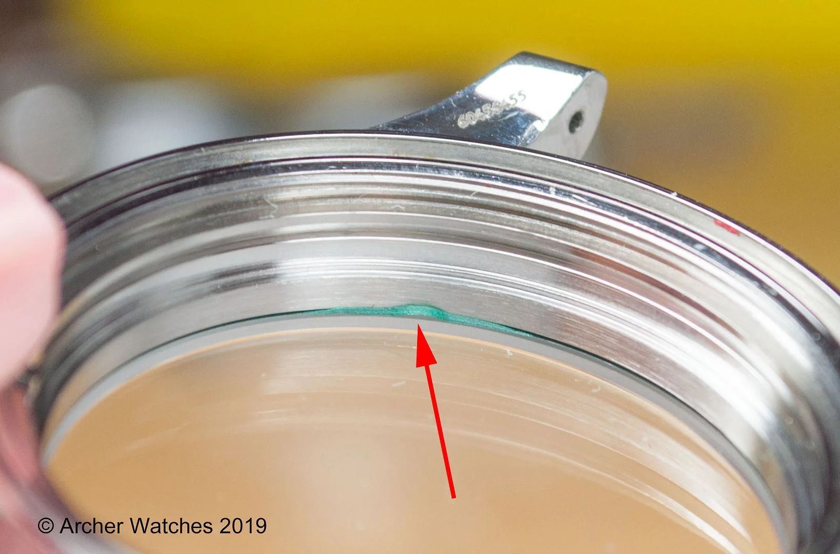

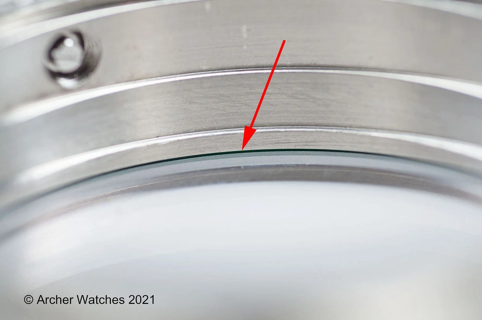

The crystal was not installed correctly, either during the last service or one that was done in the past. The crystal seal is a hard plastic seal and it has been crushed on one side, and part of it is under the crystal, leaving that side high.
If you were to remove the movement and look at the crystal inside the case, you would see a gap between the case and crystal, like is shown here:
This is from a watch I received with the exact same issue. After removing the crystal and installing it again with a brand new crystal seal, it looks like this:
That was a fairly mild instance of this problem. Since your crystal is sticking up so far, it probably looks more like this:
Note that a new seal must be used, as these are one time use only seals. They will never grip as well once they are used, even if they are not crushed/damaged.
