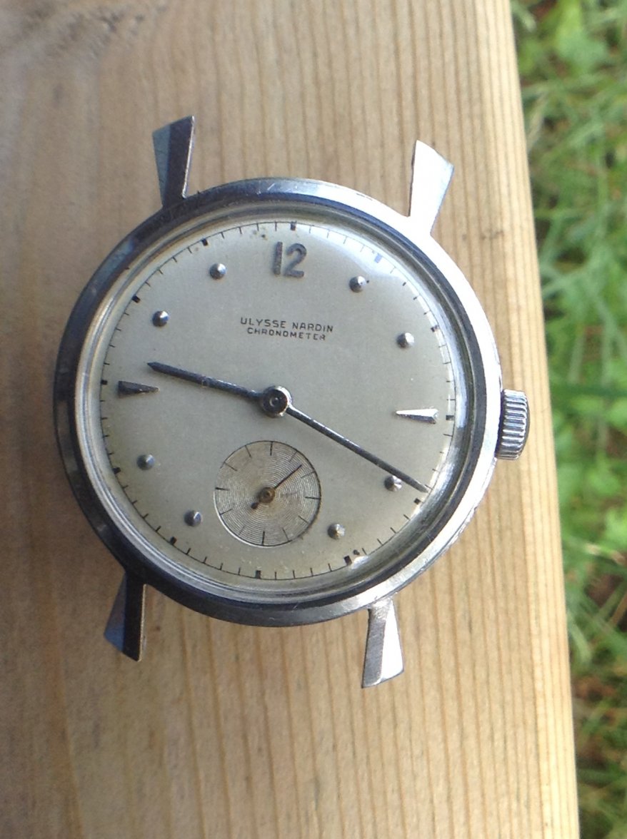

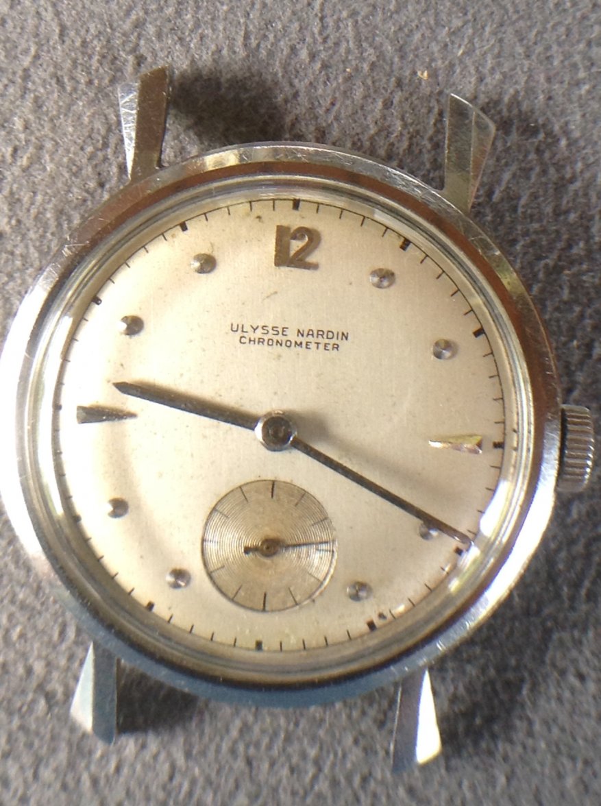

    bild 3 (4).JPG bild 3 (5).JPG Hi bought this watch on auction a month ago, i thought i bought a watch from the early 40s because of design and the size of the watch.

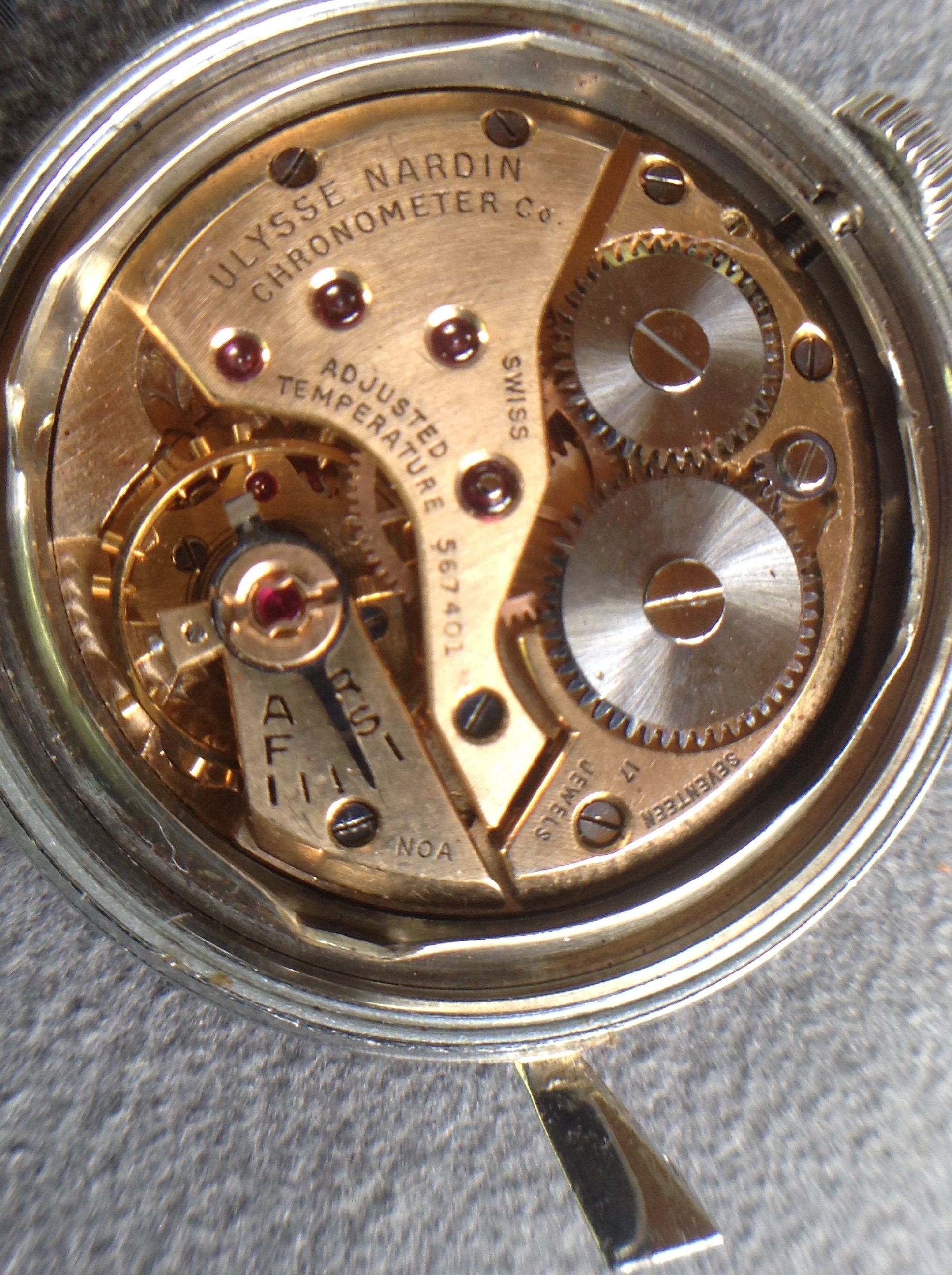

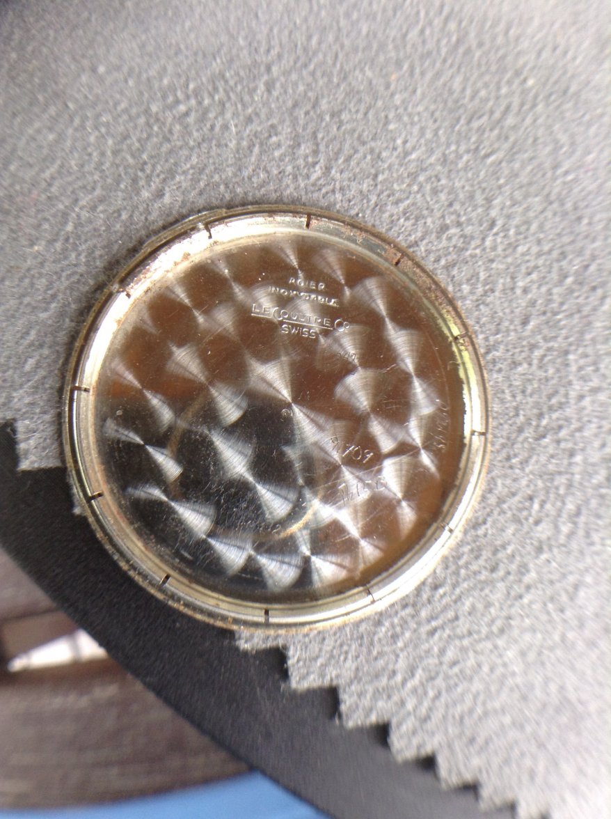

    Arriving one week later i find out that the case is signed Le Coultre Co and the movement signed Ulysses Nardin Chronometer Co.
    As i understand the movment marked NOA was shipped from Swiss whitout the case for assembeling in USA, Le Coultre was doing it in the same way because of taxes.
    Does anyone know if these Companys coorperated or is it a creative watchmaker in the early 50s.
    Gratefull for any info.

    Very odd. I'm not aware of any such partnership, but I'm not a U.N. expert, either.
    Color me skeptical, as, among other reasons, the movement and case don't exactly appear to be a match made in heaven...

    The ring around the movment that looks od is a part of the locking system for the case.(Sorry English not to god)
    The ring is suposed to put some pressure on the backcase.

    I'd say more like a creative watchmaker in the 2000's. To my knowledge, there was no cooperation between Ulysse Nardin and Jaeger-LeCoultre. Steel cases like those were used for both US LeCoultres and JLC's in the rest of the world.
    Movement is a Ulysse Nardin product, but in those days, UN did not make their own movements. They purchased existing models from established Swiss movement makers and did their own branding.
    Not too much different than the Omega Moonwatch.

    Also, the U.S. import code for Lecoultre was VXN. NOA was only for Ulysse Nardin. No evidence for them mixing (to my knowledge).

    braclet from the early 60s.The only thing i did was to put a new glas on there is some corosion on the spring ring at the
    backcase and the movment really needs a cleanup. looking on the total amount of corosion on the case and hands it seems to fit.
    Did they stamp the cases whit importcod to or only the movments?
    Regarding the movement i cant find this base caliber from Felca or Peseux but the serialnr from UN dates it 1951-52.
    Do anybody recognise this basemovment?

    The import codes were only used on movements intended to be exported from Switzerland to the USA. Although, I suppose it is possible that the same movements could have been sent to other countries that taxed gold watch cases.
    This "national production" system was only used with gold filled and 14K gold cases, at least here in the USA.
    Since your watch is steel, don't know what happened there.

    Look at the movement carefully - there might be a mark/logo/number somewhere...
    I don't think they made their own movements then, so perhaps it is an ETA base?

    Found out that the base movement is a Aurore-Villeret 423 (thanks Lenny)
