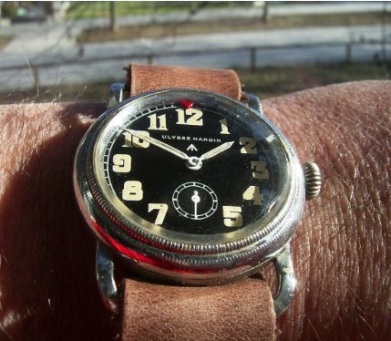

Hello! This is very similar to my last post regarding what the forum quickly declared a bogus Rolex '1928 pattern' flieger watch!
I found this and was thinking the dial looked really crisp when compared to other watches of this era and type The movement says Ulysse Nardin on it. I can't find any other examples of this brand of pilot watch.

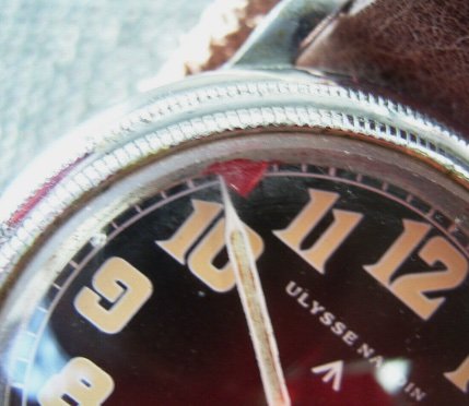

Now, after Zenith designed theirs in 1909 for Louis Bleriot to fly the english channel , I’m aware that multiple manufacturers (Omega, Natalis, Emte, Helvetia, Lanco, Rellum to name a few) made watches in this style - 40mm(ish) similar cases, black dial, clear numbers - however, I have never seen an example of a Ulysse Nardin version. My gut tells me the below is bogus in some way, perhaps a franken version, but I’m really not sure… the dial looks suspicious to me - particularly given the time when these watches were around. Perhaps I’m just being skeptical having never seen another example of this kind.

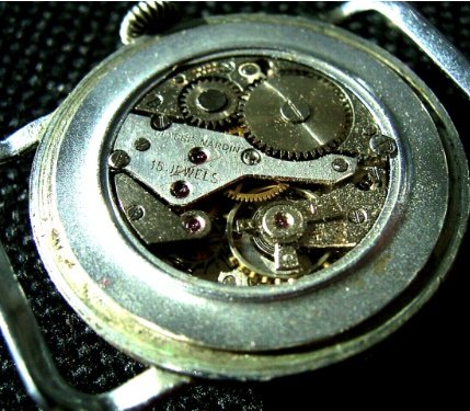

From seller: "Pilot's watch by Ulysee Nardin from the late 30s. The hand-wound caliber 984 by Adolph Schild was built from the end of 1938. the clock was so around 1940 made. these watches were worn over the aviator suit, the red arrow index was set to the minute, as in photo 4. This made it easy to read the time flown and the fuel supply for the return flight was accurate can be measured. In reconnaissance flights, this is an essential factor"
The Asking is EUR 2.750,00
What do you reckon?

Hi Harry,
I don't have the KK book to hand but I'd be skeptical why the watch is attributed with a Pheon.
Also that the movement image has different type shine on its bridges. I'd expect it to be uniform.
I'm a hard Pass.

.............. Pay attention to the Arrow of the Kings.
I've seen the broad arrow/pheon with long sides, but for a British 1940s military watch I would expect to see a contemporary arrow.
Maybe the frankenator didn't do enough research.

Hi Harry,
I'm a hard Pass.
Yes I never thought about the non-uniform sections that ought to be. Good spot.
