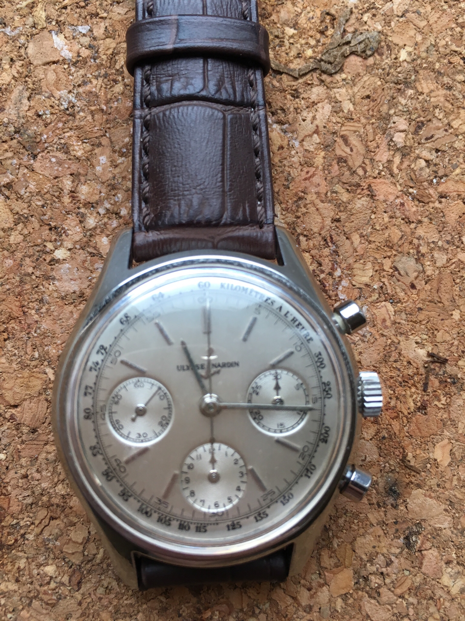

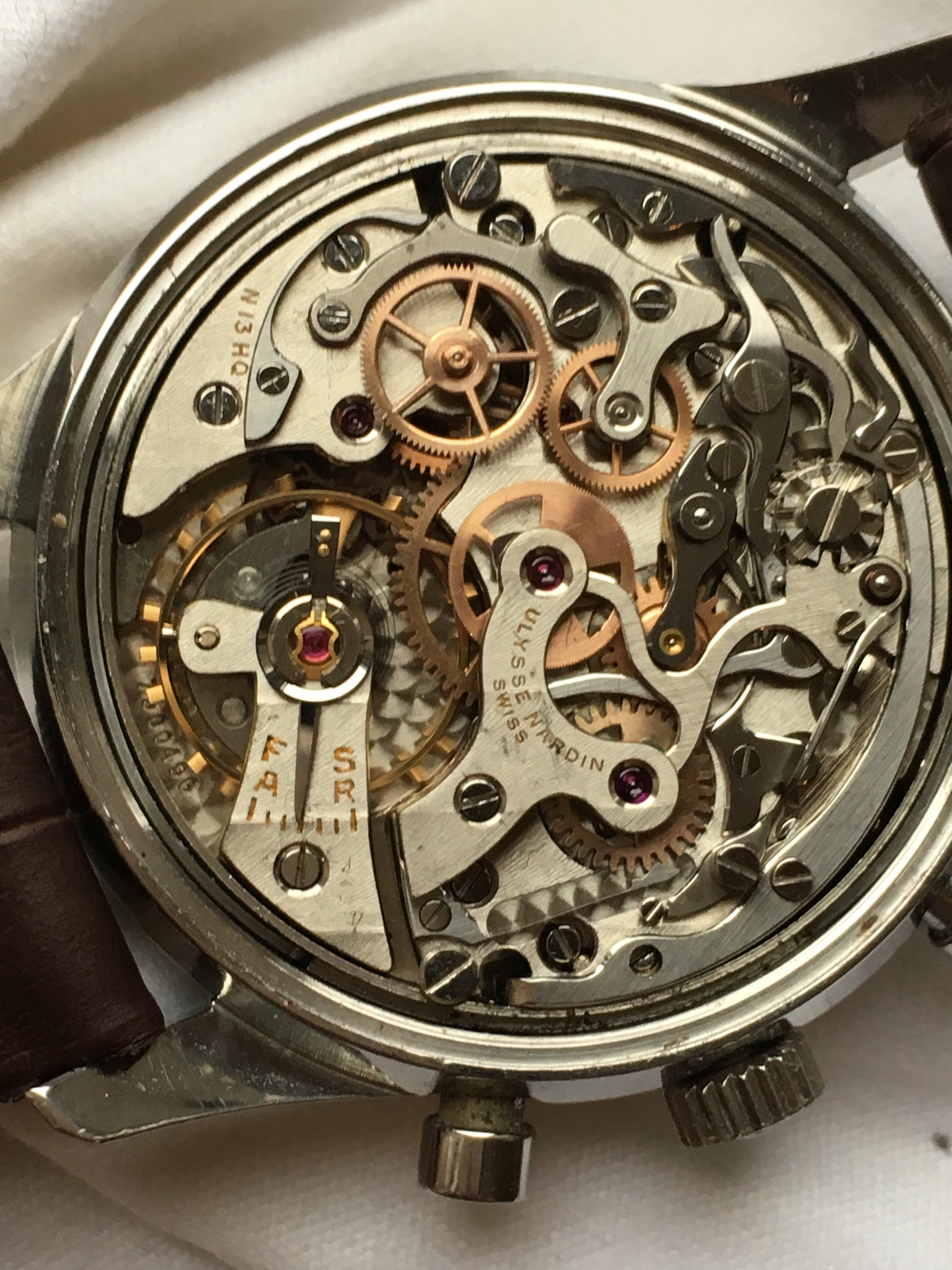

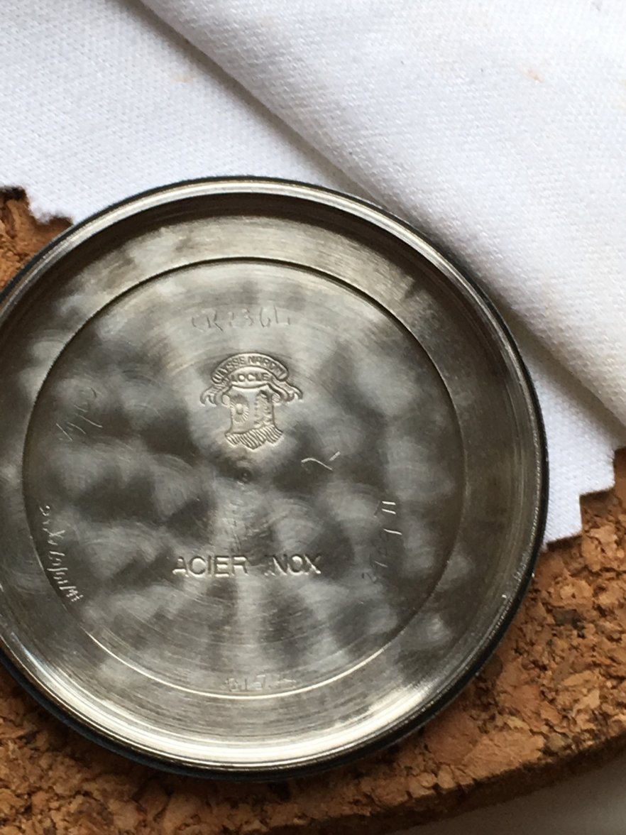

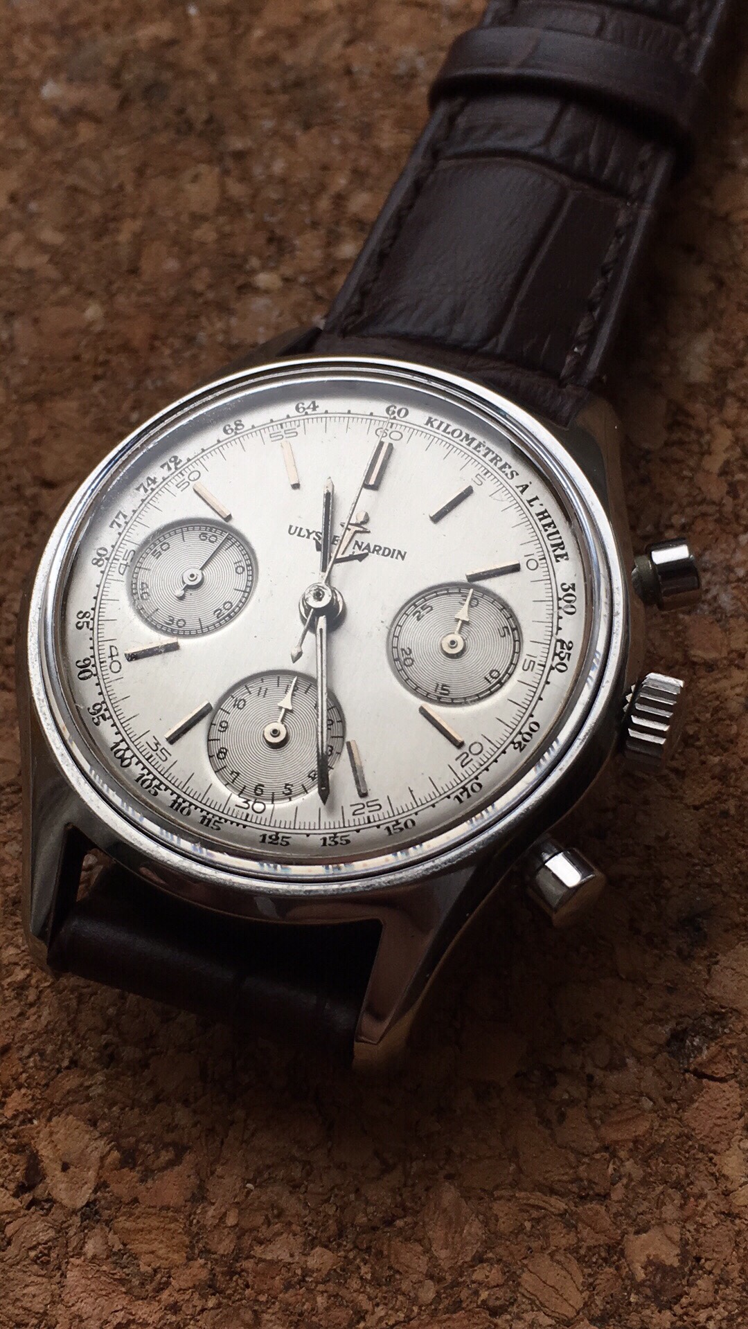

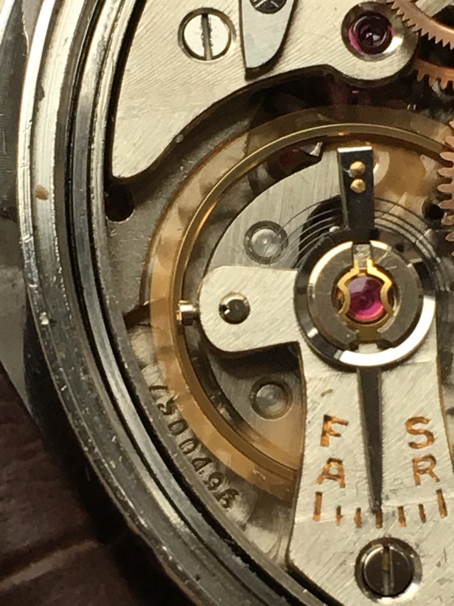

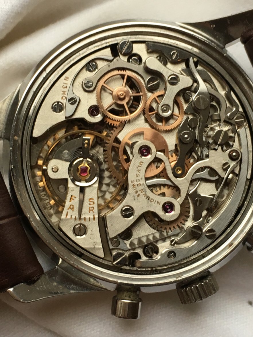

    So I took the plunge and got this baby.
    I'm being told by some sources that this is the real deal however some other sources are disputing this... is a Franken
    Some expert input needed...

  2. Syrte MWR Tech Support Dept Jan 31, 2017
    7,383
    20,738

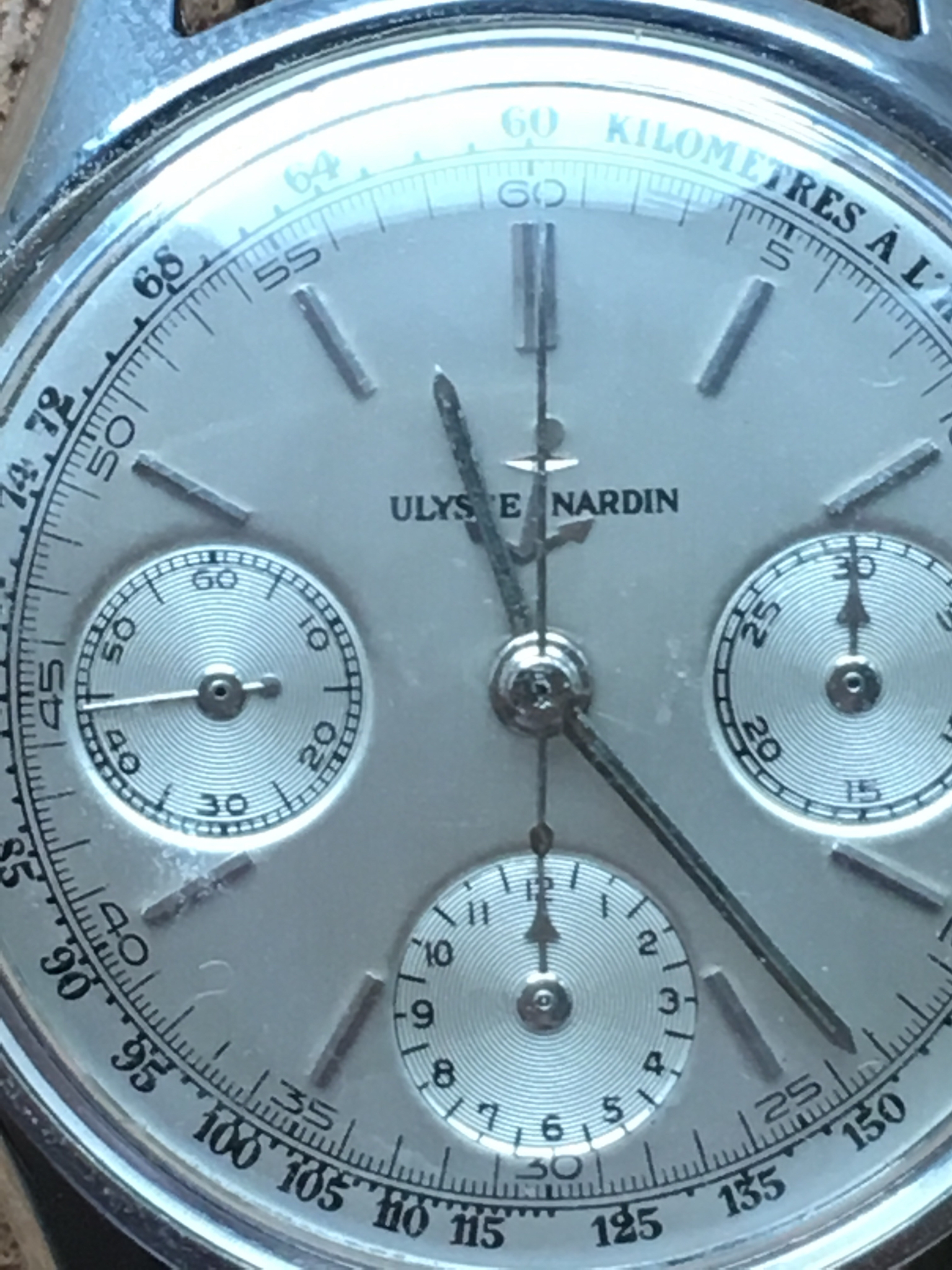

    More importantly its dial has been refinished. As evidenced clearly by blunt edges on the subdials, lower subdial edge overrunning the number "30", blotchy numerals on the tachy track, thick and uneven script on the "Ulysse Nardin" signature.
    Hope it was cheap or can be returned, or that you like it a lot and will enjoy it as is.
    Most collectors shun refinished dials so reselling it may be difficult if you were to tire of it-- value is reduced to parts.

  3. ConElPueblo Jan 31, 2017
    9,587
    26,961
    I'm curious - what attracted you to this particular specimen?
    I have no knowledge of UN, but can easily tell that the case is heavily polished and the dial a horrible redial.

  5. Syrte MWR Tech Support Dept Feb 1, 2017
    7,383
    20,738
    The fact you like it is what's most important but that person gave you bad advice. Everyone here would have advised to take your time to learn until you find better, ie a chronograph you like with an original dial.
    Your best course of action remains to try and return it for a refund. If the seller cares about their reputation and did not disclose the fact the dial is refinished they should take it back for failing to disclose a critical piece of info about the item.

  13. FullyWound Hasn't discovered decaf yet. Feb 1, 2017
    972
    949
    Nice movement 22 but that dial is a real mess its visibly ugly... If you want we could do a better dial than that...

  15. hermes4 Feb 16, 2017
    44
    7
    Thanks guys... I finally got the watch returned! And got my money back sans the shipping fee...
    However I would like to name and shame someone who "persuaded" and coaxed me into buying this watch...
    I relied on his expertise and professionalism and he led me into this mess...
    He owns various watch forums on Facebook and I thought he was an "expert" till a group of people on another forum helped me verify the authenticity of the watch...
