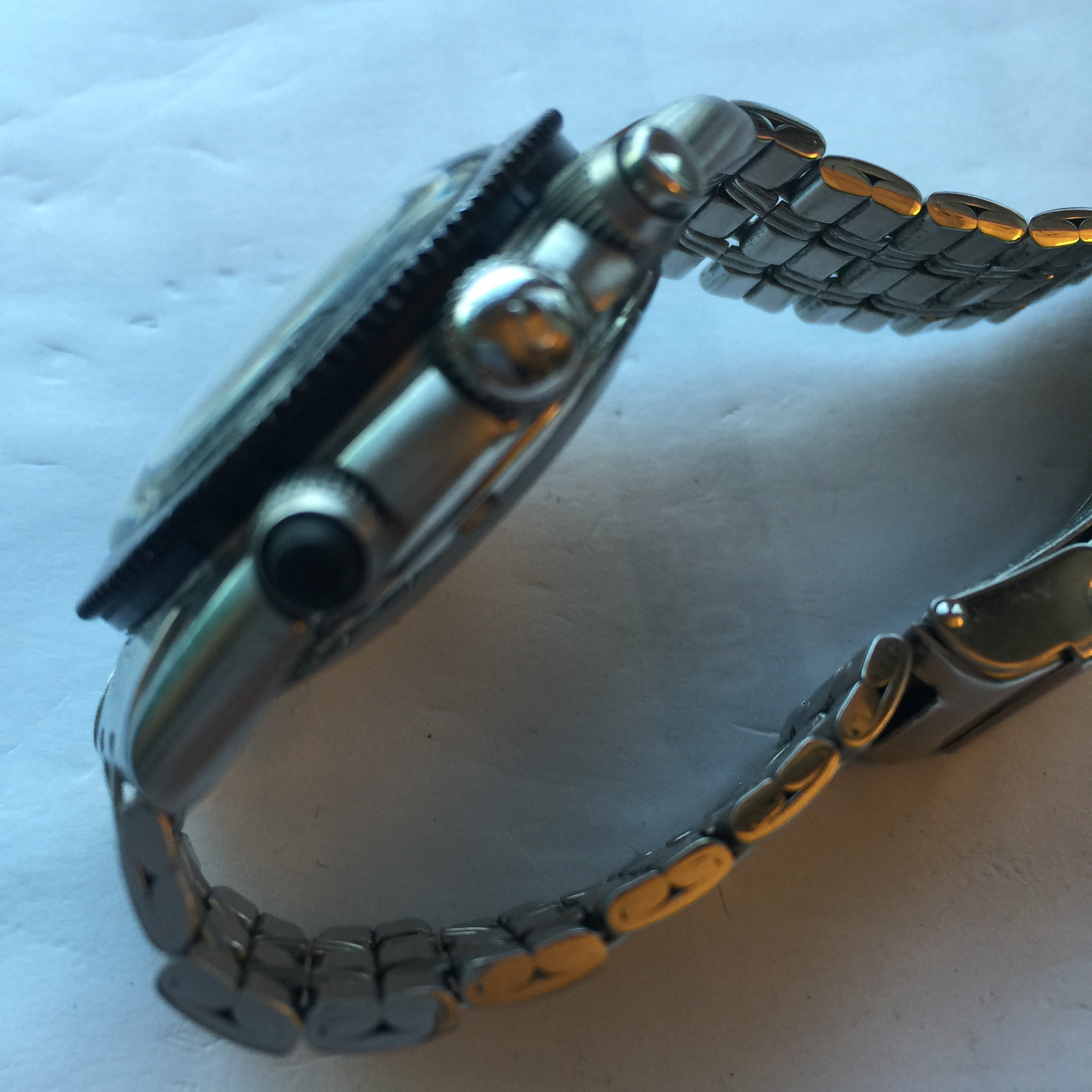

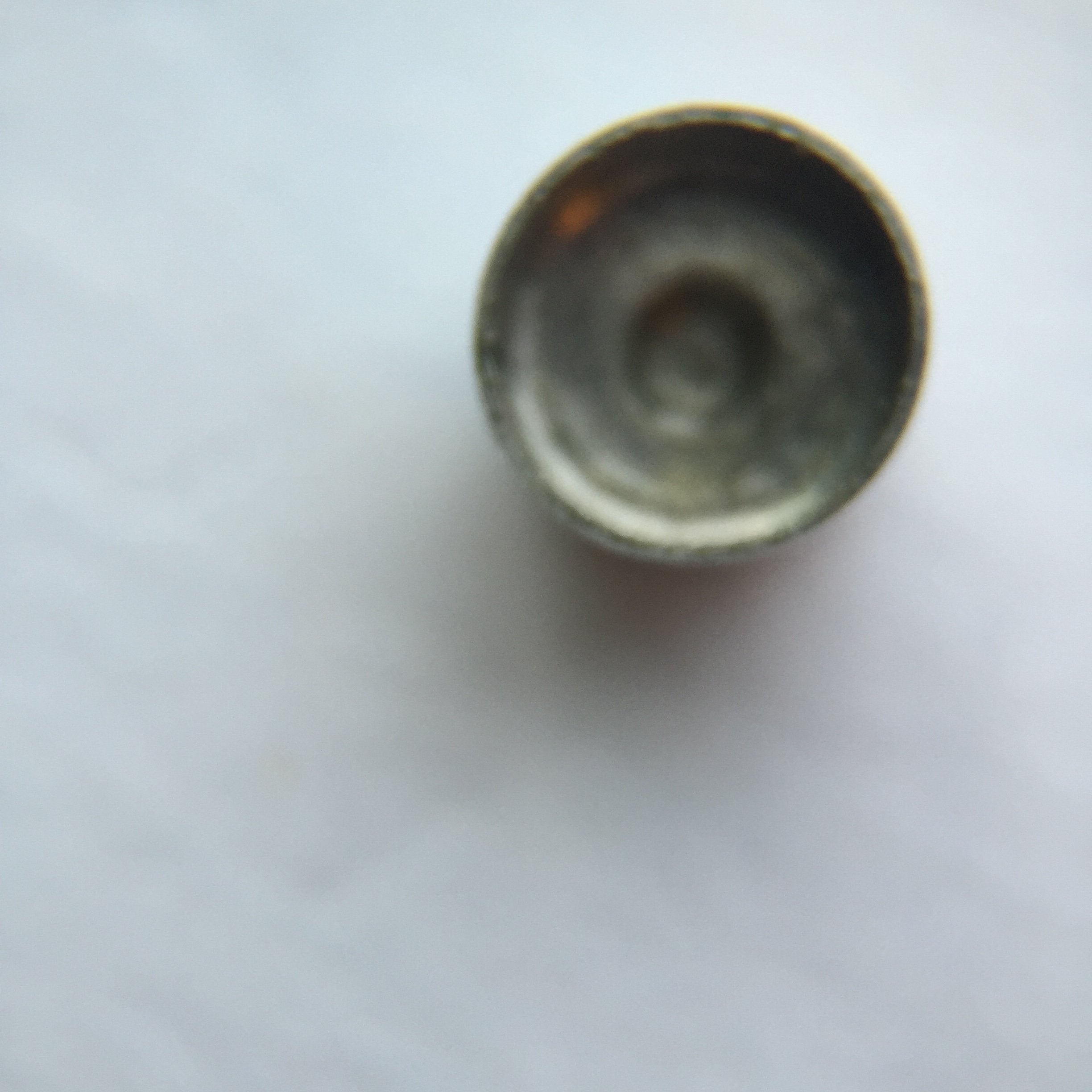

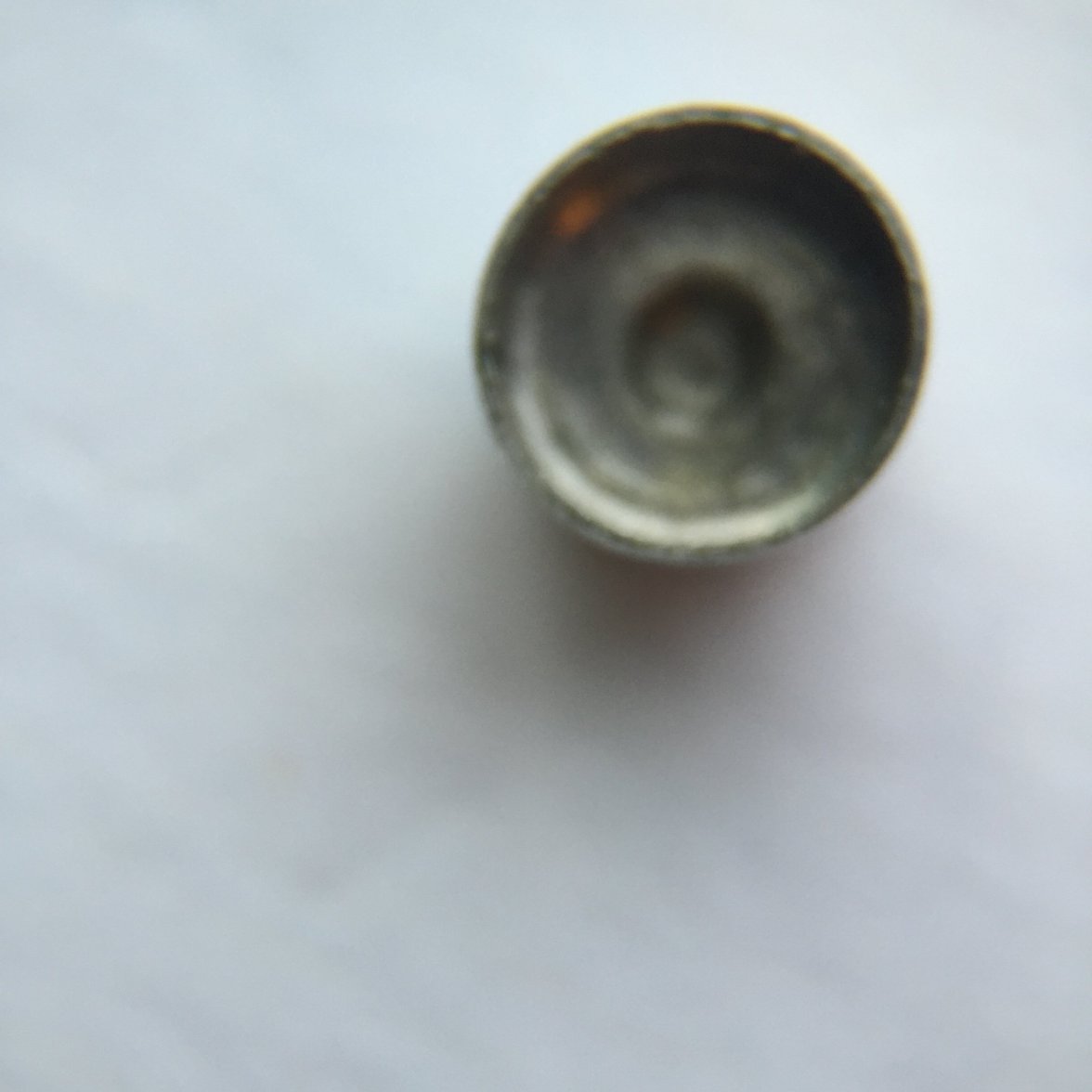

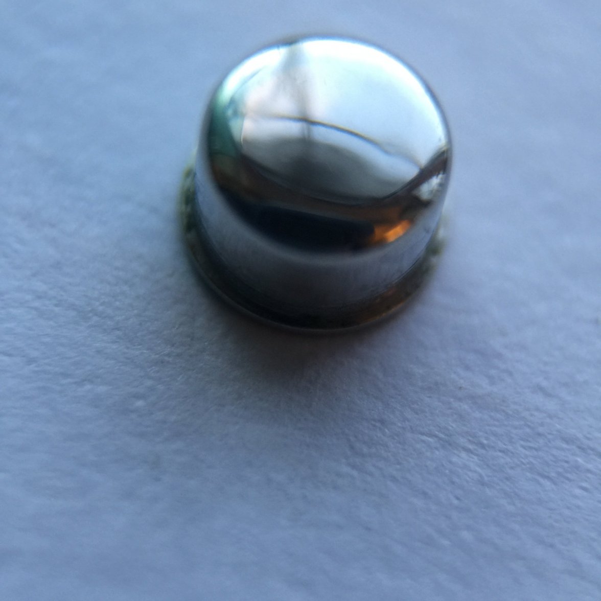

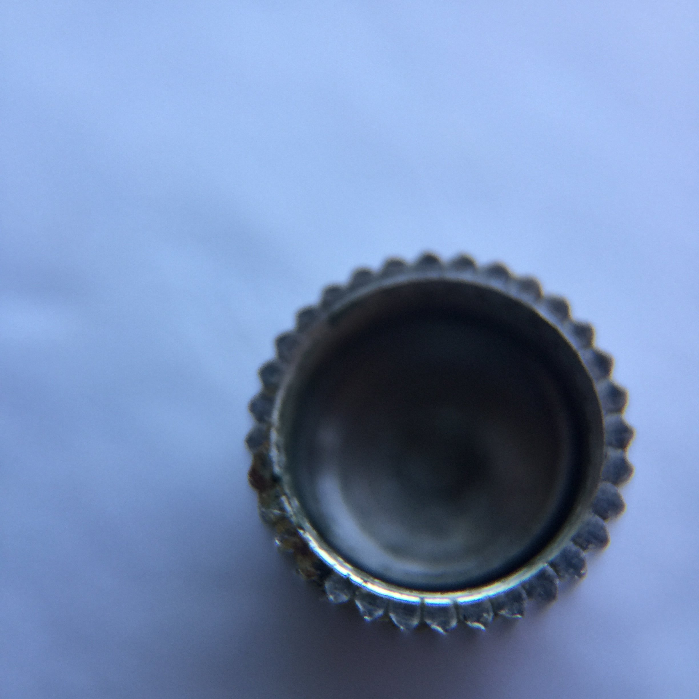

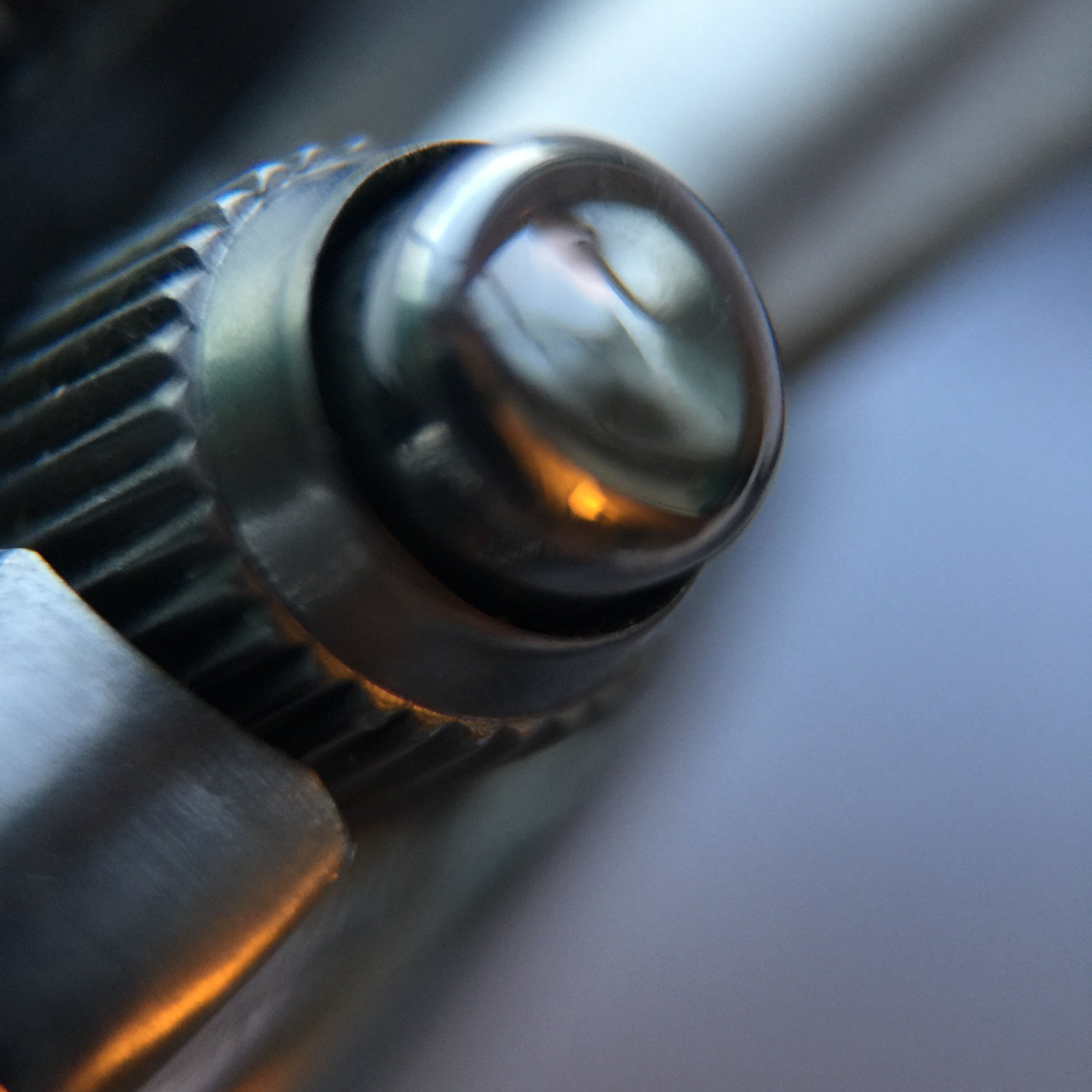

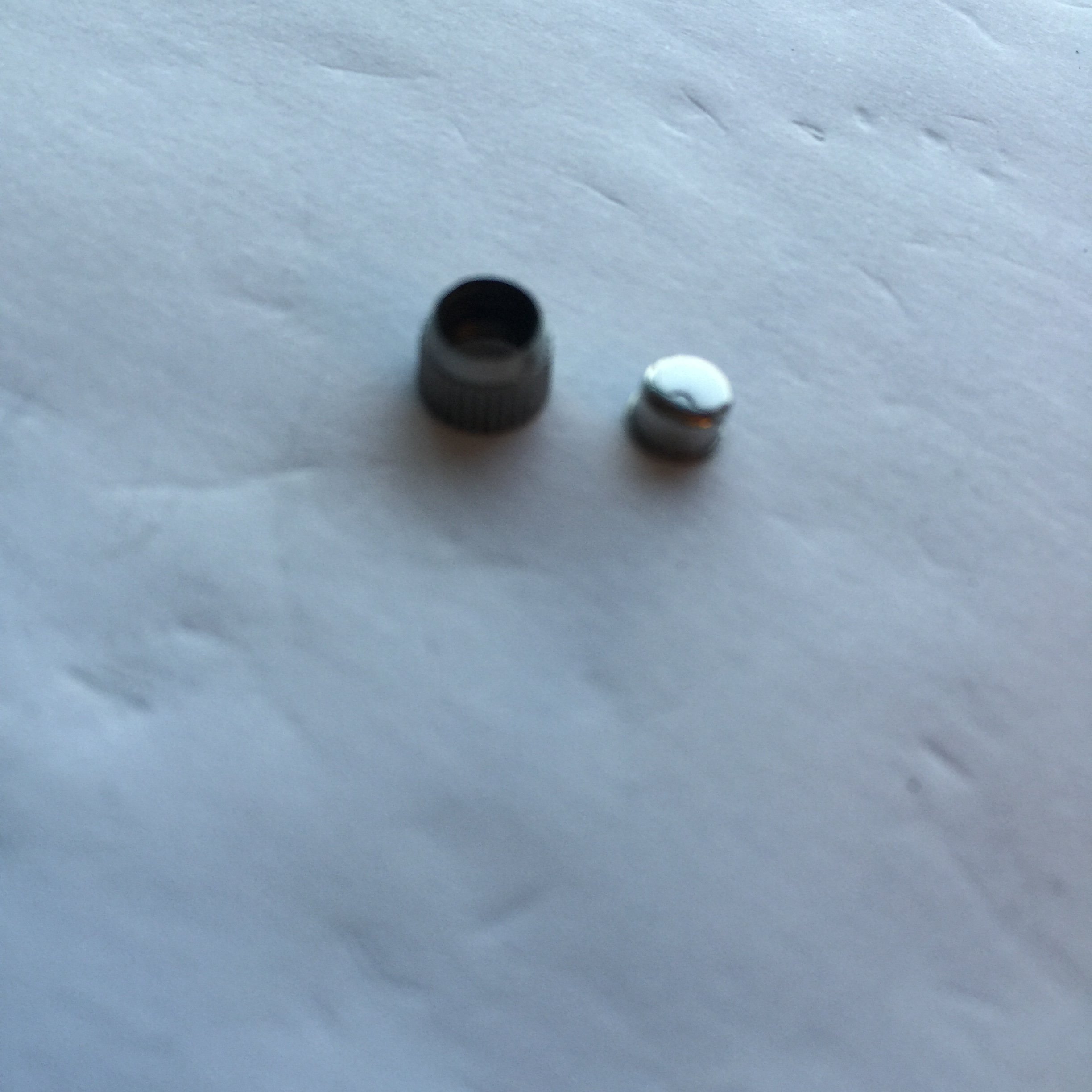

    Off topic. As you mentioned you're designing a new pusher part; here's something I received with my watch when I sourced it from Japan
    The previous owner used these plastic replacement pushers as the original rubber covers had perished over time in storage. They work perfectly but of course look rather odd
    The Hong Kong eBay supplier for replacement rubber pusher covers has stopped supplying the black rubber version, so there's a pressing need for an alternative.
    I could lend you one if you need it for measurements

  6. Diabolik Oct 6, 2016
    1,372
    2,659
    I am surprised they work as the original rubber glove, made a seal with the serated screw in pusher cover. That seal made the pusher waterproof and was tight, too tight for there to be any movement. If you replace the rubber glove with a solid pusher as i did and you have done, movement is minimal so pusher becomes quite temporemental.
    That is why when using a rubber glove, you must have washer on top of the pusher. The diameter of the washer slightly smaller than the internal diameter of pusher and allows full travel of pusher.
    The solution is a two part pusher to replace the rubber glove ... An external shell that locks it in place and an internal moving part that drives the pusher.
