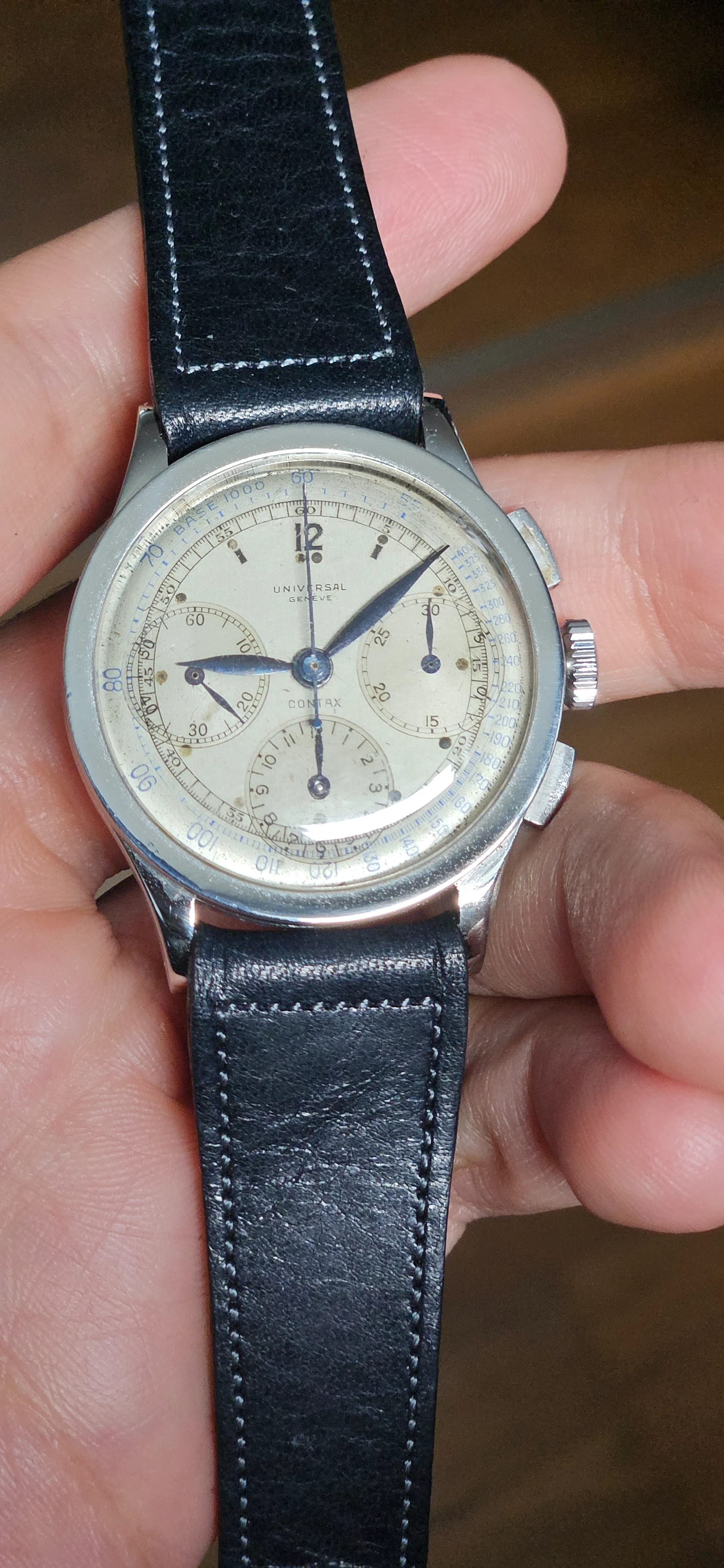

Hello dear OF experts,
What do you think, can a Contax watch possibly have a 587XXX serial?
All I have ever seen have serial numbers 607XXX or greater.

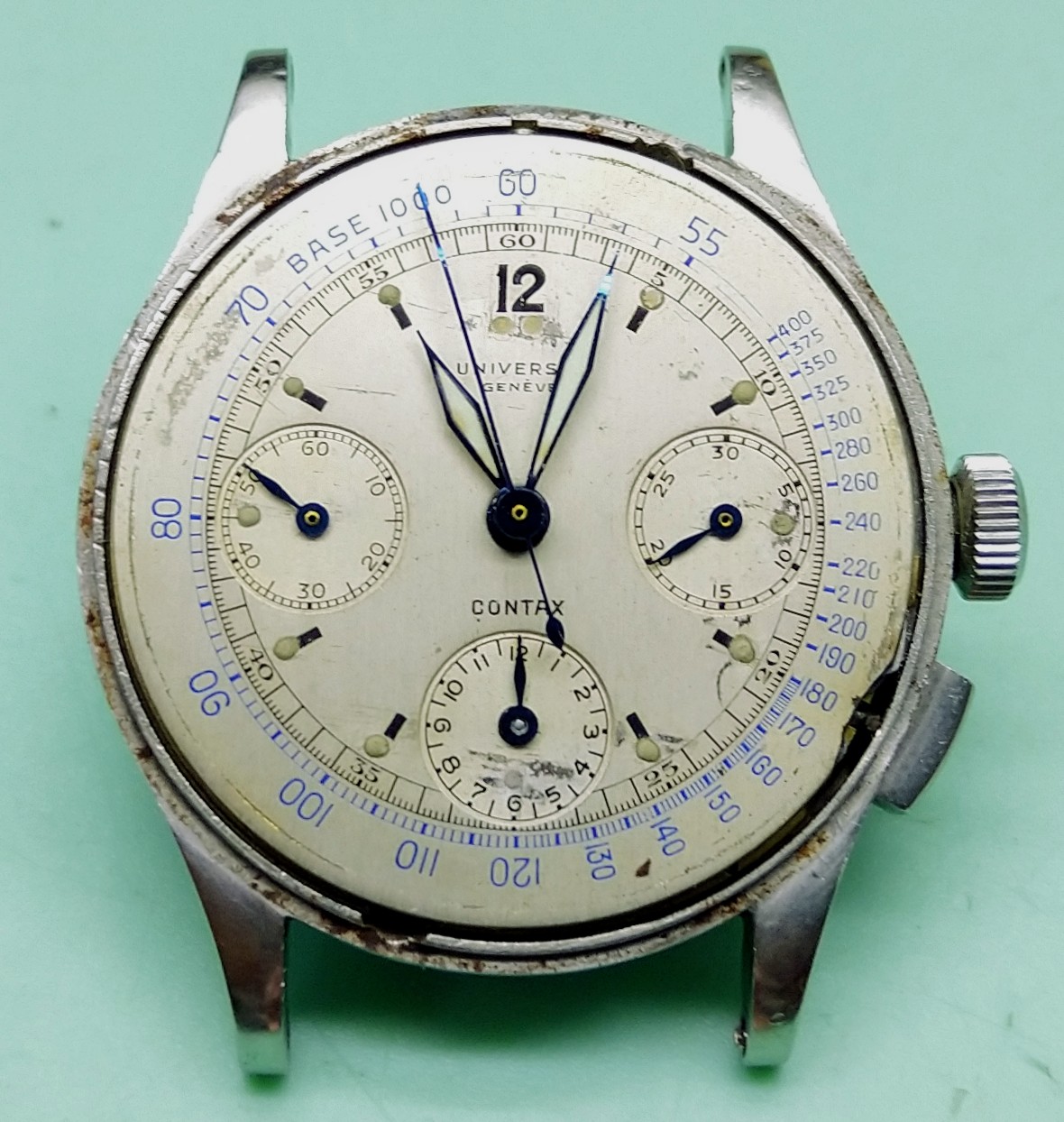

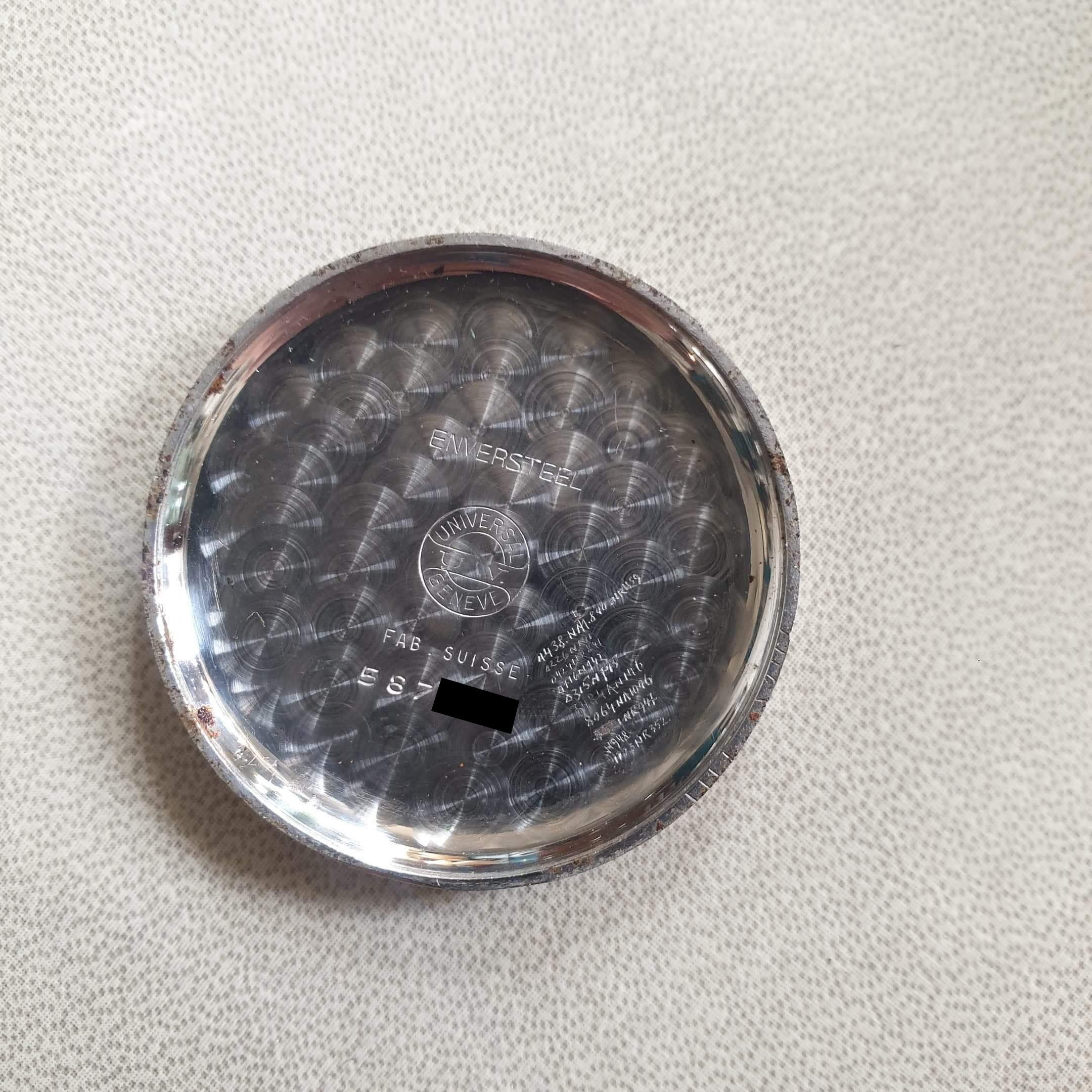

But to satisfy your need for a picture - here is a photo of the caseback of a watch which has a ss case, cal. 285 movement and a "CONTAX" signed dial...:
The dial (plexi removed) looks like this:
N.B. First photo is not mine but from the person I am discussing the purchase of the watch with. The second photo is from my watchmaker who now has it on his workdesk....

I understand perfectly the importance of pictures. I hope those two help.
In this case I am really asking more in general, although yes - I obviously have a particular watch in mind - the one in the pictures.
My own research led me to older discussions saying that known Contaxes are in the S/N range approx. 605XXX - 620XXX. I have only seen a few with serial numbers visible and they were mostly 607XXX.
(For example here: https://catalog.antiquorum.swiss/en/lots/lot-216-258 , here: https://www.kaplans.se/en/auktioner/3218/vara/1320838 , or here: https://www.officechronograph.com/manufactures/universal-geneve-contax/ )
The one sold at Phillips in 2015 was a 630XXX:
( https://www.phillips.com/detail/universal/CH080515/238 )
One discussed in 2007 here was a 633XXX.
I have noticed here on OF that @Florent has 2 examples, but I didn’t find any info on serial numbers. I have seen a few more on Instagram, but no info on serial given...
587XXX seems a bit too early to me... but if it is a 1936 serial, there might be some possibility the case(back) is correct. I have no doubts about the dial (maybe except the hour+minute hands, which definitely are relumed, but quite possibly not original at all).

So theoretically Contaxes could have been made as early as the beginning of 1936. But can a S/N 587XXX be from 1936?
And how come all other known Contaxes have serials of 605XXX and more? If I could see at least one other Contax with a close enough serial I would feel much more comfortable. 😀
Among Sala’s references there is a 583XXX Compur stated to be 1935 and a 593XXX to be 1936. (Btw. How can Sala be so exact regarding the dates?? Pure interpolation?)

Difficult to say. I would consider 600.000 as the first serial number for watch produced in 1936. I will look at my contax when I can
994
3,206
However if the patent is from November 1935, maybe the vey first one were produced at the end of 1935 and have a 500.000 number ?
