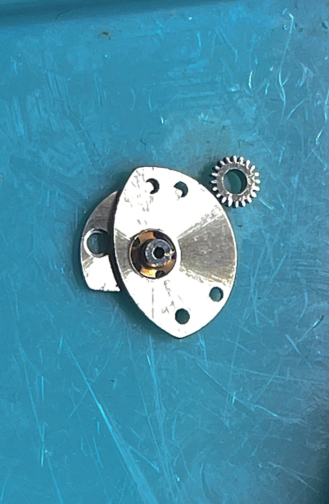

Wondering if anyone can suggest where to source a Universal Genève cal 69 part 1497. This is the rotor ball bearing which is faulty on my Polerouter Super. I have tried the obvious avenues such as Cousins, EBay & Urdelar without luck.

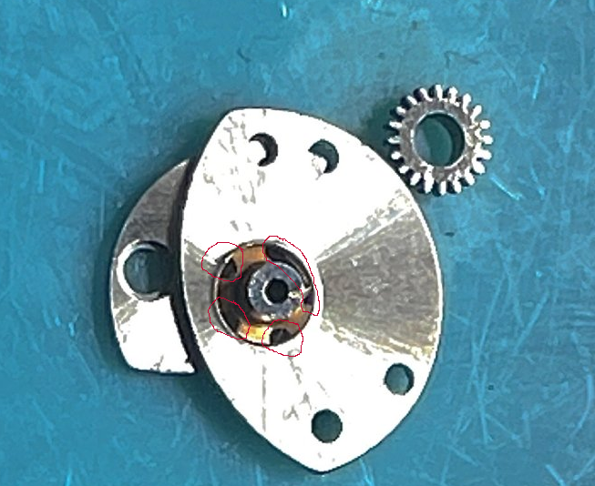

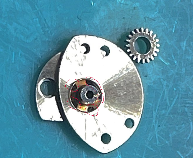

Yes, although better (there is less friction), the roller bearing solution fails due to the wafer thin brass spacer that is used to keep ball bearing equally spaced (see below image). The common problem that they suffer from is visible in your microrotor (oblong circling the failure). it gradually wears the brass spacer which eventually breaks. Bearings are no longer held in place (spaced out evenly) and oscillating weight wobbles. The wobble gradually gets worse and Bob's your uncle.
They are impossible to fix. I have tried doubling the number of bearings and had limited success. To much work for too little. Best to opt for an earlier microrotor !
